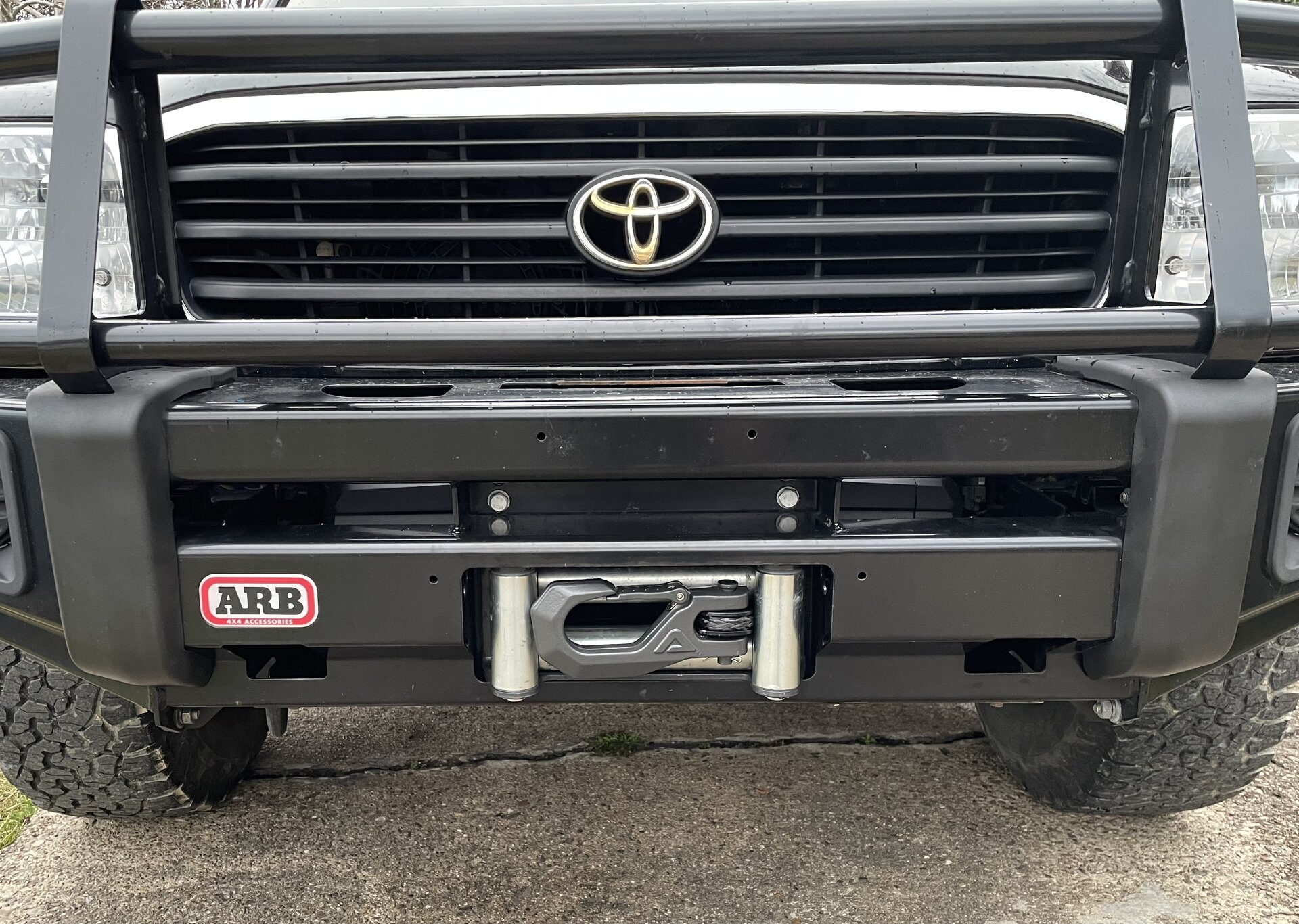

Installed a HF Apex winch to replace my old Ramsey that died recently. The winch itself is a beast, but fit with plenty of room inside the ARB. The only real negative is that the control box is absurdly large. I ended up disassembling the Apex control box and modifying the Ramsey box to fit everything. I mounted it behind the RF headlight.
After quite a bit of research I decided to stick with my roller fairlead. IMO, it suits the ARB design better than a hawse and gives the rope better protection.
I might have considered a Warn VR, but I had a $100 gift card to HF from Christmas and caught it on sale too. The winch appears well built and offers a lot for the money.

You won't regret it. That winch has served me well. Well, its mostly served other people well ;)

Any chance you can share some more pics on how the kill switch is mounted and where?
I'm just about to do the same set-up as far as control box location and including the kill switch as well...
I sure can. The switch really isn’t “mounted” per se. It’s just held in place at the moment by the stiffness of the cables. I have the positive cable routed from the control box across the radiator then down and around the battery to the cutoff switch.
I might make a bracket for the switch that mounts on the battery tie down. That seems to be the easiest way to make a permanent mount in the area.

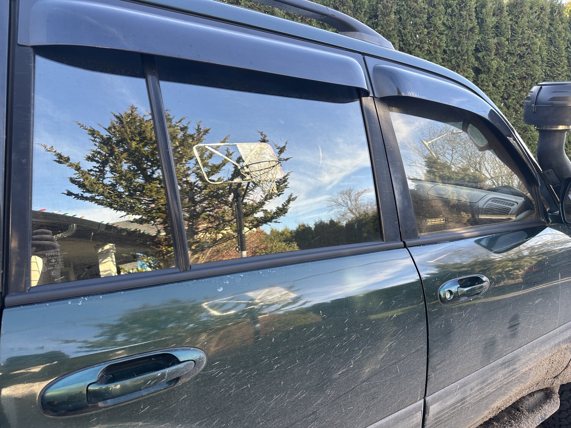

Shout out to @Trapper50cal for the window trim idea. It didn’t bother me until I found out how cheap it was to do 😂

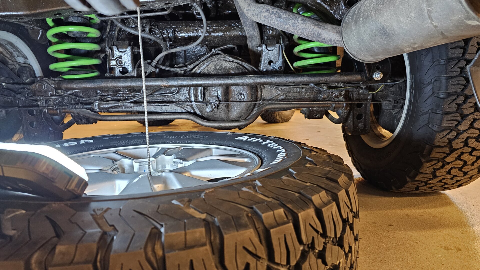

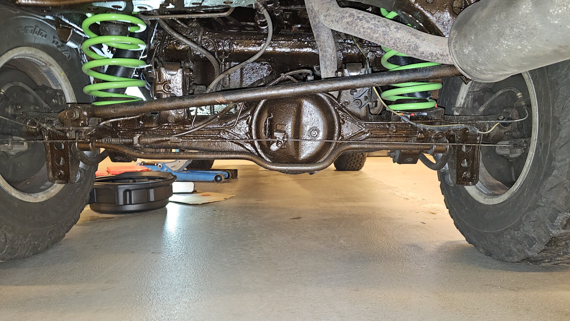

Installed the Delta VS panhard drop bracket. Easy job and trust it solves that awful death wobble / sagitta ass shake the cruiser got following its (ironman) ~ 5cm lift. Funny enough i only had the death wobble on concrete - not tarred - highways. Look how nicely its levelled the panhard bar...
Before:
Beafter:
Was the death at certain speeds or all the time?
Which ones did you go with? I’m motivated to do mine now.
