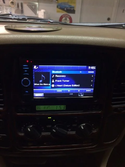

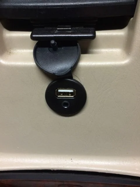

1. Installed a stereo: Kenwood ddx470 (double din dvd with Bluetooth and siriusxm) and added a flush mount usb cable in the console.

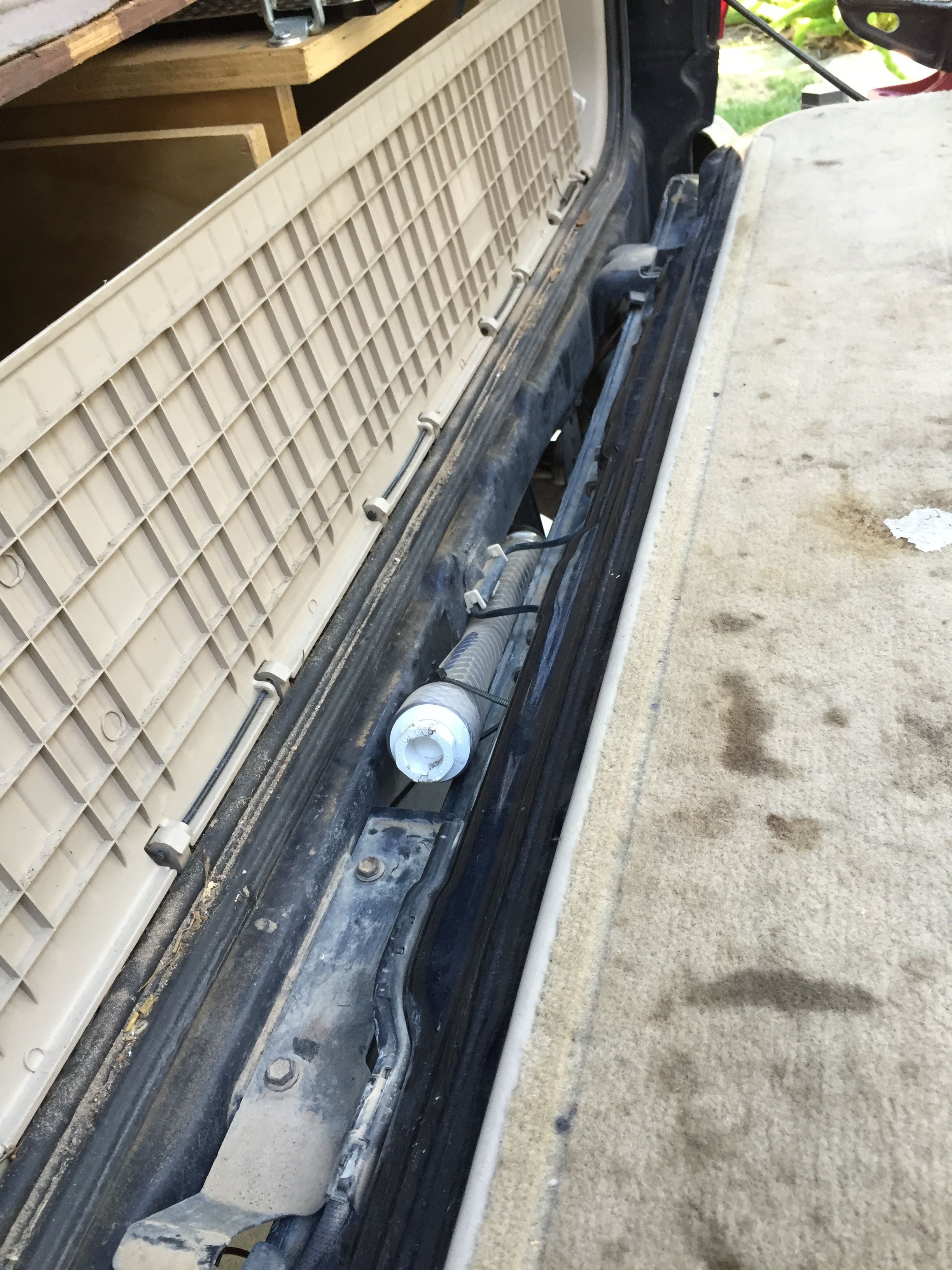

Installed a ~12 gallon ABS water tank where the spare would usually be. Decided to try this route instead of an auxiliary fuel tank since it seemed easier/safer. So, fresh water here, fuel in jerry cans on the rack.
The install for now is more of a proof of concept than anything...a bit rough as you'll see from the pictures.
I tried to tuck the tank up as high as possible, but at some point it hit the hoses entering the charcoal canister. The angle of the hoses did something since I got a CEL immediately after putting my tools away and going for a test drive. Had to lower the front of the tank an inch or so which isn't all bad since that'll help me get every last drop of water out of the tank.
You can just see the water pump mounted along the side of the tank. For now, the pump sends water to the Helton heat exchanger. I haven't yet, but plan to route another line for cold water direct from the tank.

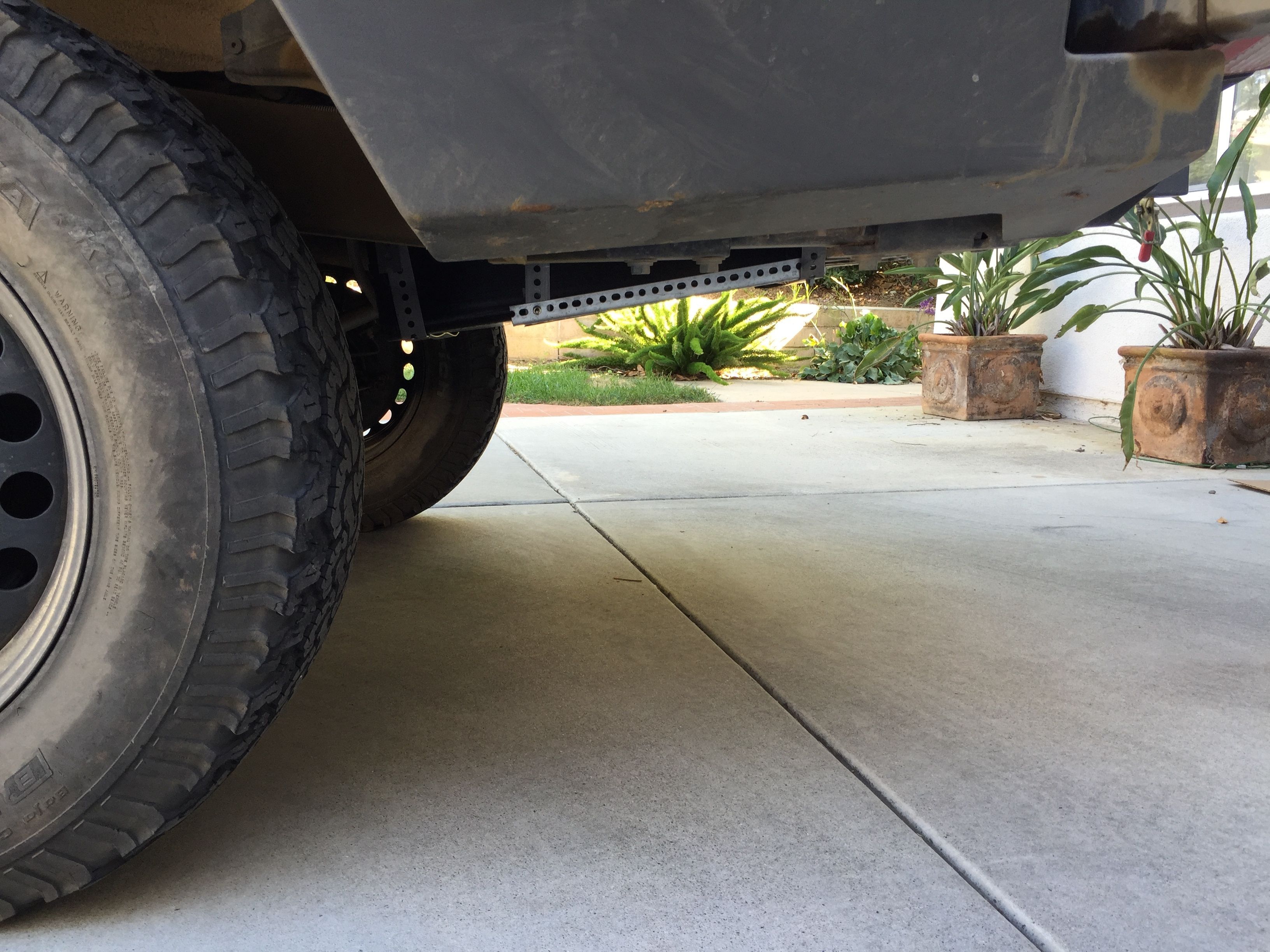

From the side, you can see the tank angled down from the back, hanging below the line of the frame a couple inches (looks worse in the pic than in person). I doubt this will be too much trouble other than in extreme situations, but we'll see. I'll bring extra water on the first couple trips in case the tank gets smashed on a ledge.
The fill pipe comes up between the tailgate and the truck. When the tailgate is open, there is a bit of a pinch on the 1.25" ID fill pipe, but not enough to worry me. The tie wrap keeps the pipe angled so there isn't any stagnant water. So far so good.

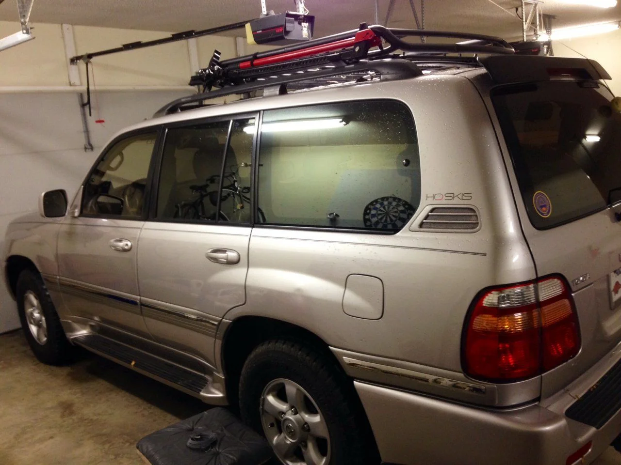

rearranged the drawers to recovery in one and camping stuff in the other. Bolted the high lift offroad base to the jack

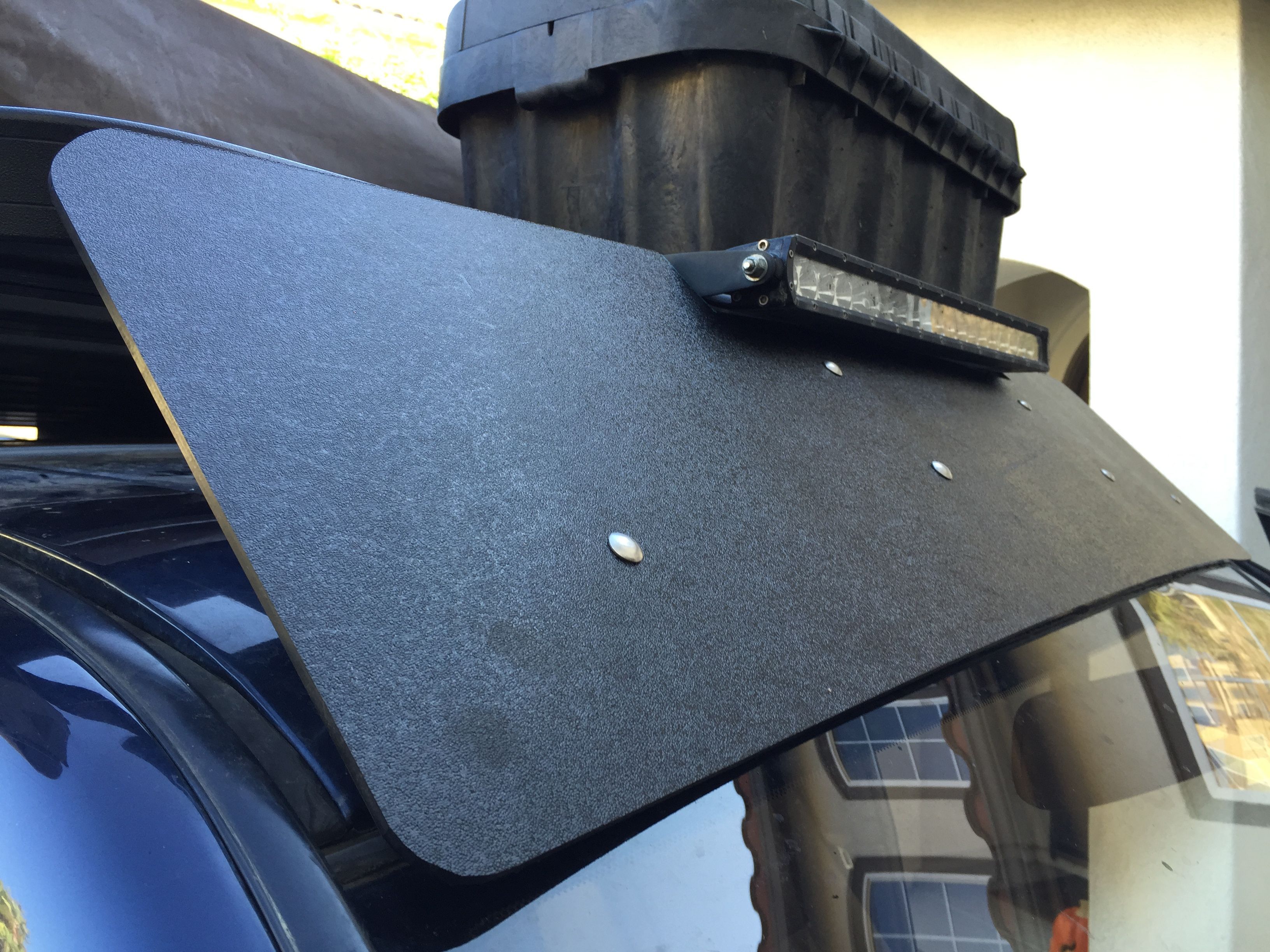

Having installed taller rack feet on my Front Runner rack to allow me to squeeze a table underneath, my previous off the shelf Yakima fairing became pretty much useless, standing nearly vertical between the rack and the roof. So, I ordered a big slab of ABS from Tap Plastics and rolled my own. It for sure takes up more real estate (decided to extend it down to the windshield), but it does cut down on wind noise and should immediately improve my gas mileage. Or maybe I'll just have somewhere to put a bunch of expo stickers.
The "finished" product. May still add a rubber strip along the bottom edge.
Notched out the top to go around the light bar and rounded the corners with as much precision as I could muster after a couple beers.
Made some custom brackets with bits I had laying around the garage.
Finally got around to mounting the Hi-Lift jack I had laying in my garage:) Just got to keep my clearance in mind from now on. Sure don't want to take that garage door with me when I pull out.

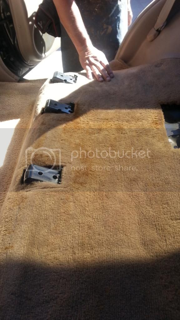

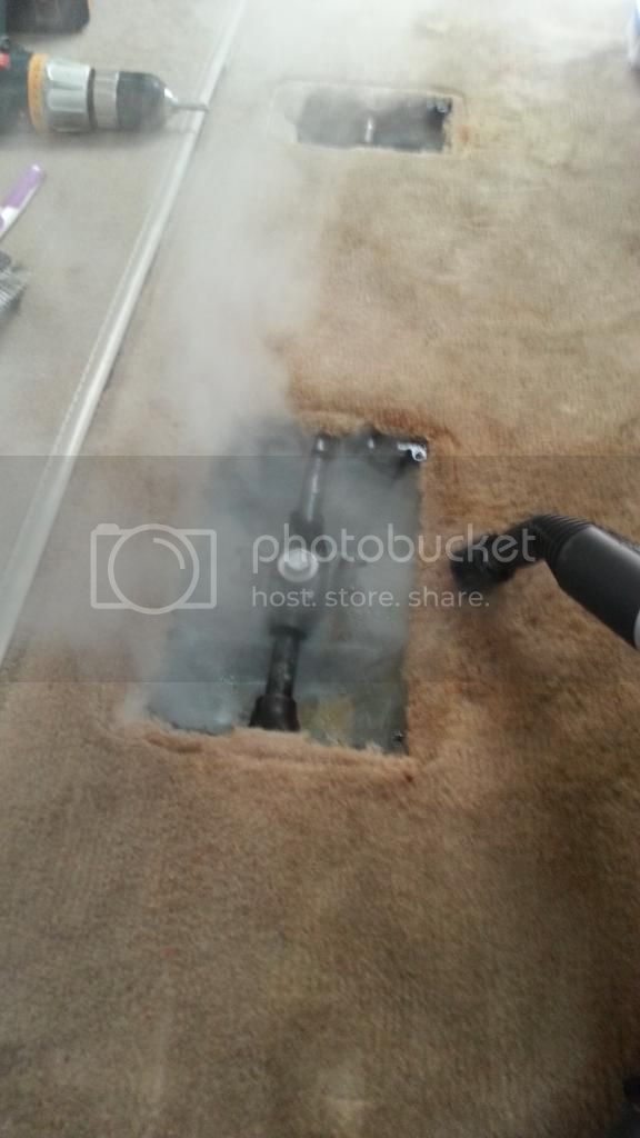

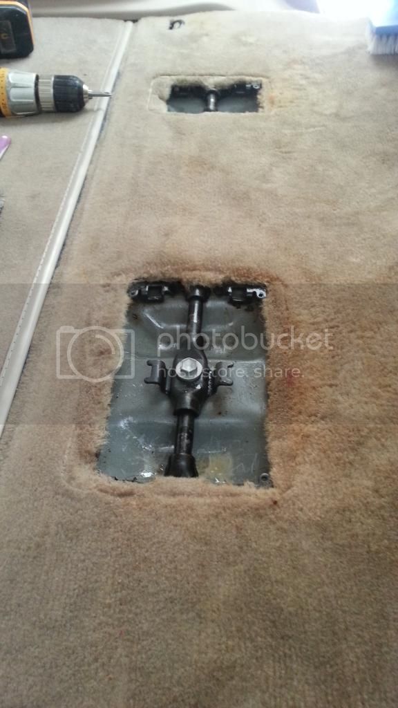

Getting my 2001 ready to sell and was not comfortable with a carpet stain hiding in the middle seat area. Removed seats, steam cleaned area, but decided I'm going to pull the interior, remove carpet and power wash the entire carpet. Looks like someone spilled a coffee in the past :)
Oops

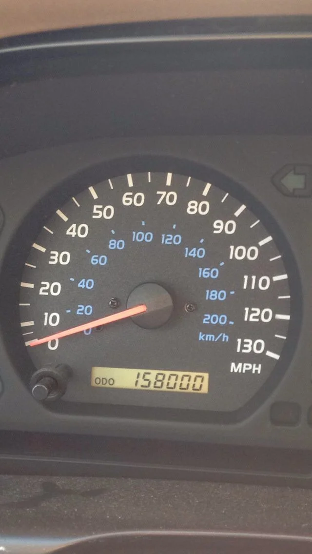

Rolled over 158,000 on the way home from work. Not too bad for a 2000!:)

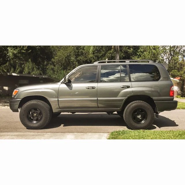

added Duiser Recovery Brackets on all four corners
ordered Slee , ext batt setup, full skid plate setup and will also be extending the breather lines on the transfer case and diffs next week
