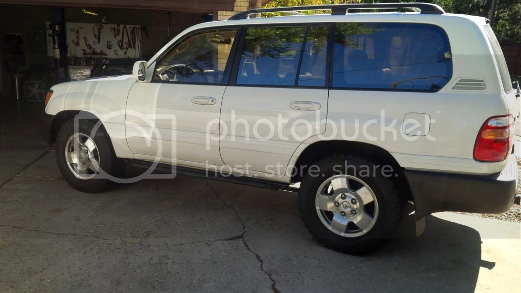

Which Tundra sliders did you get? Any more details on how they needed to be modified? :)
These were originally Rocky Road sliders for the new crewmax tundra. Guy who bought them did not like them and gave them to me very cheap or I would not have gone this route. With help from a member who is also a welder we cut them down about 24" inches as the crewmax tundras are huge, welded the ends shut, cut off the mounting arms and welded on new ones to fit the LC.
what they looked like originally:
@ProvoCruiser Off topic I know, but did you have to remove those rear vents to plastidip them or did you just spray them while they were still on the truck?
I taped them off very well and sprayed them with rustoleum flat black. still look good after a year.
