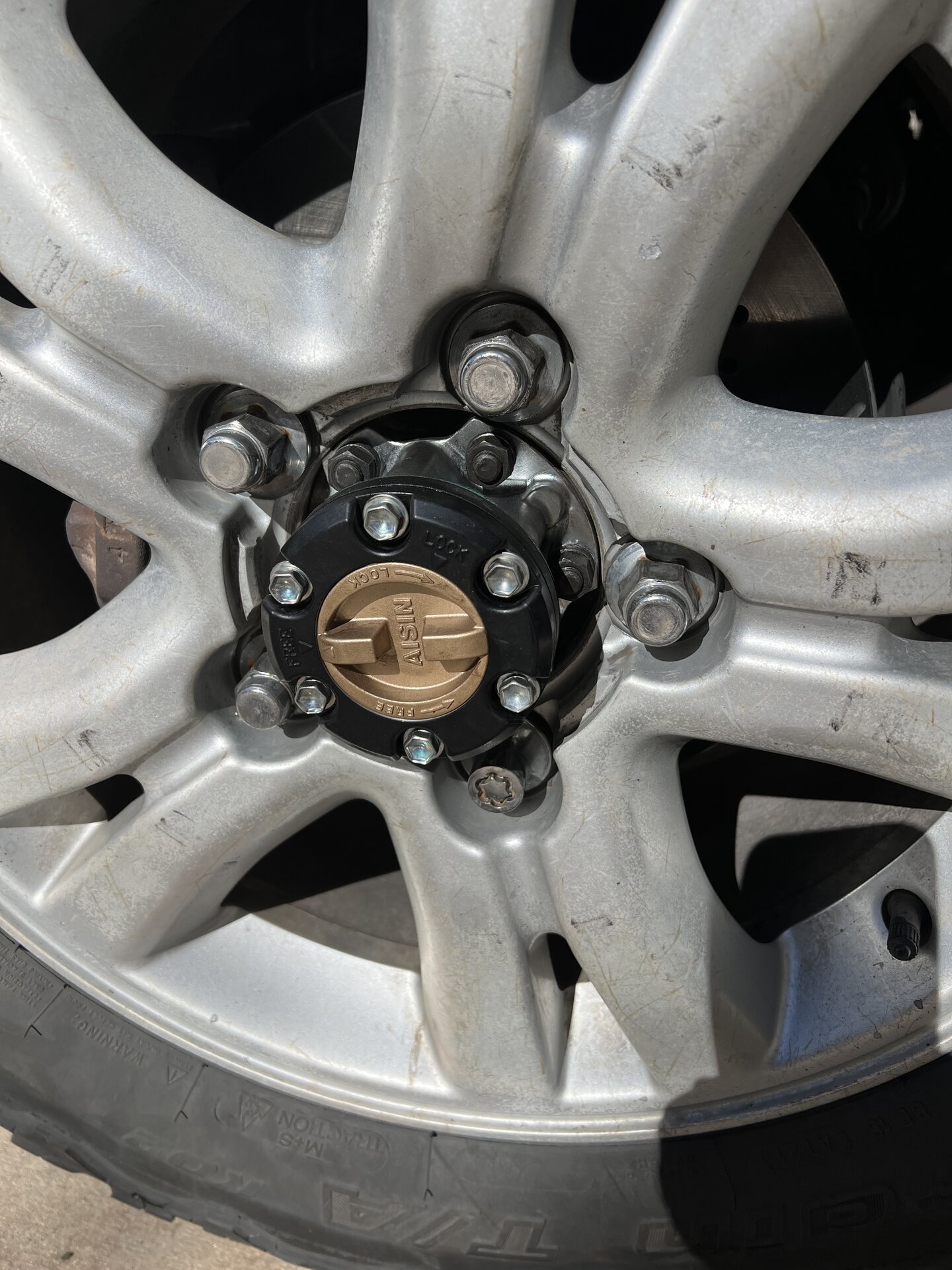

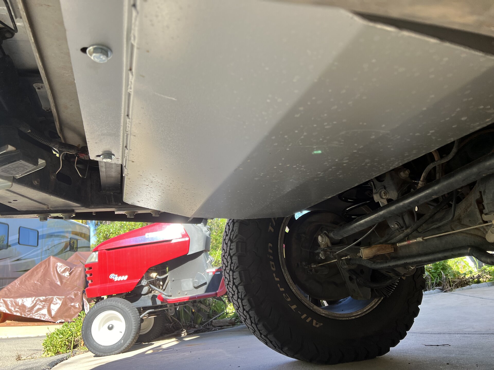

Added front disconnects and a 24 gallon reserve tank also some new springs in the back to handle the extra weight.I was really busy with building a shed to put my tractor in and a couple of other projects so I had “The Truck Shop” in San Diego do the install for me. Very happy with the quality of their work. If you’re anywhere in SoCal I recommend them for working on your LC/LX.
She’s coming along nicely.
What did you use for the accessory fuel tank?
