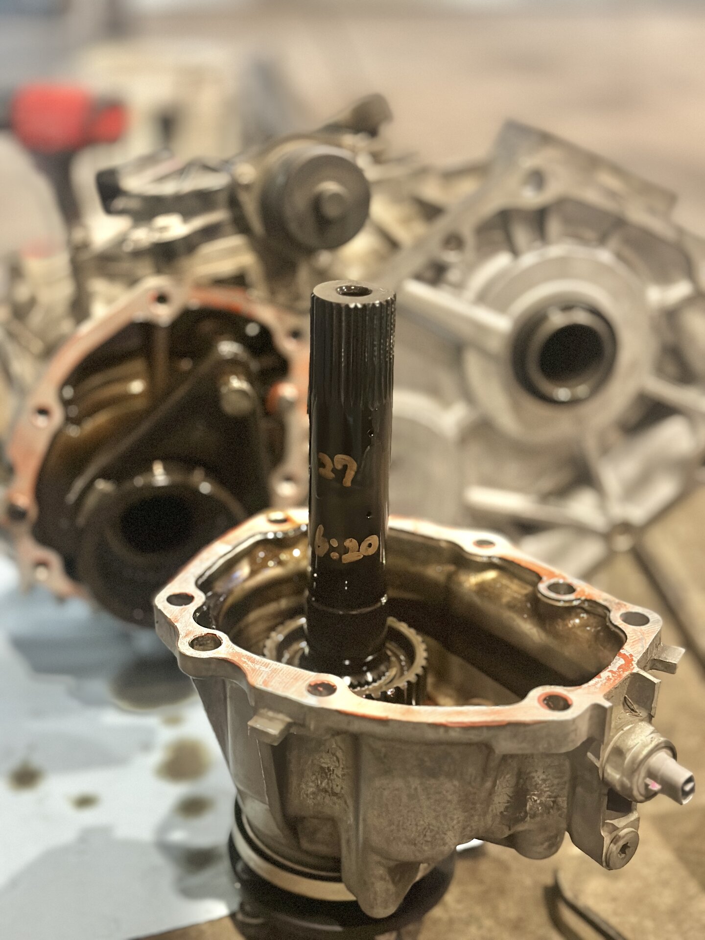

T-case refresh on a 06LX:
• Input shaft seal and bearing replacement.
• Output shaft seal and bearing replacement.
• Transmission output seal replacement.
Symptom: weeping gear oil (and you know gear oil, it’s thick and smelly) at the input flange (front). While at it I will be replacing wear items like the f&r bearings as well just to make sure there is no play/lateral movement of the rotating part.
On a side note, interesting to see who ever built this 18 years ago wrote the specs on the shaft itself.
Choice of parts are all OEM and is now inbound, fun project as usual. Happy wrenching everyone :banana:
