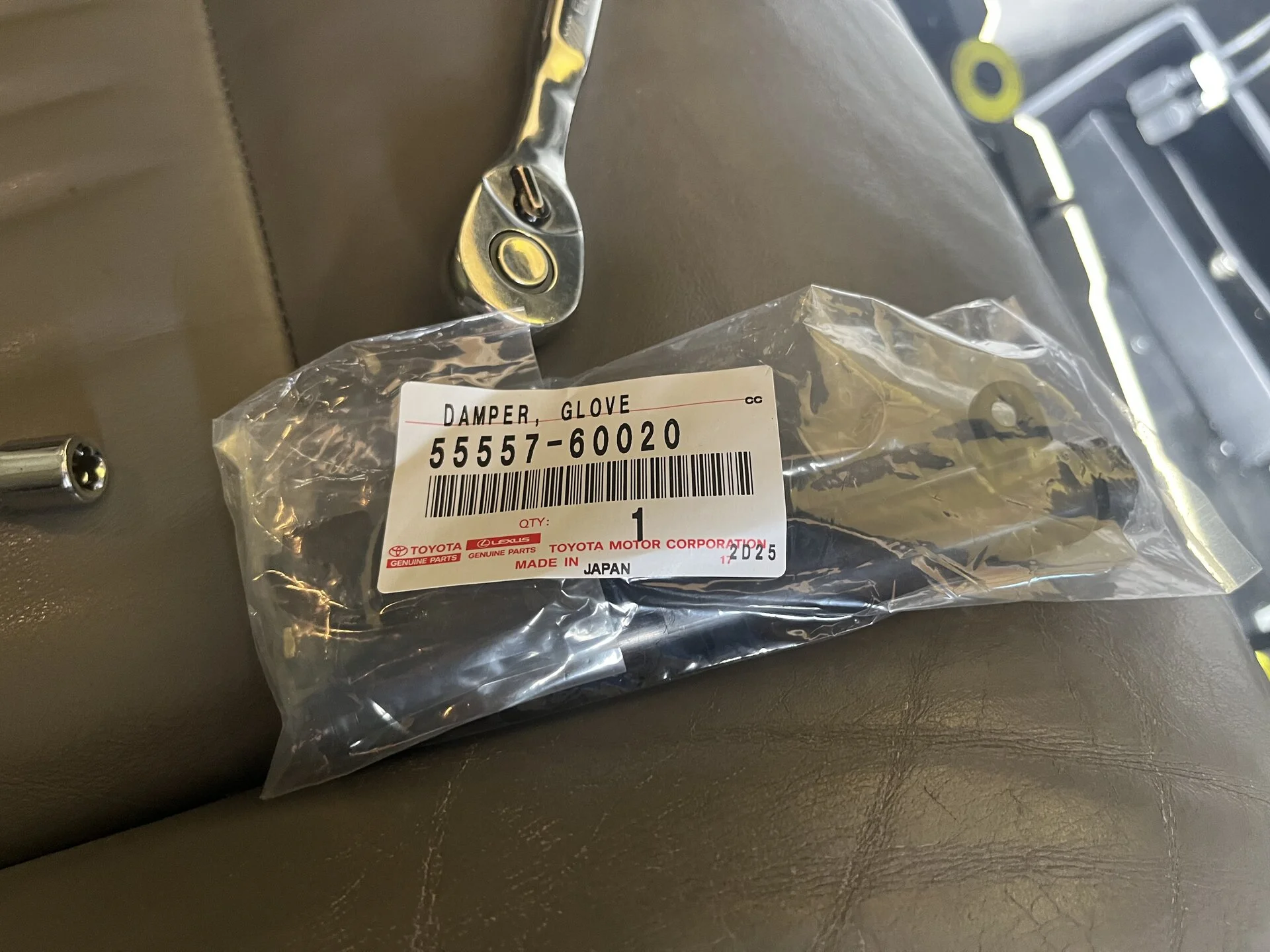

I must have overextended the glove box damper last time I replaced the cabin filters, was the perfect “while I’m in there” job.

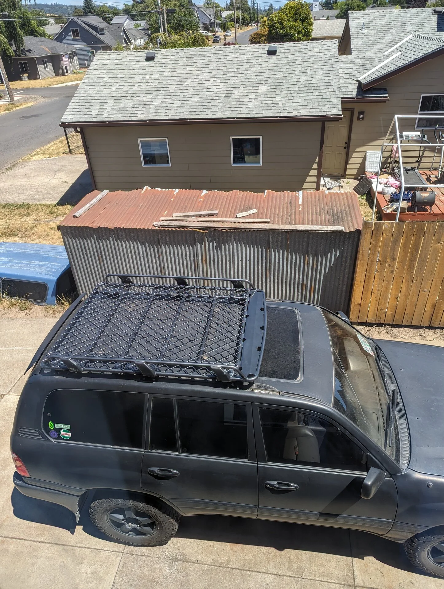

@PrinceJabar
What’s your initial opinion of fit and finish? This seems like a really good budget friendly rack, although I wish it mounted a bit lower.
The finish is really great. The powder coat looks nice and I don't have any weld splatter on the rack.
The fit? Well, YMMV, but I found this install a gigantic pain in the ass. Yes, it installs correctly, but the instructions are severely lacking. A couple pictures, all low quality, so I didn't know which way some of the brackets faced. I had a general idea but it turned out wrong, so I get to uninstall and fix two of six next weekend.
Overall I'm very happy with it. I wanted a light weight rack(44lb) and that's what I got. I think it looks nice and the price is right. On sale it was about $760.

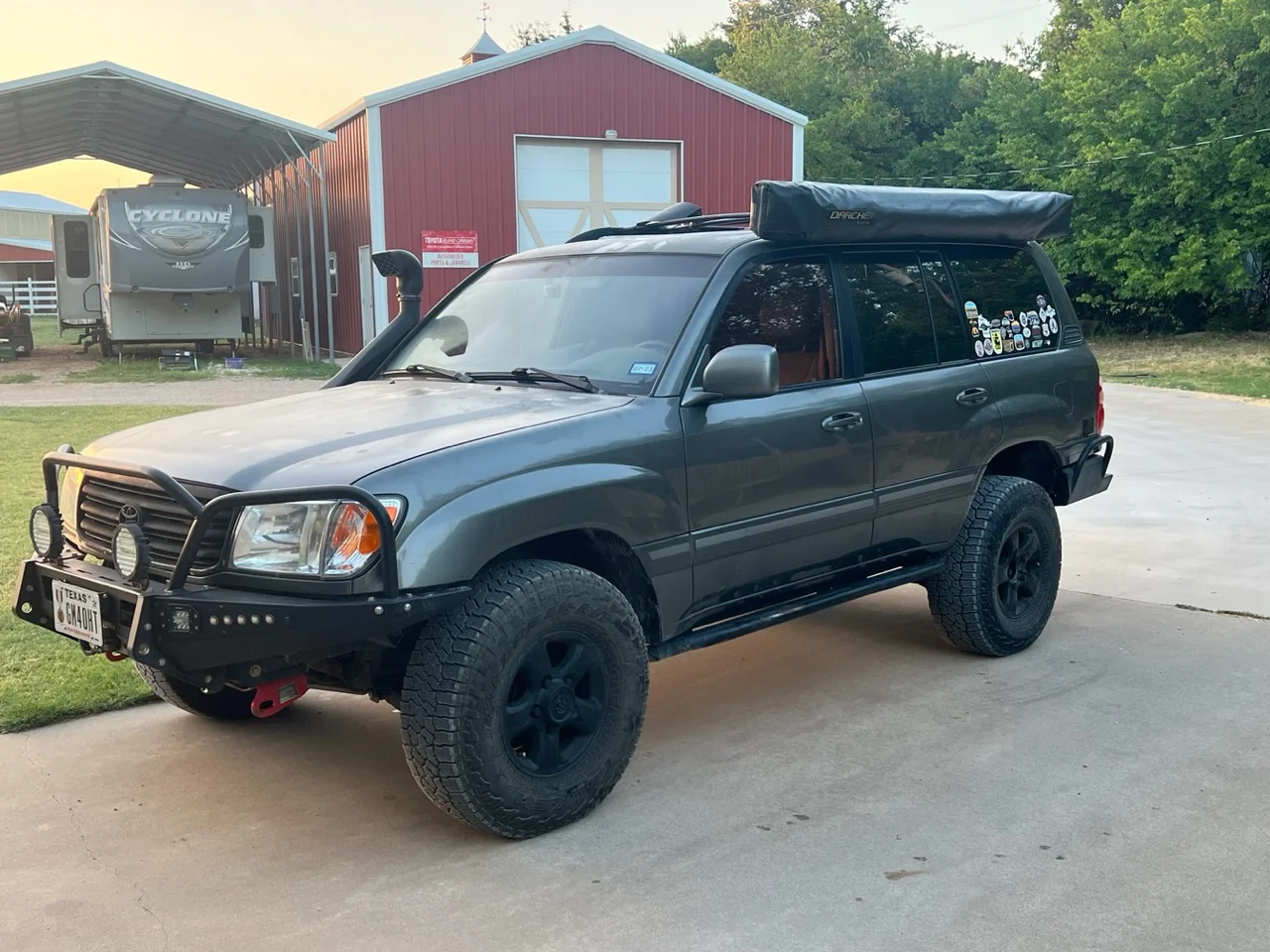

Busy couple of weeks getting ready for CO later this week.
Installed ValleyTech rear bumper. Very stout and Garret is awesome to work with. Wiring everything up was actually the hard part.

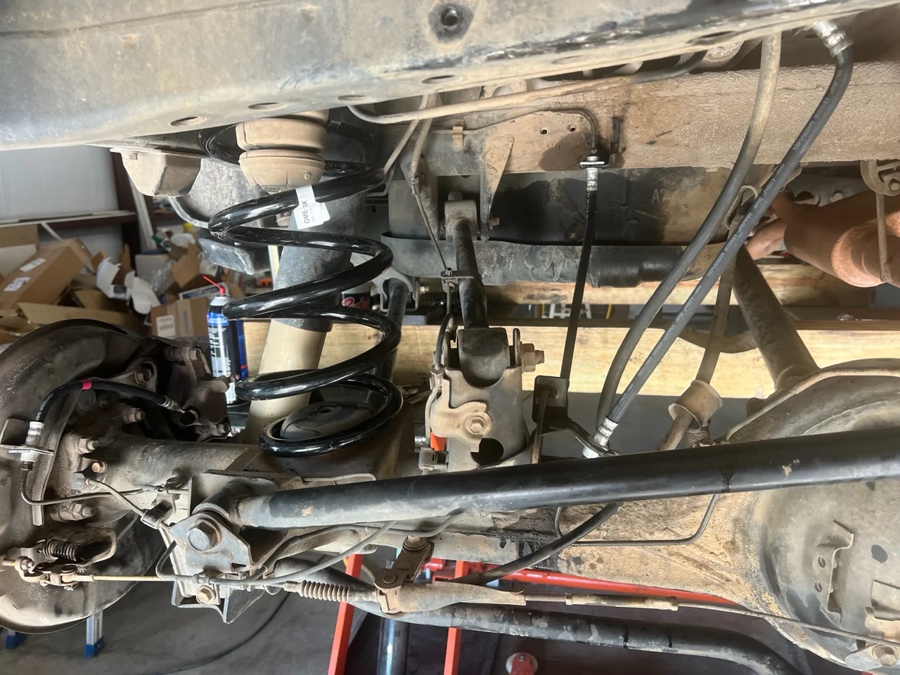

Replaced OME 2865 coils with OME 2863s. This was a bigger PITA than I thought it would be. I cannot get my lower shock mounts to budge, so had to unscrew them from the top...
Replaced right rear axle seal and Oring, so I could replace the parking break shoes.
As long as I had to break into the brake lines for the axle seal job, I replaces all the rubber brake lines with Toyota. The 23 year old 300k mile lines actually were still pretty flexible, but I didn't want to find out the hard way on a mountain pass...

How does the ride feel with the 2863s?
Honestly just a touch firmer, and I may not have even noticed if I didn’t know better. Clearly I added weight with the bumper, and it’s sitting just over an inch higher, but it’s only been a day. It is definitely stiffer and doesn’t settle as much when I sit on the tailgate, so I’m hoping for better manners offroad.
did you have to adjust the TBs?
I didn’t. I’m waiting for it to settle, and I’ll see what it’s like loaded with camping gear before I do anything. With the 2865s, I sat dead level with camping gear, so I knew adding the rear bumper would over do it. One of my plans is to add a gas tank where the spare was, and I’m hoping these springs will be enough for that, but we’ll see.
