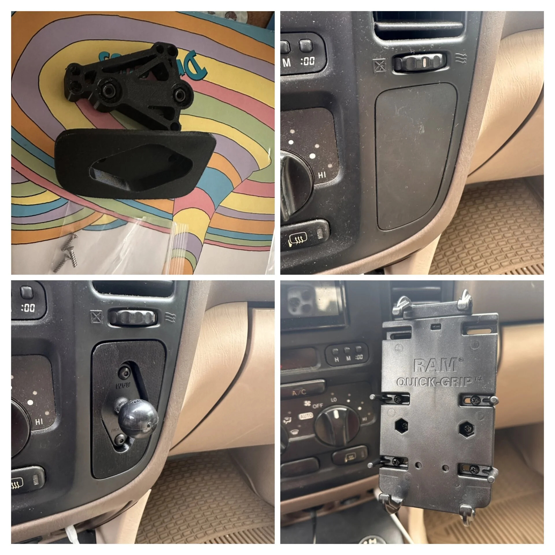

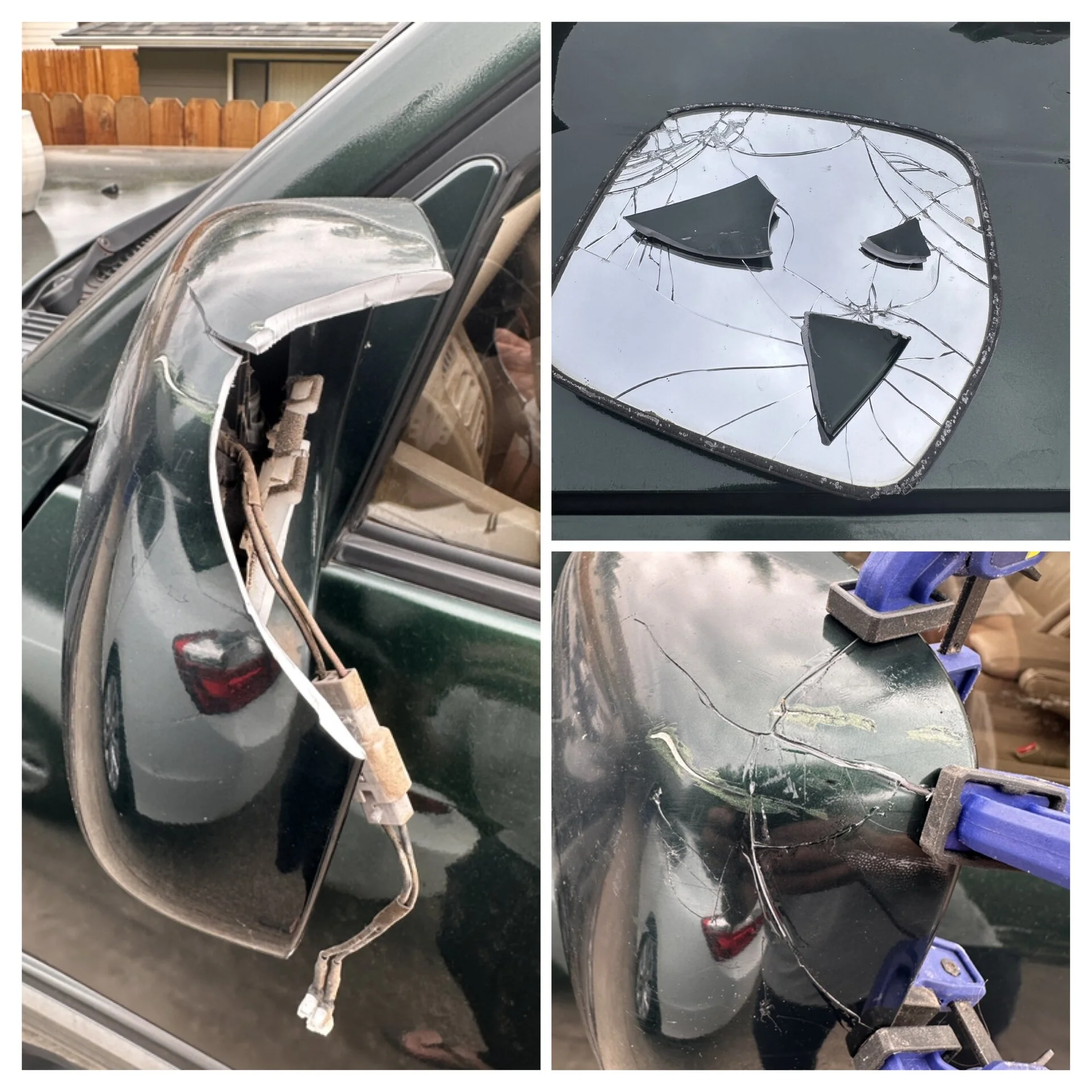

Installed the M2V2 from @BenCC. Awesome product - the install took about 20 minutes and Ben's pieces fit perfectly. Also repaired my driver's side mirror housing after a neighbor clipped it the other night. Not the prettiest repair but the epoxy seems to be working well. Someday I may find a color-matched mirror but until then this should do. New glass from McGeorge Toyota is on the way.
How far out does the phone mount site from the dash? I have been thinking about this option.
Perhaps not as far as it looks in the first photo I posted. Here is another view. For reference, the RAM double-socket arm (from Amazon) is 2.42" in length. I'm happy with its position and it doesn't seem to impede into the front passenger's space.

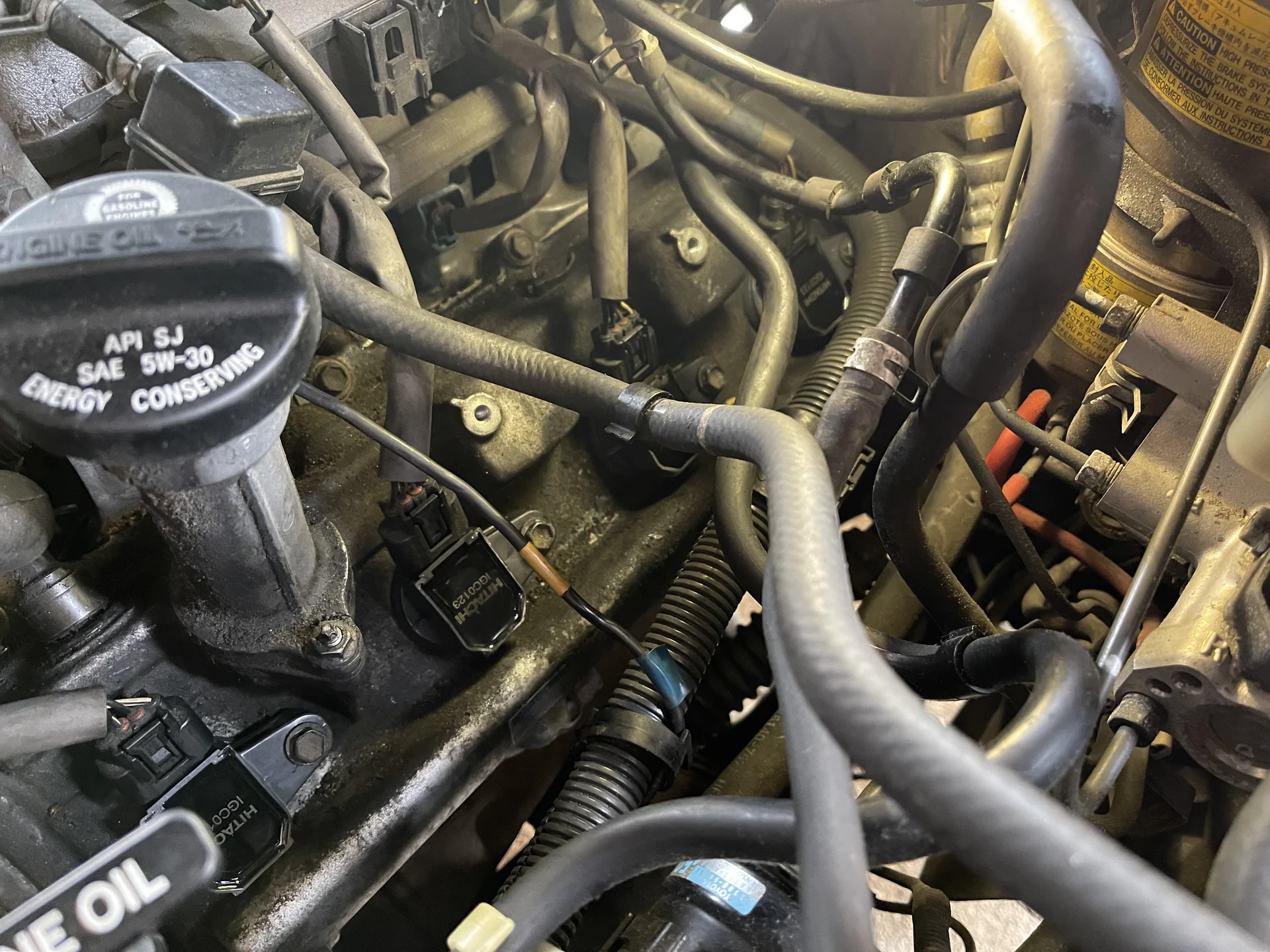

Muscle, steel, and sex appeal is what comes to mind when I look at these newly installed Hitachi Coils, paired with DENSO Iridium long life plugs. I also changed out the air filter today with a basic FRAM. Simple maintenance to some, but it made me feel good. All but two of my plugs were hand tight. Only one coil had a crack, and they all look to be OG Toyota DENSO's, with possibly one or two of them replaced with OEM over the last 262k miles. Do I just discard them all, or are they worth saving? Without knowing how many miles are on them, I can't see myself ever reusing them...
I aimed plug torque to 13 ft.lbs., but torque range was from 13 to 15.
Not sure if it's just my deep sense of satisfaction, or if the LC is actually running better. Probably a little of both!
Keep a couple coils as emergency spares and give the rest to friends for the same. You can never be sure one of your new coils won’t suffer from infant mortality, and a coil is an easy diagnosis and repair with an OBD reader.
