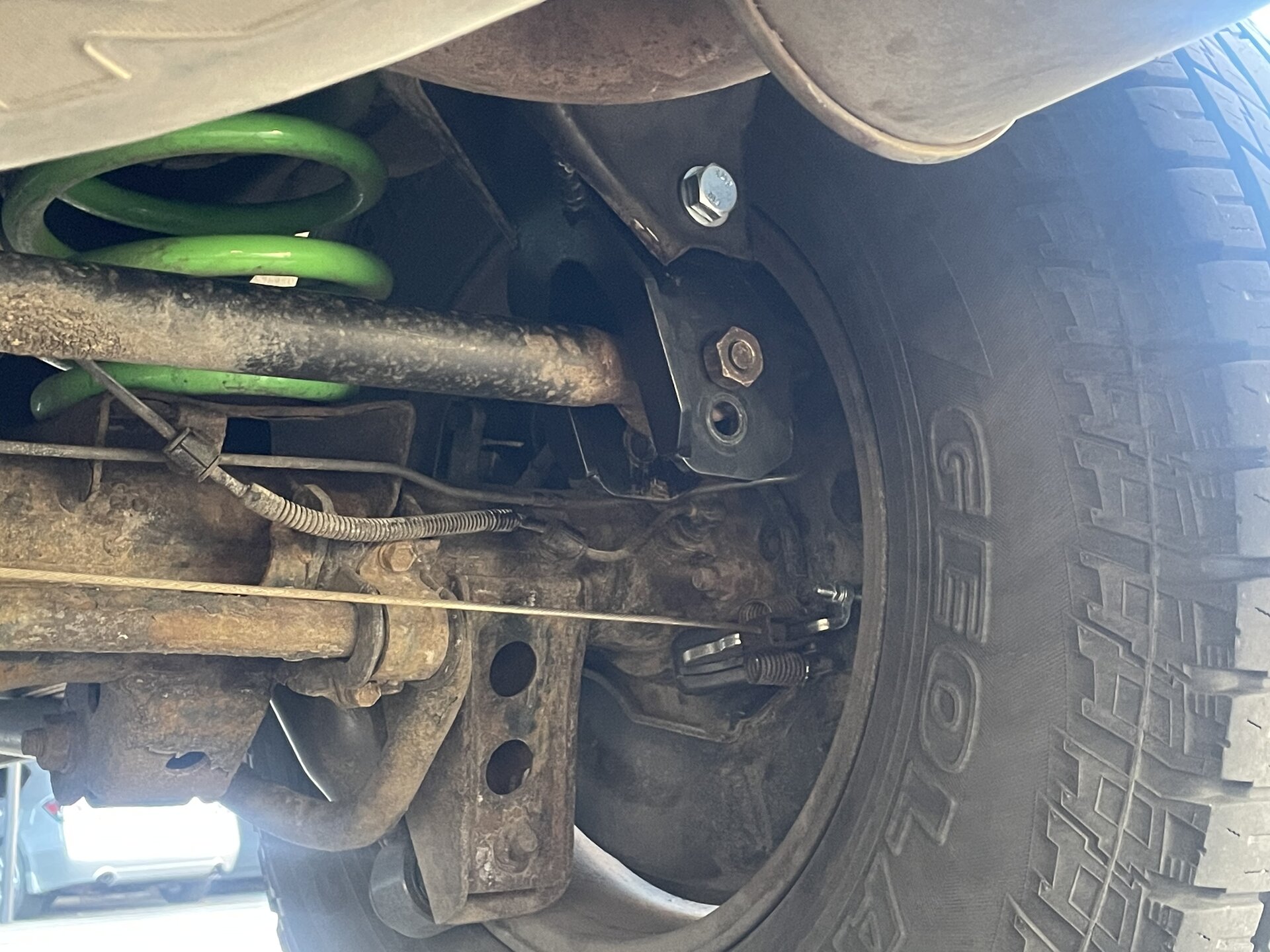

I also found what’s been causing the clunk sound in my front end. At some point my sway bar end link broke off!
Stopped by cruiser outfitters today and picked up replacement sway bar end links. I opted to save a bit of money and got the aftermarket ones. I’m not sure if it’s the same on the OEM ones but I had to use a mallet to get them in on the lower control arm mount. Extremely happy with how well this old cruiser drives after doing this work. Planning on ball joints next, though I’m thinking of saving up a bit and replacing the upper and lower control arms with the kit from cruiser outfitters. I think it would save a lot of time pressing out bushings
