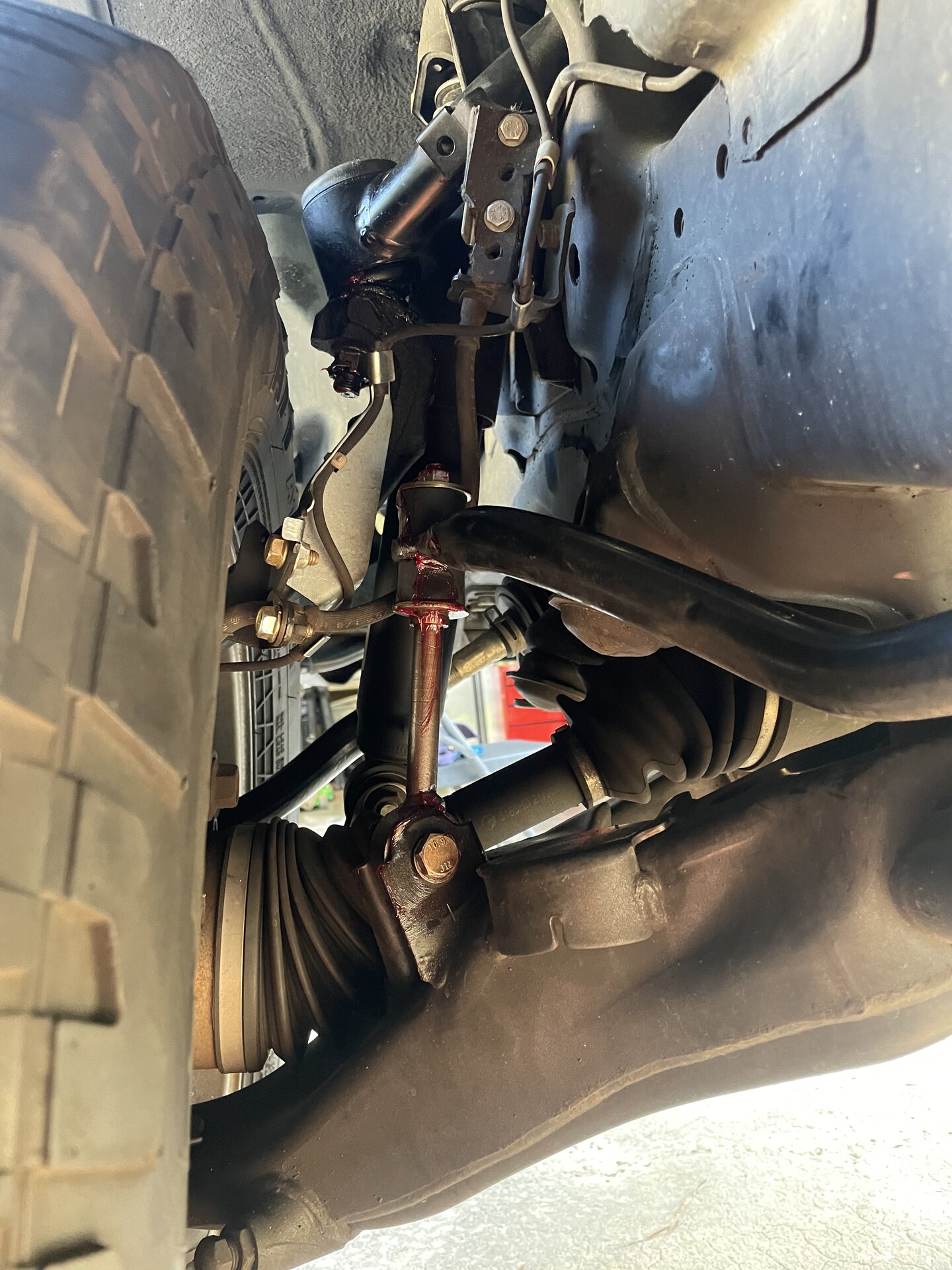

Modded a new donor pair of f250 sway bar end links to account for the 2” lift.
This will hopefully put and end to the creaks and clicks from the originals.
Had to shave the eye down to approx 18mm width.

Missing a washer below the bottom bushing of the upper mount?
Yes, the only thing I had in my parts bin that would fit was too wide and would rub on the abs sensor wire. I’m going to the hardware store today to get it buttoned up.
Other than needing a washer, and grinding things down, I think this is a workable solution vs spending $100 for overpriced extended versions.

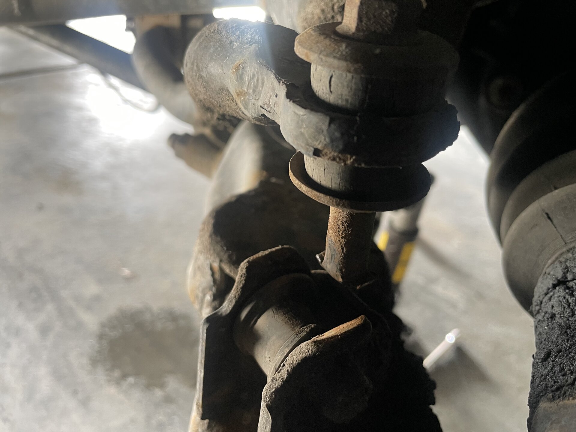

I also found what’s been causing the clunk sound in my front end. At some point my sway bar end link broke off!

Update, had the washers just didn’t realize some of them had a larger diameter to accommodate the flared post. Generally, I just assume nothing goes right and I have to go to the hardware store.
