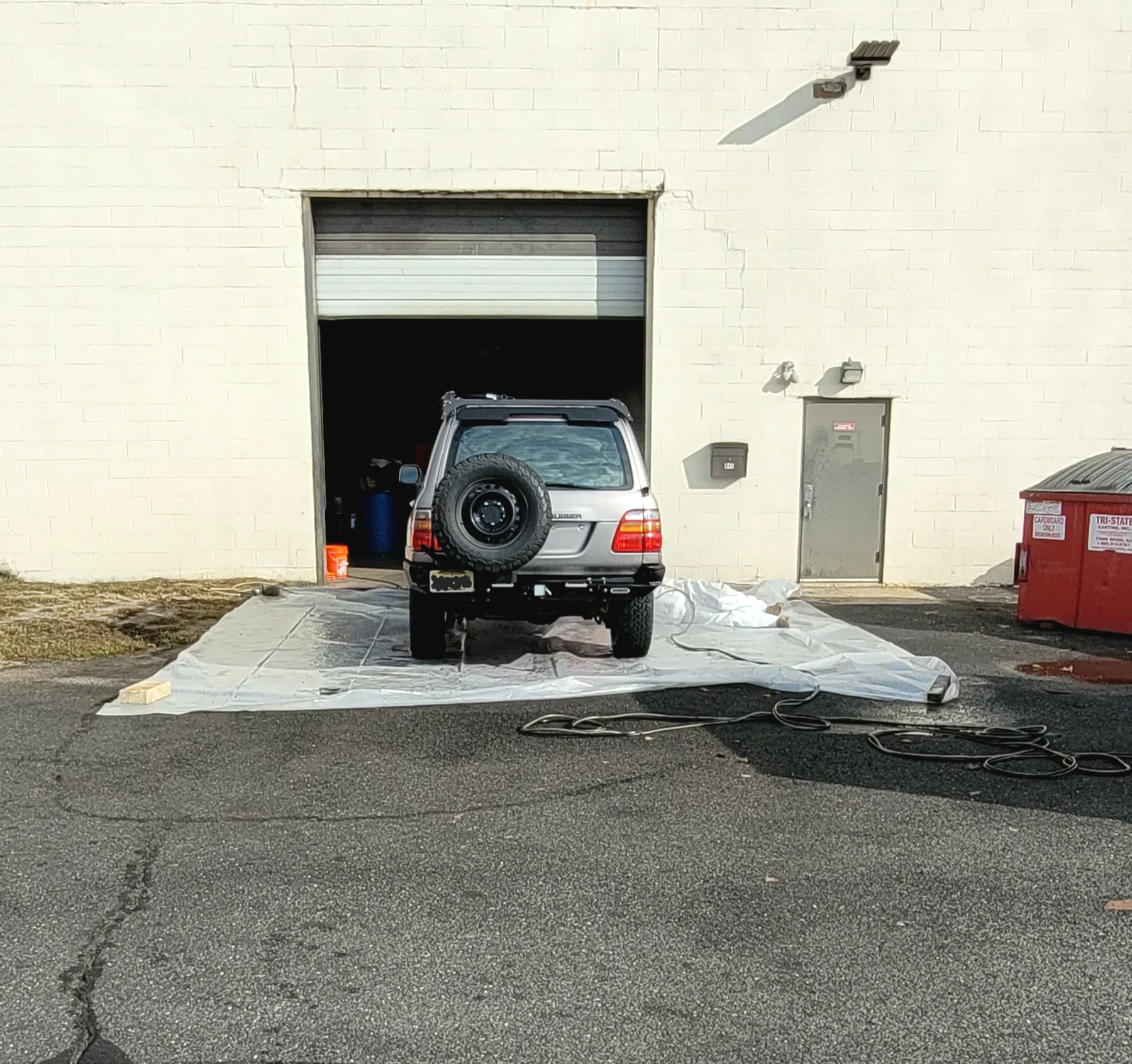

Had an petroleum based uncoating sprayed this past Friday. The shop also sprayed inside the doors, the lift gate, door jams, wheelwells.

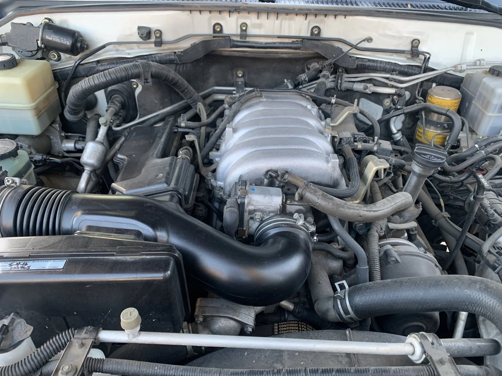

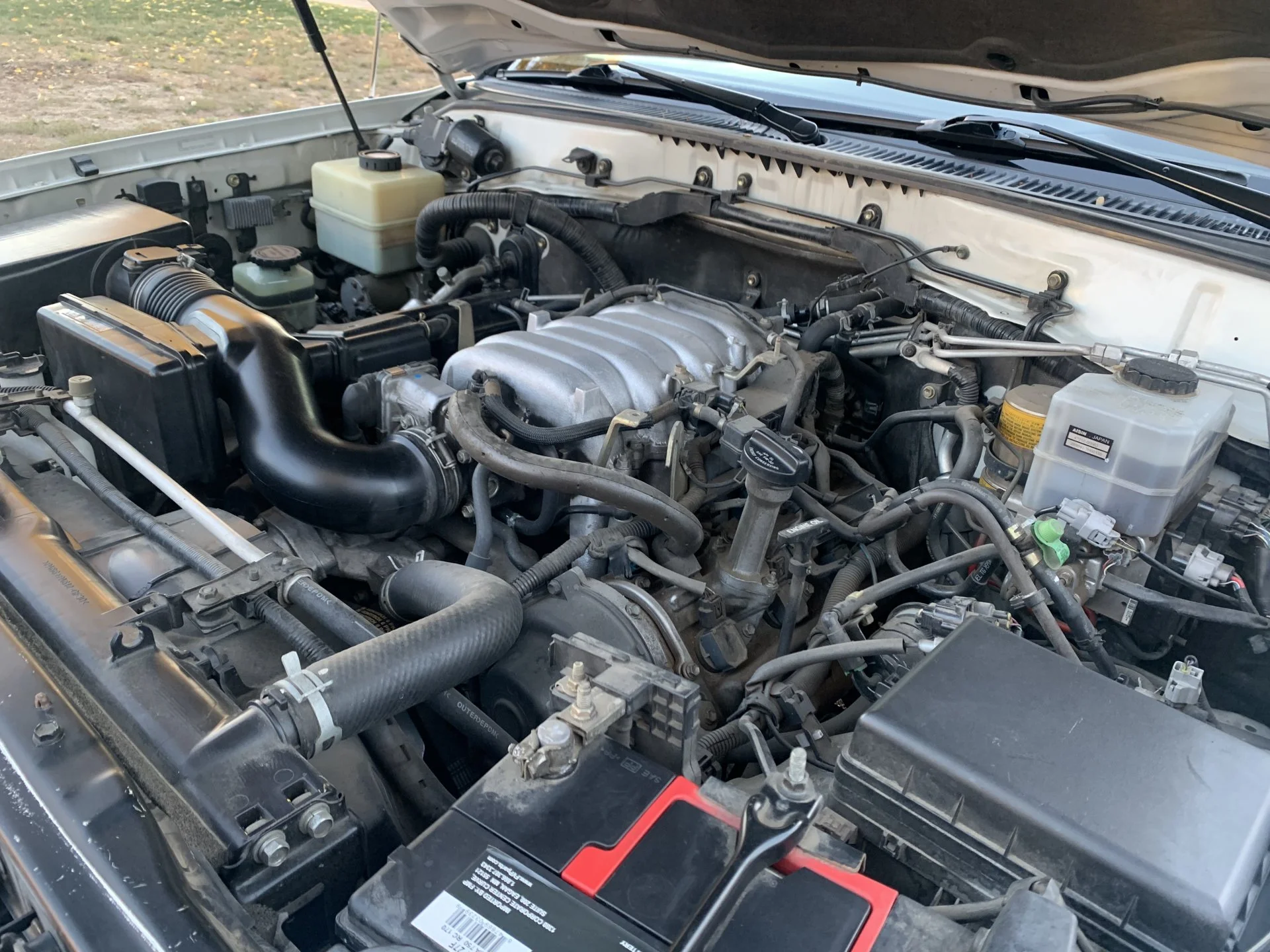

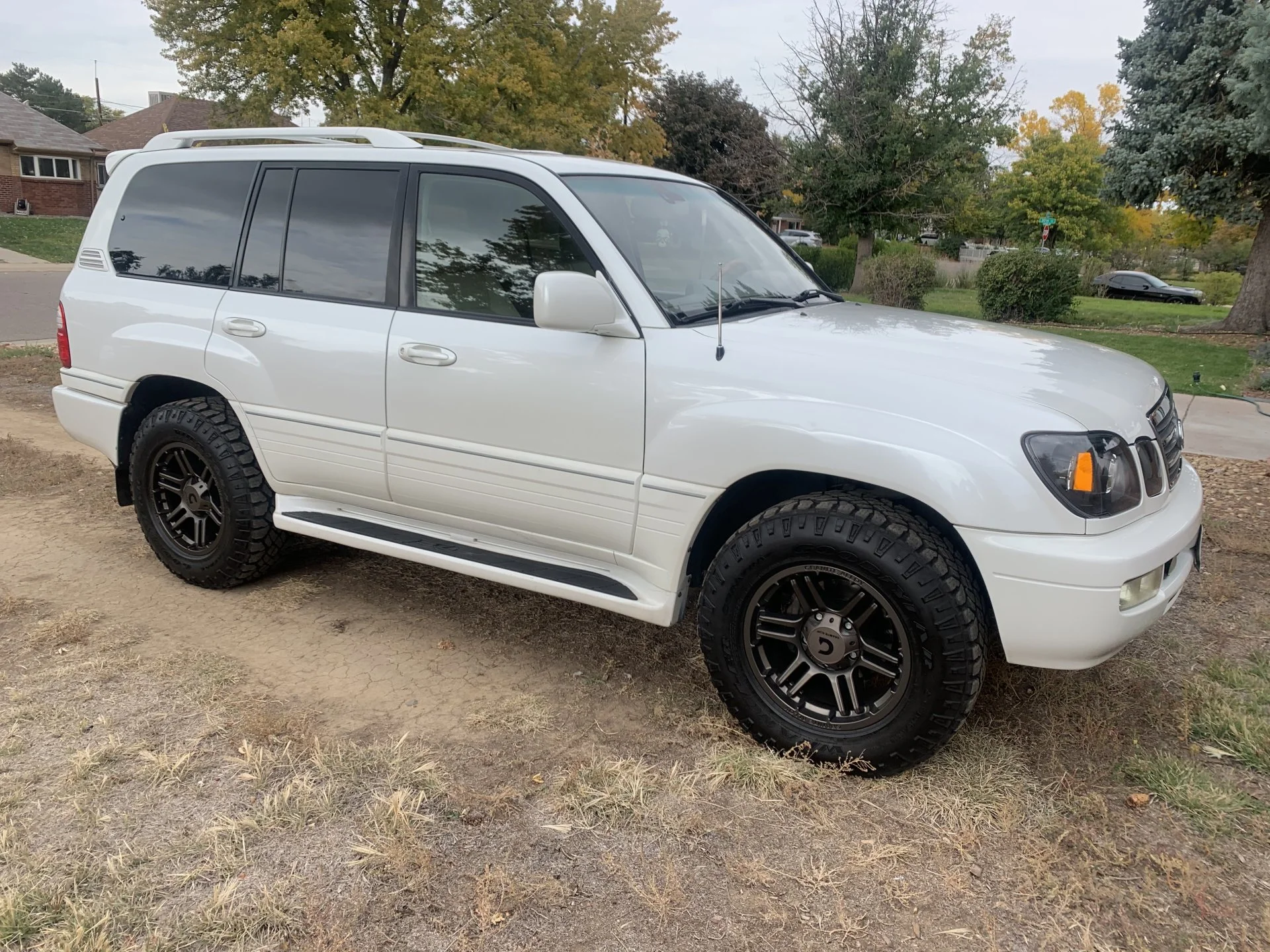

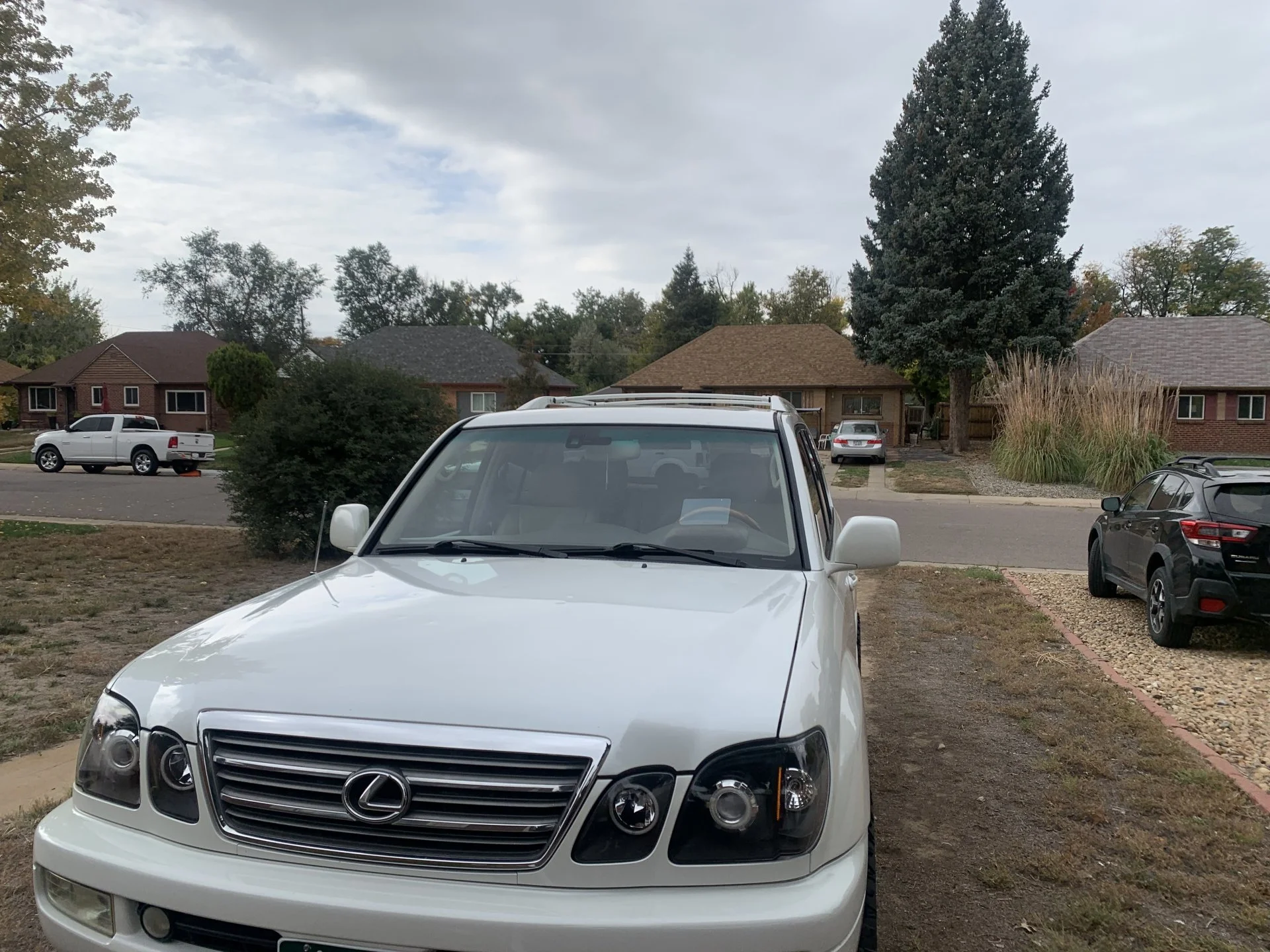

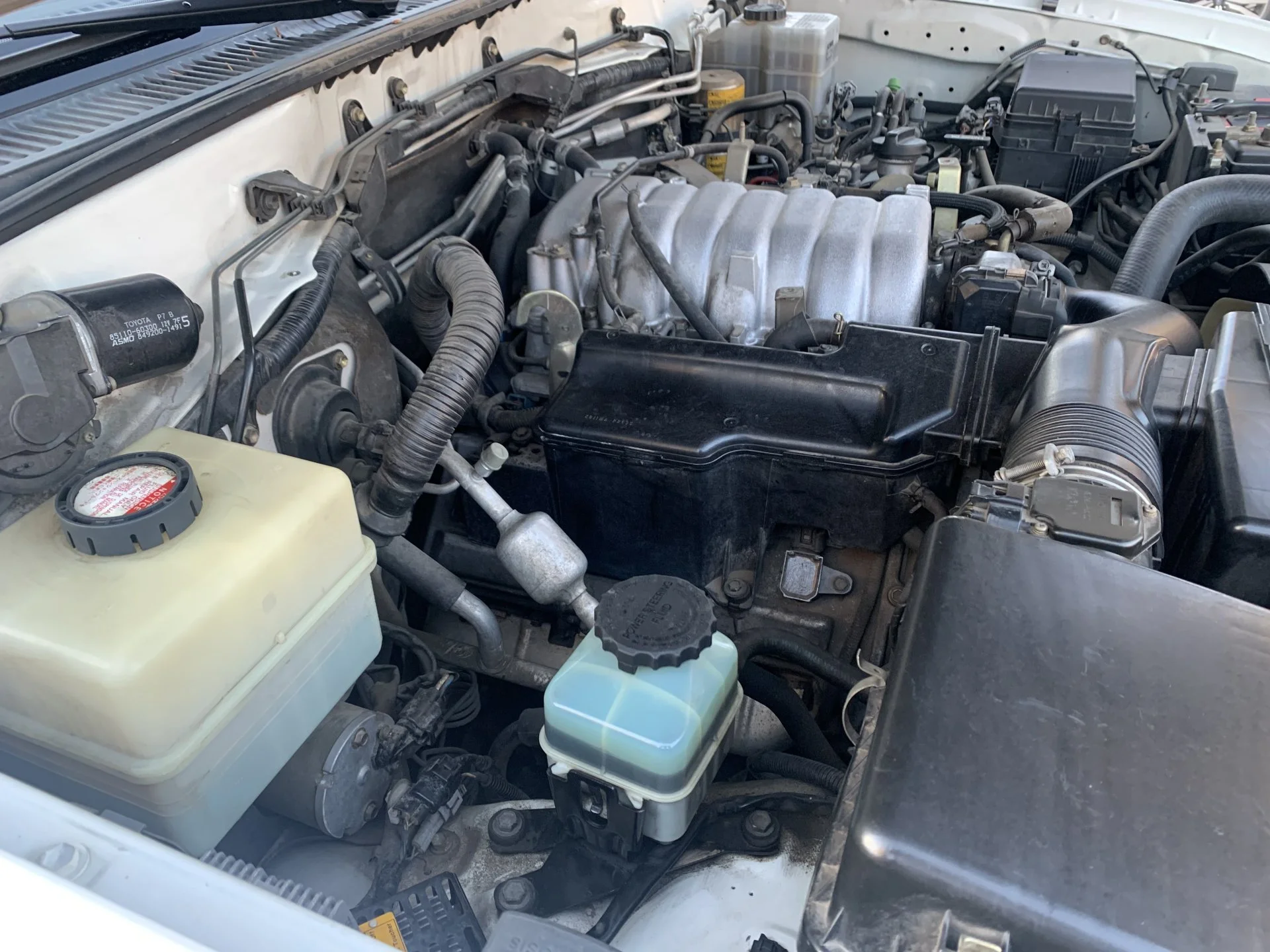

Nothing overly technical, maintenance wash, steam cleaned the engine, and ceramic coated the windshield.
What ceramic did you use for coating the glass?
Adam’s Graphene for glass, way less streaky than all purpose ceramic. It permeates the pores and flashes very quickly, used it on my Mach 1 about a month ago with good results.

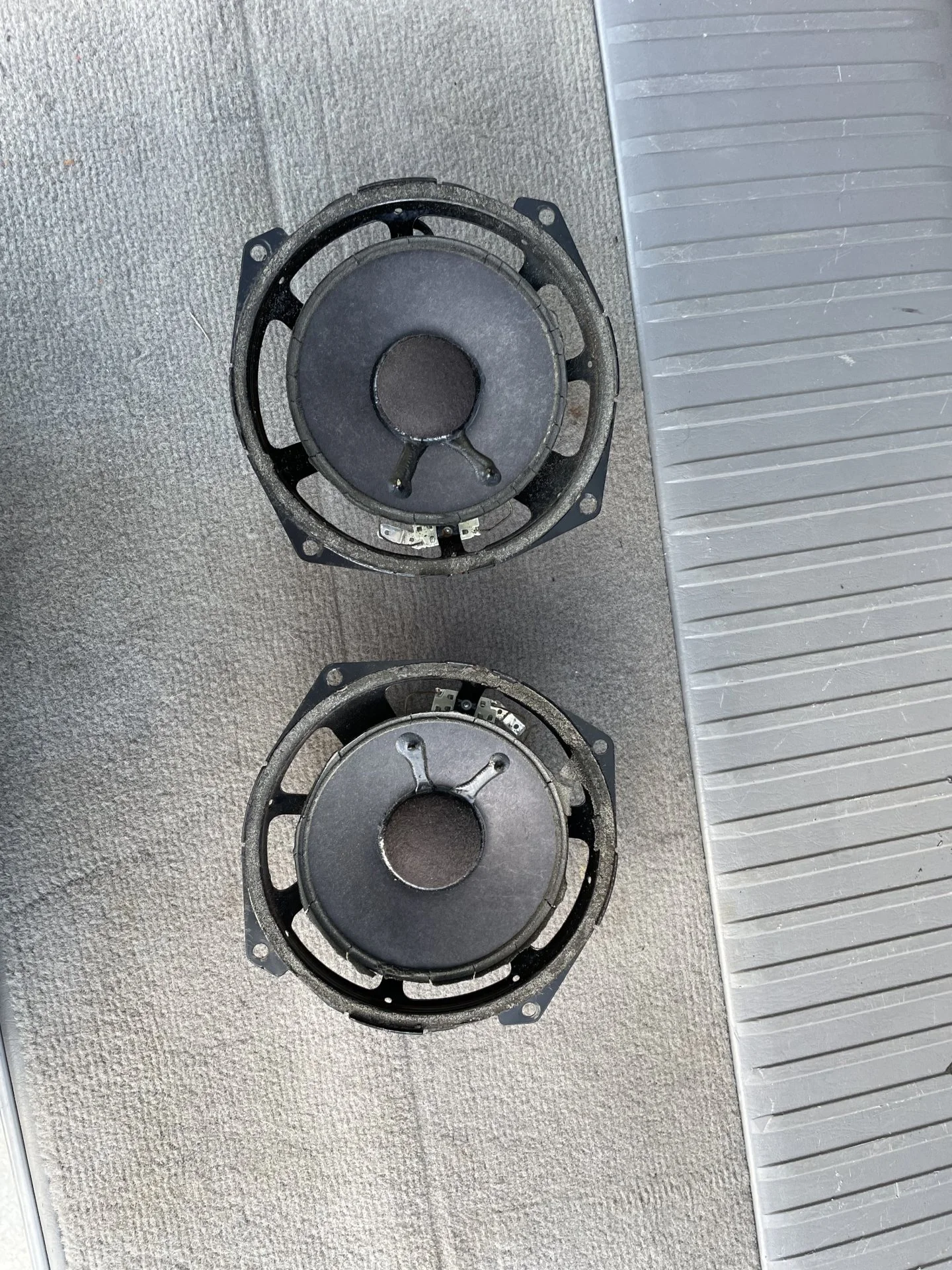

Finally got the two front door speakers replaced. Took a oriole liner than planned with the little one running off to dig holes with the tools. But I think it’s safe to say my speakers were in need of replacing. The rears are going to look the same when I get to them.

engine bay pics?
Just did a quick job, stayed away from electrical components. I’ll use APC and a brush this weekend to get the rest.
Looks like the engine wiring harness, from the firewall to the engine, has popped loose from the retaining clip/ hanger
Good looking out, I’ll take a look.

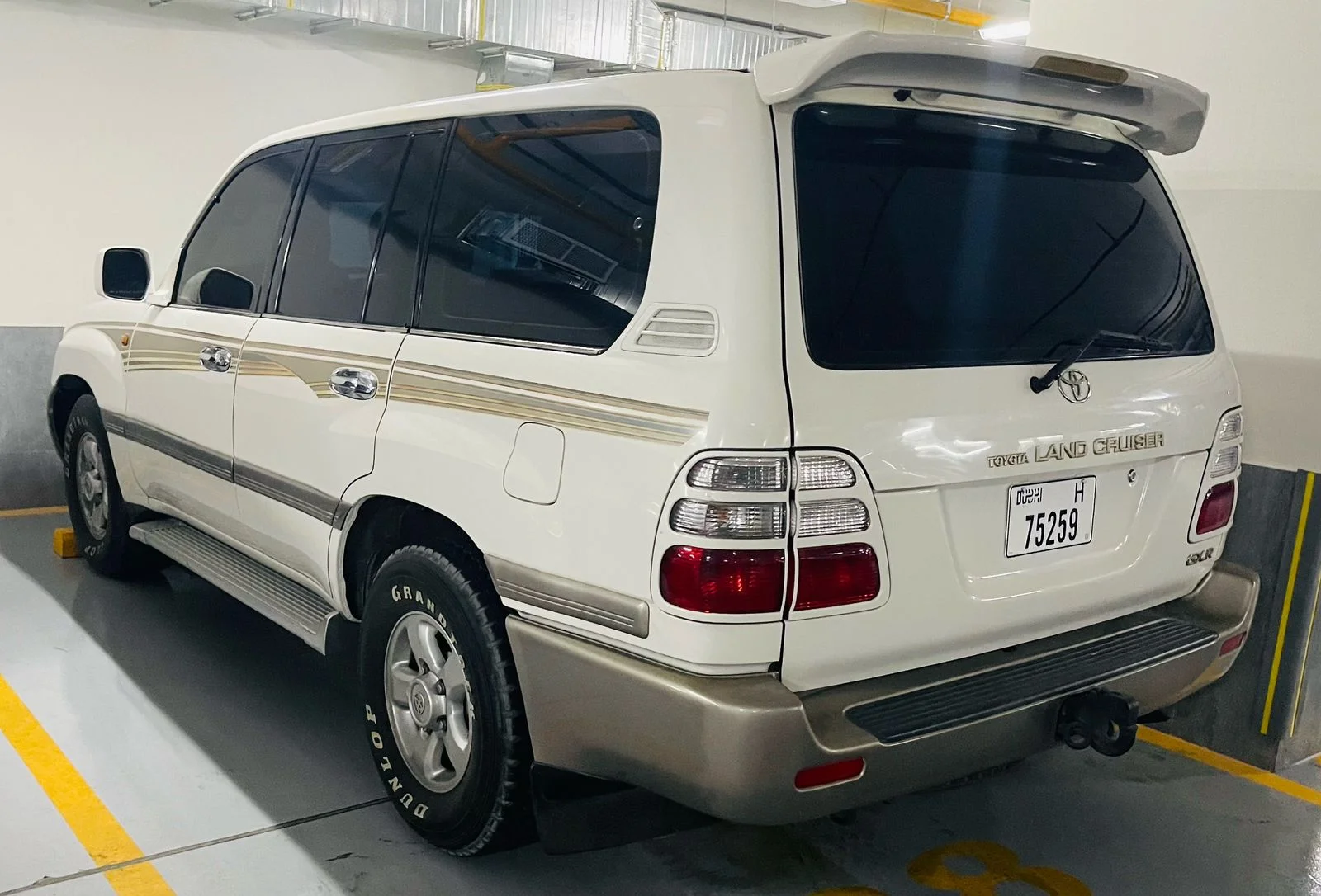

Just bought FZJ100 last week (09/1999). Observed some torque steer, replaced front lower arms, rear upper and lower link rod bushes, now drives fine. Left axle boot was leaking, replaced both left and right ones. The valve cover seal was busted and oil was leaking, replaced. New PS reservoir and hose, spark plugs, air filter the regular oil/filter change. Exterior and interior cleaning and polishing.
