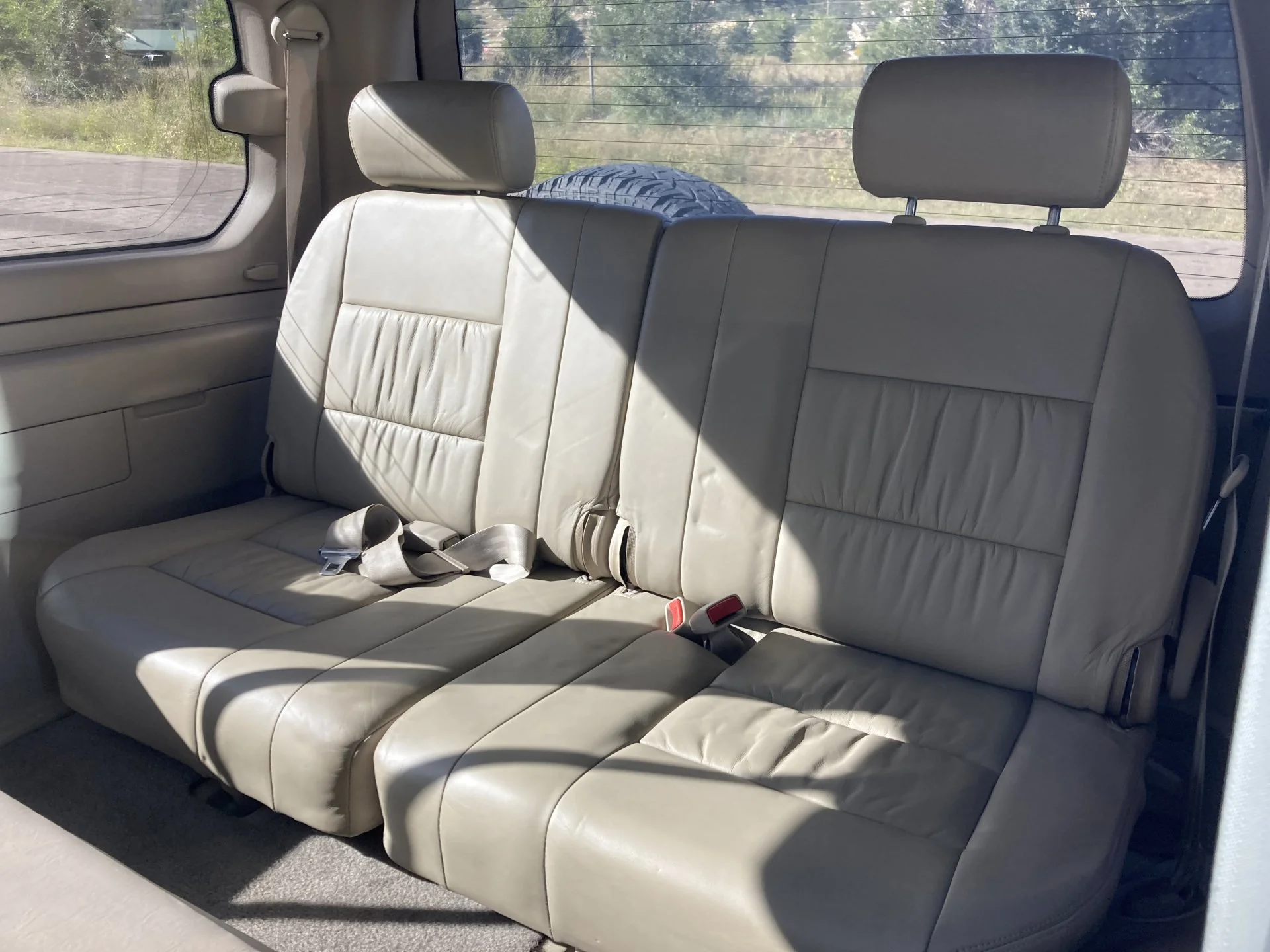

Me and the boys put in the third row seat brackets and from parts I received from a fellow forum member. Finally can use the Land Cruiser as I had envisioned. We hauled the whole family to church tonight. Good thing we have some little ones yet. There is not a lot of foot room in the third row! The kids gave it a rave review though.
Really only two things left to do. I need to get skid plates and rock sliders. Then we’ll be good to go!
I’m 6’1 and occasionally enjoy the third row… with the second row seats folded 😂

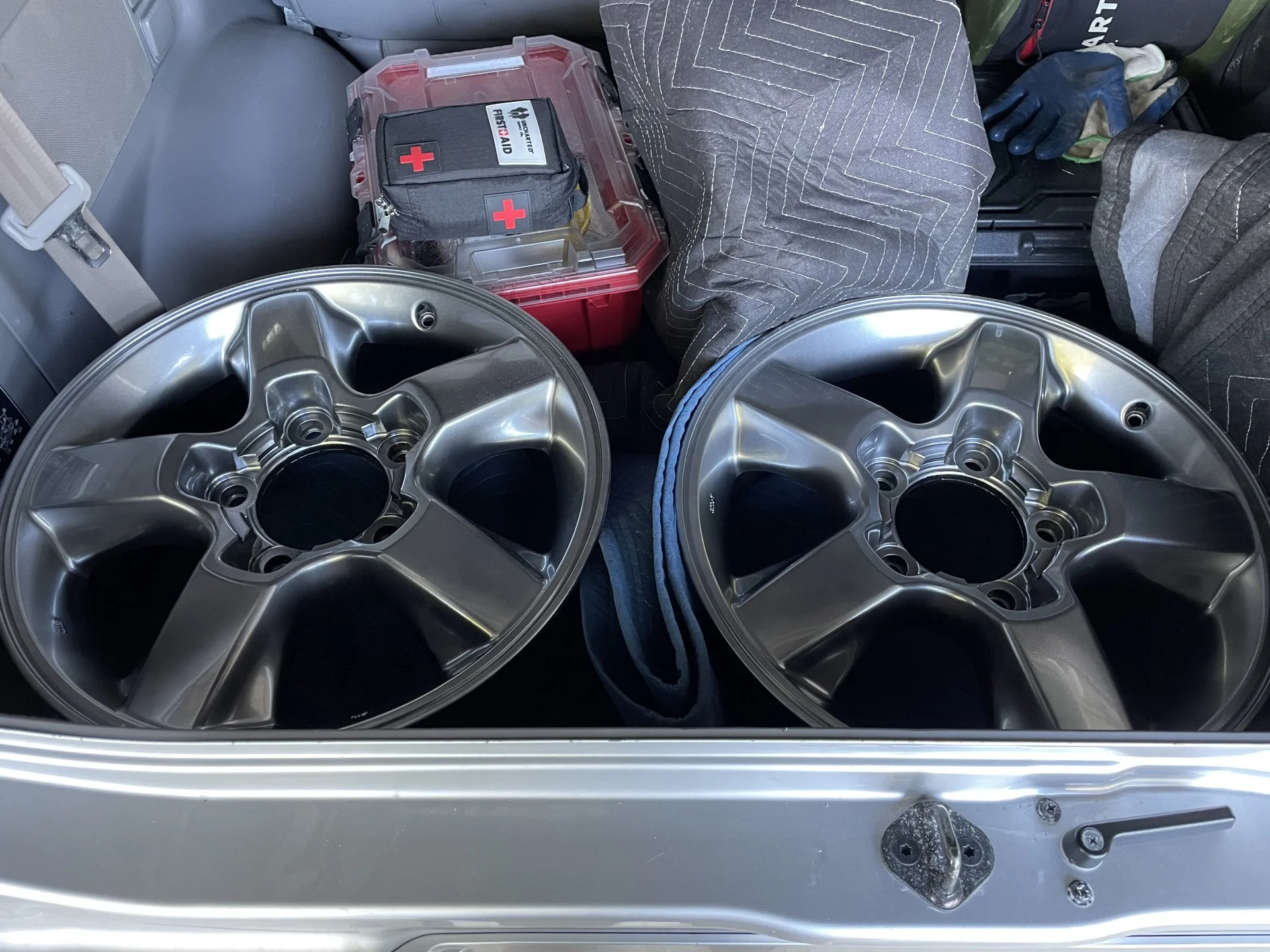

Not much action, but did have a set of LC wheels refinished that I plan to install at some point on my LX.
Before
After
Did you replace the rivets or paint them on the wheels. I have the same setup.. was thinking of spraying each rivet black...
On the wheels? I removed the bolts in order and stuck them on card board. Sanded and sprayed black. I didn’t paint the washers. I replaced back in order so I didn’t have to rebalance. Otherwise, on a tundra/Tacoma forum people needed to get thicker washers to accommodate aftermarket black bolts.

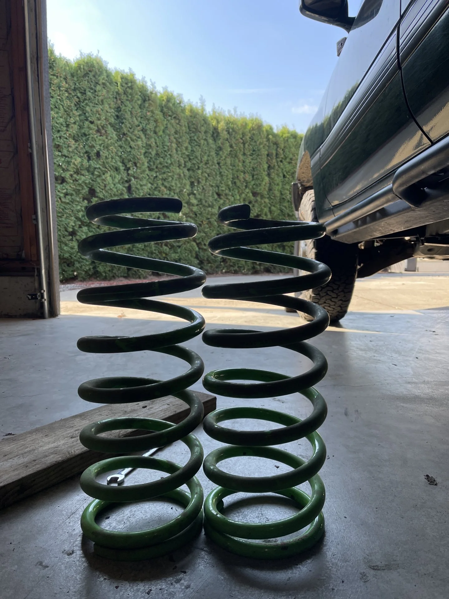

From the Ironman FAQ page:
Refer to completed installation form to measure and compare with new ride height. If a vehicle is leaning down on one corner, firstly ensure the vehicle is on level ground and then assess the weight distribution to ensure even placement of load and accessories.
Many vehicle models exhibit an uneven weight distribution from factory, Ironman 4×4 adjust the spring height accordingly to level the vehicle.
Check if springs are designated for Drivers Side (D/S) or Passengers Side (N/S) and ensure they are installed to the correct location. Typically the taller coils should be fitted to the heavier side of the vehicle.
Swapped the coils today, took me about an hour.
Apparently, the “P/S” which is stamped on the coil is slightly taller. I think this is because the fuel tank and passenger are on the “North American” side driver side.
This is one of my big annoyances with Ironman, their instructions are garbage and they didn’t bother to make separate ones for LHD / RHD.
I'm gonna let it settle after a few drives, but so far the driver side is just a 1/4" taller now instead of being off by 3/8".

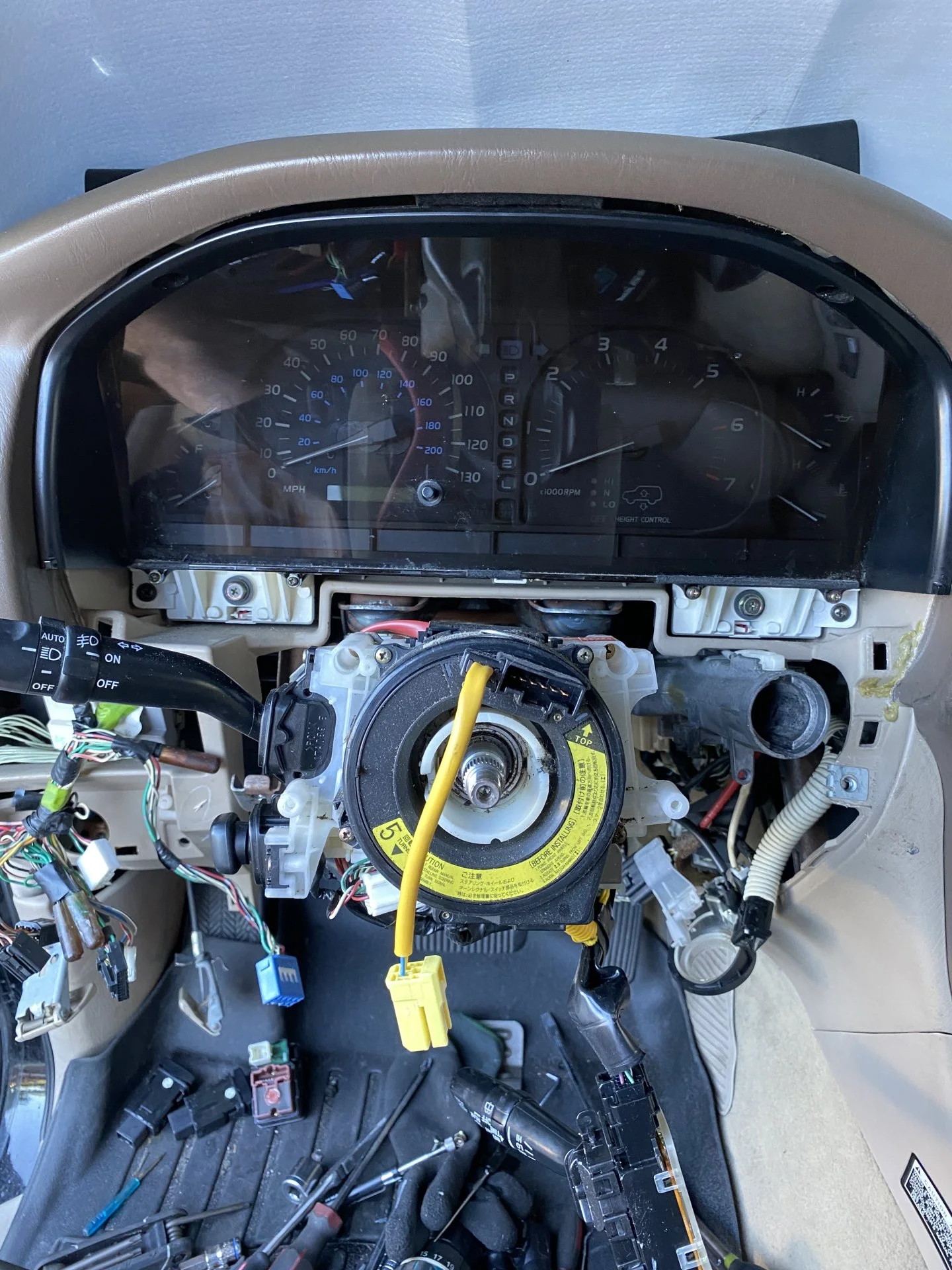

It ALMOST runs! Fixing some more PO surprises. I think the green painter's tape was a nice touch. You all better watch out, I might have to get more gas and damage something else before long.
I think you get the award for buying the worst truck but still sticking with it.
My wonderful mother says I’m too stubborn to know when to quit. Admit it though, you wish you had a green taped electrical fire under your dash. 🤣 I don’t want to say it too loud. But today feels like I turned a corner. Just hoping the light at the end of the tunnel is indeed daylight and not a freight train. Thank sweet baby Jesus! Now that I’ve blown my entire build budget on baselining back to zero. I’m a little lost as to what to do next. Thinking five bucks in gas to the liquor store might be the move.
