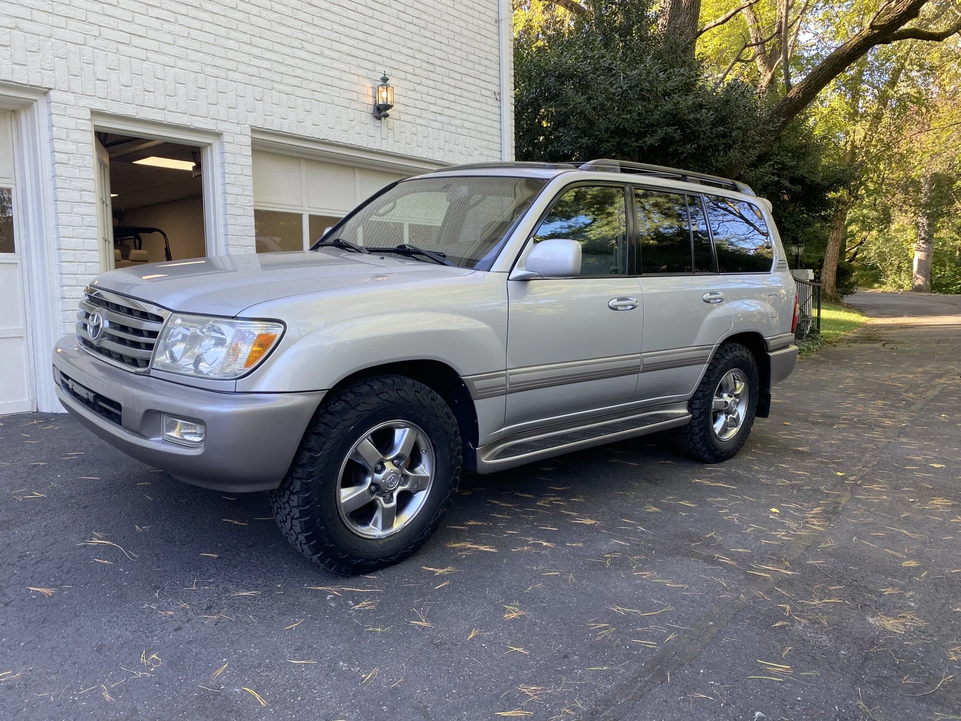

295/70R18 installed today. Did the pinch weld mod but haven’t messed w/ washer fluid cover or reformed the plastic in front of the pinch weld. No rubbing that I can feel/hear or see since driving ~30 miles day 1. Will keep an eye. For sure noticeably taller, thankfully. In high mode it looks awesome. Will likely adjust sensors once I have techstream up and running. Also have AHC fluid in route but taking forever to arrive. Ride is still great, so the posts I’ve read make sense to me now. A bit firmer but a good firm. Seems like the perfect size for the LX. I had 285/65R18 on my LC and they did seem a hair small.
Oh, finally finished the ARB bumper install too. That took a long time w/ just me and also having a newborn.
Lots of other little things I’ve done since purchasing last month. More to come. So happy to be back in a 100.

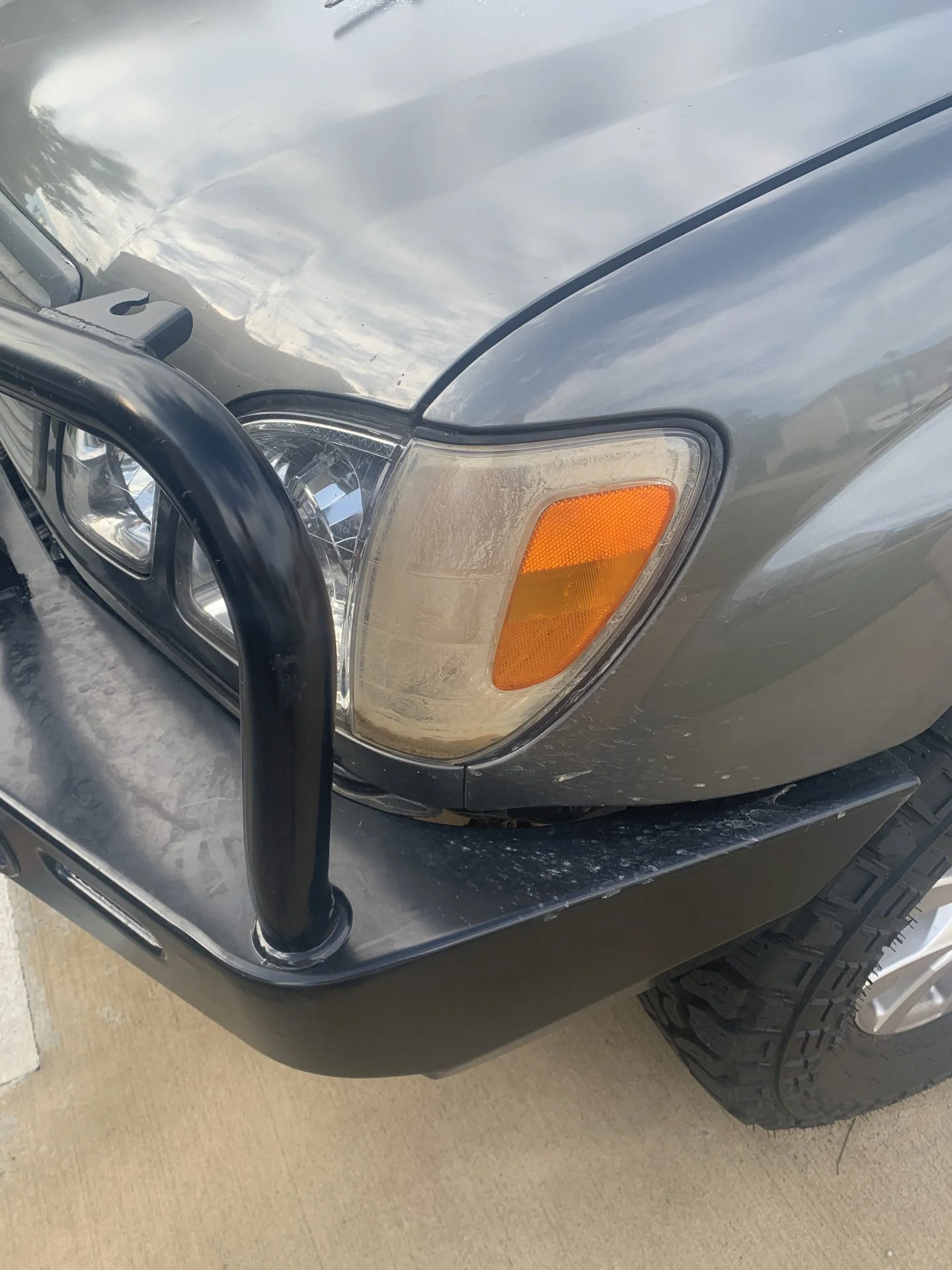

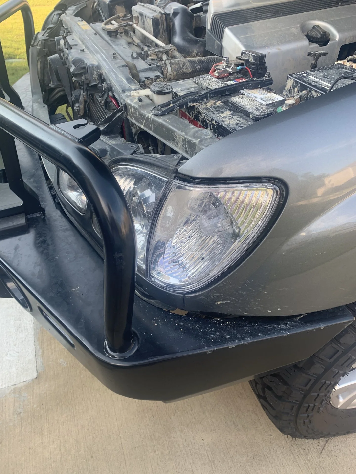

IF those are the cheap Chinese corners, I recommend you spray them with a clear UV protection paint. Otherwise they will be yellow and foggy in 18 months. Ask me how I know...
How do you know so much? Pics or it didn't happen. Please, sir.
