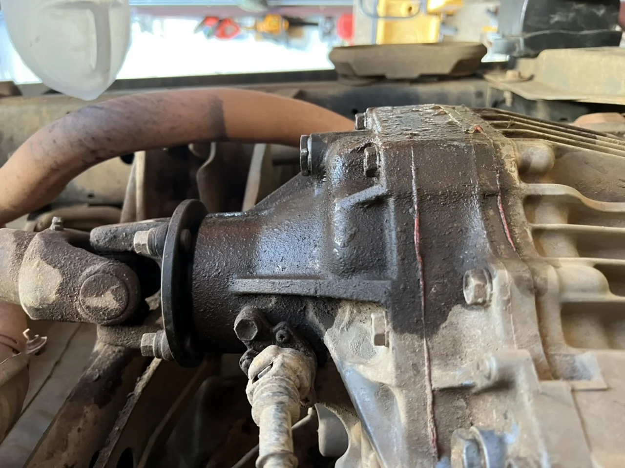

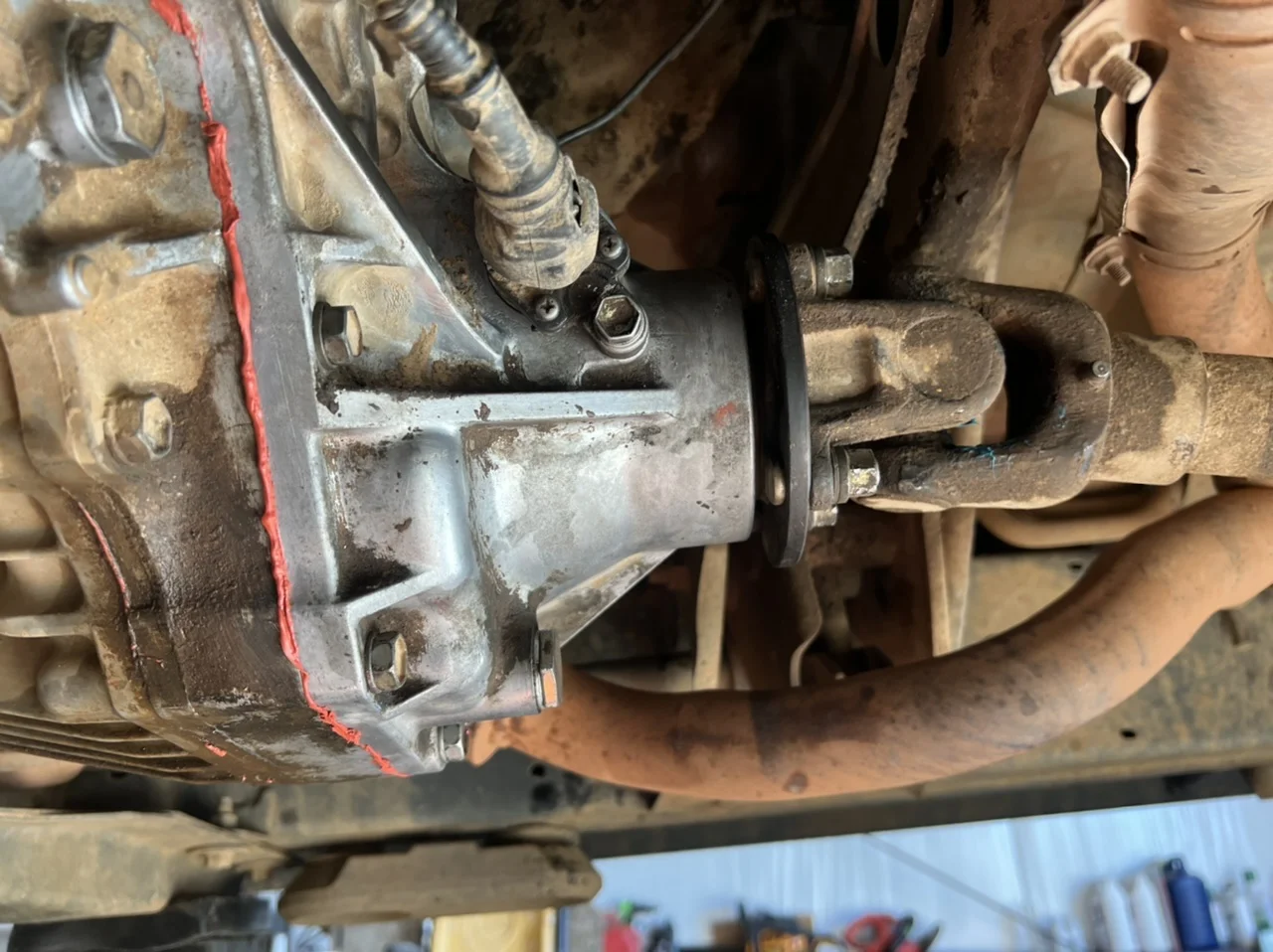

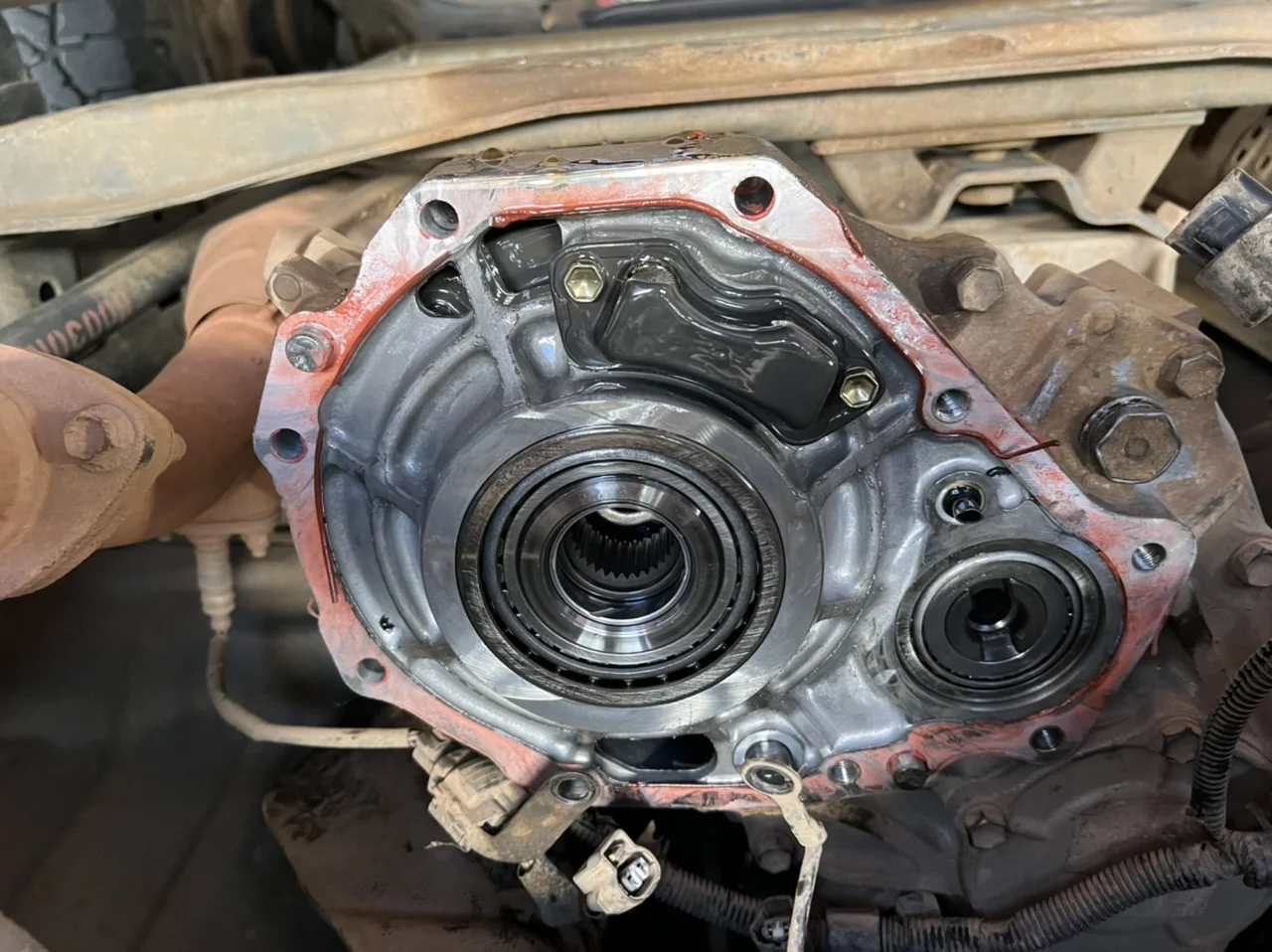

Replaced the rear output shaft seal and bearing. Much easier than the front, which I did two months ago (ran out of time to knock out the rear at the same time). It started leaking on return from the Ozarks a couple weeks ago. Greased everything up and changed all the gear oil as it was time.
That thing is absolutely clean as all get out. Shows what a little love and maintenance can do for you over the long run. Nice work!

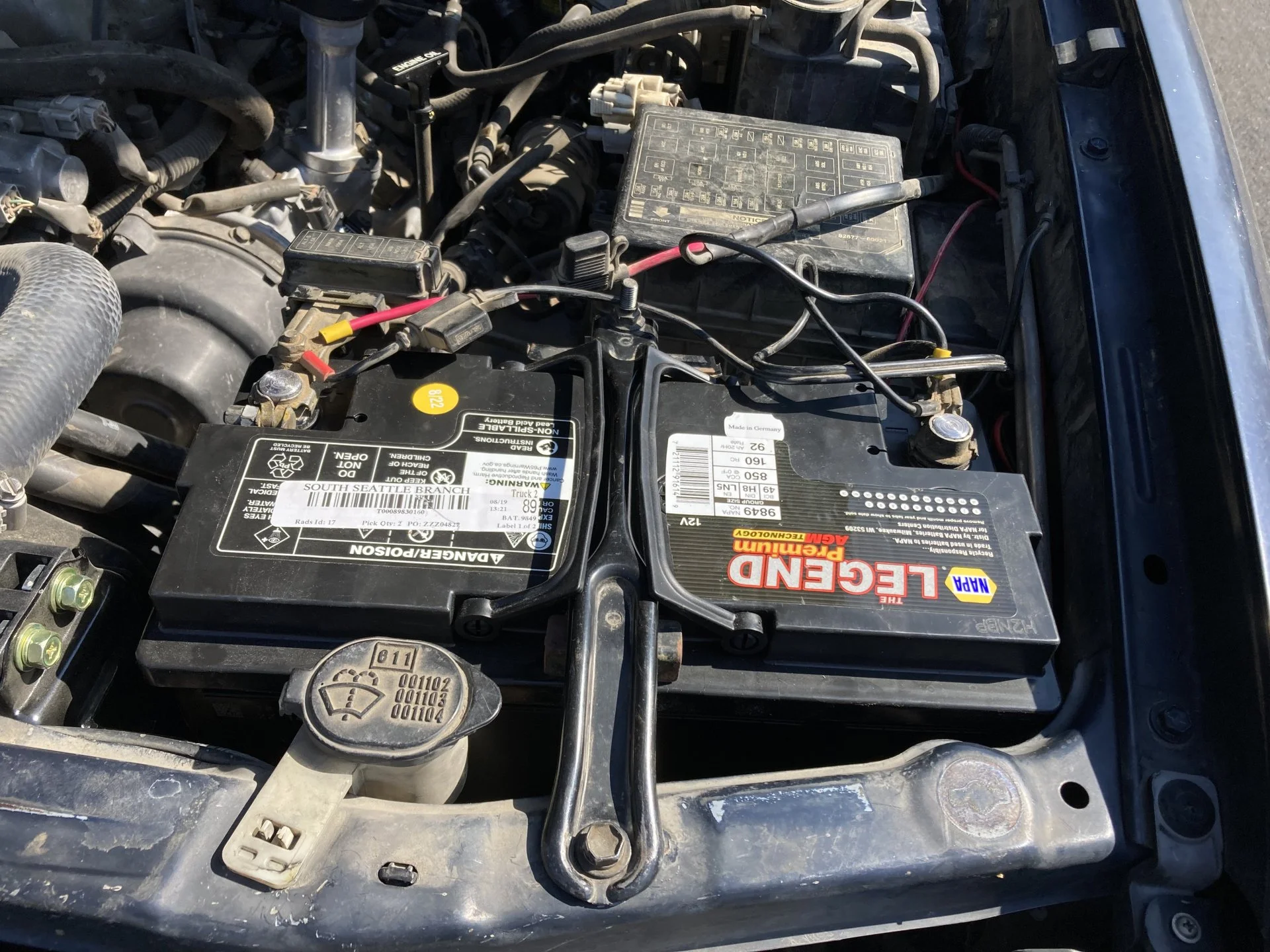

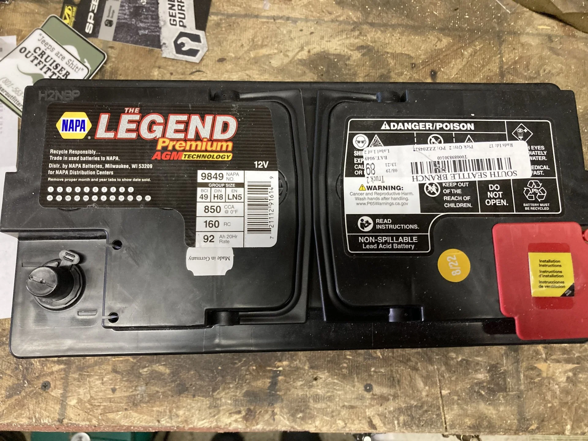

Replaced the Group 27F battery with a Group 49 AGM. Used a piece of 3/4 inch plywood as a tray spacer. The stock battery hold down is working fine.
This Group 49 AGM battery I bought form NAPA Auto Parts for about US$200.00 It is marked "Made in Germany" and the label says 92 amp hours.
View attachment 3118458View attachment 3118459
For what it's worth I am running the same battery, but went with this hold down. It didn't even cross my mind to raise up the battery.

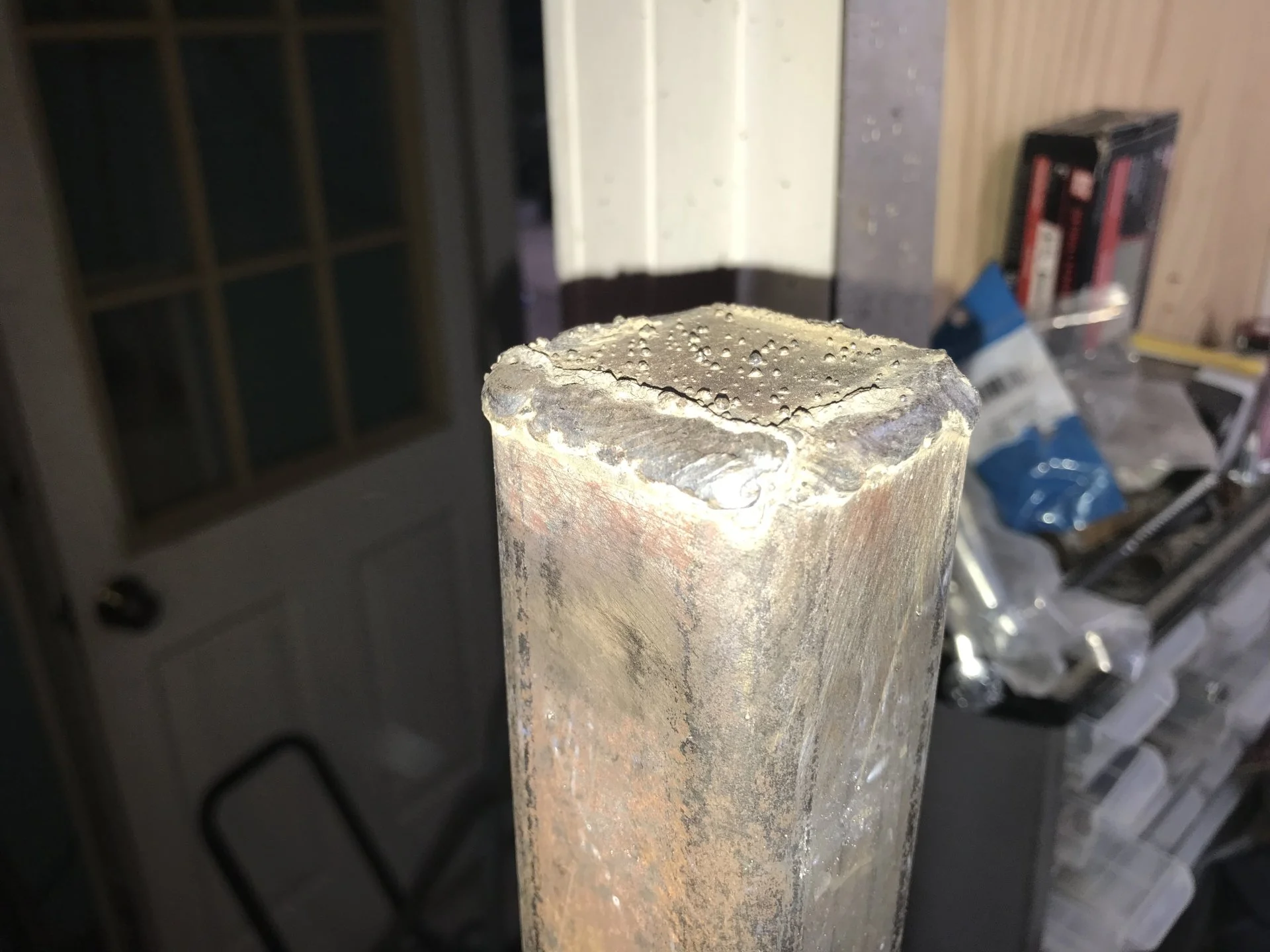

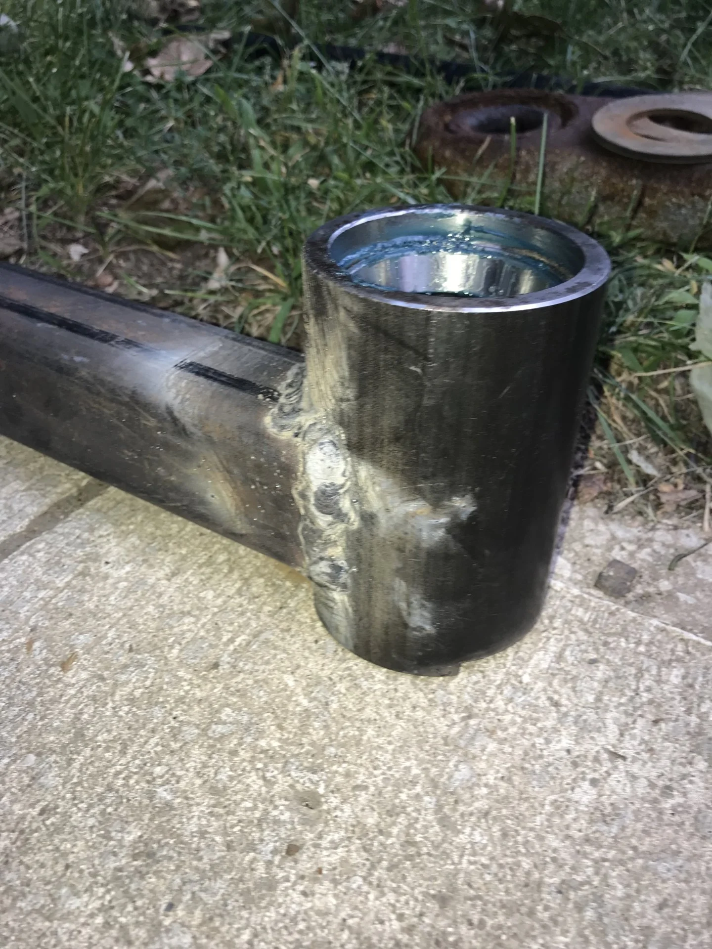

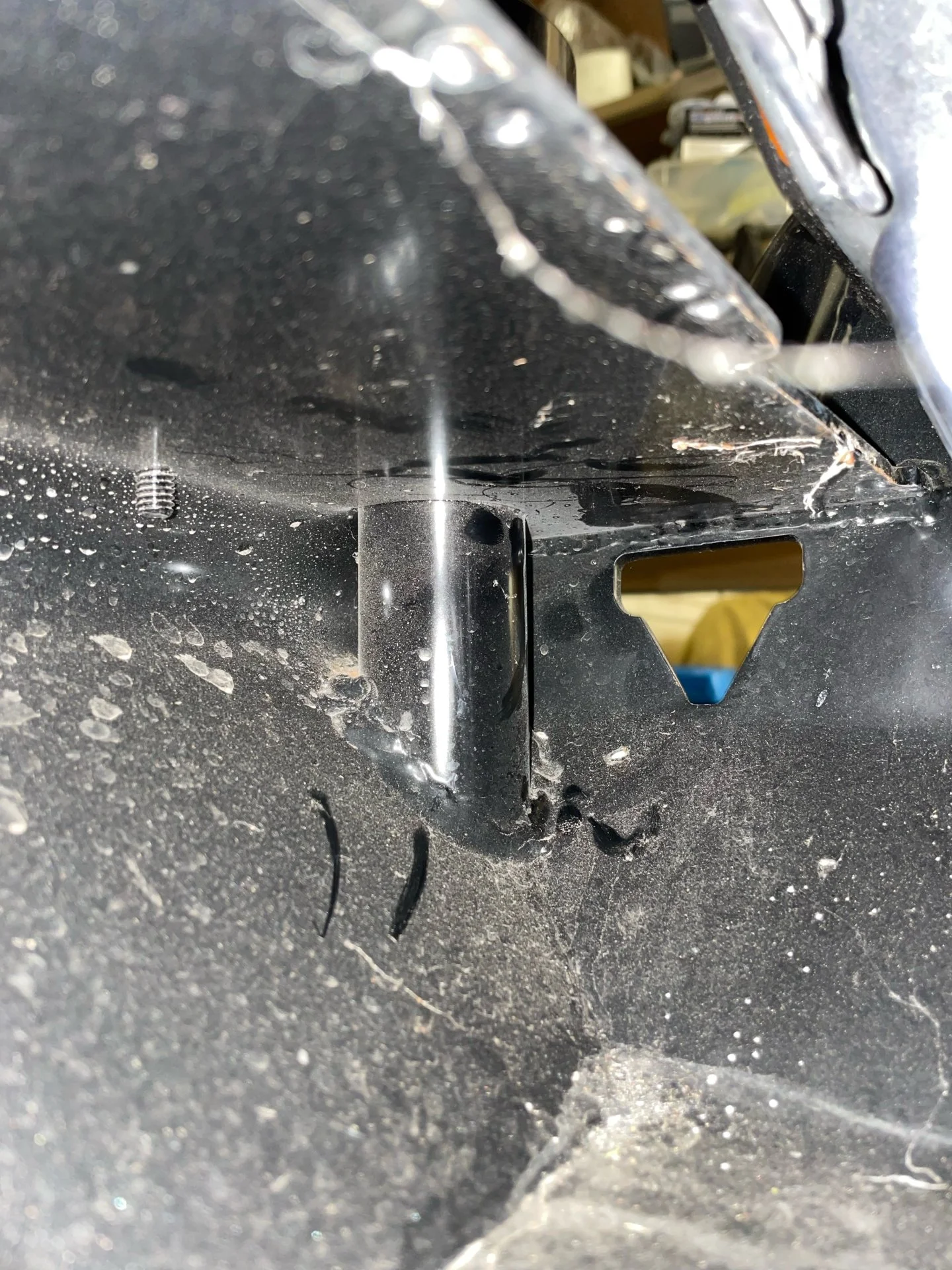

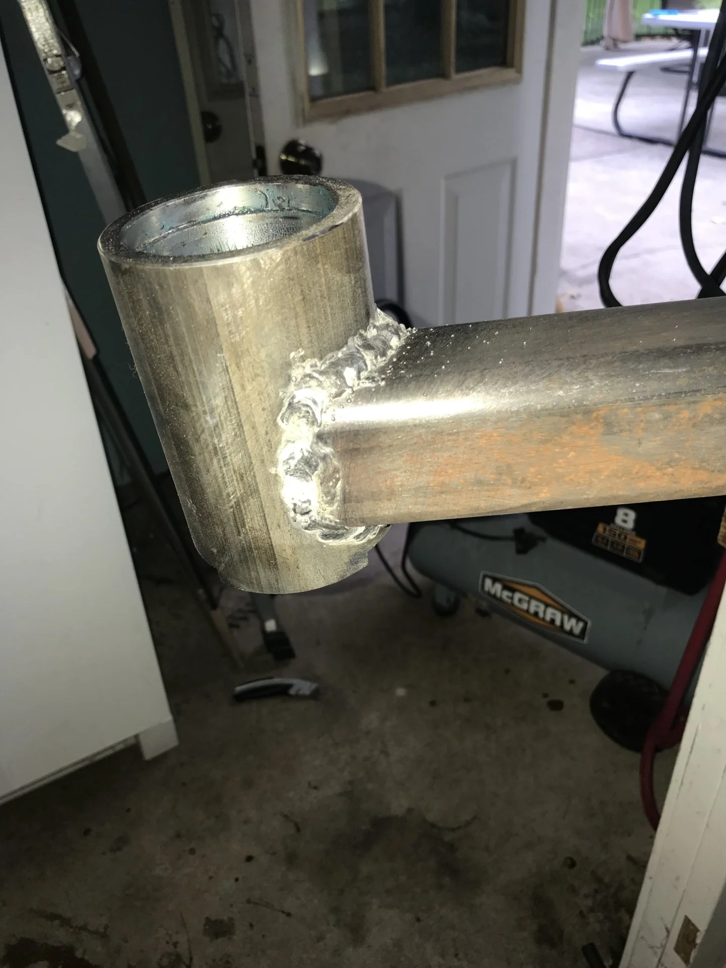

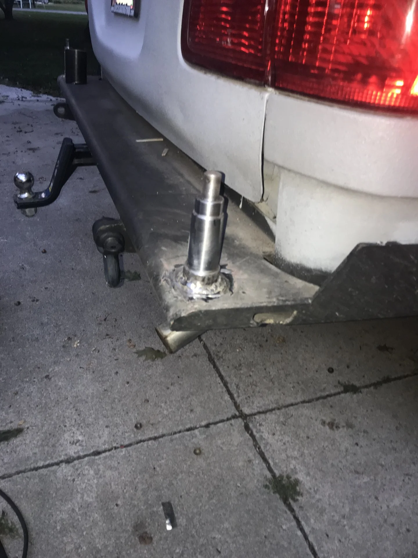

Were you able to weld the spindles within the bumper as well? That's how my 4x4labs bumper is and I think it's important for longevity and to prevent the spare tire from rocking fore and aft.
I did not, but the though occurred to me that the bottom of the spindle would be stronger if welded. Issue is that from the bottom once the spindle is in, there isn't any access to the bottom of the spindle. I suppose I could drill a hole and weld from beneath. Have any pics to share showing what you described?

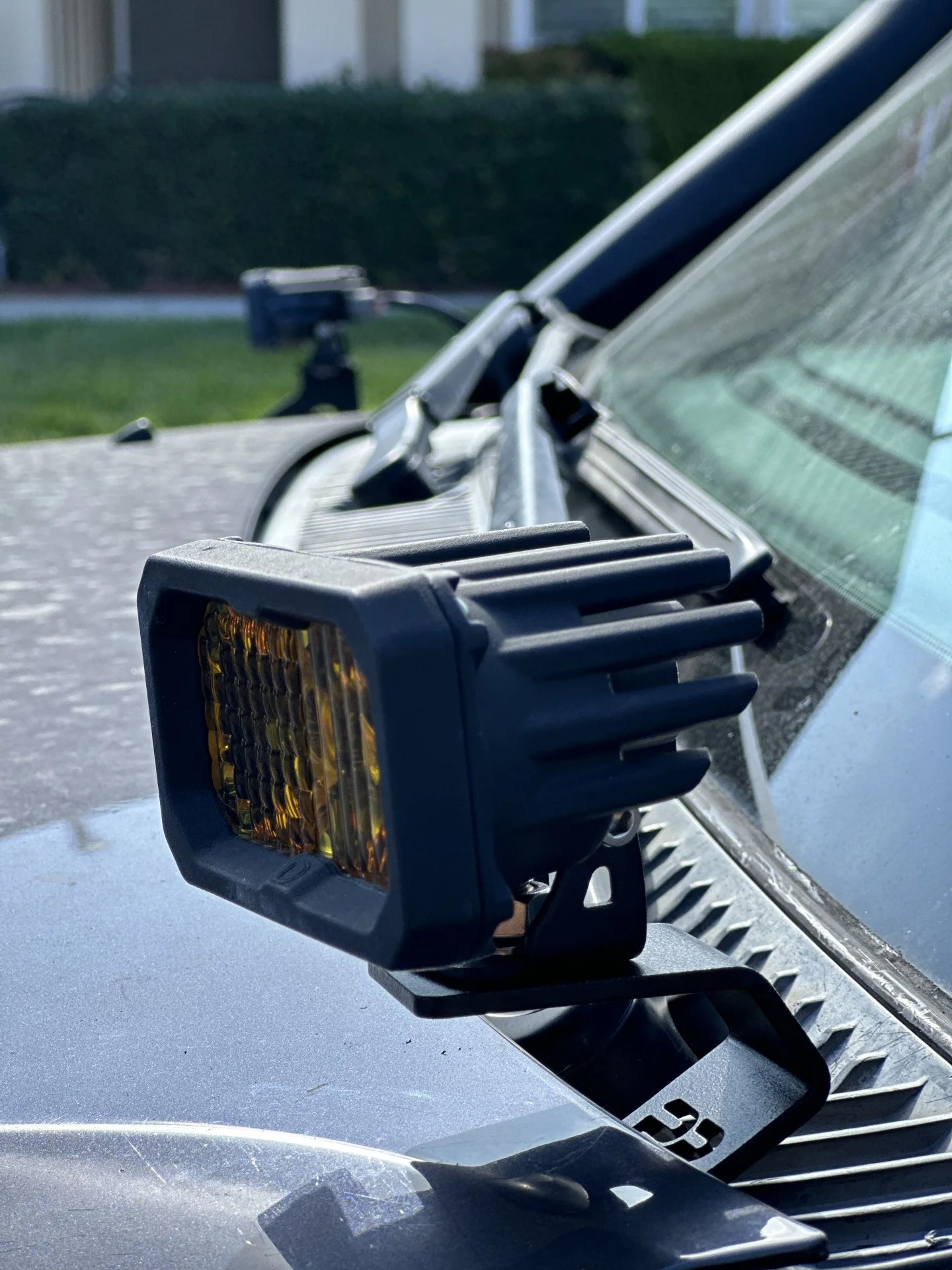

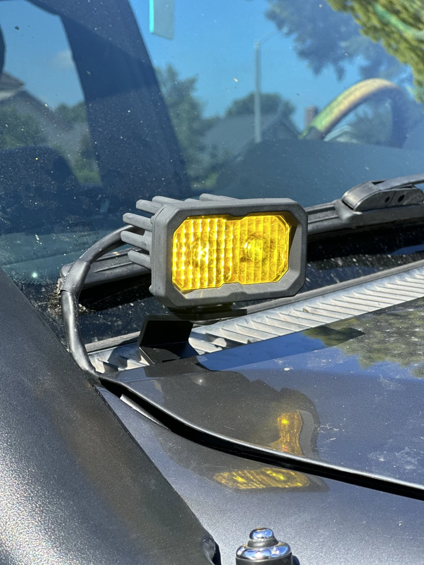

Installed some goodies from Trail Tailor.

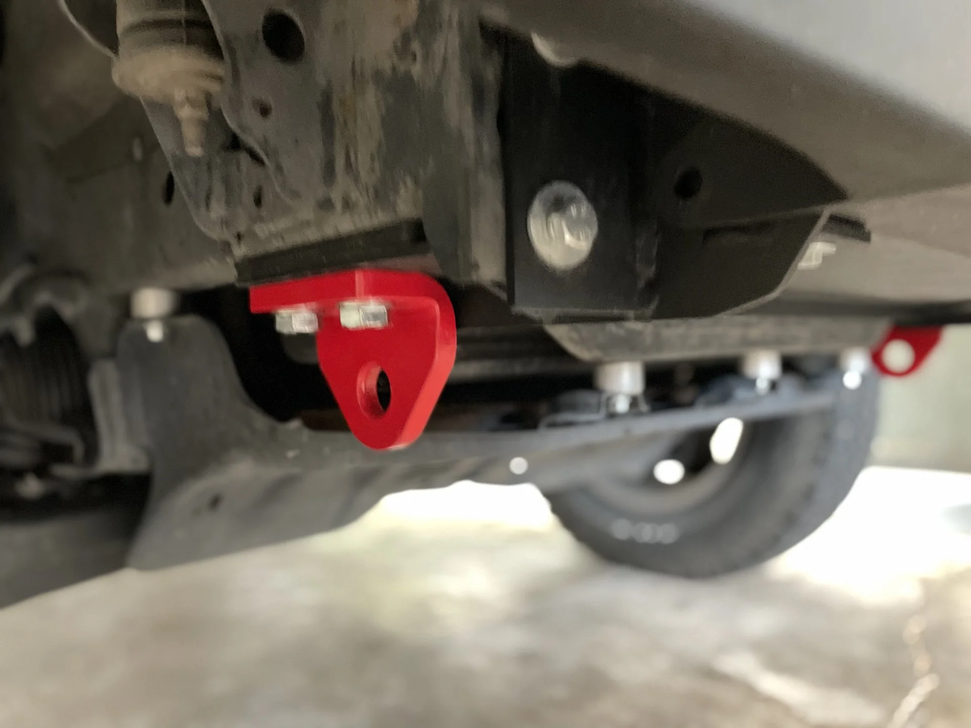

After a quick pull from a Taco last week ( blame the heater tee 👎) and having the tow strap fly off that stupid hook up front I went home and ordered the proper tow points. Soft Shackle Tow Points - 60 80 100 Series - https://trail-tailor.com/store/p95/Tow_Points_-_60_80_100_Series.html

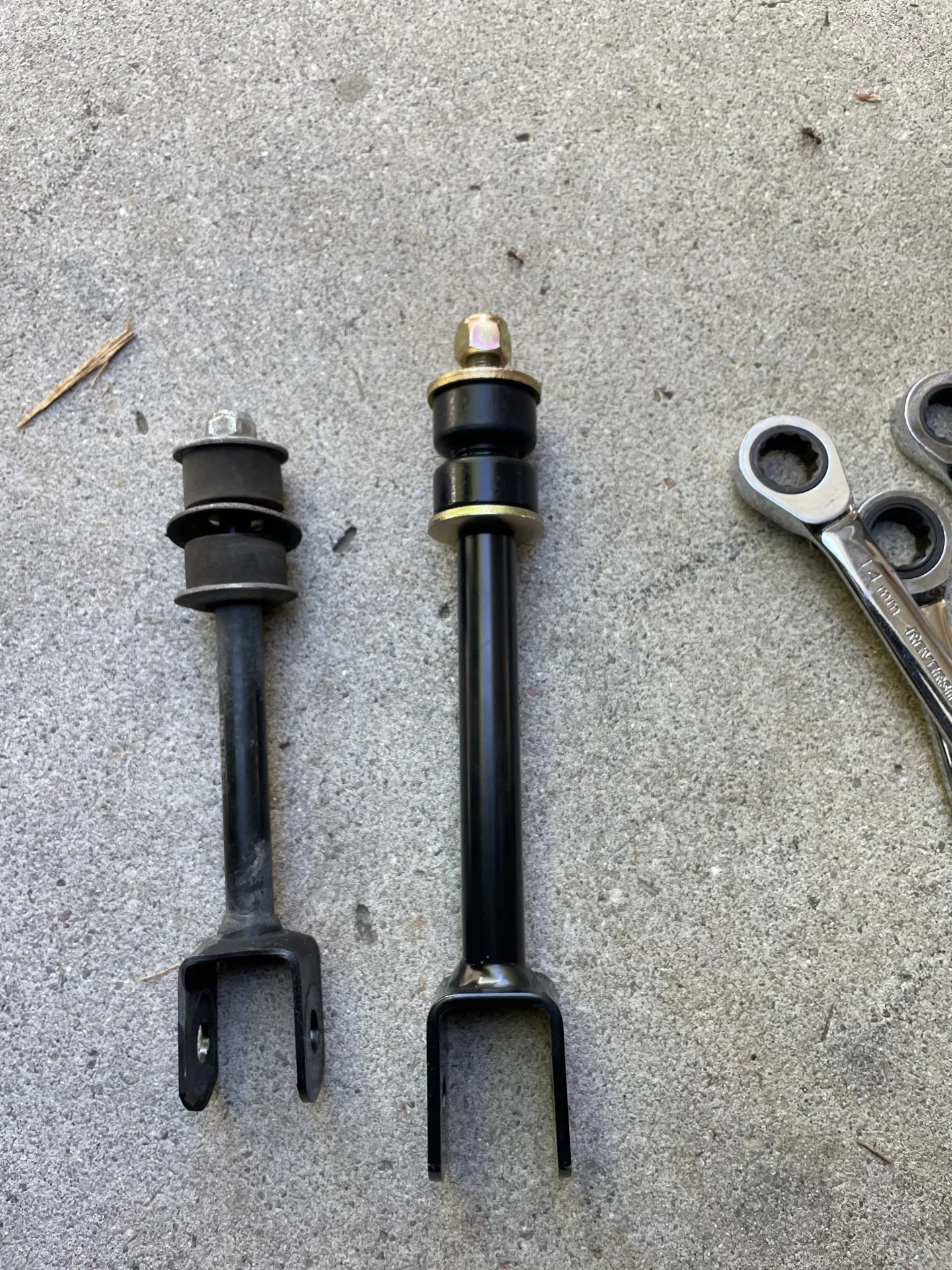

Since I was on the website, I had to find something else to buy. Sway bar link upgrade! Front and back now complete. Plus wife says the ride is better, so win – win. 👍

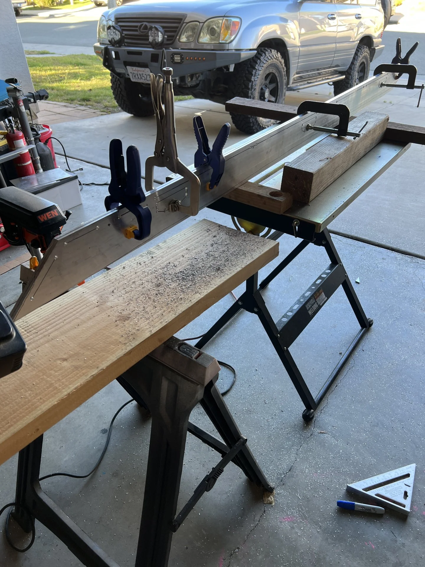

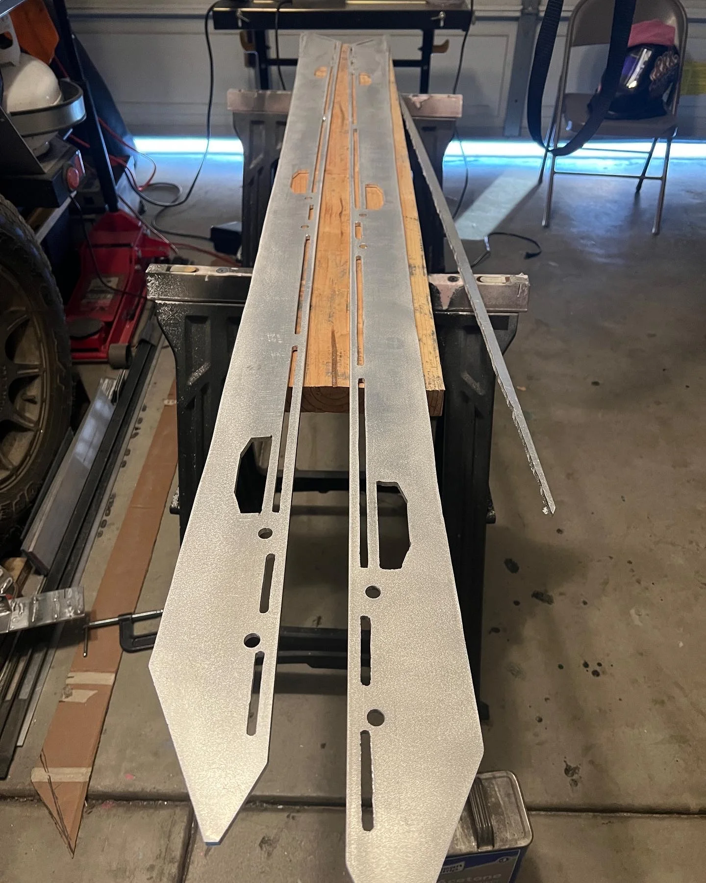

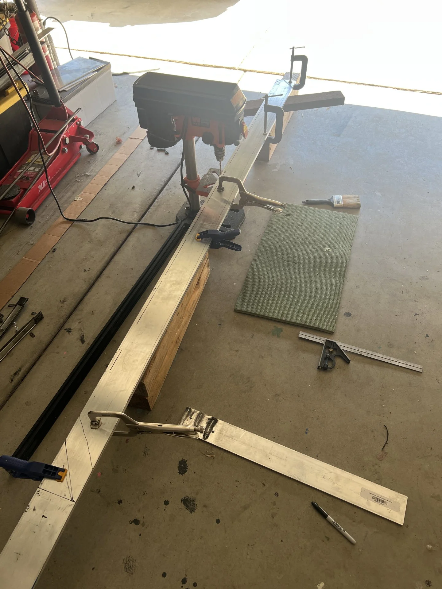

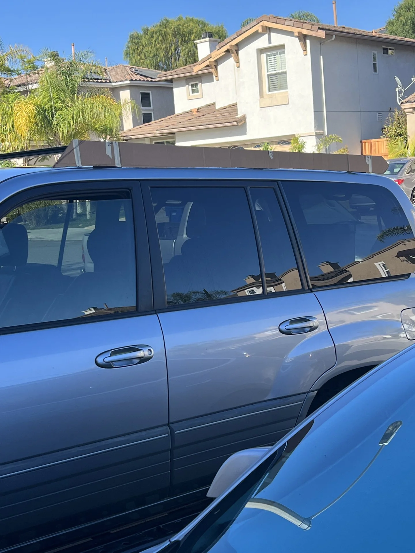

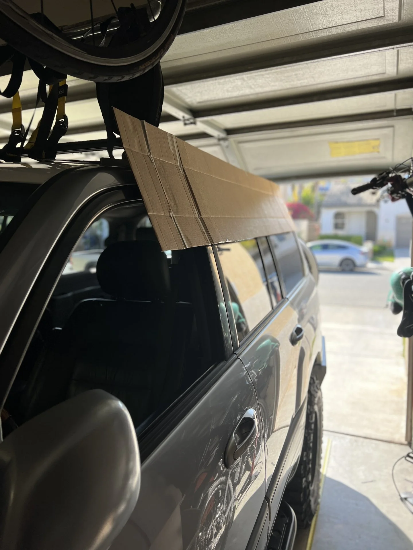

Found scrap aluminum at my metal supply shop sold by weight. 1/8” plate and 1/4” aluminum. Purchased Sherpa mounts with their ss hardware and t nuts extrusions. Had to do some tig welding to add more width to give the front more real estate for the roof curve.
I put a white wrap on the roof prior to starting. I think I’ll keep it raw.
I'm not a pro welder AT ALL, but those welds look pretty good for a $200 flux box from what I've seen. Nicely done. Have you welded much or are you getting into it?
Thanks, just learning as I go. I’ve built a front coastal off-road bumper and the 4x4labs rear bumper with just some final touches needed. Combined it’s a lot of welding (something like 8 spools of flux wire). Definitely have gotten more comfortable with the machine and welding in general, but definitely just learning to crawl in the world of welding.
