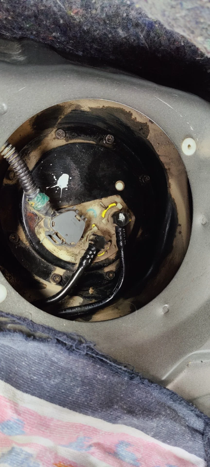

Replaced the fuel pump....lasted about 285k miles so no complaints. I started hearing the pump about a month ago, but I attributed the fact that I could hear it to many many miles on washboard dirt roads here in Wyoming...thought perhaps some insulators had vibrated out or degraded. About 3 weeks later, moved the truck out of the driveway and parked it. Went to move it back a few hours later and the truck would crank but not run. EFI fuse was clicking on/off. No codes. Surmised it was likely the fuel pump. Pulled the second row seats, pulled back the carpet to expose the fuel pump access door, and replaced the pump, filter, and gasket. Re-sealed unit in tank....truck started right up. Awesome You-tube instructions. Took me about 1.5 hours going slowly and checking my work against the You-tube video.

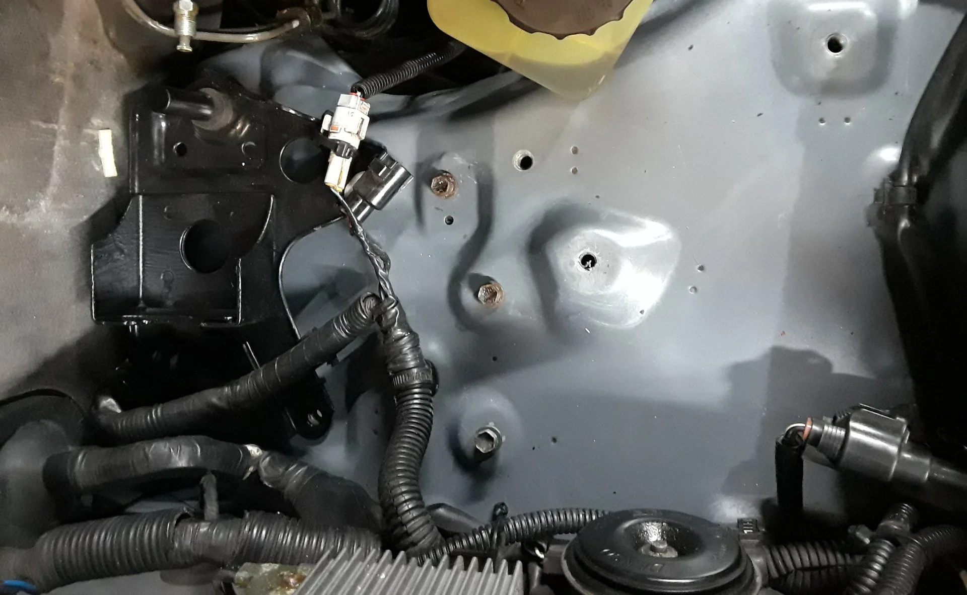

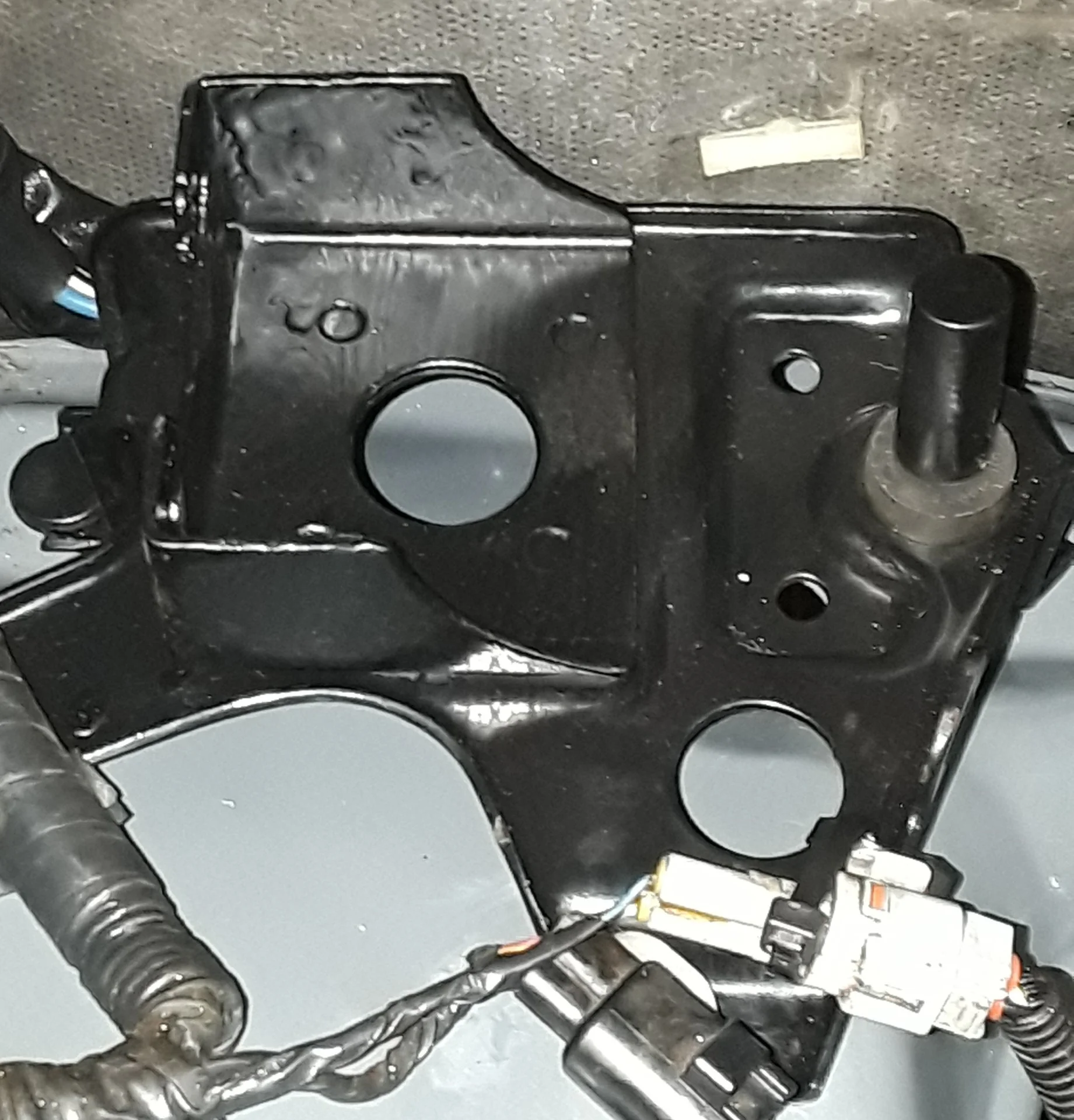

as part of the timing belt job, and in preperation for an active stereo system, i installed two type 94 agm batteries under the hood of my lx470. i modified the ahc pump bracket and turned a little "pillar" out of an upper control arm bolt to help support the battery tray i made from the case of an old dell computer. currently, the ps reservoir is zip tied to the a bracket bolted to the battery tray. i will likely mod the ps bracket and bolt it to my setup rather than relocating the reservoir as some have done. the batteries are wired in parallel. wiring is 0 gauge. a alternator distribution block sends a fused charging wire to each battery. the + parallel connection is fused on either end. each battery is separately grounded to the frame, the engine, and the alternator housing.

I really love a well wired engine bay...
*looks at mine... cries*
