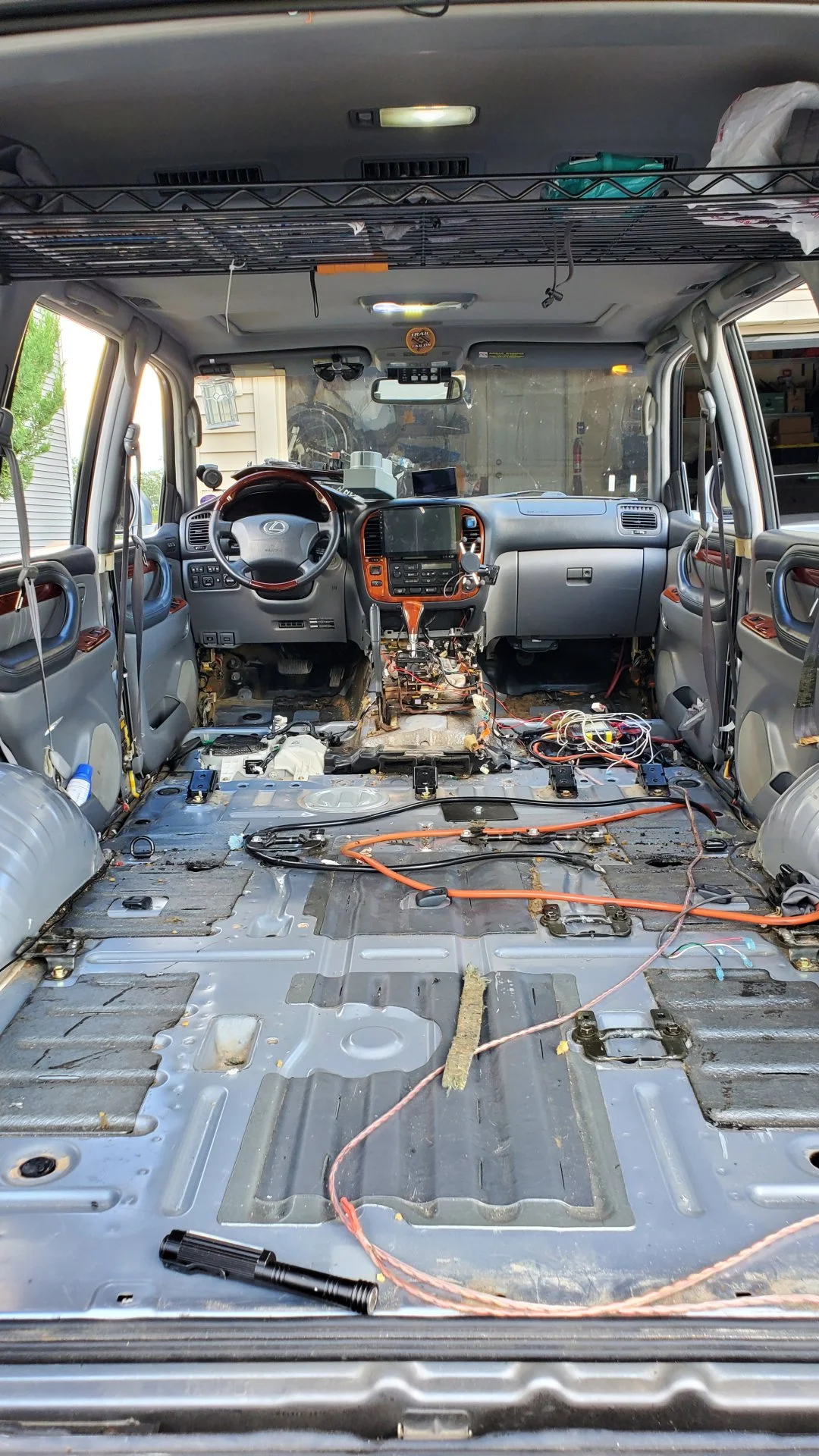

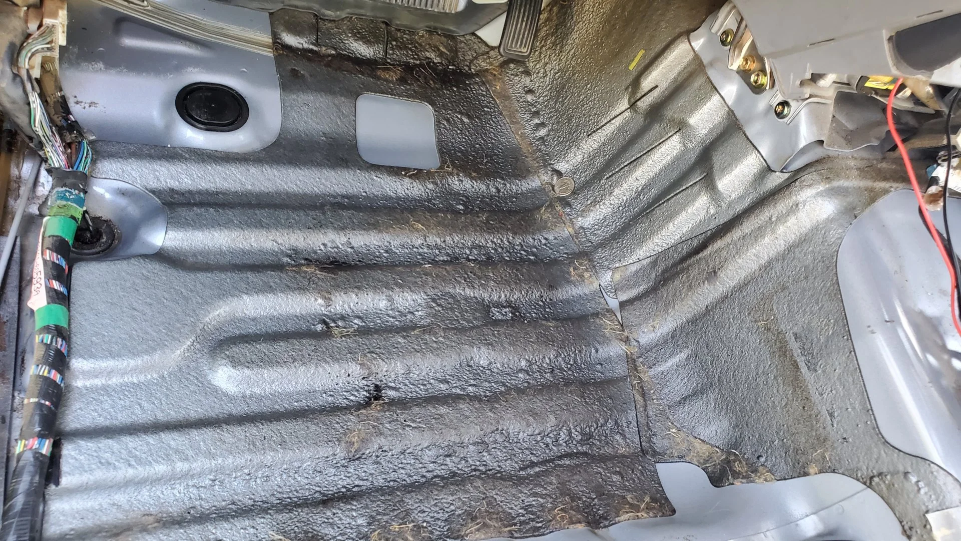

Once I sorted the crank-but-no-start issue, I started the next project on the list: add sound insulation to the floor. Interior came out easy and there were no surprises (no unwanted holes etc.). I am pleasantly surprised that the floor already has a lot of asphalt type layer applied. Is there any benefit to adding my own layer of butyl sound deadener on top of this?

Looking good! When I had my interior pulled apart I decided against adding any additional butyl sound deadener to the floor as it seemed pretty well covered. I did just pickup a bunch of MLV and some CCF that I might go back and add everywhere.

I am not sure about the aversion to putting down butyl or any of the sound-dampening products. We are not running race cars here so weight surely cannot be of any concern. And lastly, in the worst-case scenario should 110% of the deadener fail to keep out sound, there is always the lovely side effect of keeping excess heat out of the climate-controlled areas. I cannot even begin to consider myself to have any understanding of the ladies that would even consider associating with us, but I do know if you keep them from getting too warm they are in fact less volatile or dangerous. Kind of like avoiding feeding Gremlins after midnight you avoid destroying society or civilization by keeping them cool. Everyone wins at life. 🤷‍♂️

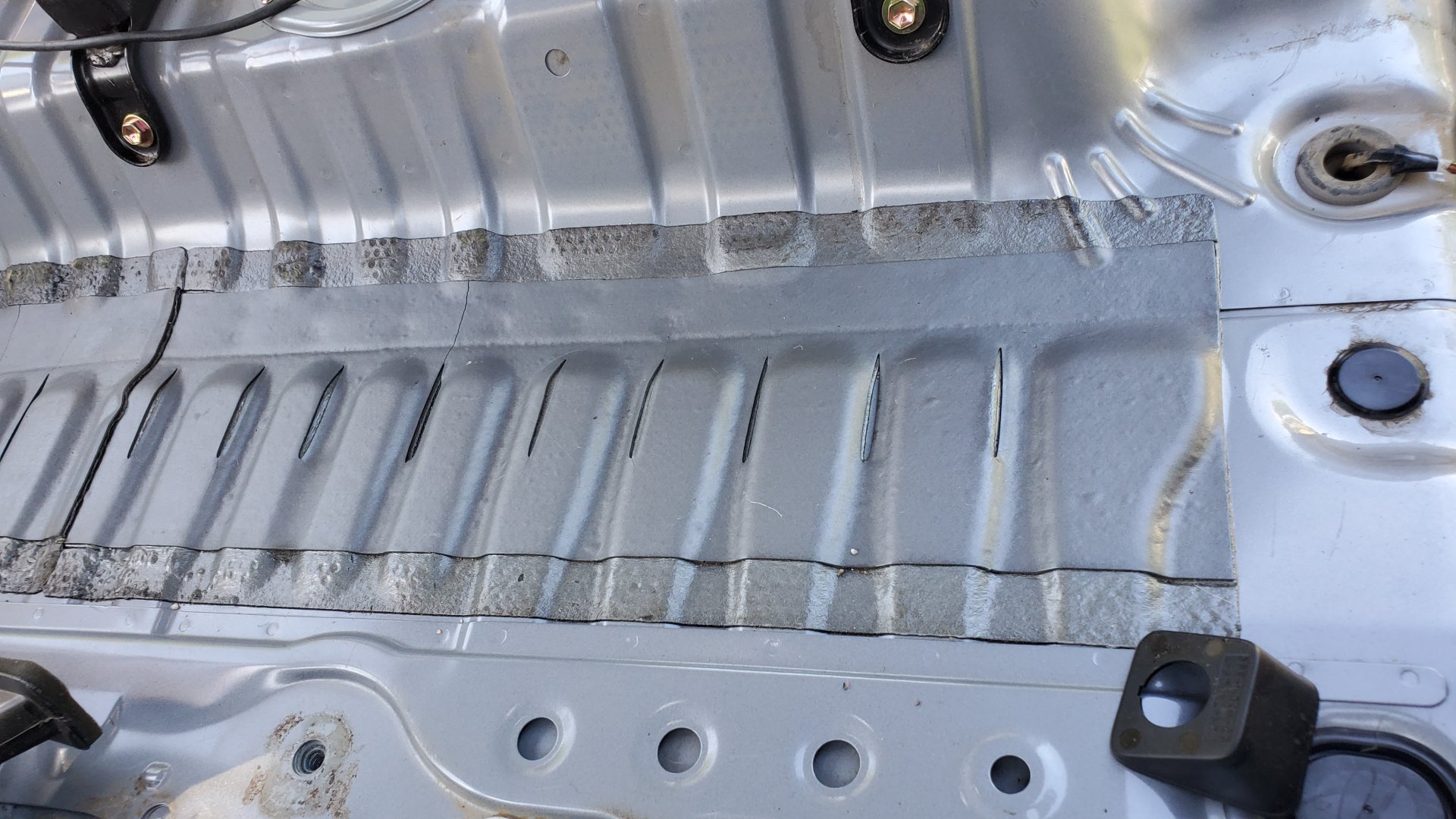

I did the full rear. In hindsight, just do the wheel wells and the outer layer of metal and you'll be good.

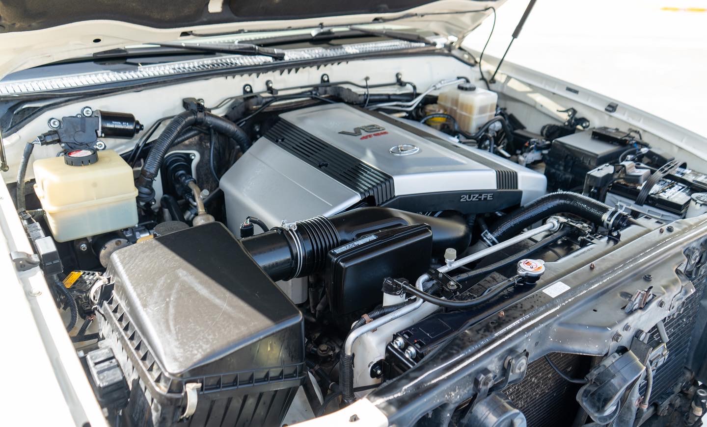

Replaced the fuse block (82720-60023) and the fusible link (82620-60010) in an effort to cure the crank but no start issue. That still didn't solve the issue! Then noticed the EFI relay is getting warm after a couple of longer cranks. Tapped on it a couple of times and wham! the truck started. Now I am looking for a replacement EFI relay (still looking for the part number!). Hopefully that will fix this issue for good.
You should've shown the SPAGHETTI Central, Where these puppies Came From inside the firewall....it looks so 'orderly' (& Deceivingly SIMPLE) from the top side!

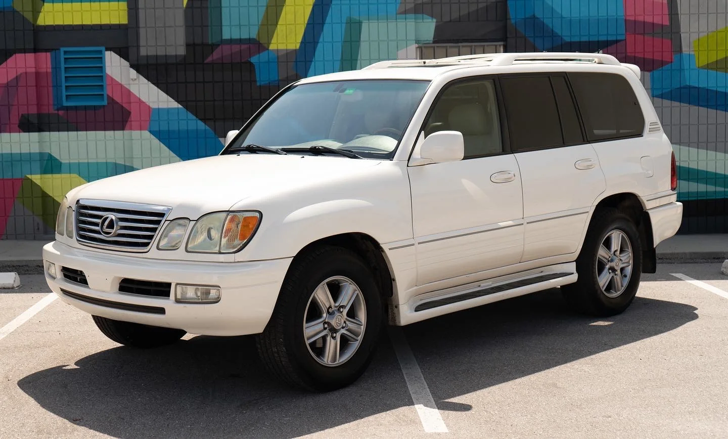

2006 Lexus LX470.
Can’t deny the elegance the LX470 brings to the automotive world.

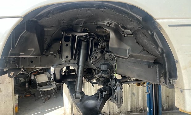

Our good friend Adam (@sammybones) trusted the family vehicle to Tampa Cruisers, to undergo a major maintenance session; a slipping transmission rebuilt, CV axles, steering rack, Radiator, tie rod ends, full brake overhaul and one of our favorite services, undercarriage and wheel-wells restoration.
She’s feels like is 2006 again.
Good old times.
Manny @ Tampa Cruisers.
