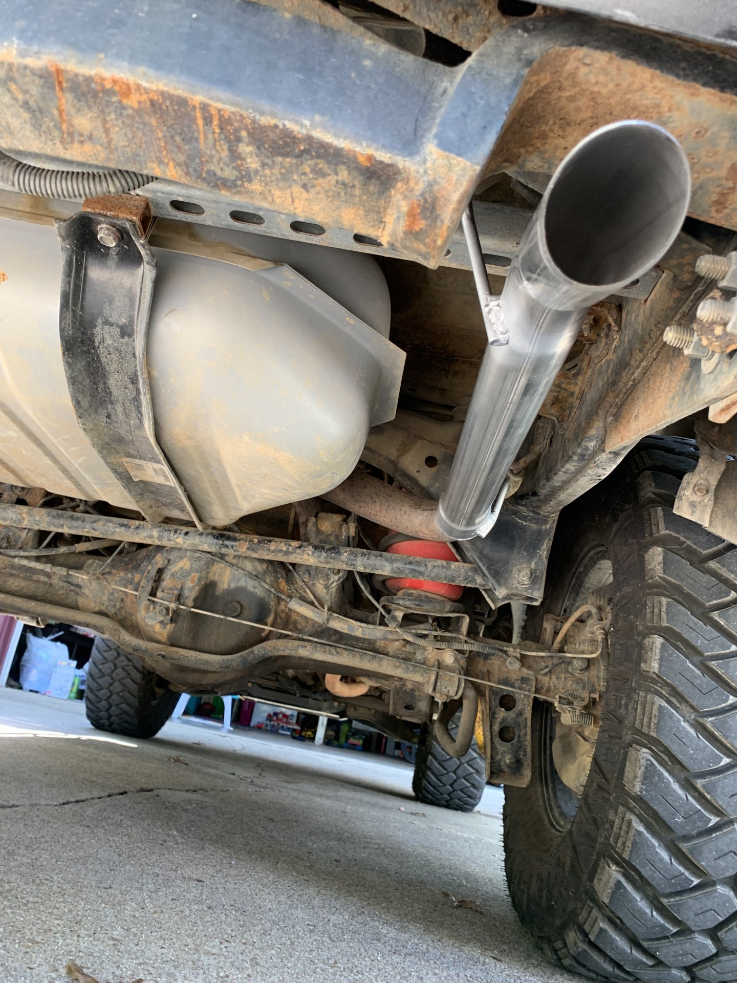

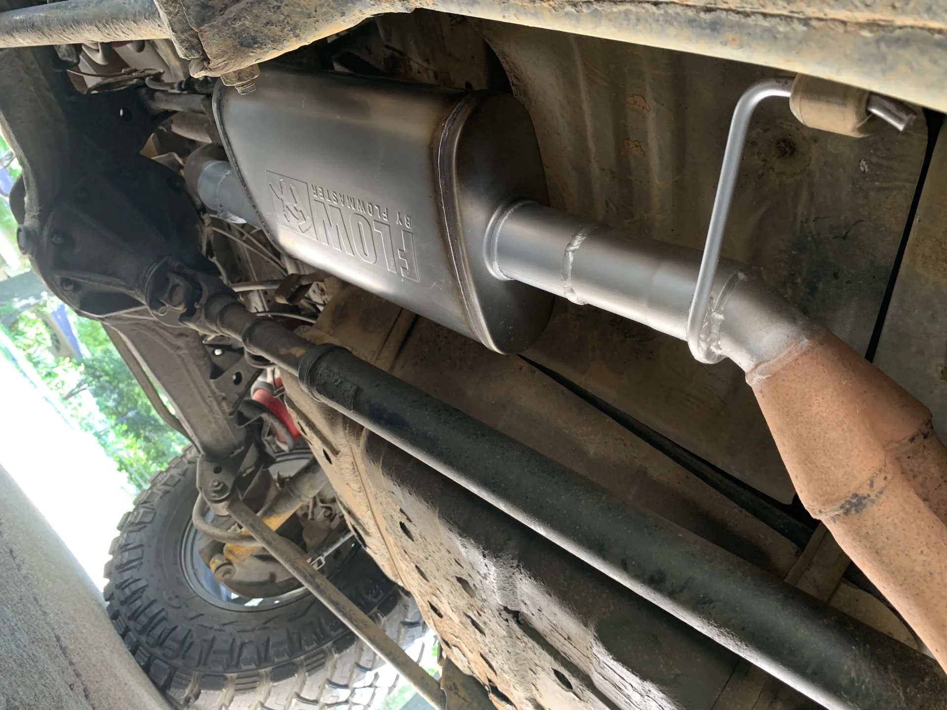

Yesterday I had a muffler installed. First time I’ve let anyone else work on the 100, they did great. Sounds perfect.

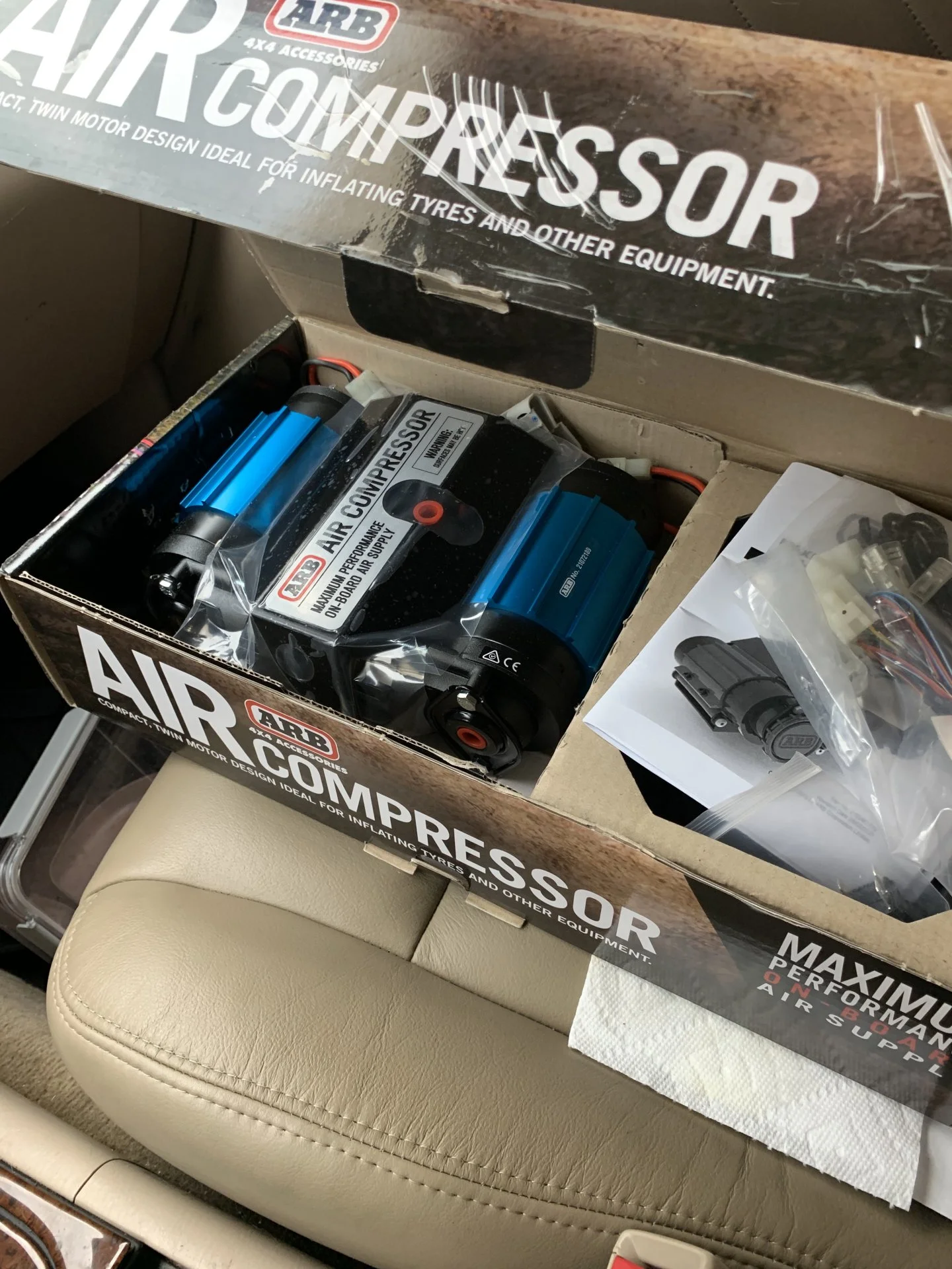

Also got my compressor in the mail.

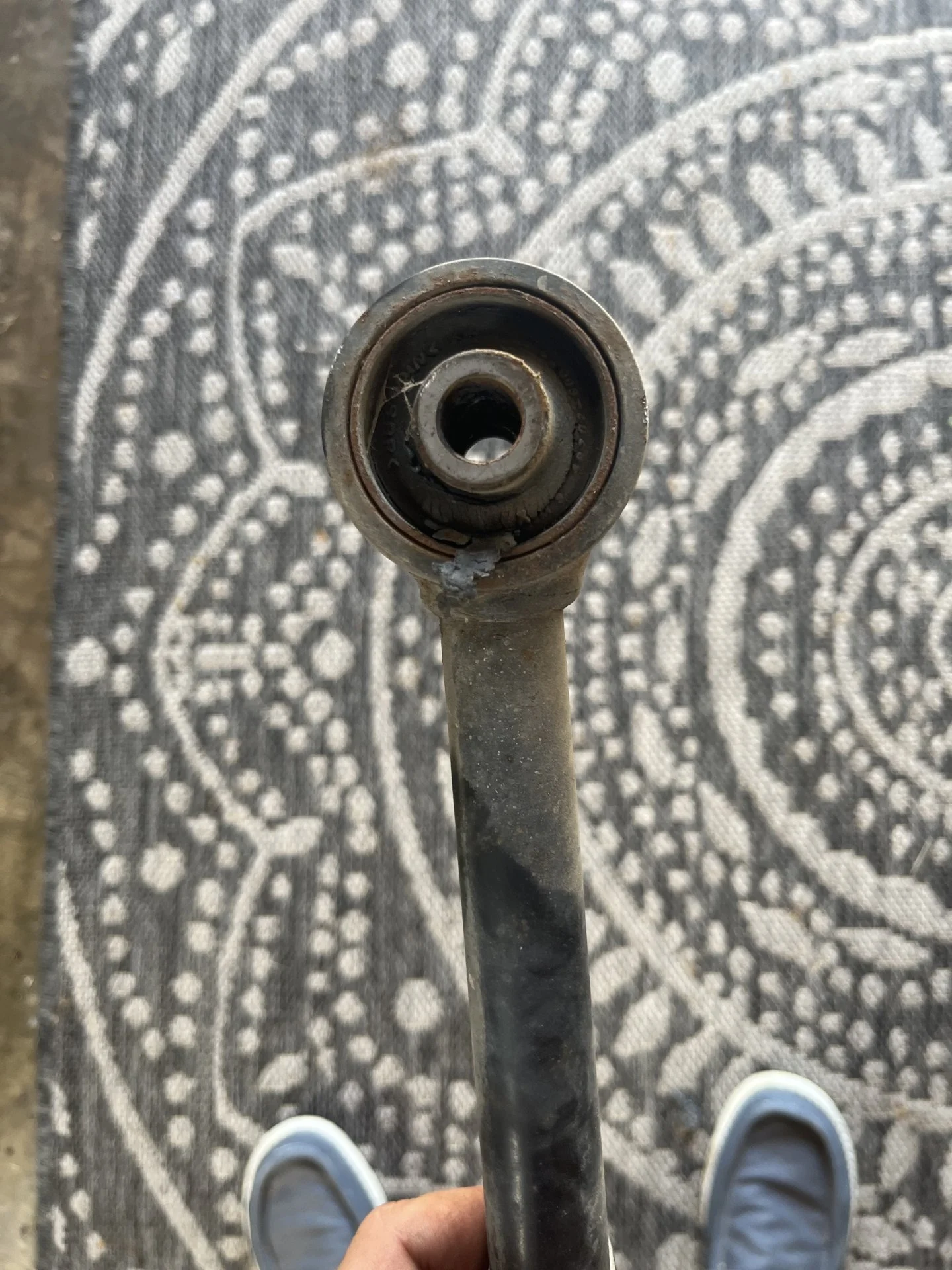

Are yours still straight? I noticed while swapping tires the other day that I have at least one rear control arm of custom banana shape.
Well that’s interesting. No, mine were good other than the old bushings.

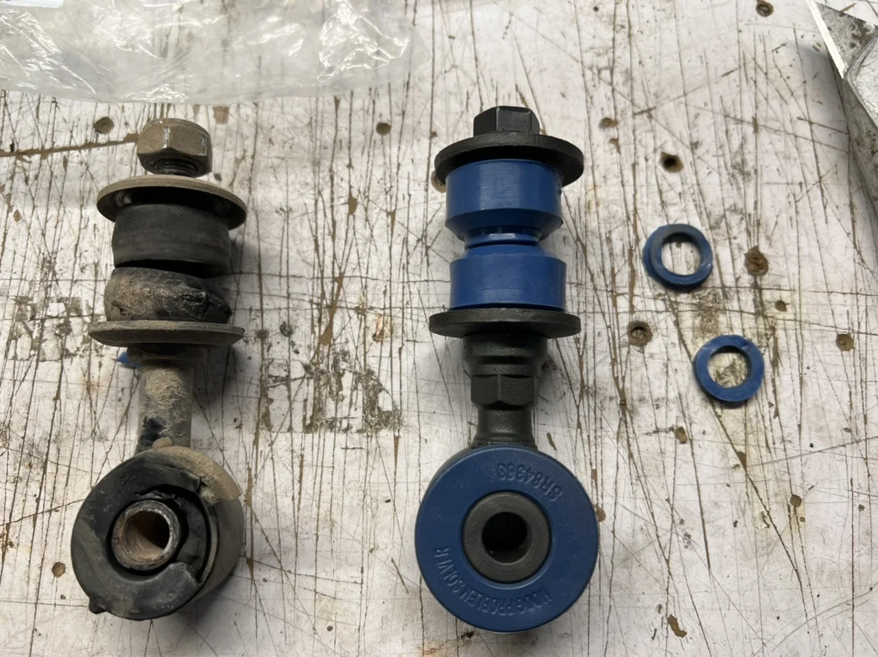

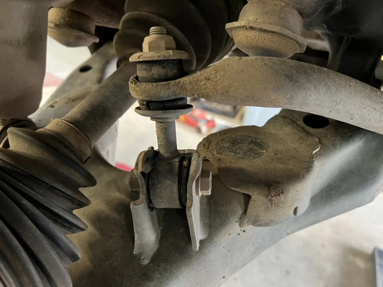

I replaced the front sway bar links with Moog. Very beefy, and apparently poly bushings. The old ones were only a couple years old and already falling apart. If you get these the bushings have a lip you need to cut off so you can get the nut started.

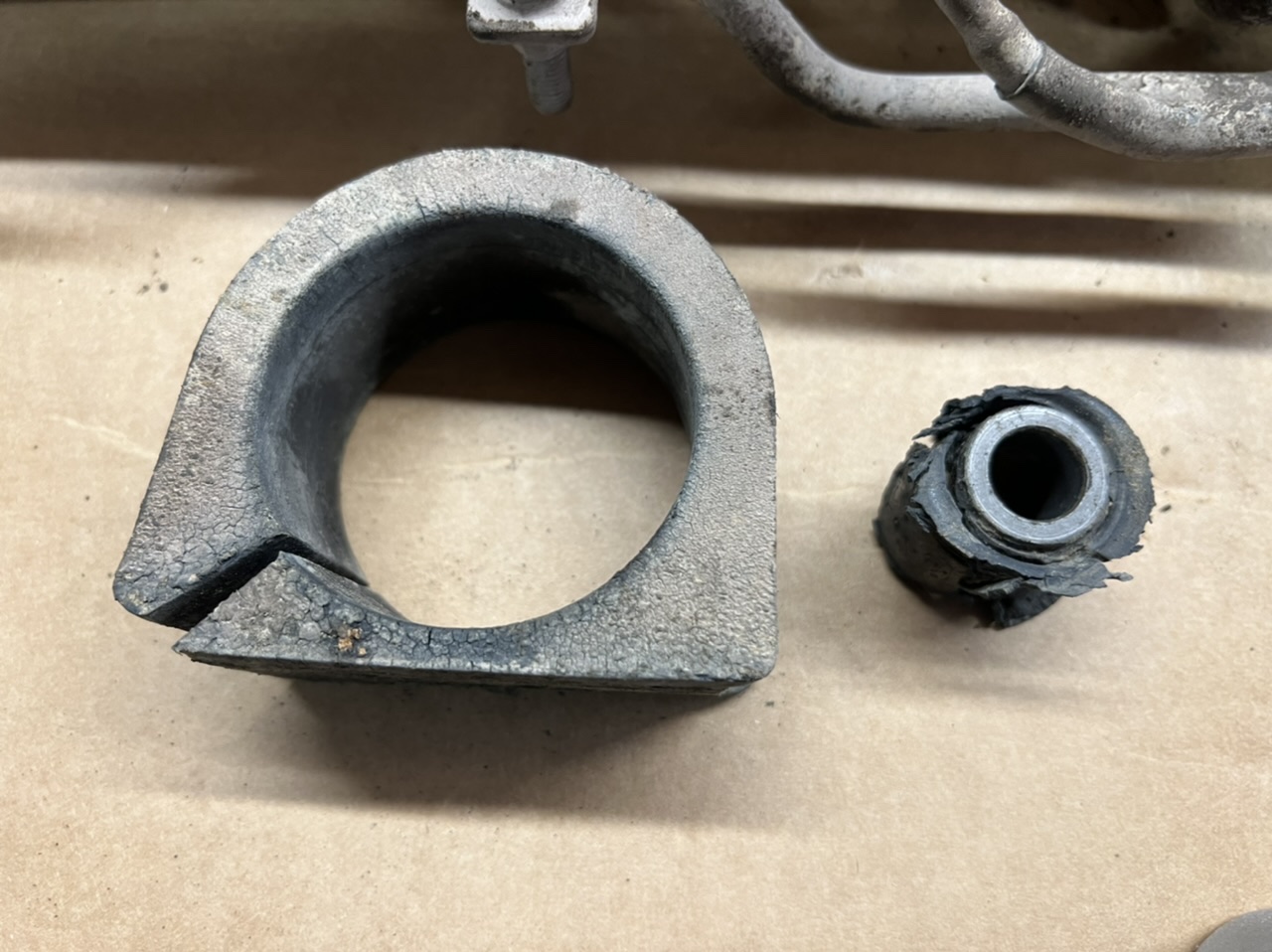

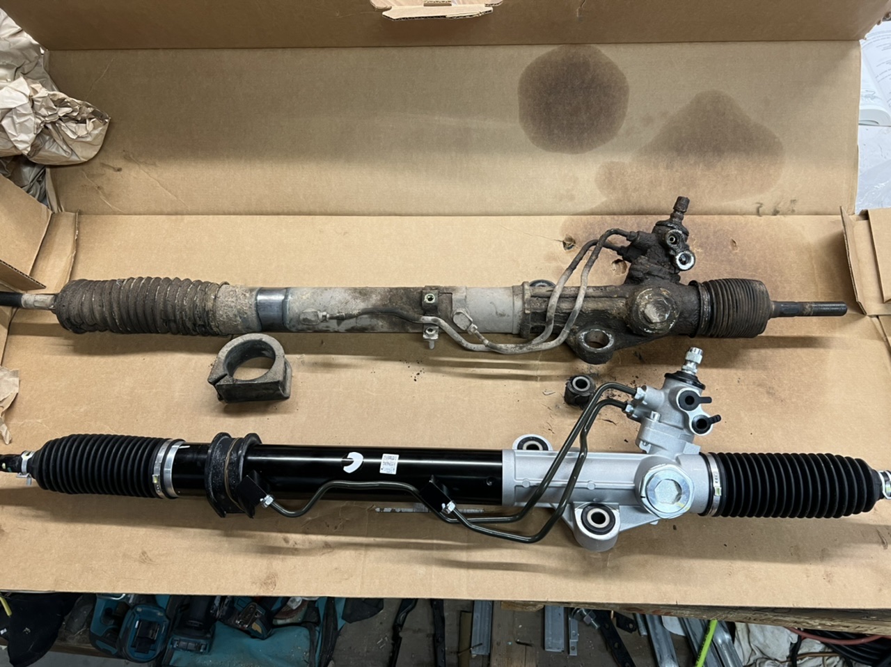

And then the fun..replaced the rack with a new Cardone unit. Not too hard, but trying to make sure the rack is centered was not easy. I also replaced the high pressure line, which was at least as much fun. Still has a bit of whine, when not turning, oddly enough. Getting it aligned as I type.
