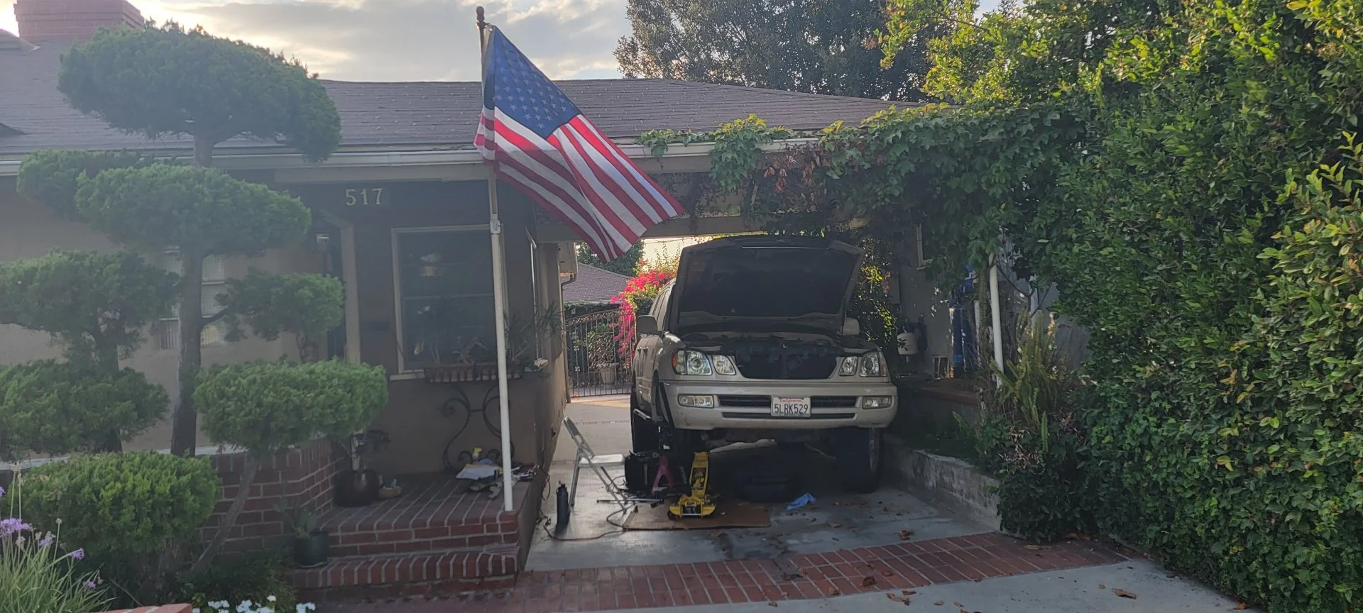

Busy couple of weeks.
Had a ps cv boot rip and spill its guts.
Notice ps lbj was rip too so...
After examing the cv's inner joint saw gouges on all six sides of the inner cage.
Bought new oem cv. Chickened out in installing the ps diff seal left it alone (I know, I know)
Installed 555 lbj.
Notice my ubj was loose and ripped. And since I have had torque steer and wonking handeling ever since my 2 " AHC lift i decided to installed spc uca to help correct caster.
Handles awesome now.
Also installed tie rod ends inner and outer, they were very sloppy.
Did the same for the driver side except just rebooted since all looked good to me. I did do the diff seal here.
Could not have done this myself without this community helping out.
