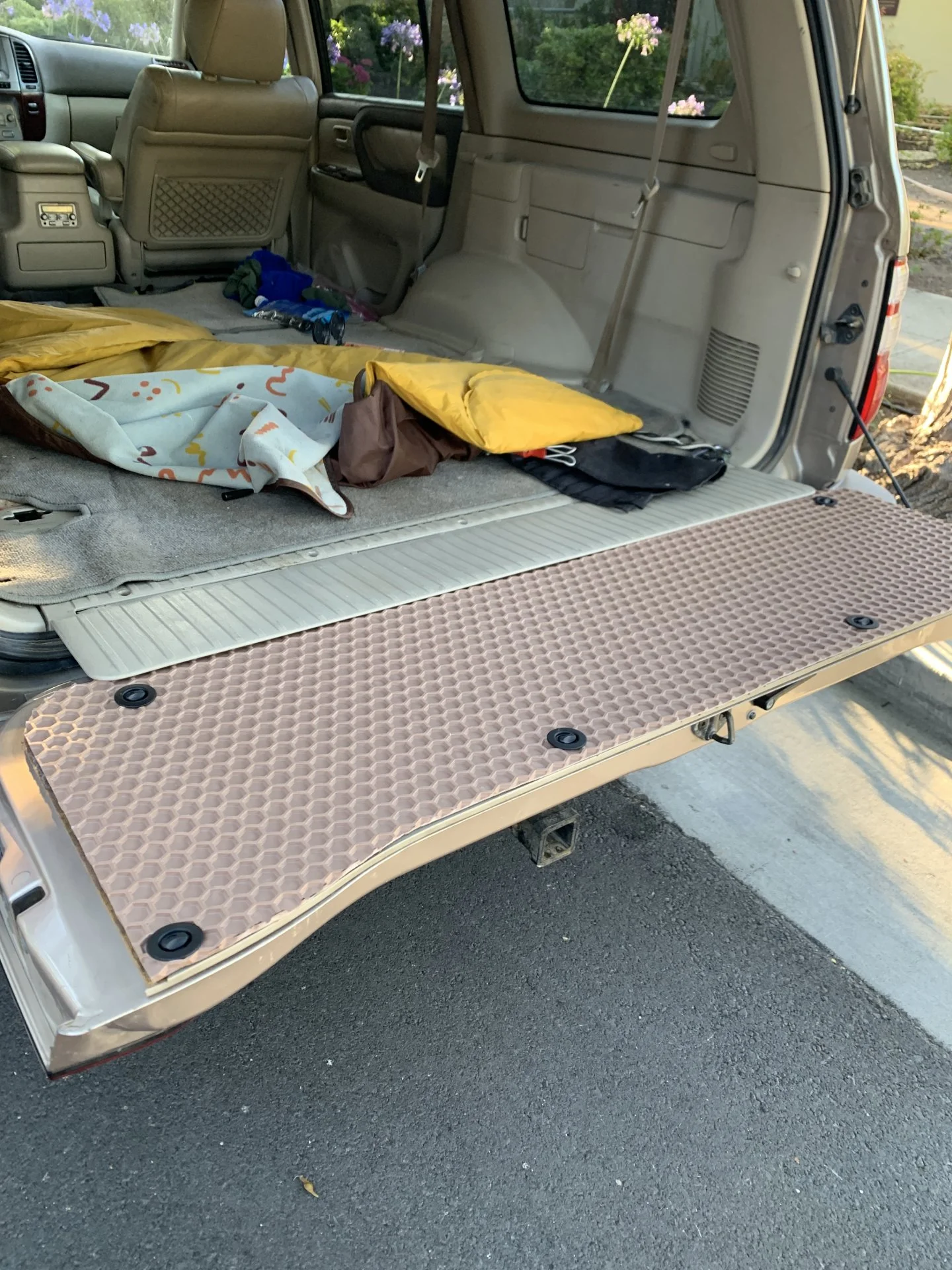

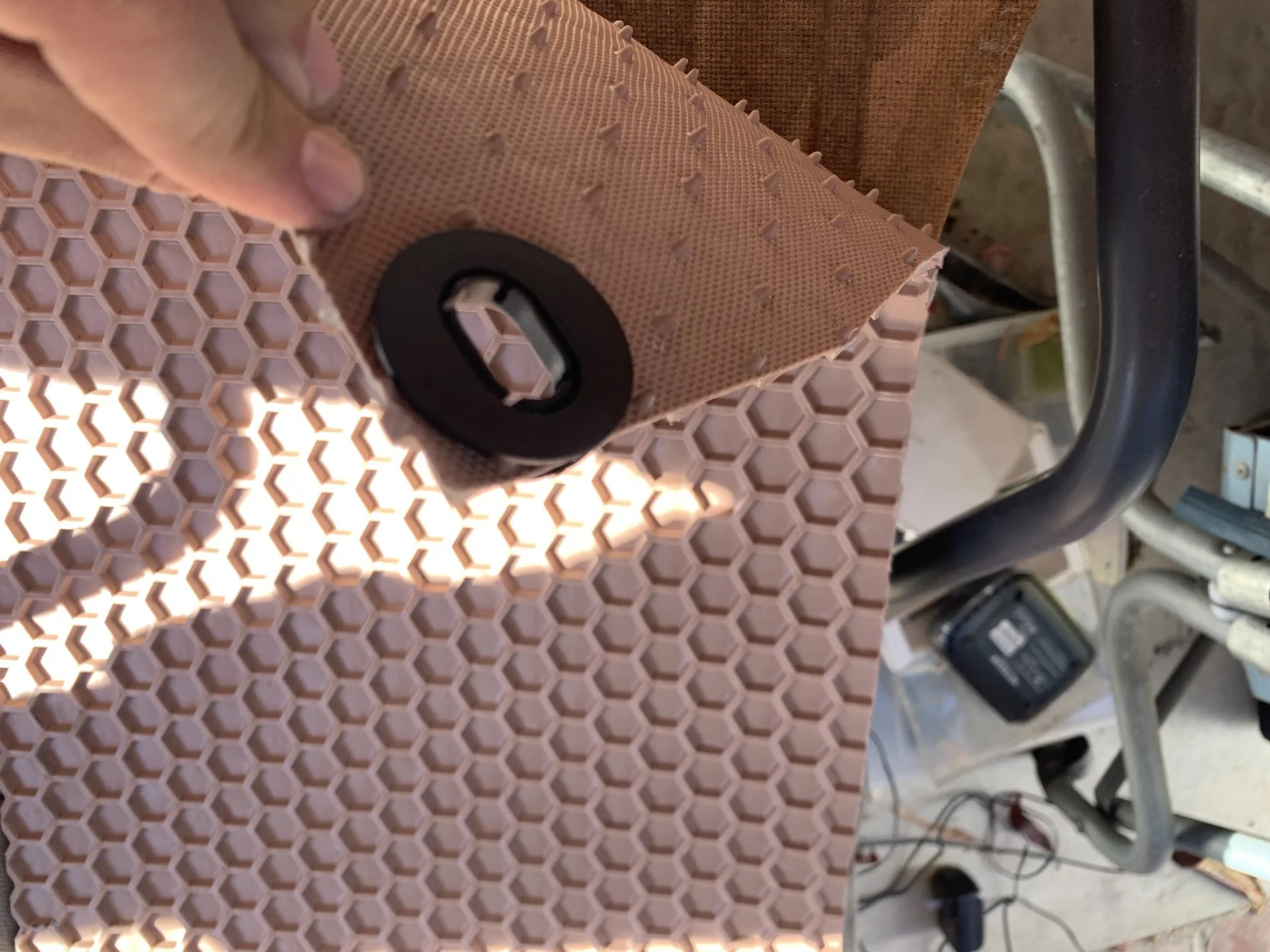

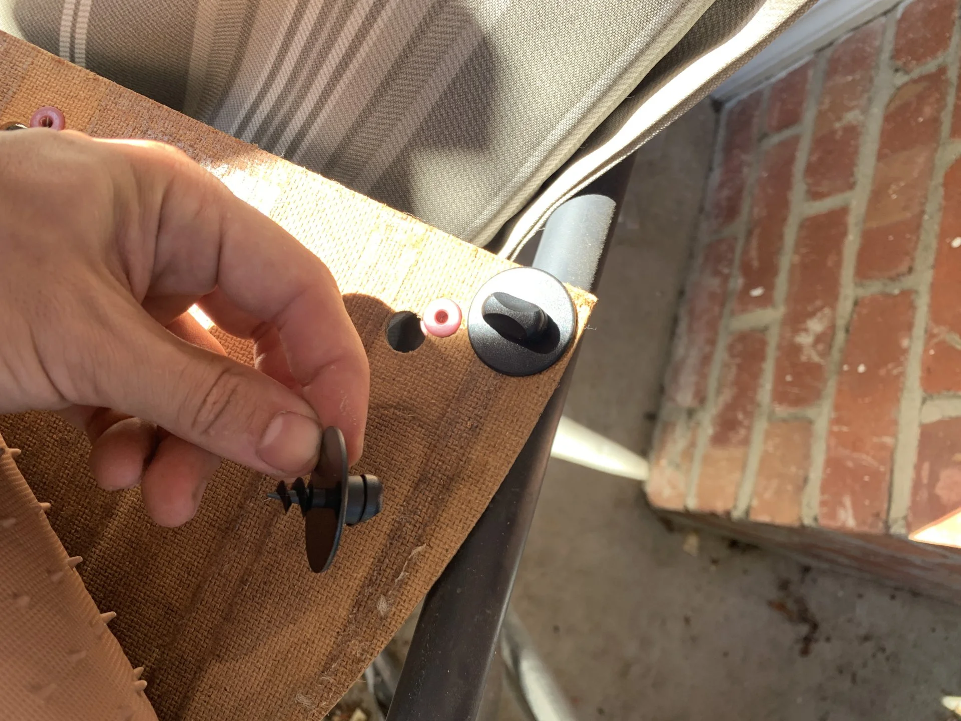

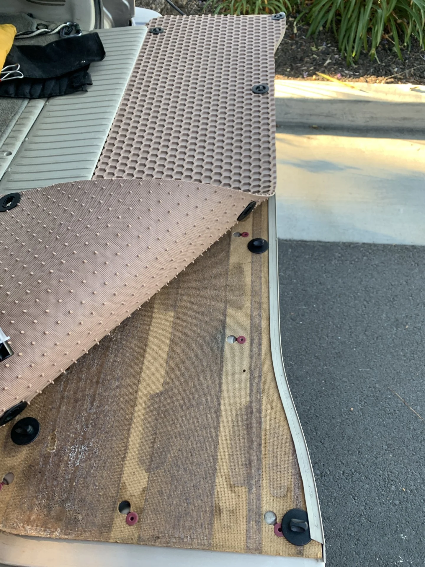

Replaced the old stained tailgate carpet with some Hexomat rubber. Added some twist locks so I can remove and hose down to clean it too!

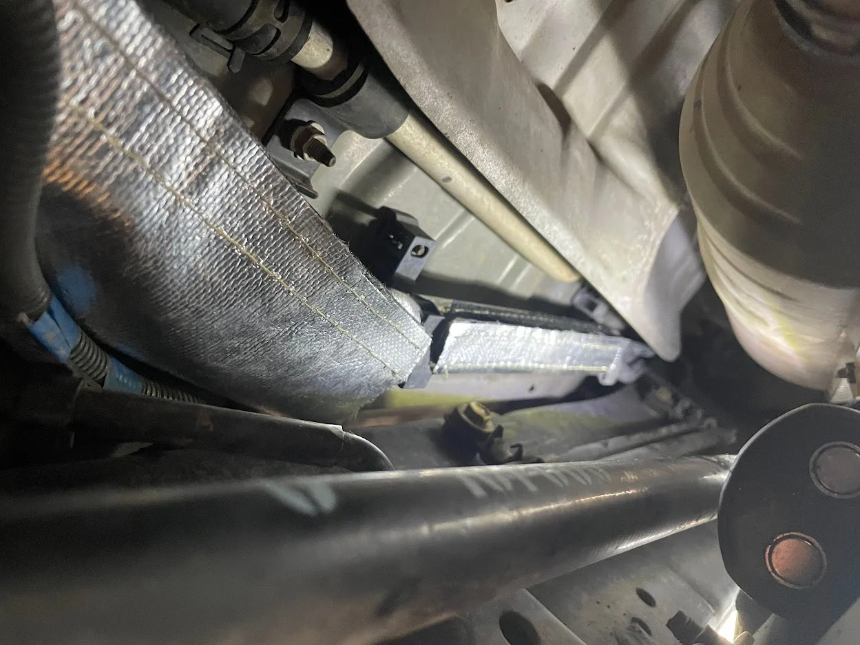

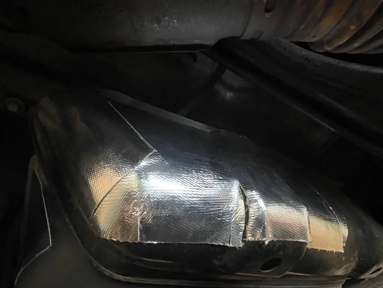

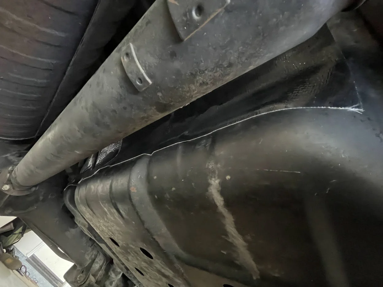

Finally got around to putting the reflective heat shield wrap around the fuel lines coming from the gas tank and runs parallel to the driver's side cat and exhaust. Hopefully this will alleviate some of that vapor build up in the gas tank whenever I go to open up the gas cap.
