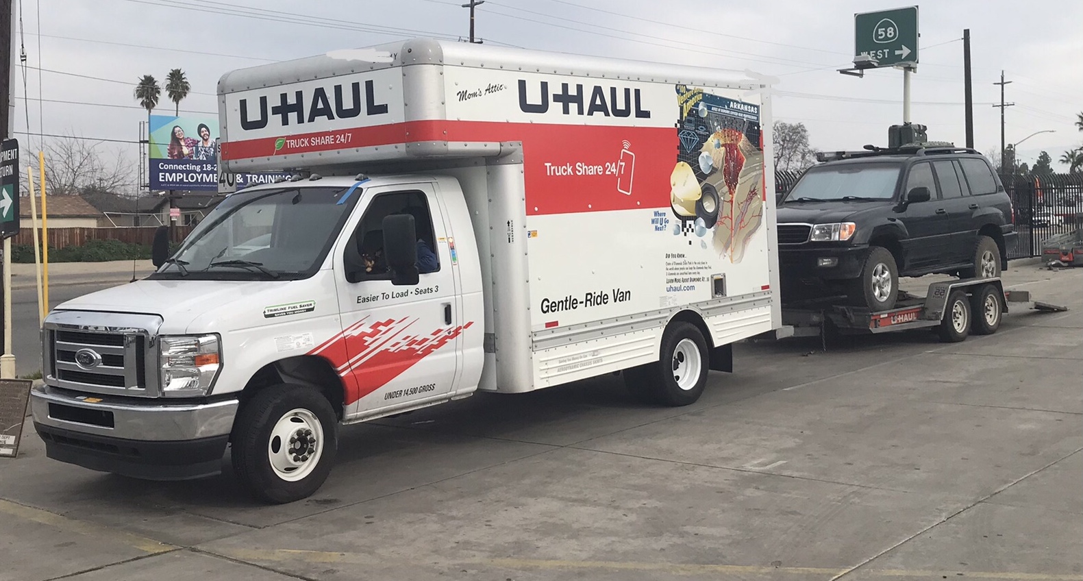

Started a trip and pretty sure we lost the engine. Really sad way to start the year. Towed it back home and planning to investigate more about what happened.
Edit: I'll be updating this thread as I make progress in the diagnosis and repair/engine replacement decision. Misfire on cylinder 8 and oil in intake box
What did you see/hear/feel/smell?
Link to the thread I started about it here: Thread - Misfire on cylinder 8 and oil in intake box
Basically filled up with gas and ~2 miles down the road started to get a new engine noise. Sounded higher pitched almost like a fan that matched engine RPM. Continued to drive and then got a misfire on cylinder 8. Pulled over and checked everything over and when I restarted driving got some smoke that went away. Continued driving to a autoparts store and found oil in the intake air pipe. From there, limped towards home and tried a few other possible replacement parts, but no luck. Eventually found milky fluid in the oil (assumed head gasket) and decided to tow it instead of continuing on.

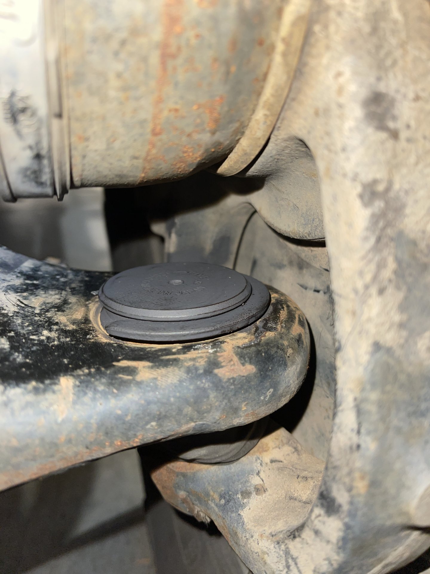

This bothered me more than it should have, but my new-ish lower ball joints were already rusting. We don’t salt our roads and don’t generally have any rust problems in the PNW, but occasionally we drive on the beach.
If they are 555, that's normal cuz they don't come coated.
They are 555. I know it's not a big deal but I feel like i'm under the rig every weekend and I'm getting tired of seeing it lol.
Same observation when we drove up to Lake Tahoe during a snow storm mid of December. Surface rust immediately showed up. I had to paint mine using a fine hand brush with oil-based enamel paint.
Yup! Almost immediately after seeing the first sign of salt. I just used a wire brush to clean it up, taped around, and sprayed some rust inhibitor spray.
