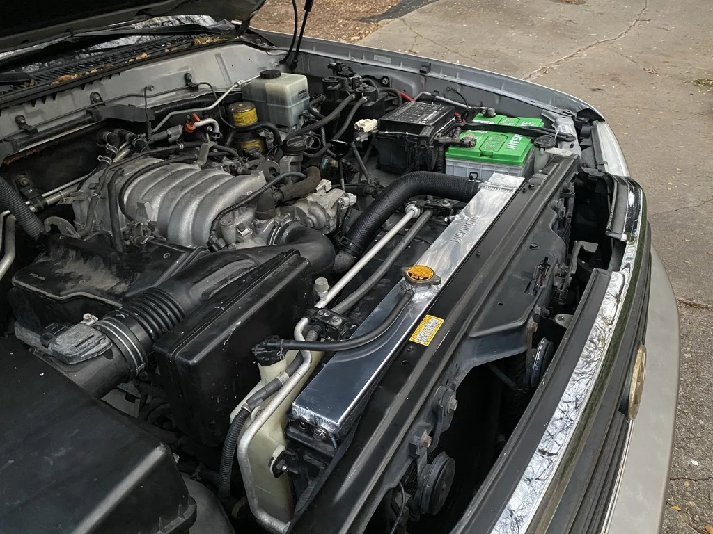

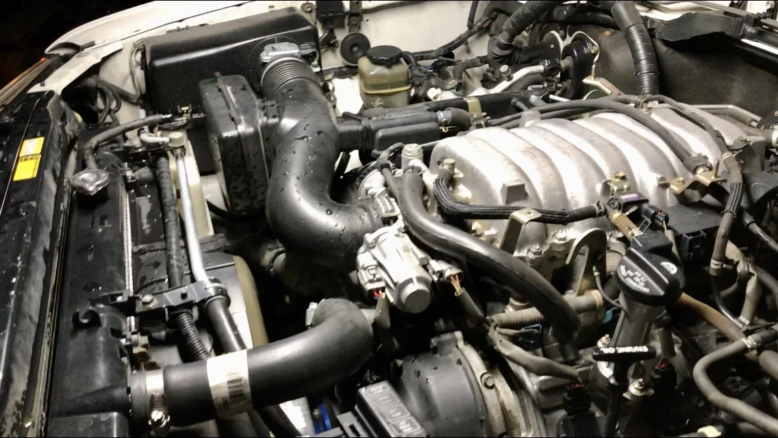

Finally got around to changing out my leaky Gates radiator hoses with OEM hoses and new OEM clamps, replaced fraying serpentine belt with new OEM, replaced original plastic radiator with a Mishimoto all aluminum unit, and while I was in there I did the thermostat and gasket with new OEM also. I did the heater Ts a couple mo ago.
Only fitment issue I had with the Mishimoto was that inner top bolts which hold the rad to the bracket would not line up properly on both sides. Visible in photo on the side of the rad if you look closely. I figured this was not a big deal since the bolts go straight into a welded aluminum nut vs. OEM which bolts into a nut suspended in plastic. All other bolt holes lined up well.

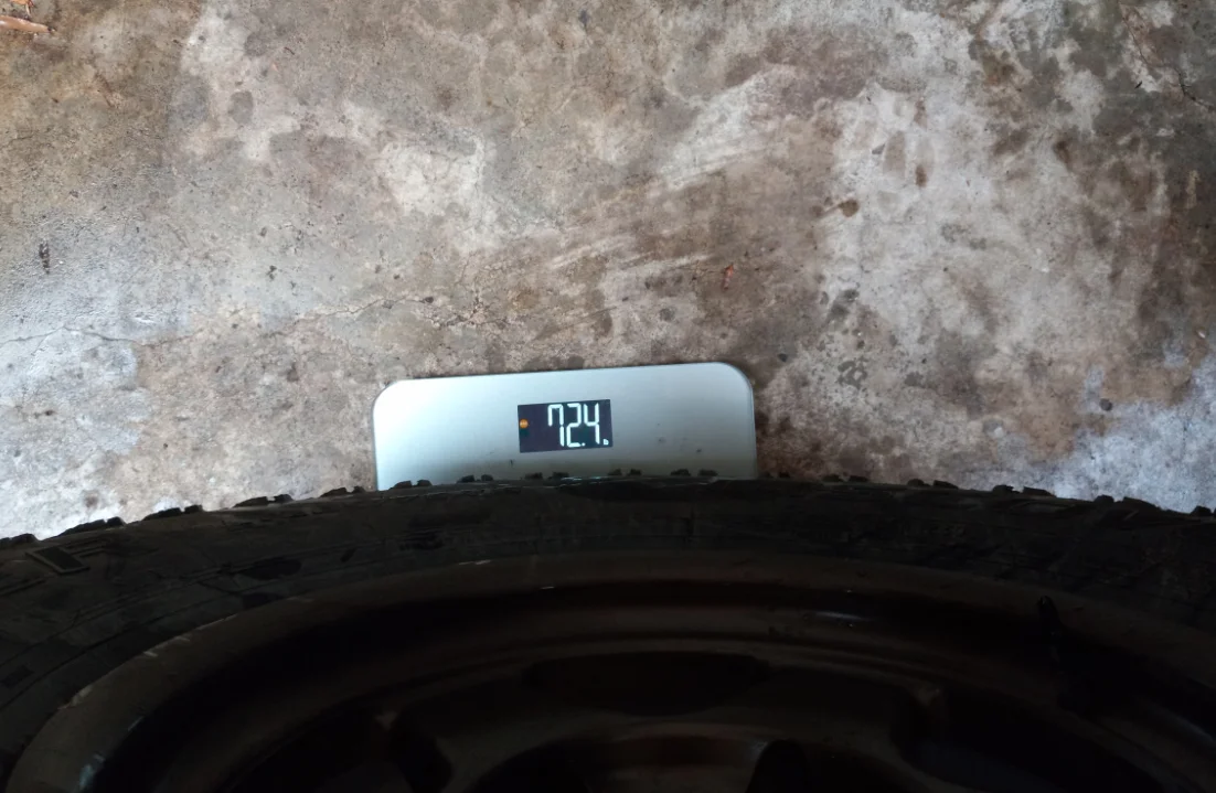

Weighed one of my F5 wheels and tires I like quick acceleration, braking, handling over mass. I want to keep wheel and tire weight under 75 lbs. I think it worked out.
I've never weighed mine, but using published weights on my 17" FN 5 Star wheel and 33" C rated KO2 it should be 70lbs.
Good to know. I bet you like how it feels?
Yup, originally bought 32" E KO2s and didn't like braking performance, so sold those and got 33" C KO2s. It's amazing what a few pounds less of unsprung weight changes the feel. I was a forged JDM whore when I was younger, wasn't going that route on the 100.
Absolutely! It's just physics. Looking back I've jacked up a few decent handling/performing cars in the past by thinking bigger and heavier was better.
Usually, I would sell or trade the victim soon afterward so I didn't have to live with my mistake.
I did forget and jacked up my Tacoma for a short while with some heavy metal wheels and oversized tires. Fortunately, I was able to return wheels and tires over another defect while moving to a larger but lighter wheel and tire combination. That restored handling and performance.
For the 100, I think coming to terms with and learning how to enjoy and leverage the truck's natural capabilities (with some minor enhancements) will give the best bang for the buck.
*cries in Hutchinsons and 35" E-rated tires*
Looks great though, and the F5s are killer
Yup, I remember my college classmates made fun of me for buying lightweight forged wheels, they were like you could just lose 10lbs. They didn't understand the unsprung part.

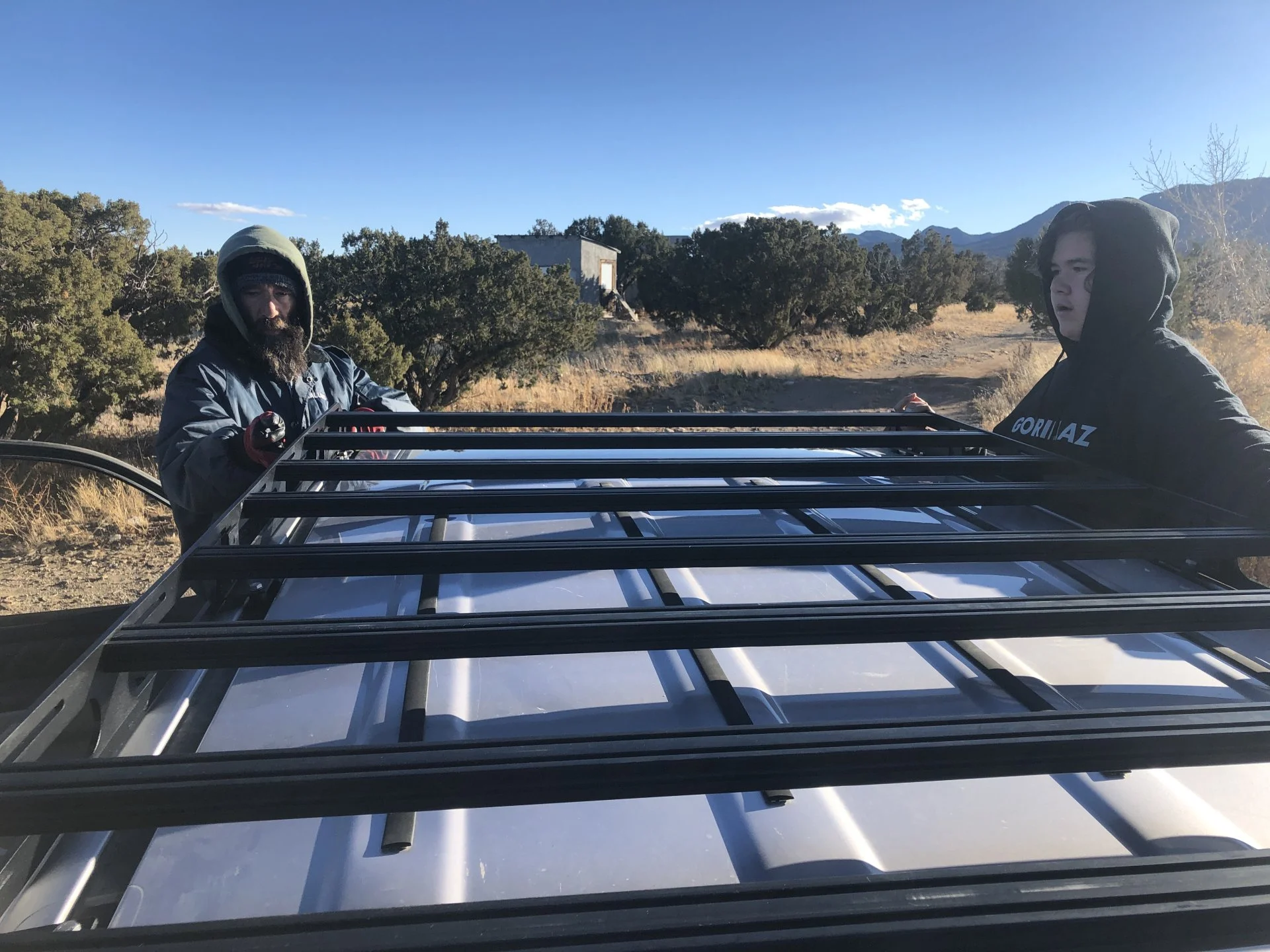

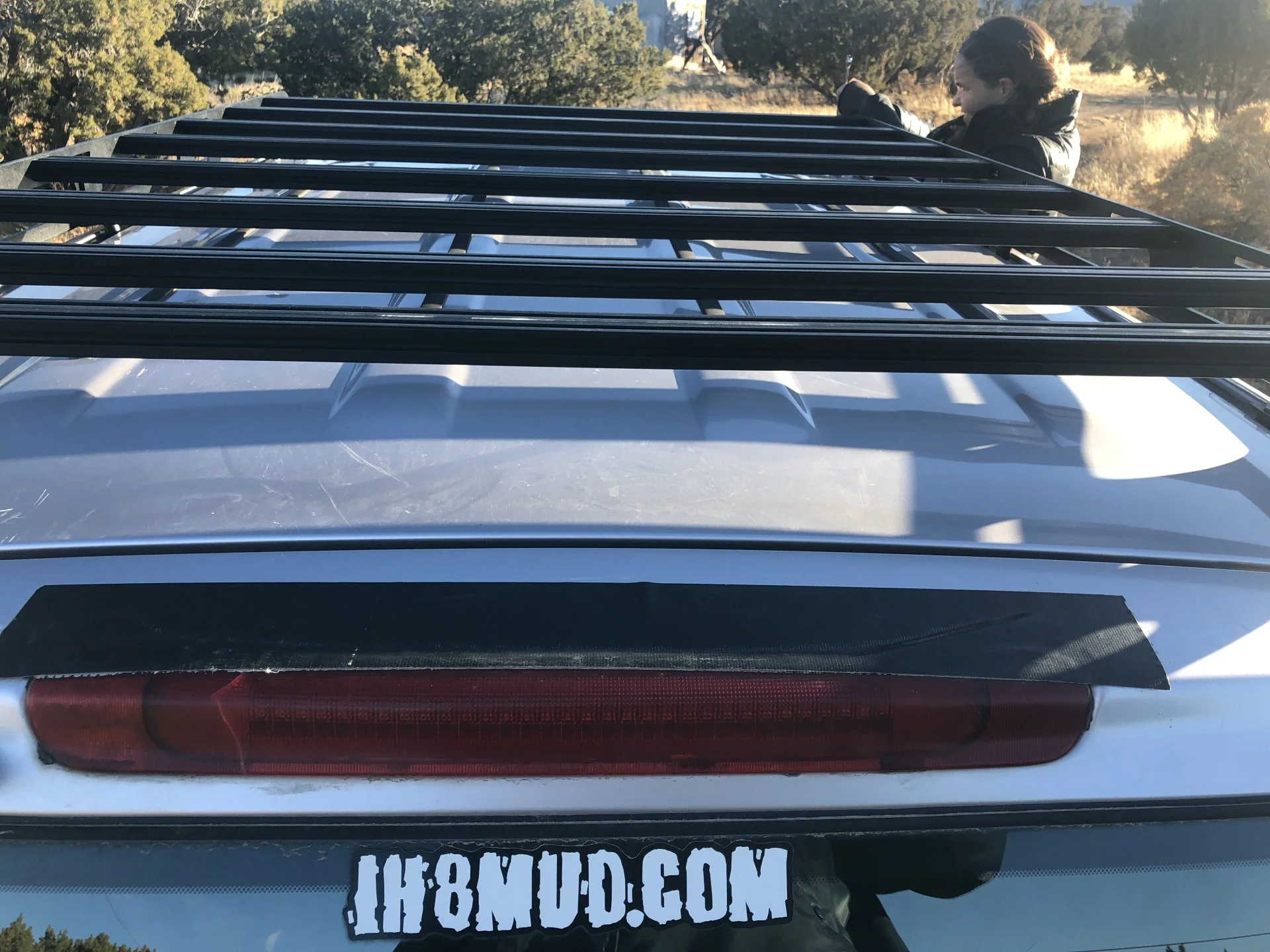

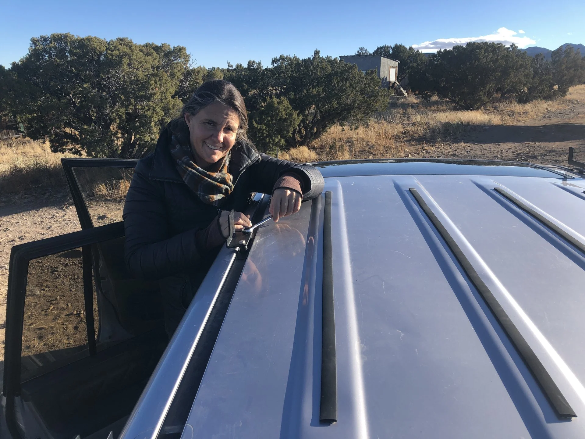

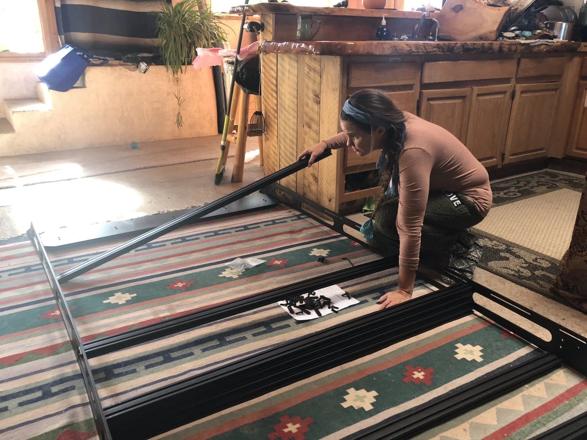

Today I installed my Bowfin Cruisers Roof Rack from @dogfishlake
I did most of the work in my living room out of the wind and cold then had my husband, @mesa man, and my son, Dylan, help me load it on before I tightened all the bolts down. I’m really excited about this new rack, it feels sturdy and ready for our long adventures!
Thanks Pat! I have been looking forward to this day for a LONG time!
Off for Adventures!

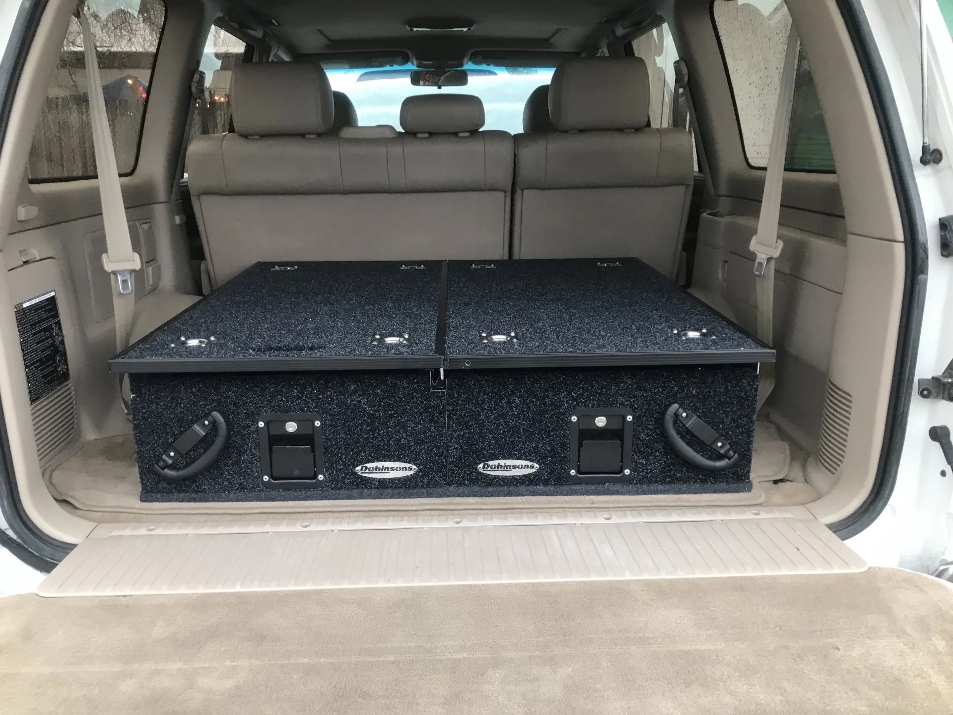

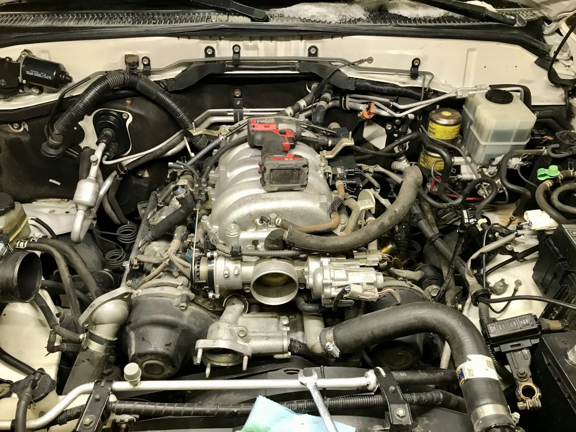

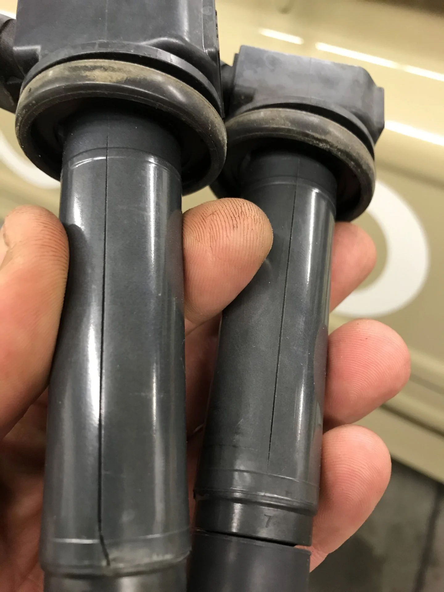

Pretty good day in the spa for this one. One owner but 372,000 miles.
Upgrades!
Five new coil packs, spark plugs, valve cover gaskets, fan clutch, thermostat, PCV hose and valve, evap hoses, fresh mobile1 and filter, front wheel bearings adjusted, new drive flanges, diffs and tcase fresh gear oil. Not a bad day. Little more and drawers all fitted plus an inverter install and this one is ready to go. One of the nicer high mile 100’s we have seen.

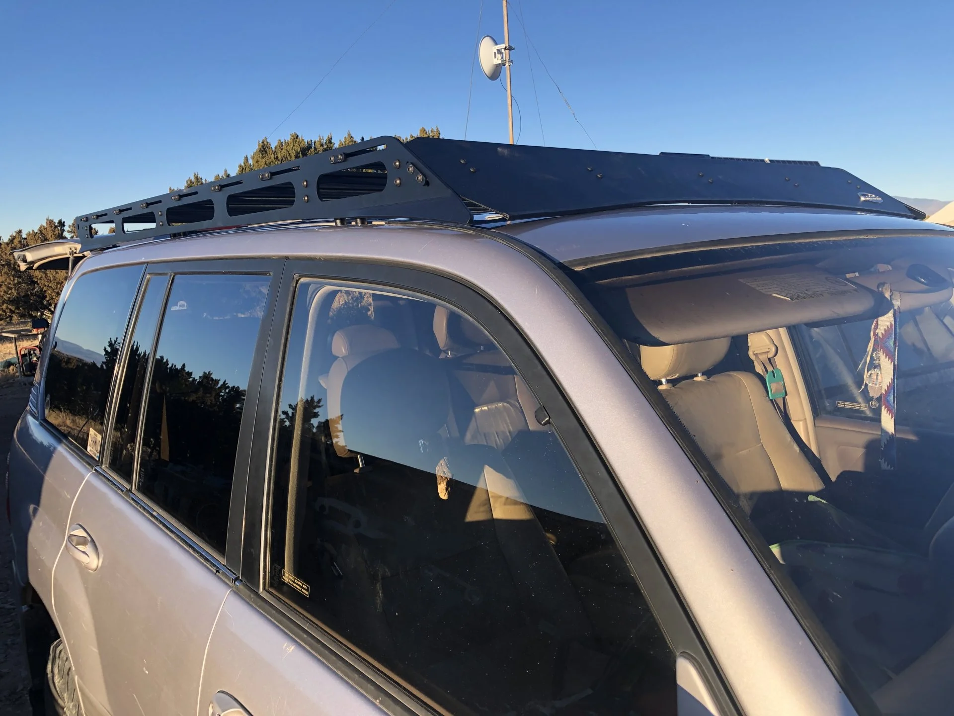

Off for Adventures! View attachment 2866271View attachment 2866272View attachment 2866273View attachment 2866275View attachment 2866276
Sweet! Glad you got it on there. You'll probably be the winning draw for a rack next year at Solid Axle Summit LOL. Here's to the rack serving for many adventures.
Cheers!

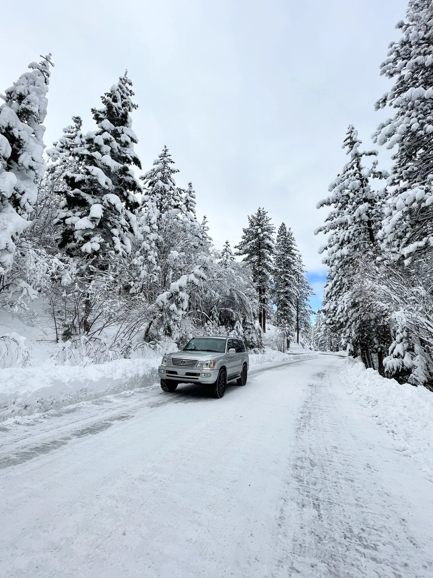

That semi in front of us shortly after this quick video was taken caught a patch of black ice flipped and jack knifed. Driver survived without a scratch at all. One of the worst snow storms I’ve seen even saw a 200 series on snow chains abandoned on the side of the road.
Pulled a jeep JK that got stuck on the embankment, when I checked with the driver he doesn’t know how to operate the 4WD. Gave him a quick 5-minute “crash course” in correctly operating his equipment and he was on his way.
Our LCs/LX standout in these types of weather. Drive a Legend.
