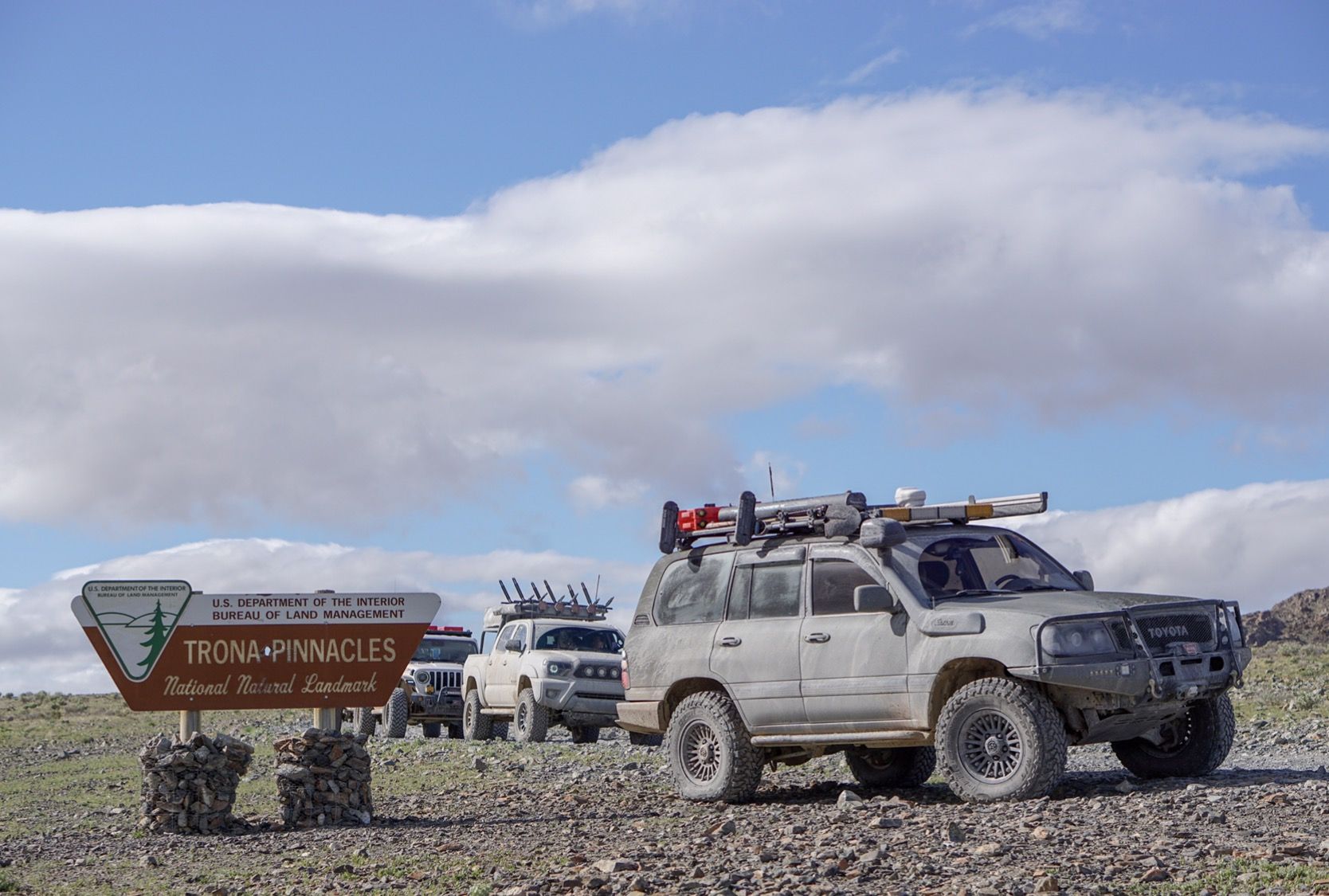

Looks like an epic trip!
It was fun! Started out from Vegas to Rhyolite, NV. Then took Titus Canyon trail into Death Valley. Stayed the night in Death Valley and did a little site seeing before making our way to the Trona Pinnacles for the night. Then a little detour to Nelson, NV the next day to meet up with a Jeep group that was running a trail called Copper Cache before heading home! Here's a few more cool pictures from the trip.
