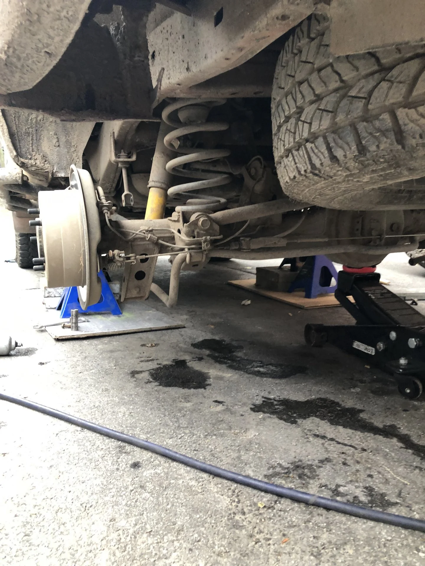

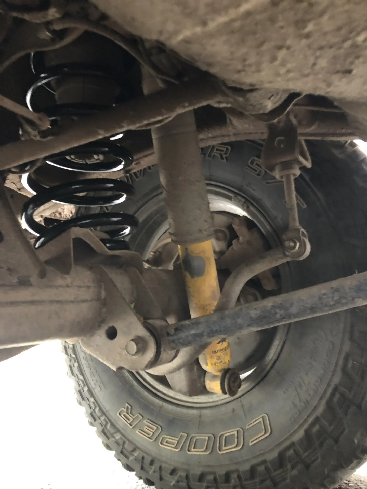

Exit 2866 and 1” spacer —-> welcome 2864
Rather simple work of 40 minutes where 10 was devoted to securing the vehicle on the workshop supports
Did you unbolt the lower control arm? When I did the shocks and sway bar refresh I couldn’t get the axle to sag on either side enough to pull the coils. And I dorked around long enough with the top shock bolts I figured the coils could wait another 6 months. 🤫 I was needing a sanity beer.

You shouldn't need to. Take the rear wheels off, first. Then once you take the shocks off their lower mounts and disconnect the sway bar links, raise one side a little and put a jack stand underneath it. That would make the other side just drop almost to the ground.
The spring should then easily come out

I left wheels on; disconnected lower shock mounts, stabilizer links, panhard bar, brake hose, and height sensor. Jacked up at receiver. Bada bing bada boom, reassemble in reverse

I my case, I did not even need to raise one side or the other. Just remove the wheel, disconnect the shocks and sway bar links and that it !
… even with the 1” spacer, removing the “old” coils was very easy.
I was quite surprised how easy it was !

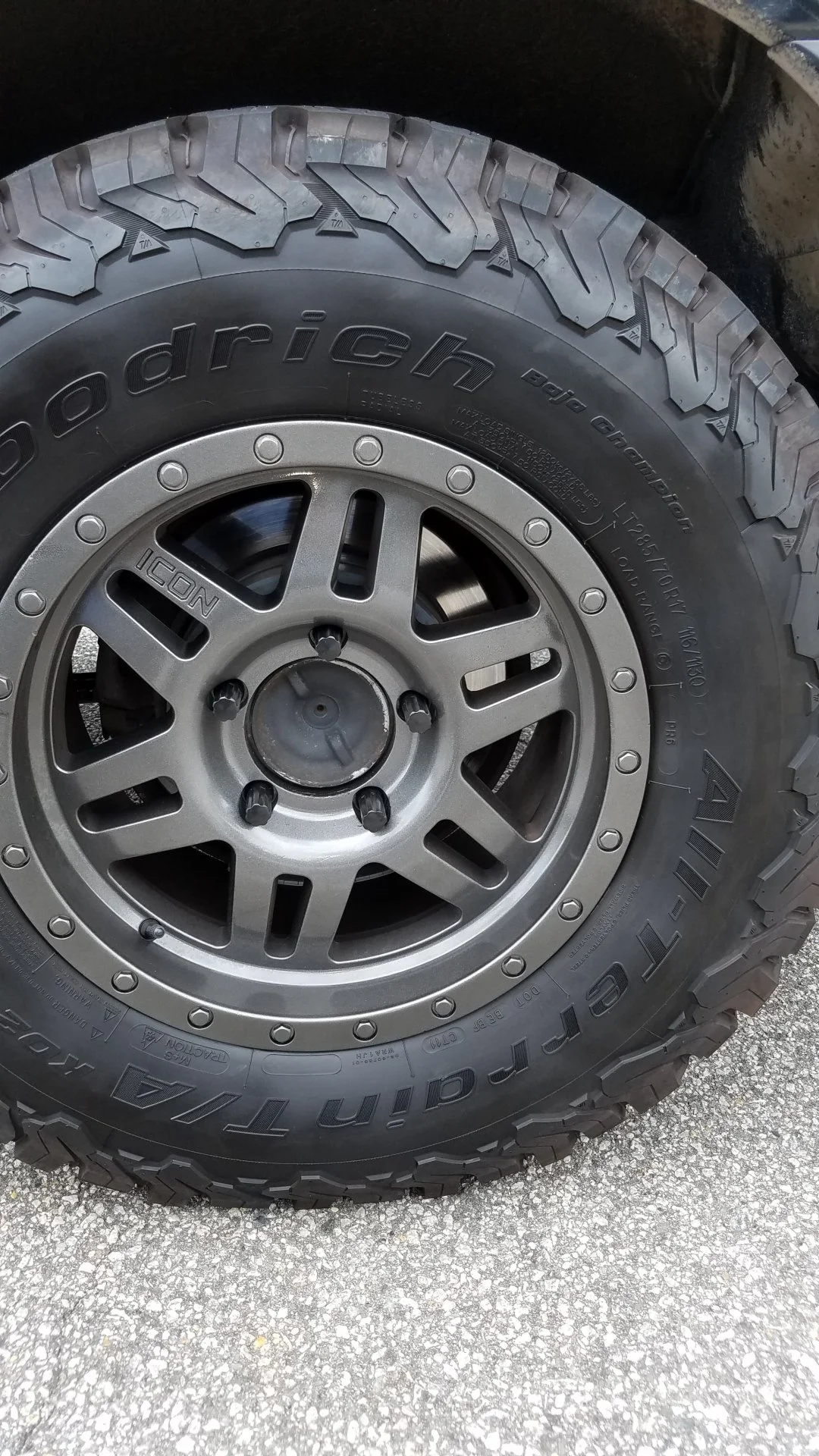

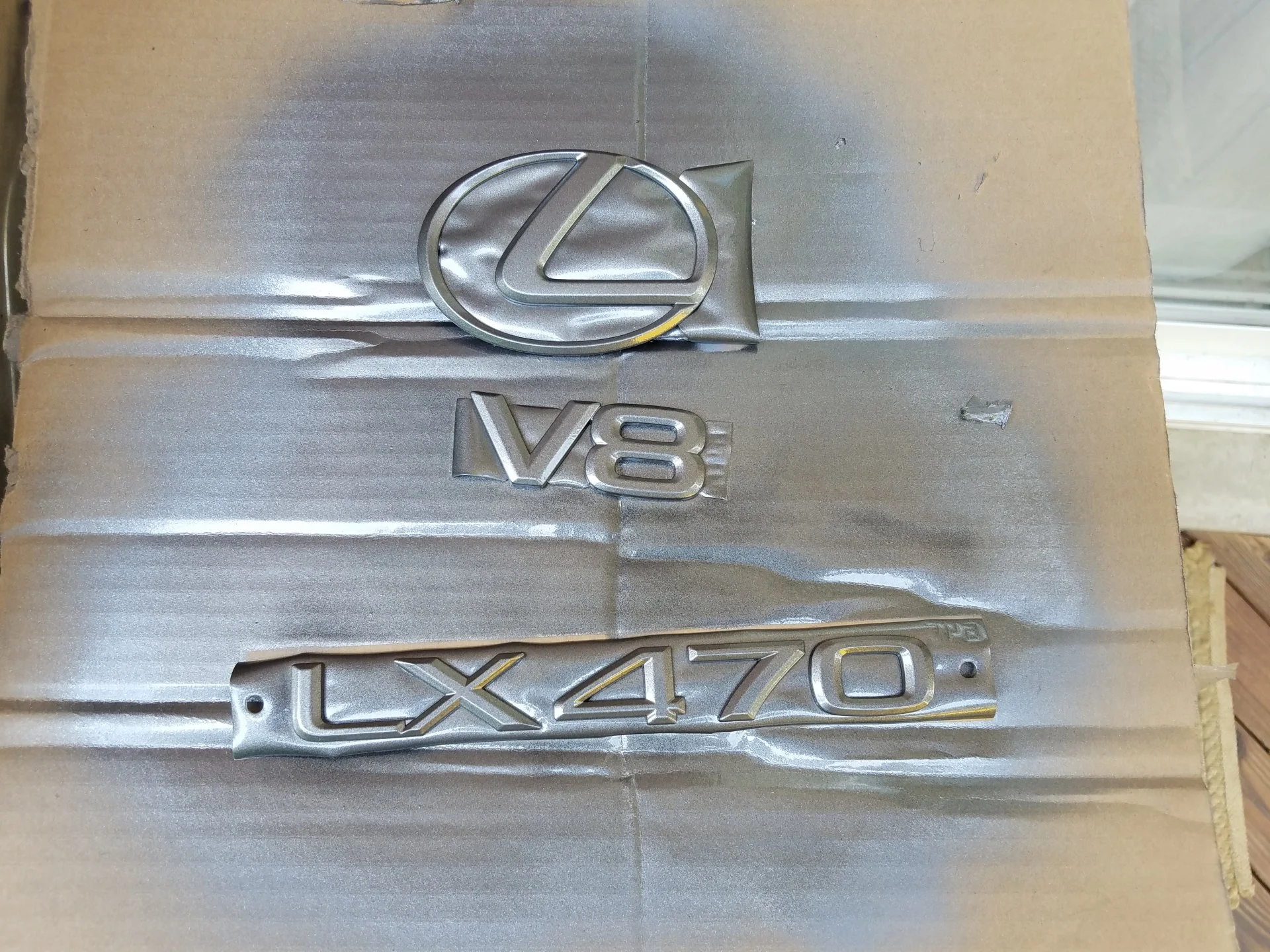

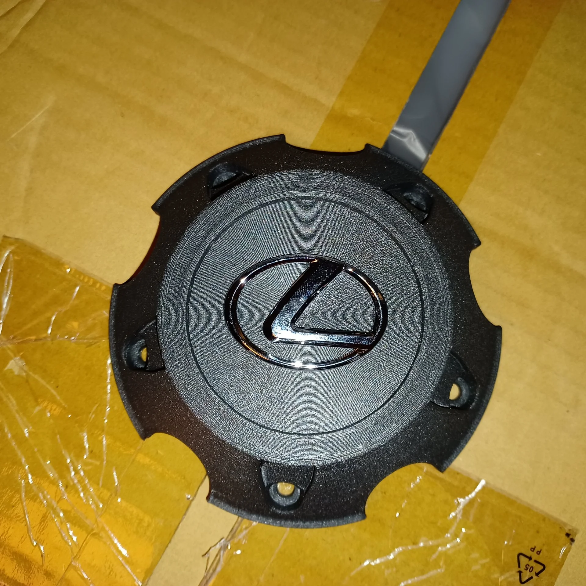

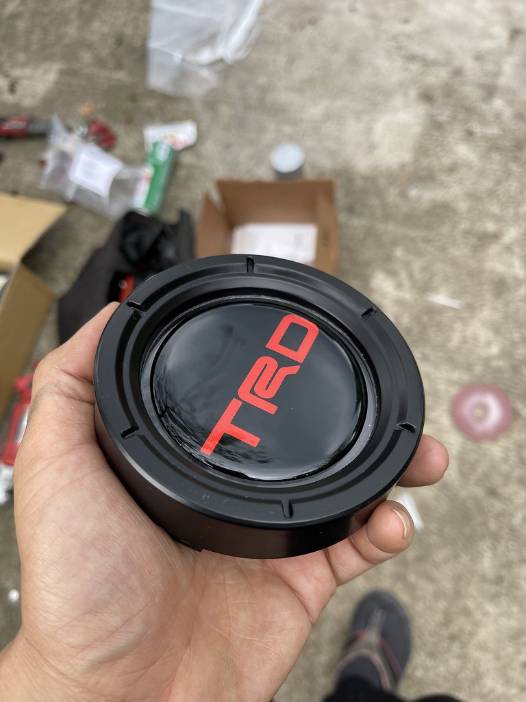

Just got these... Once the caps and emblems are painted, I think they will look even better.
Love those wheels! Are they OEM from another Toyota? Are you running spacers?
They're Raceline 944B wheels, very aggressive offset 18x9 ET +12mm. You'll have to do a lift and pinch weld mod as well as some bumper trimming to get them to fit. They balanced great and looks great, centercaps i ghetto rigged one using TRD gel centercaps.
Awesome! Thanks for the info!

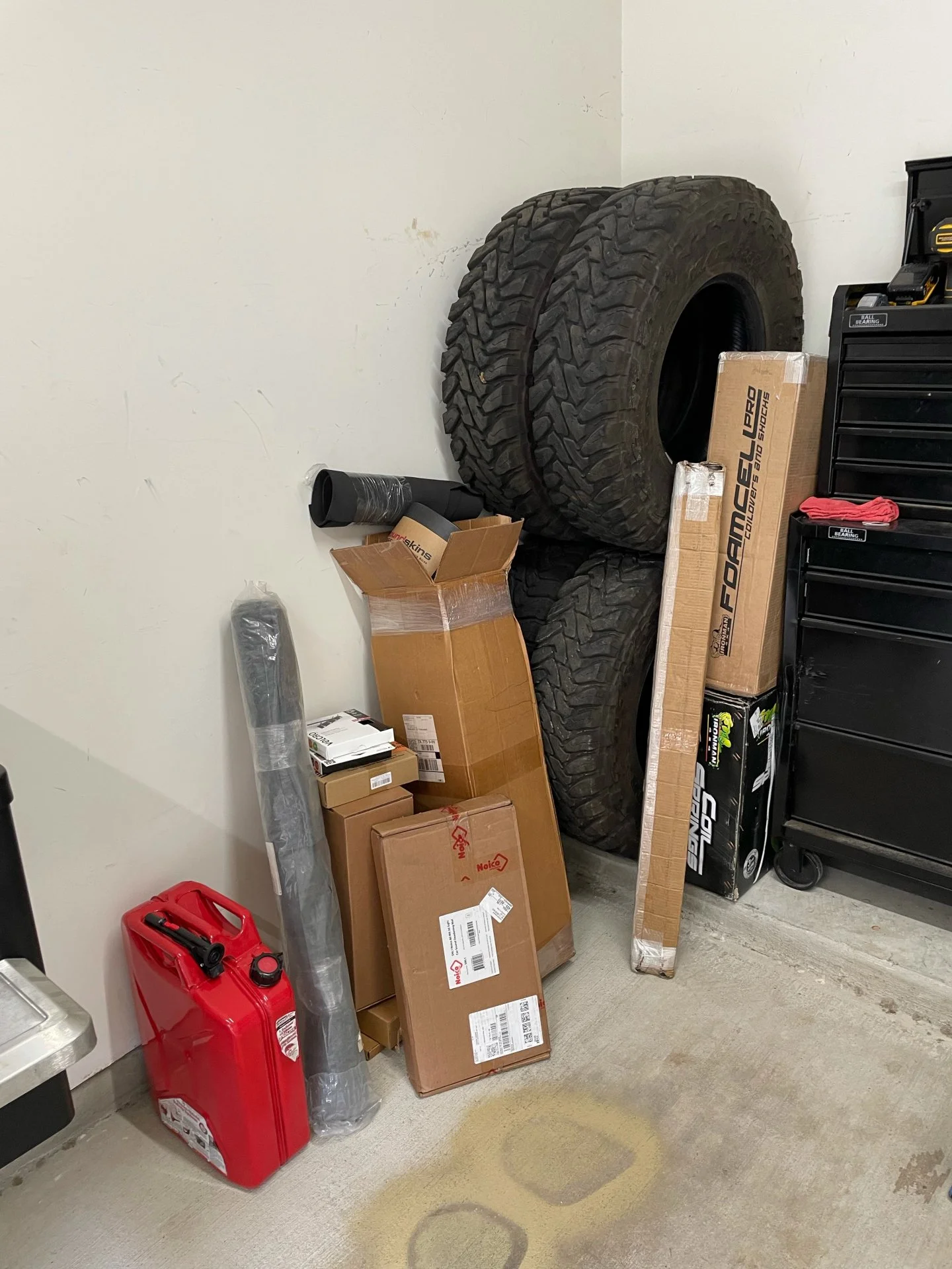

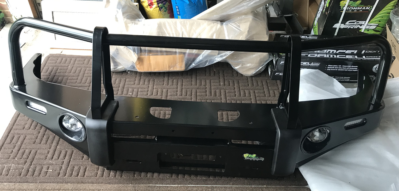

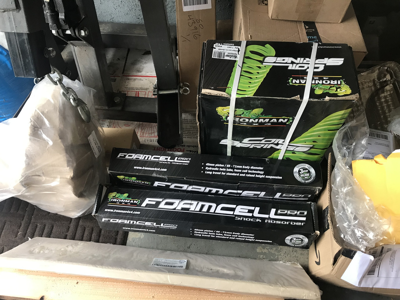

Just collecting parts.
-Picked up the tires today off CL (255/85/16 with 75%) for $300
-Ironman lift delivered today
-Theres a set of @TRAIL TAILOR rear upper and lower control arms buried in there
Just need front upper and lower arms and I'll be ready.
There's also a bunch of sound deadening materials for when I get around to that
