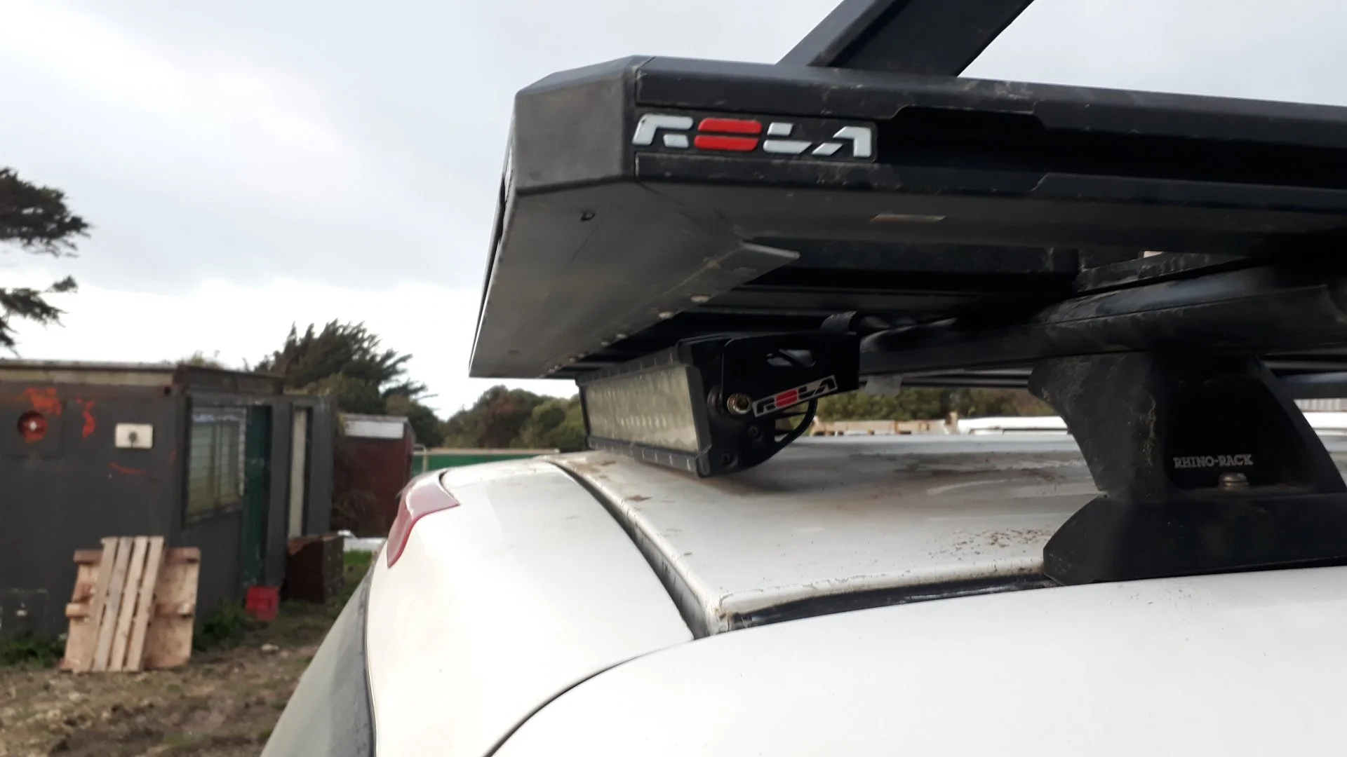

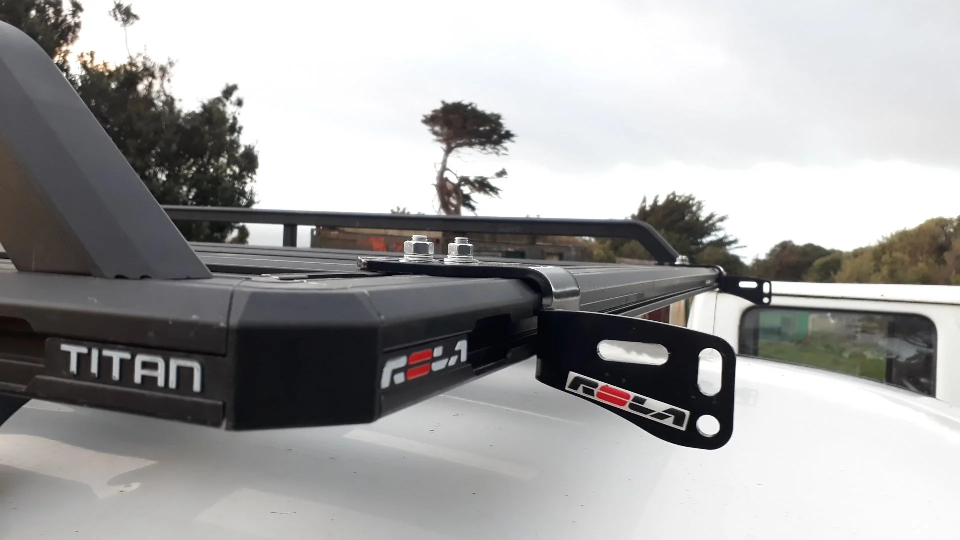

Today was to be front and rear LED lightbars, but the front one hasn't arrived yet.
The brackets are Rola, and despite being of great quality they are expensive and of stupid design as they have no serrations to lock a lightbar in place and I use my rack for carrying timber, new household doors, ladders etc. so the bolt threads protruding above the rack will be a real problem. The photo on the vendor's website showed a different (now discontinued) front mounted Rola bracket. The vendor has done the right thing and taken down that photo now, but he tells me there's no lightbar undermount available. I gave up and fitted the ones he sent me anyway as I'd been waiting a month for them to arrive.
I got around the protruding bolt problem on the rear LED by mounting the brackets to the Rhino crossbar. The rear light will be wired into the reversing circuit (with an on/off switch).
I won't have the crossbar mount option for the front LED as the Rola tray rails are in the way.

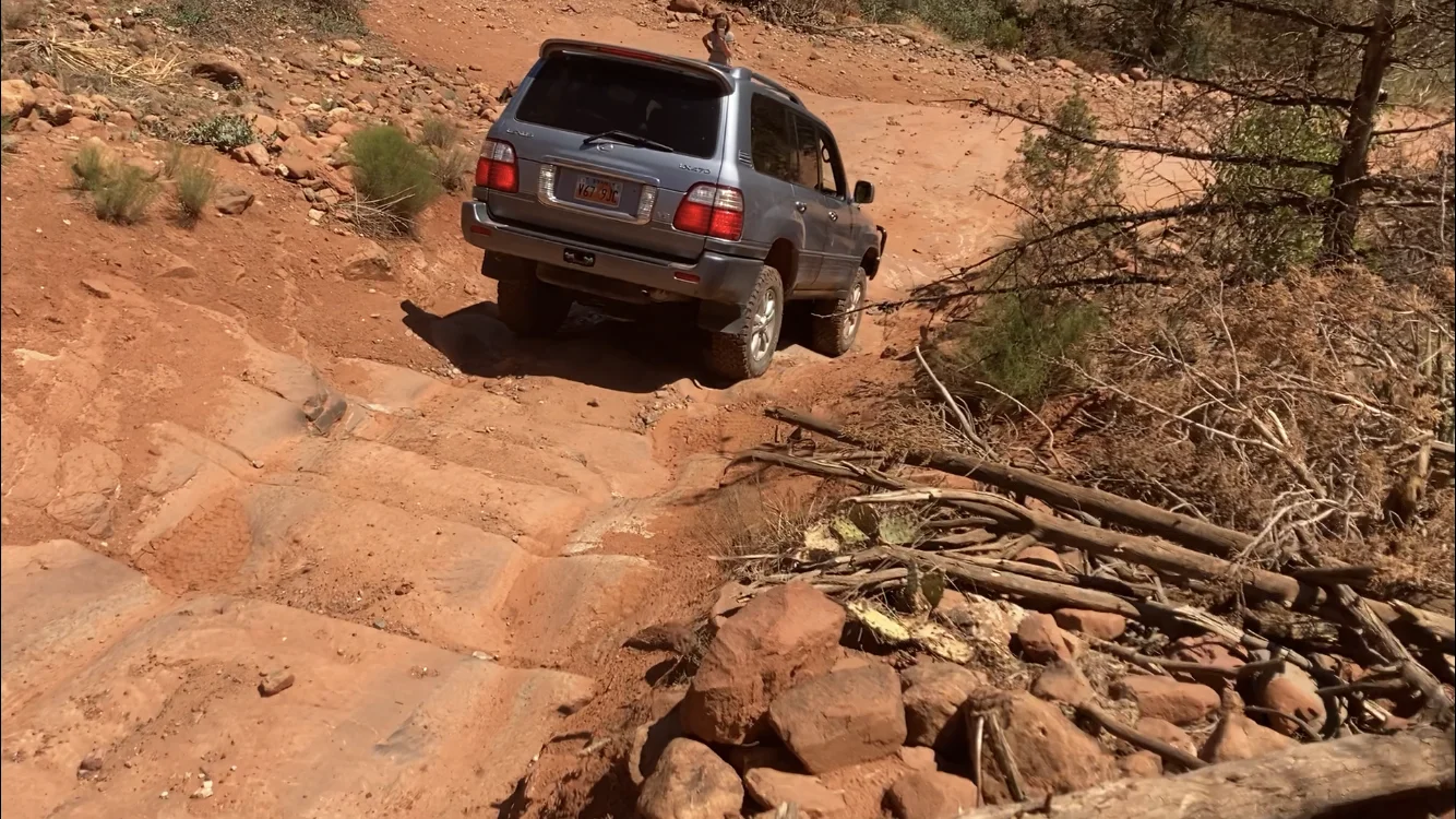

I got over 250k on mine, and just replaced both while I was in there doing the diff, bearings and ball joints, since I knew I’d be wheeling harder than most. One original is still perfect the other has the tiniest play. From what I understand, having the front locker takes some stress out of the whole system when wheeling hard and lifting tires. When in Moab, AHC was on high for hours, but going very slow. I only use it when high clearance is needed now. Didn’t use it for Devils Staircase.
Sweet pic. I haven't had mine out yet to wheel, because every time I think about it I think... man what if some of this old busted mess breaks on the trail first time out. That's not a good look.

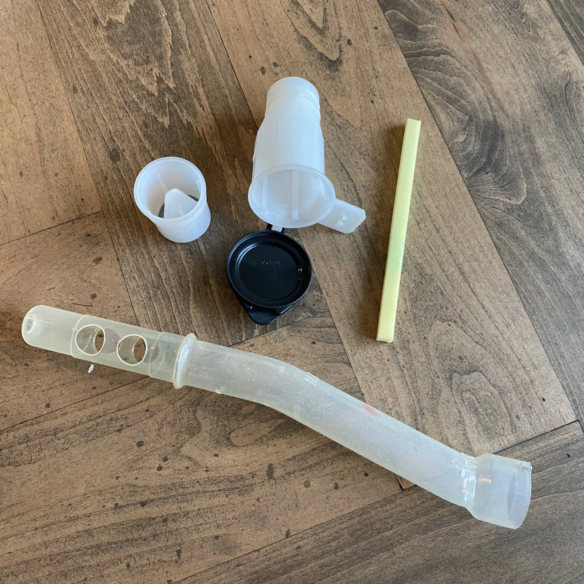

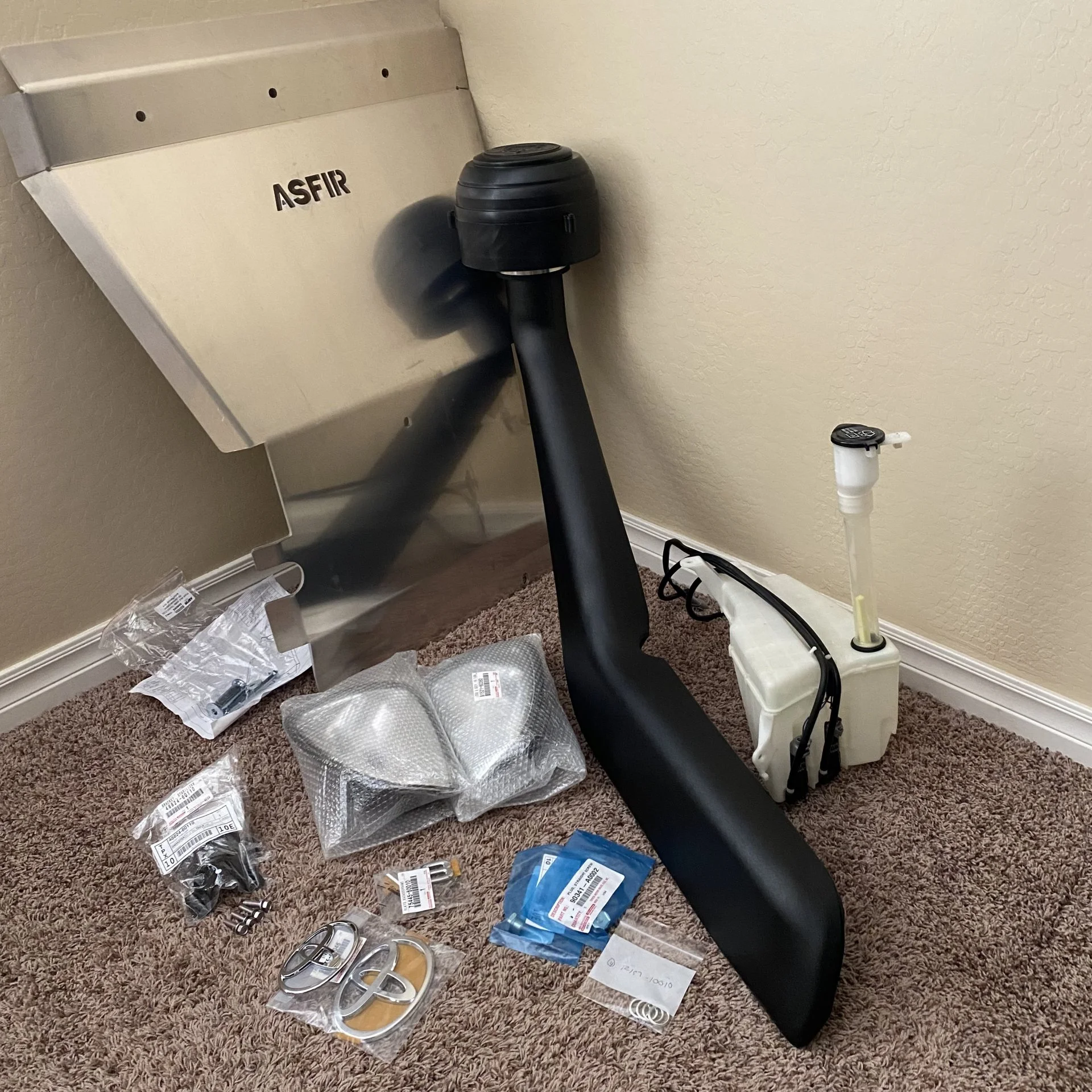

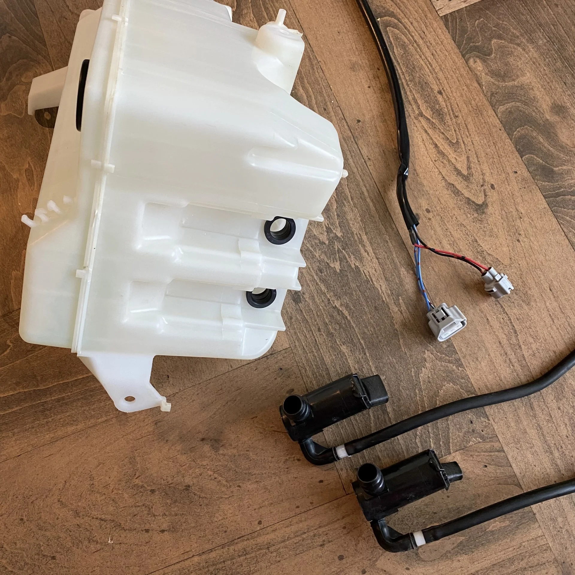

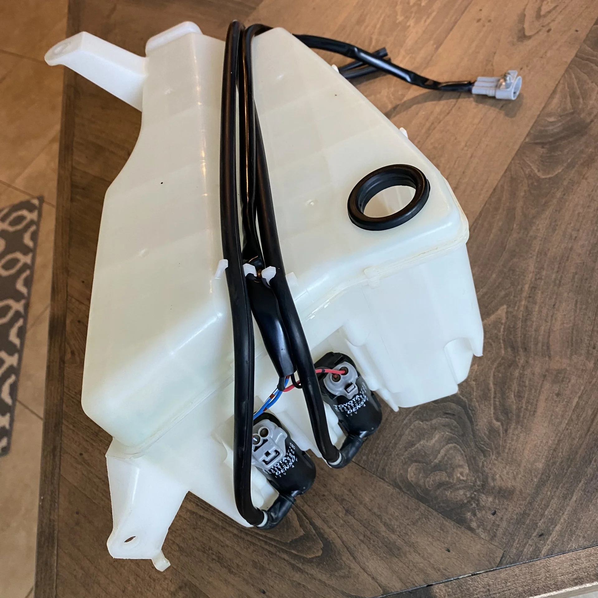

New washer reservoir for larger battery or just replacing the one that's in there?
Actually that’s my original one. It was covered in battery acid plus 14 years’ worth of crud and grime. I was seriously considering just throwing it in the trash, but decided to disassemble it and thoroughly clean it up. It’s like a 9.5 out of 10 now. 😄

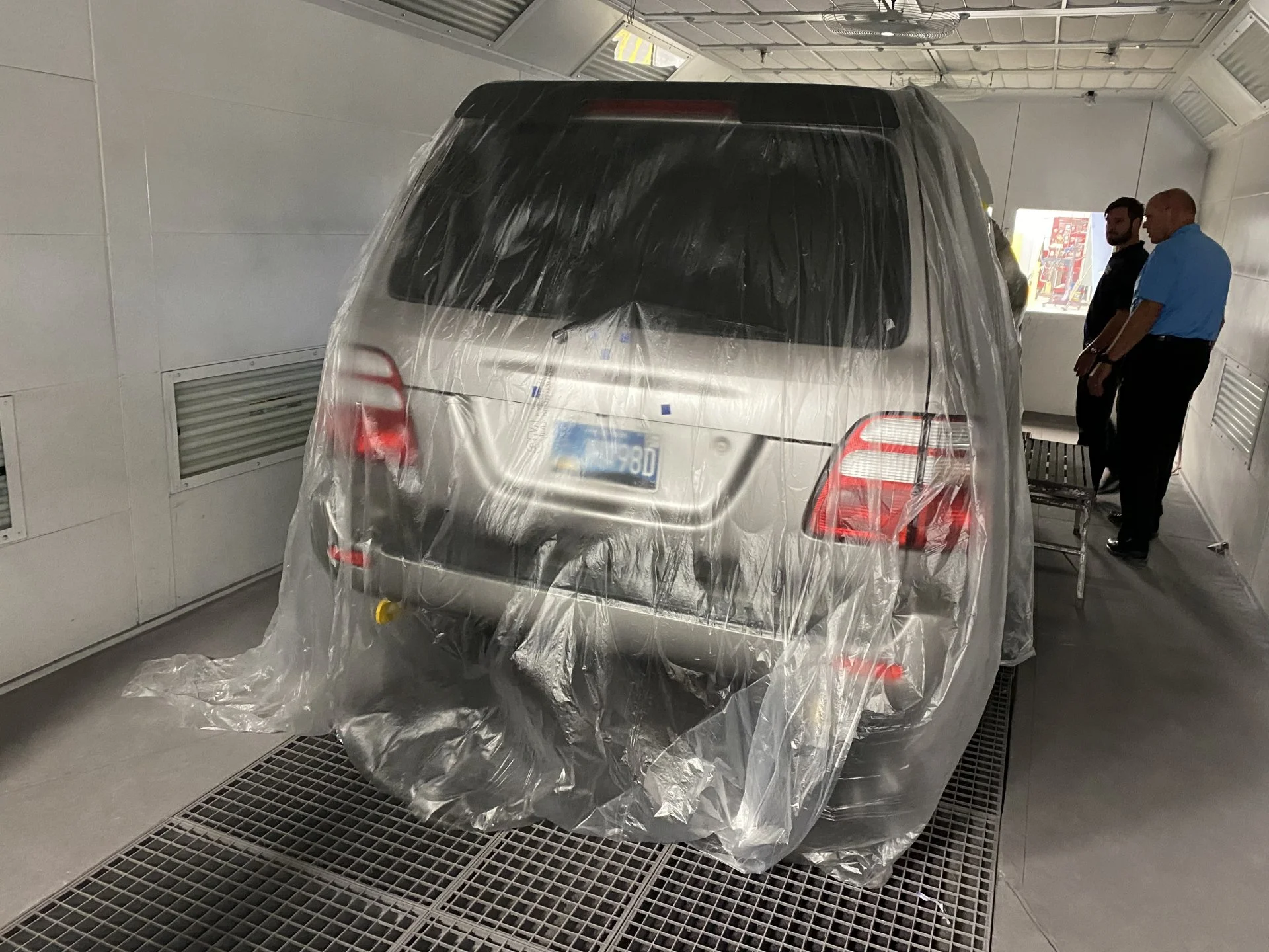

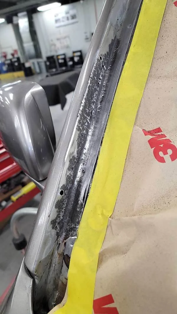

Stopped by the collision shop to visit Thundercat for the first time in two weeks. Owner in the blue polo was explaining the painting process to me and how challenging it was to get the right shade of Thunder Cloud Metallic. In doing so, he accidentally brushed his palm along the wet paint on my A-pillar. Doh 😖 It needs to be fixed now. Technician was smiling, but you know on the inside he wasn’t 😂 But still on track to get my Cruiser back tomorrow once Safelite installs my windshield.

What did it cost you to have it painted, if you don’t mind me asking?

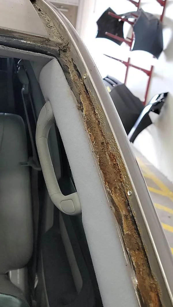

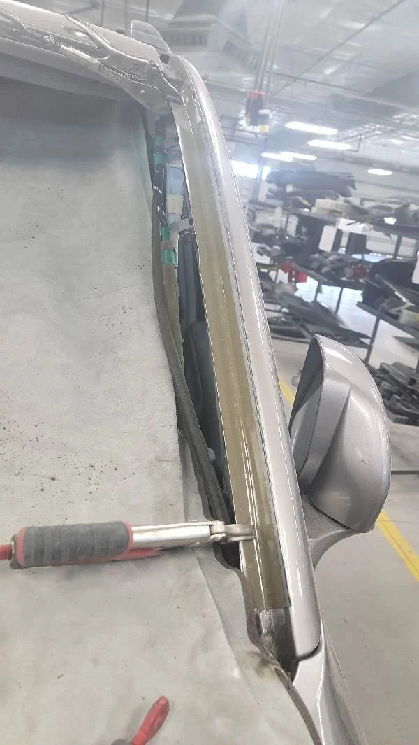

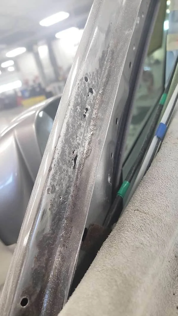

Sorry, I should clarify for others who haven’t seen my posts about my rust repair.
My windshield was due to be replaced, but there some paint bubbling and obvious rust on the A-pillar. Safelite wanted that addressed first, so I took it to Caliber Collision. Original quote was like $568 to sand down the rust, repaint the window opening, etc. Unfortunately, once the windshield was off and the moulding pulled back, it was discovered that the rust was like 50X worse. So they had to grind stuff down drastically, fab some pieces and weld them in. I’m at about $1,200 right now. But it will be fixed right and that’s what I was most concerned about.

Are you planning to have them use the rivets again or going with the non-rivet alternate installation method that someone had figured out?
