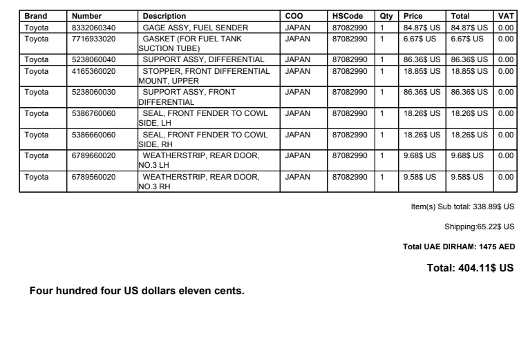

I got the pump from amazon and the fuel level sender unit from partsouq. Don't forget the gasket for the tank, see the first two items in here. Better get the pump from partsouq too but here is the amazon link which was right fit and still running - https://www.amazon.com/gp/product/B00274QIVM?tag=ihco-20

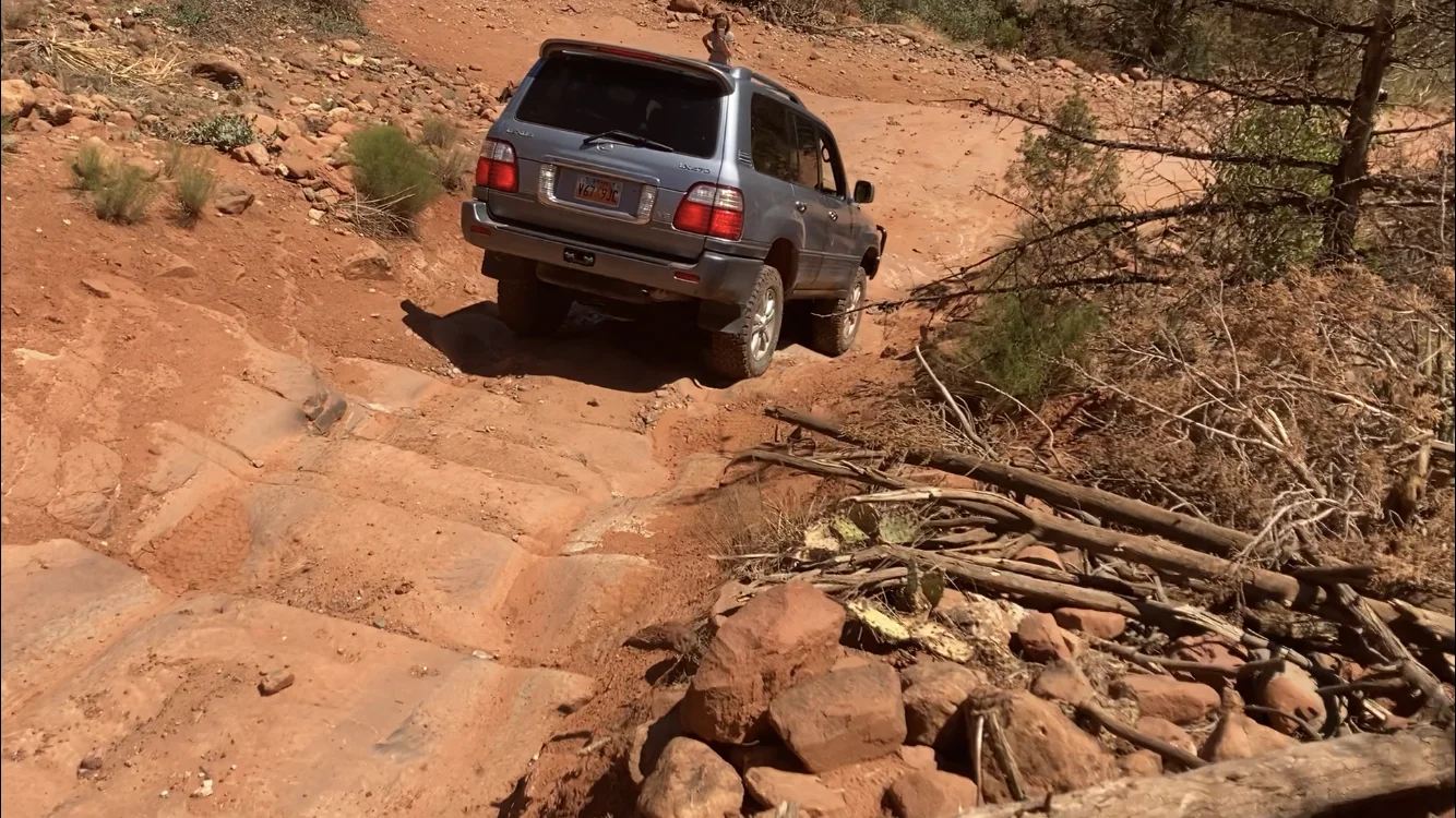

I got over 250k on mine, and just replaced both while I was in there doing the diff, bearings and ball joints, since I knew I’d be wheeling harder than most. One original is still perfect the other has the tiniest play. From what I understand, having the front locker takes some stress out of the whole system when wheeling hard and lifting tires. When in Moab, AHC was on high for hours, but going very slow. I only use it when high clearance is needed now. Didn’t use it for Devils Staircase.
