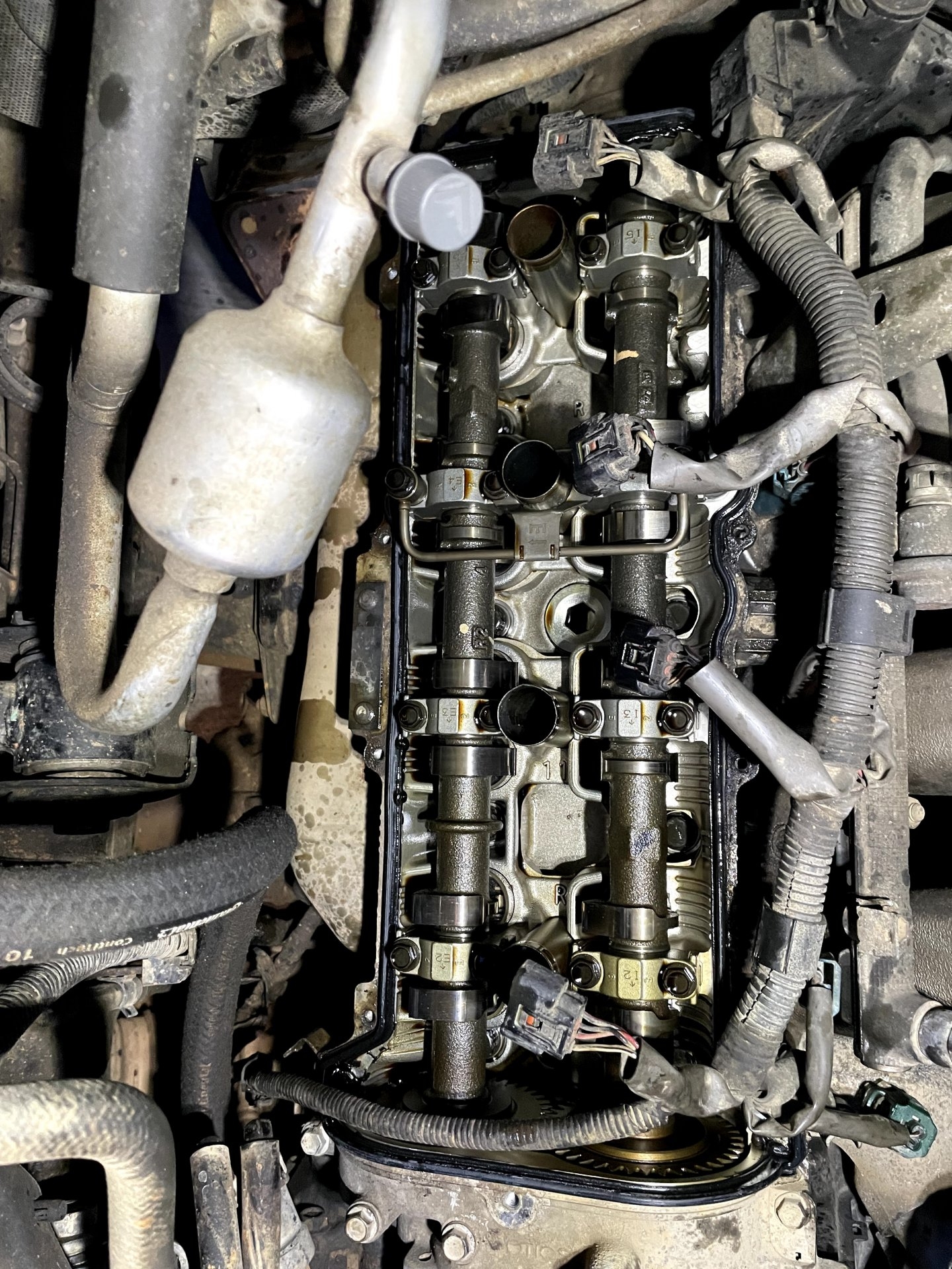

Tune-up before a 2,200-2,700 mile road trip to the middle of Wisconsin/Minnesota (depending on what we end up doing). Done several trips to FL and back but this will definitely be the longest trip in the truck and at 525,000 miles no less.
Doing:
Valve cover gaskets (Fel Pro kit)
Tube seals (these were either original or the whole cover had been replaced because the tabs had clearly never been bent back for replacement)
Spark Plugs (Denso TT)
Coils/boots and springs (Denso/Beck Arnley)
Both upper ball joints needed replacement (boots ripped and starting to creek), decided to do lower "while I was there" (Moog/555)
bearings grease and repack
pretty clean for 525K miles actually, been using BG EPR in the crankcase each oil change, not sure if that helped clean it up. I had incredible luck with this, every bolt came out, nothing stripped, broken, or stuck. Plugs were just as they should have been, the rear most coil was the only that didnt look good, seem to have some heat marks on it.

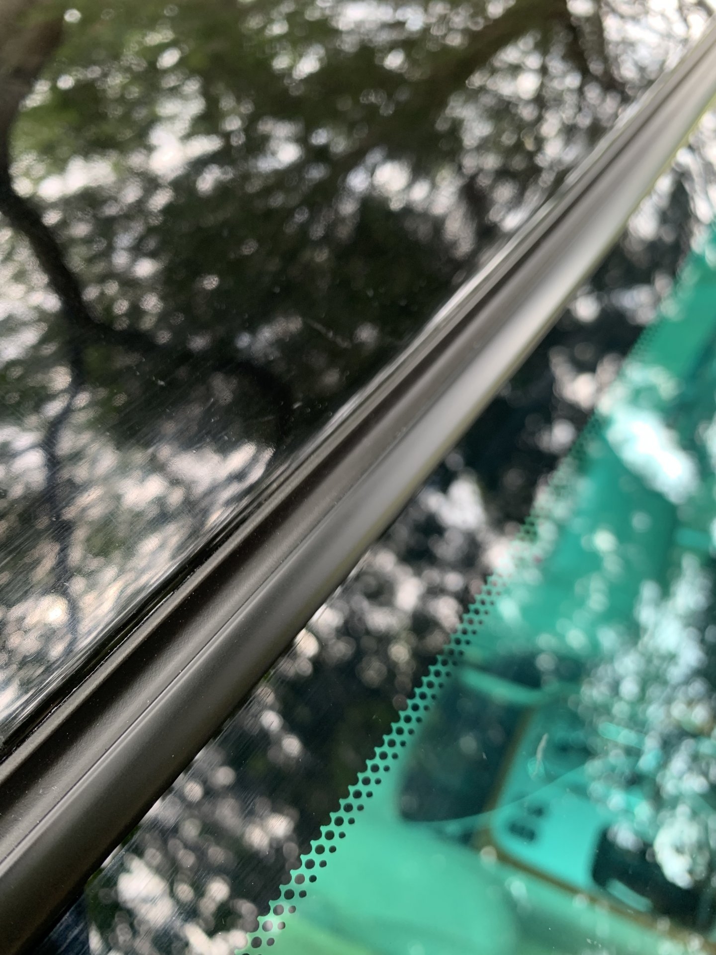

Also did the JDM rear wiper, other one can't seem to stay at a parallel level to the windshield bottom and drove my OCD nuts

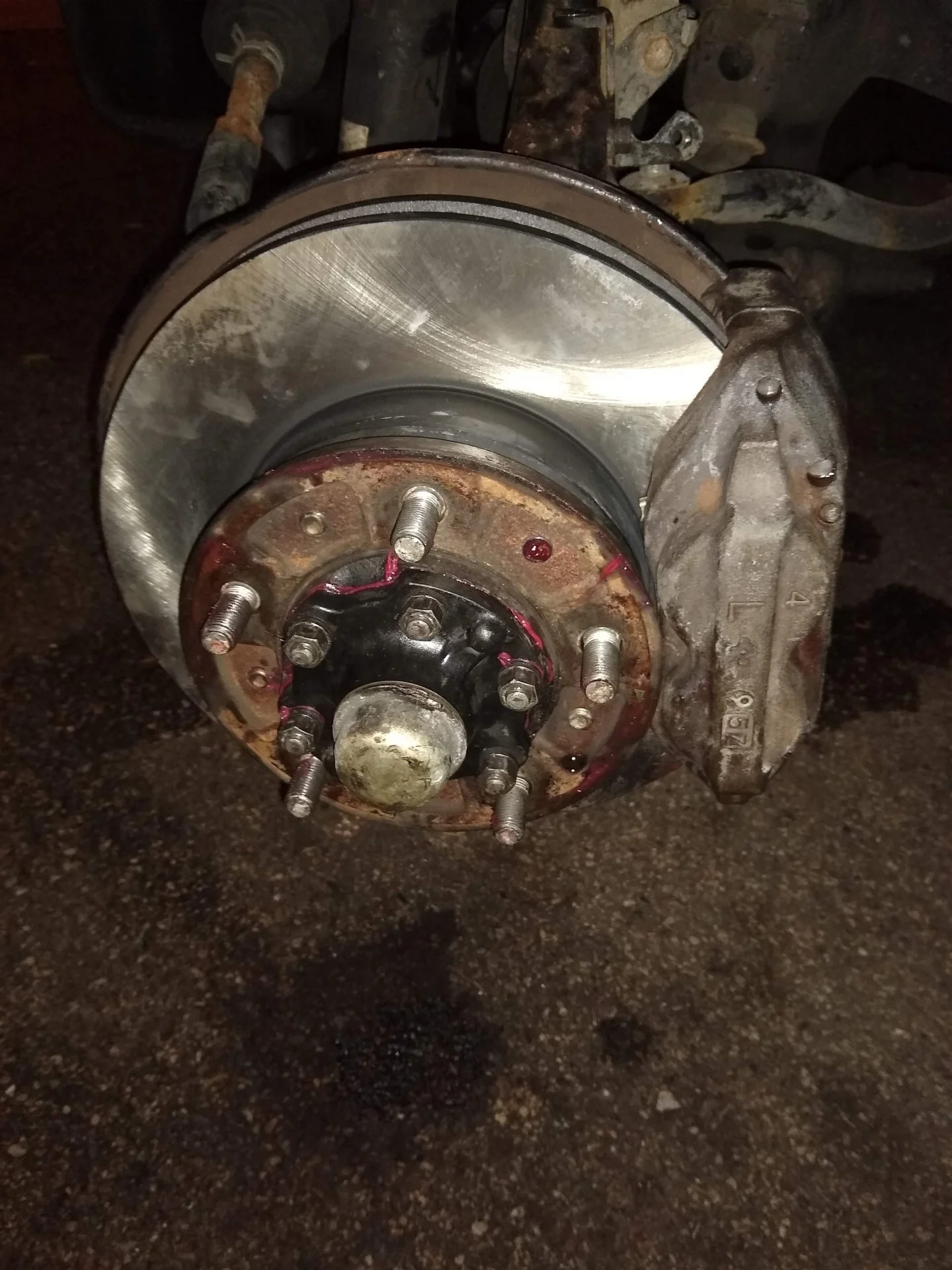

Finished up the lower ball joints and brakes. Also welded up a sleeping platform with room for 4 storage bins underneath. The plywood has a hinge so it can fold over the middle row seats and fit a queen size air mattress.
Don't worry I cleaned the rotors after this pic :)

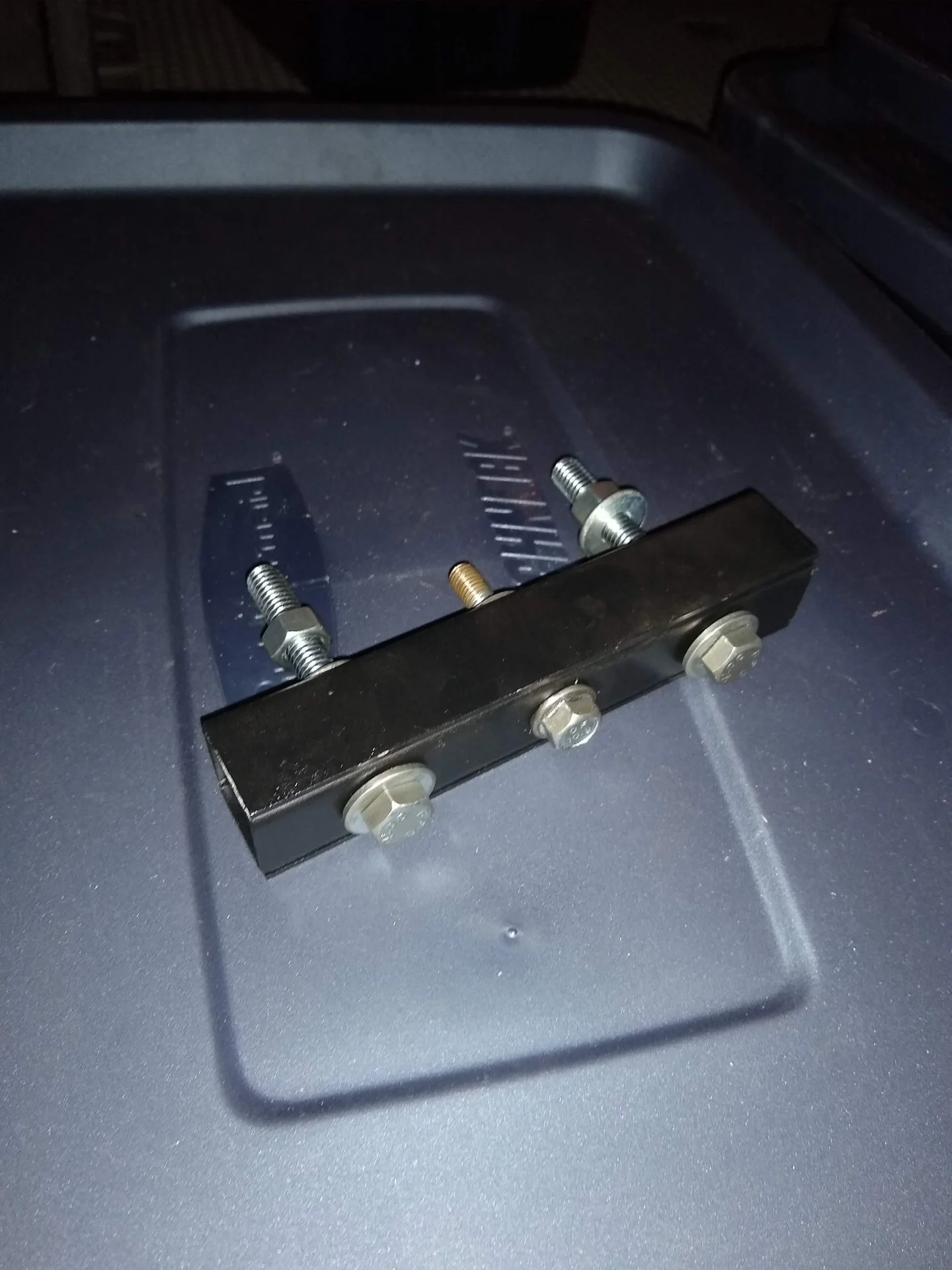

@TheForger CV puller tool came in handy. No more slide hammering!

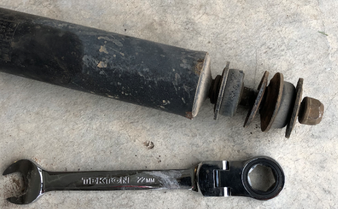

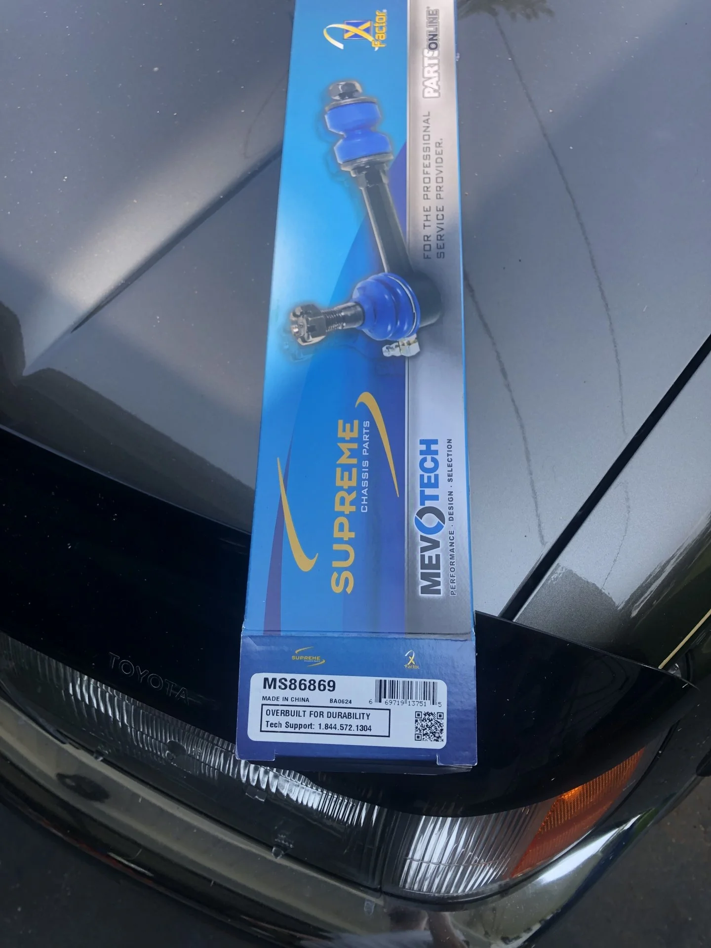

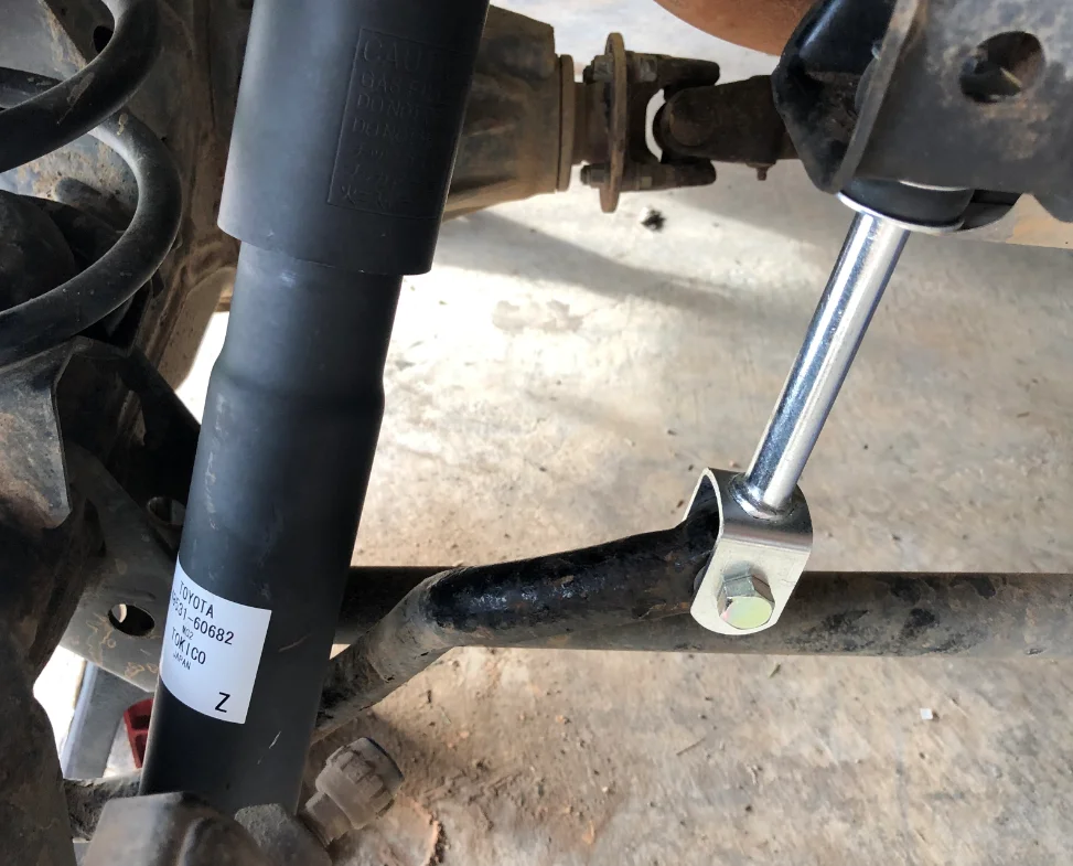

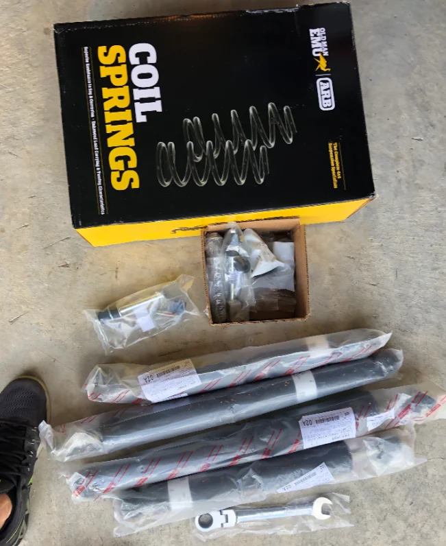

Well, I got part of this done. I wanted to do all 4 corners - shocks, sway bar refresh and coils. I got the shocks in the rear and sway bar all refreshed. The front and coils will have to wait. OEM shocks, as I have no interest in lift or heavy bumpers. OEM sway bar bushings, but AM drop link - got the refresh kit from Cruiser Outfitters - only about an hour from my house. Actually bought everything from them - easy button.
NO WAY would I try this without the 22mm flex head ratcheting wrench. $27 from The Depot delivered to mi casa. Worth every dollar.
I sprayed everything with PB Thursday night for a Friday night fight, but my family squashed my dreams, got it mostly done Saturday night. All the bolts came out fairly easily.
The top nut on the shock mount on the passenger side, I used a couple of wrenches for leverage and it broke free - backed off. Even with the ratcheting flex head it was not quick. I can't imagine doing this without it. I would have freaked out - remember - always freak in...

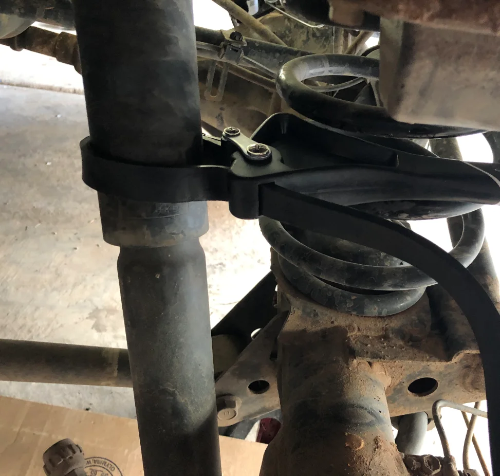

Driver's side was a total bugger. I tried the same method and stripped the head of the shock bolt. insert appropriate emoji. So I tried the strap wrench. Bonk!
More PB blaster please! Took a 6 hour nap and got after it the next morning.
Strap wrench did the job in the morning and the sway bar bushings / links were gravy. They weren't totally smashed but I was afraid the OG links wouldn't want to go back together and then I'd be in a world of crap. The shock bushing were pretty hammered. But for 21 years old! Well done Mr T!

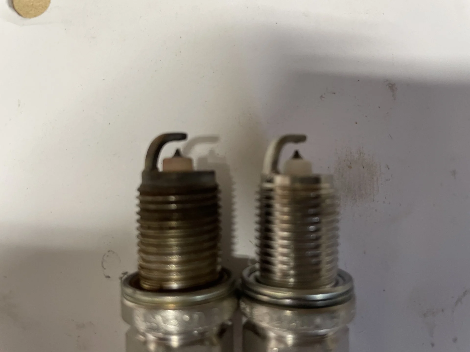

Replaced spark plugs, didn't see anything in the service history so decided just to do it, had a coupon from Advance Auto and ended up paying $48 for the 8 OEM plugs.
This is the worst looking plug, #8 cylinder how does it look? Others looked a lot better. They weren't loose, but definitely wasn't tight, didn't take too much effort to get them out. Current mileage is 215K miles, and all the coils look original, not one of them is a shiny new color, all the boots look okay too.
The rest looks like this, doesn't look bad at all.

I’d examine the coil pack and boot on that funky one and prob replace it with h denso
