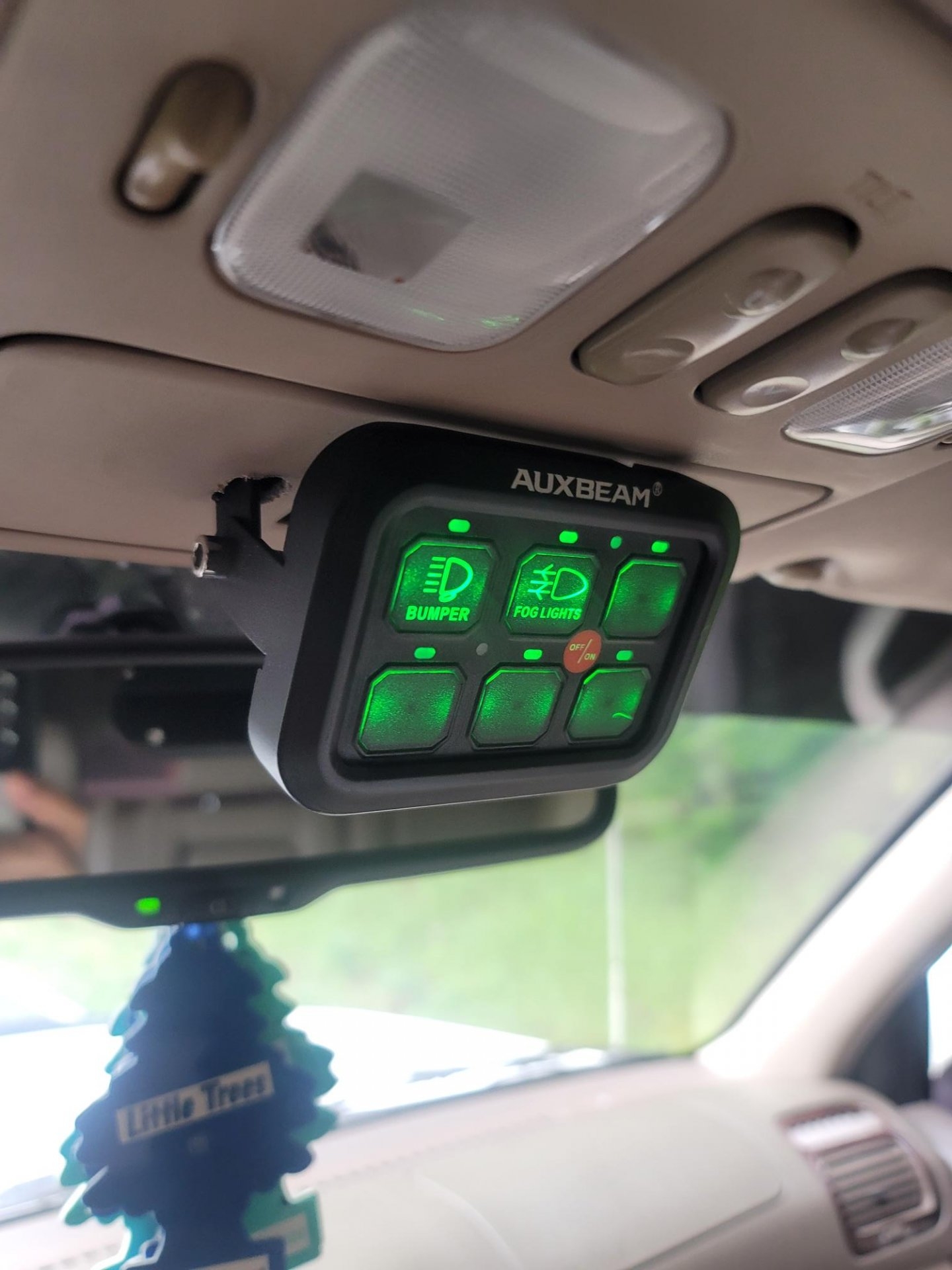

Installed a 6 gang switch panel, only using (2) of the (6), but will make adding lights down the road easier. Mounted the switch panel next to the fuse panel under hood, found to be the best spot. Modified the over head console to mount the switch.

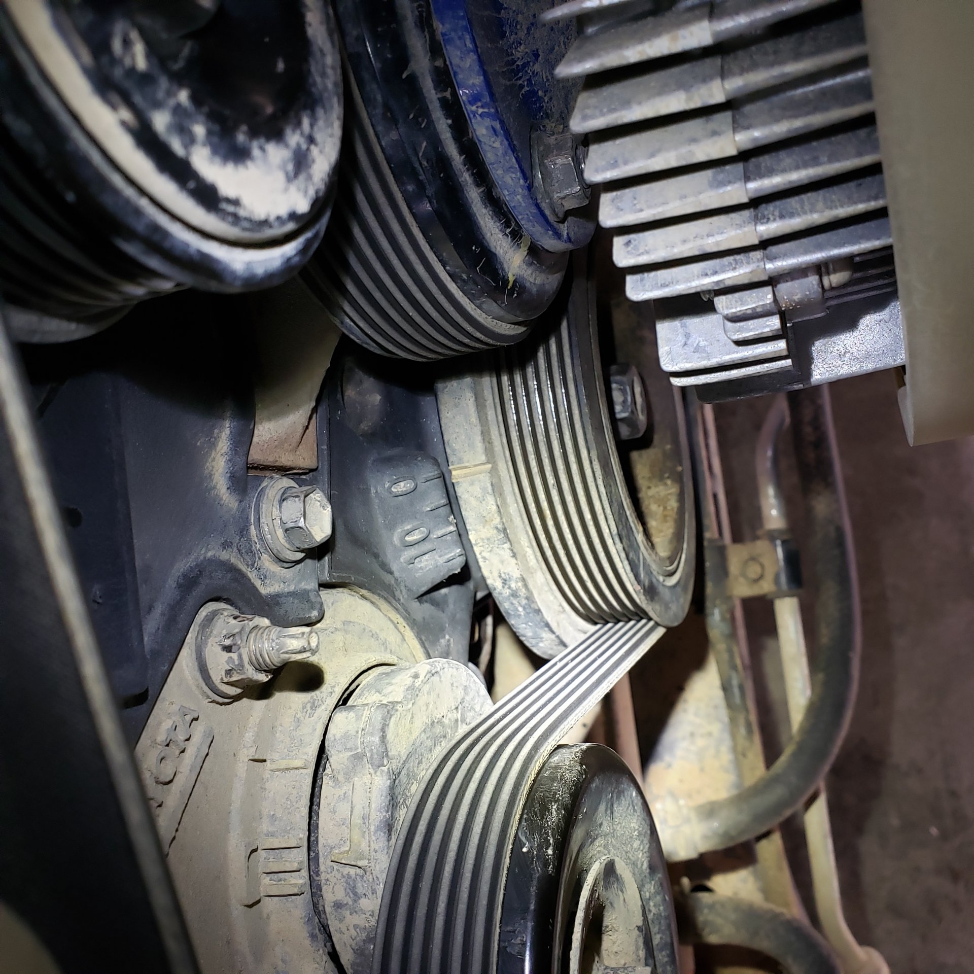

Two weeks ago I drove to the blue ridge mountains to make a video for a summer camp there. As I pulled up to the entrance I heard a squealing come from the engine bay. I quickly pulled over, and shut the engine off but it was too late. I heard a low boom and knew what happened but still could not believe it.
I bought my '99 LX470 in November of 2020 with 241K miles. The timing belt and water pump had been replaced one year before I bought the truck. Sadly the shop that did the job did not bother to replace the pulleys, or use the AISIN TKT-021 TB/WP kit.
My idler pulley exploded, the tensioner pulley seized, and the water pump (less than two years old mind you) seized as well. See pictures.
I was stuck in the mountains with a dead rig full of video equipment. I spent the next few days working since I had been paid to make a video for the camp. In my free time I ordered parts and tools needed to complete the job.
One of the full time employees at the camp happened to have a beautiful garage with just about everything I needed. His generosity still makes me tear up a bit.
I had the LX towed to just in front of Steve's garage and set to work once my time of employment had ended. I attended the camp, Ridge Haven growing up, and their response to my situation was equally as generous. They fed and housed me for as long as I needed to get back on the road.
I started working on Thursday and had to return to Atlanta by Saturday evening. By the grace of some higher power I was able to complete my first timing belt/water pump job in a relative stranger's garage with little-to-no preparation. Thank God for @OTRAMM youtube videos and @Timmy65 's most recent TB series.
Several write-ups on MUD helped me with a lot of the 2UZ-FE specific things for which I had to look out.
Got some help from Cruiser Outfitters and was able to have all the parts within about three days of ordering. Total was $556 for TB/WP/Tensioner/Thermostat/Gasket/FIPG/3 gallons of coolant/crankshaft holding tool
I was so lucky that Steve (garage owner) works on his Jeep (we'll give him a pass) as religiously as I do my LX.
As a word of advice, if you buy one of these rigs and the timing belt has "been replaced," it is absolutely worth looking at the pulleys etc. just in case the shop that did the job cheap skated it.
