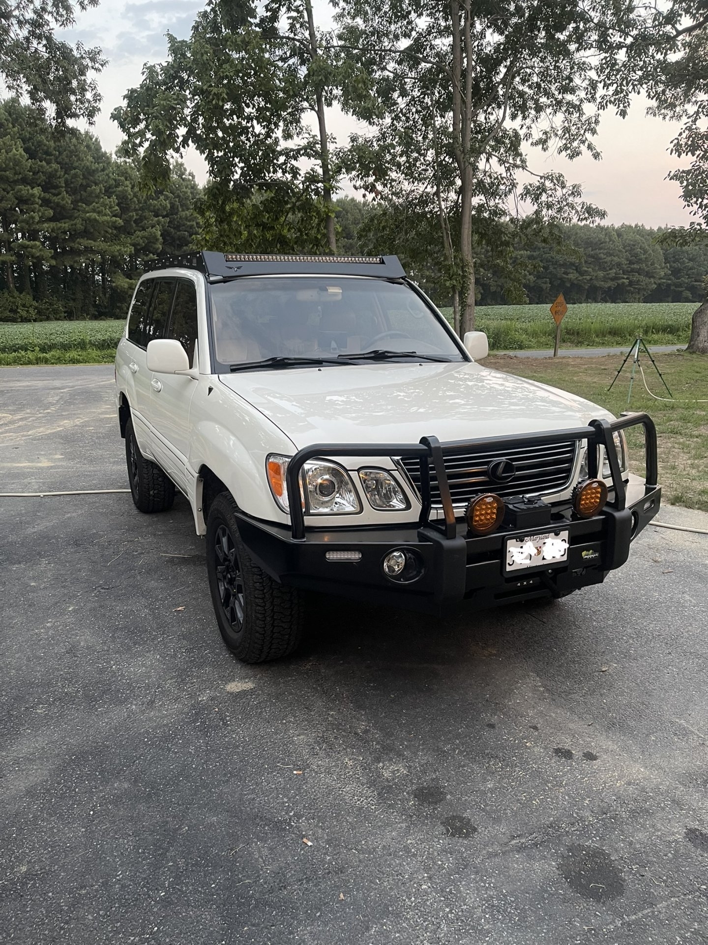

Replaced stock cross bars with 8020 t-slot aluminum extrusions. The extrusions and hardware were ordered from TNUTZ, which I’d highly recommend. Placed order on a Friday night and they shipped the following Monday, all for way less than 8020 brand.
Have a few more things to mount, will be great to flush mount the ski rack in the winter. Not gonna lie, loved how it looked when I had the entire roof rack completely off.

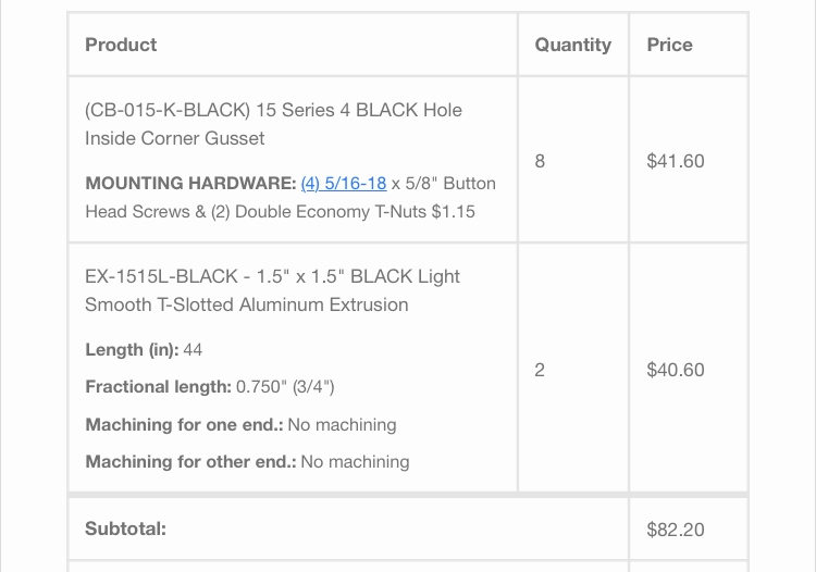

You bet, image below. Only thing I forgot to add was the fasteners but I picked some up locally at Grainger. There are a lot of fastener types available.
Importantly, measure your clearance before you order. Based on another thread it seems 98-02 differs from 03+ on width between crossbars. The cuts I specified in my order came in dead on and their guaranteed tolerance was +\- .015.

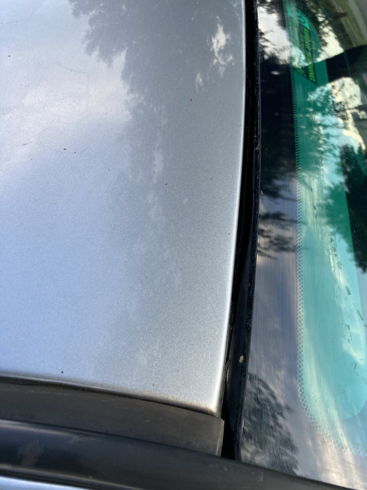

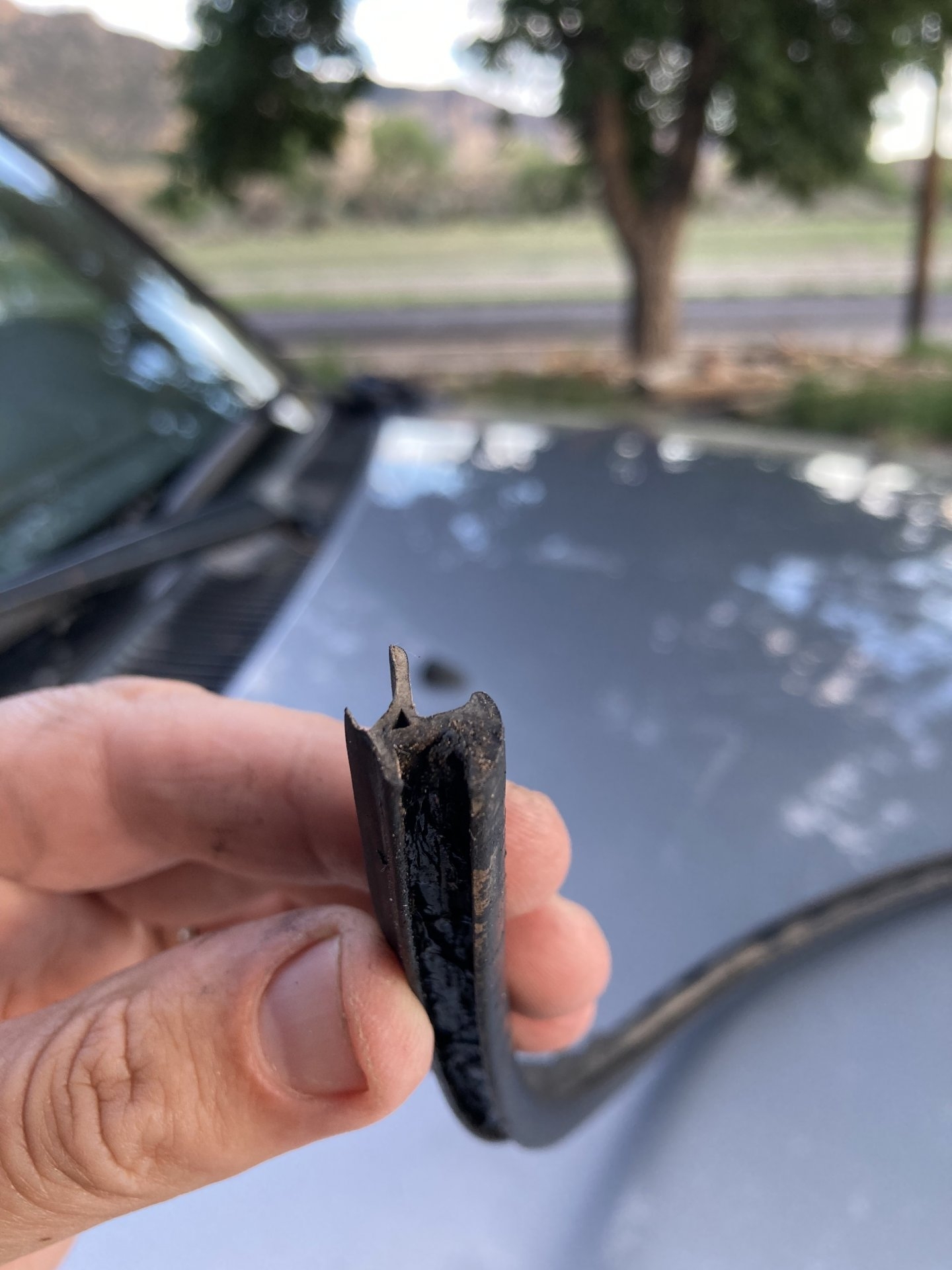

Replaced and resealed the windshield weatherstripping. Cleaning everything was a mess. Adhesive was perfect, but also messy. Wear gloves! The Permatex adhesive is most definitely waterproof! While I was up there I cleaned the seals around the sunroof with a silicone soaked rag since we got a few drops during the crazy down pour last week on the road trip.

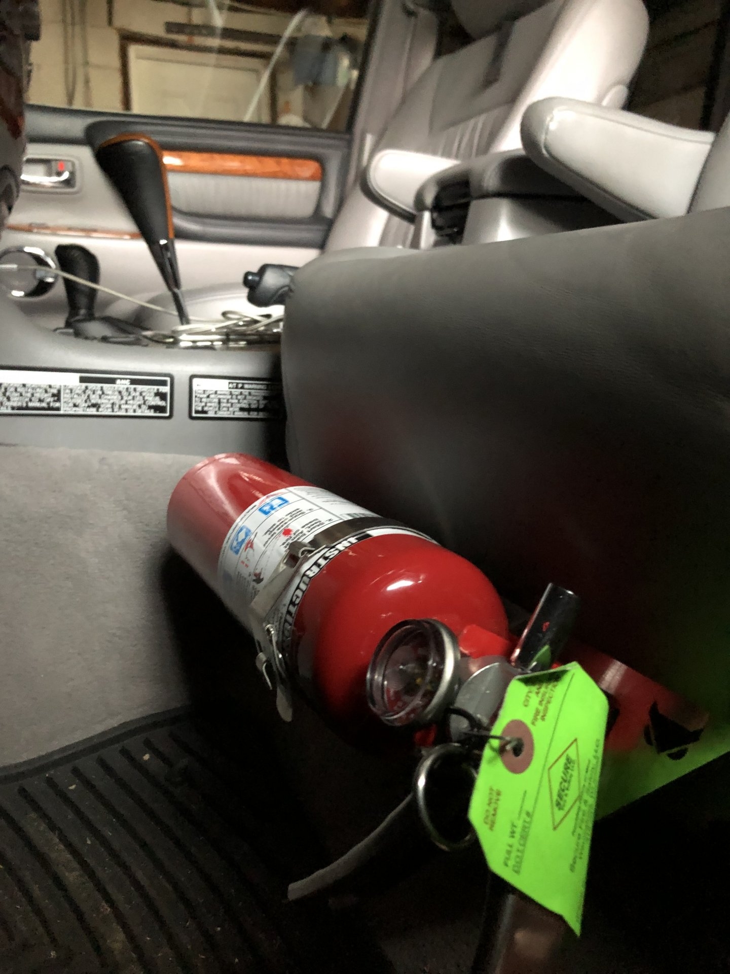

In early July I installed the Owl Expedition Fire Extinguisher/MOLLE Mount. Great product albeit involved install. I need another for the PS...

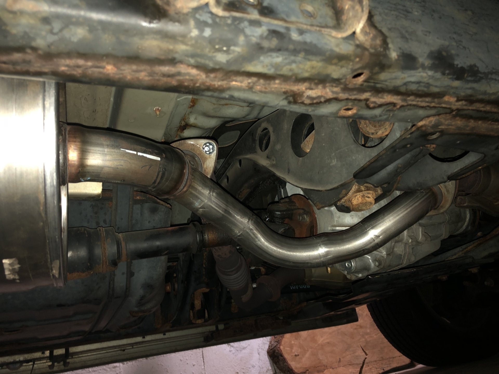

Prior to heading out on our summer road trip I installed a new OEM muffler and associated hardware. The solo install was a challenge, but I managed to complete it without major issue. A lift and a second set of hands would have made for a much quicker install, but such is life. The only real snag I hit was getting the dimple that is stamped into the tail-pipe section the exhaust to line up correctly with the key-way on the muffler pipe. I ended up grinding it down and continuing on with the installation. After over 2500 miles on the intall, I have no issues.
