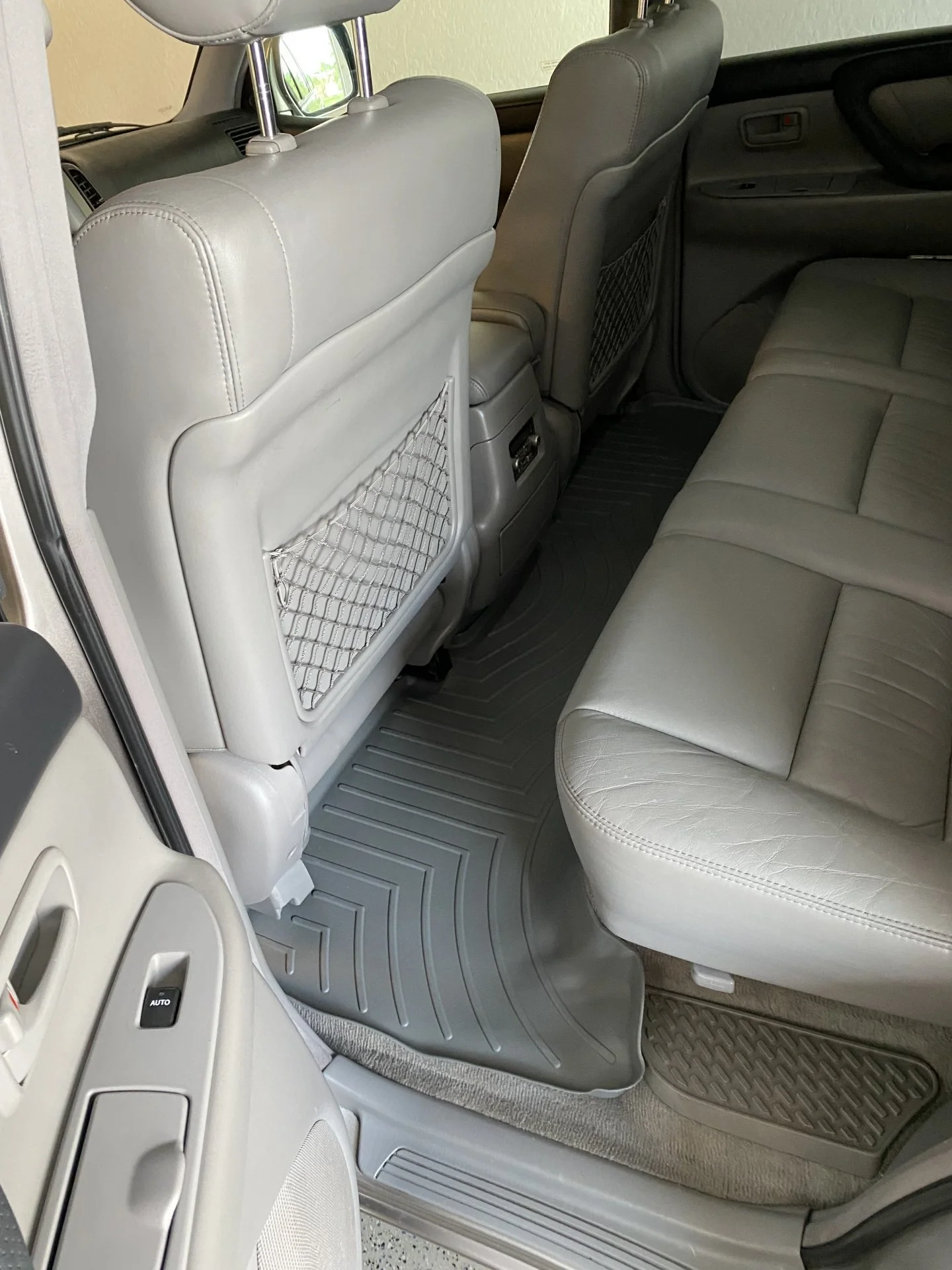

Just like @ClassyJalopy I also got Weather Tech Floor Liners in Gray. I also did some other things...

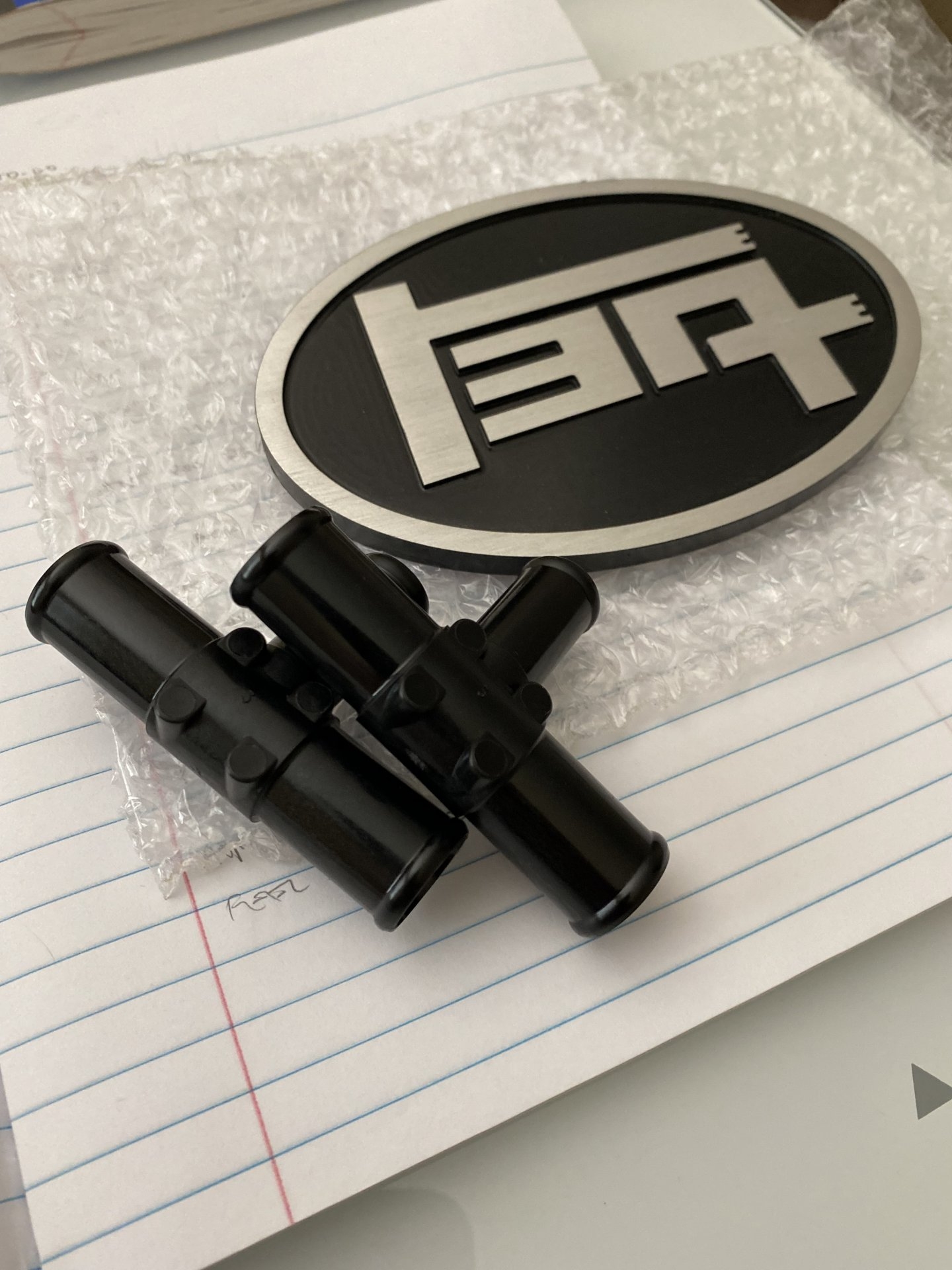

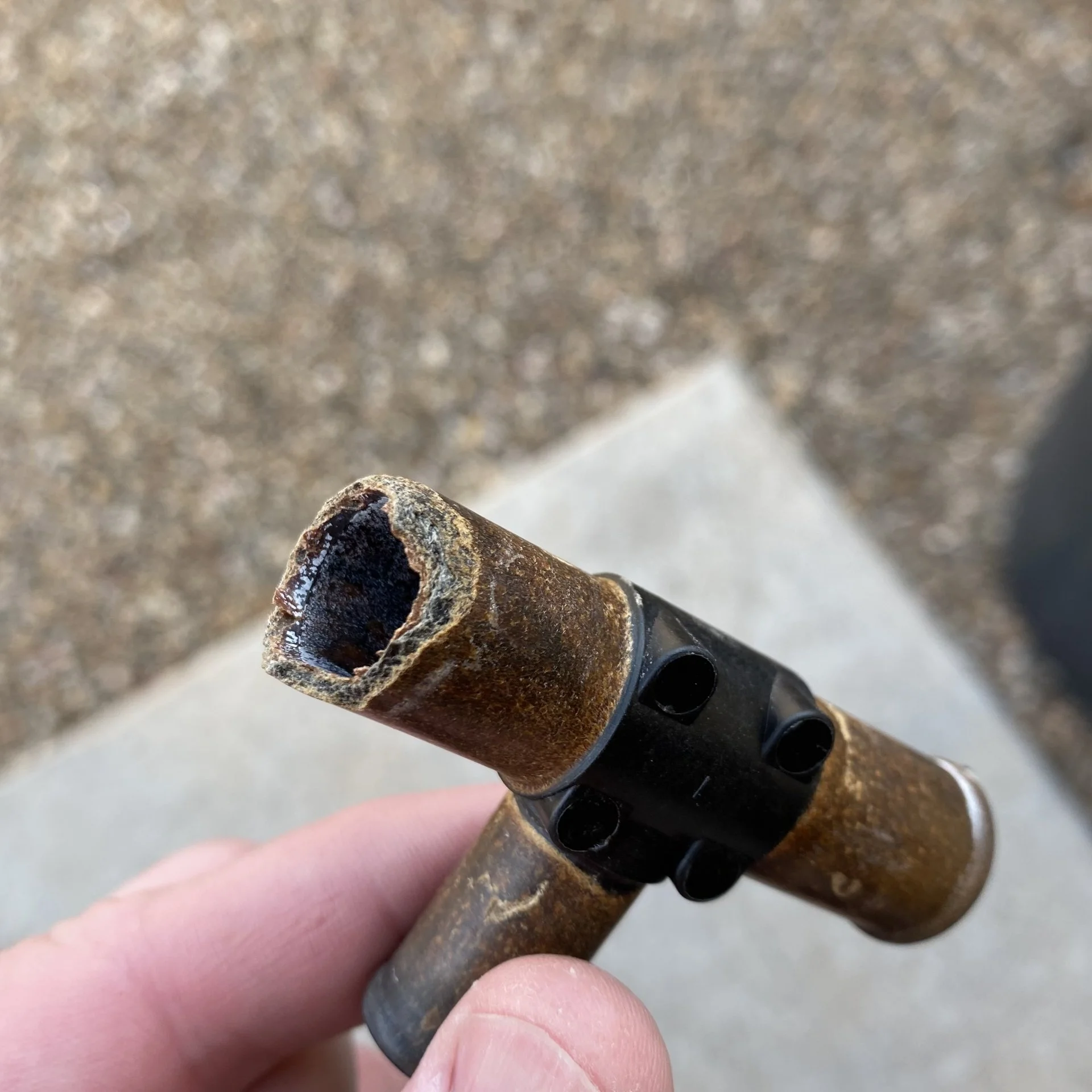

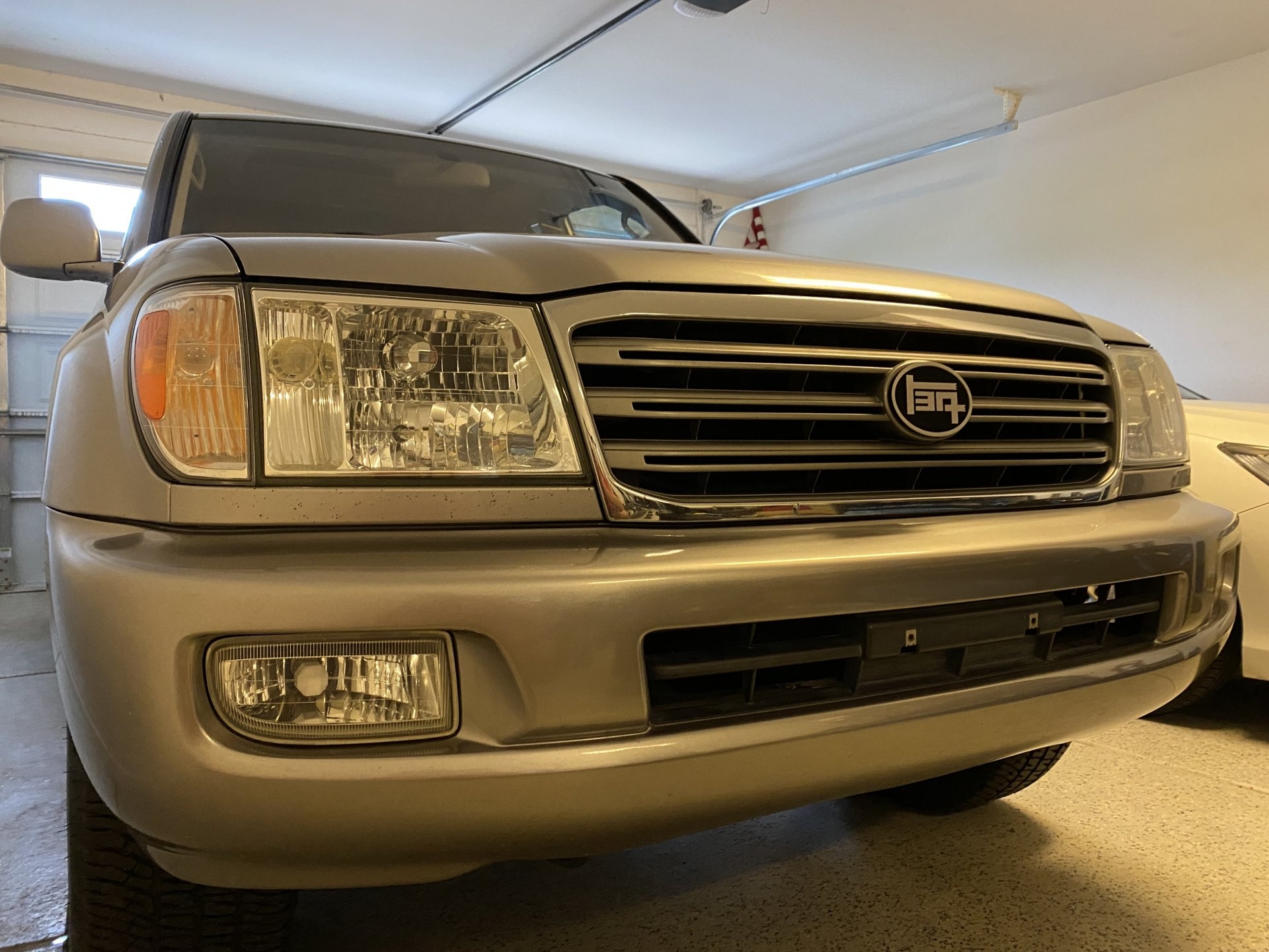

Picked up some Ts from Cruiser Yard on eBay and a "TEQ" front emblem from bh3dprinting.com.
As you can see, one of my old Ts was on its last legs. I had to pull a hose to be able to extract a small piece that had broken off and remained inside.

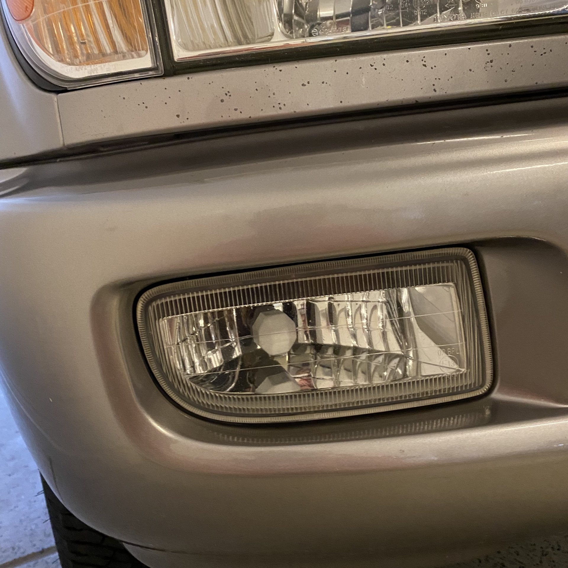

And then I addressed those hazy fog lights by removing them, gently wet sanding them under a faucet with 1500 grit sandpaper and then going over them with Meguiar's Ultimate Compound and an orbital buffer. I then finished it up by applying a light coat of paste wax to protect them. Not bad for a "what've I got to lose?" approach to improve them.

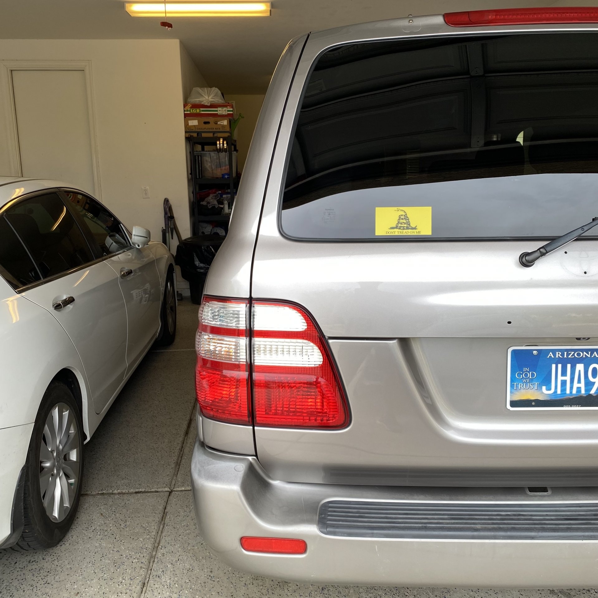

I also removed my rear wind deflector (and my roof rack just prior!). I love the look, but am bummed the holes remain behind as does paint wear and even some bending of the sheet metal from the repeated opening and closing of the lift gate with the weight of the wind deflector attached. My plan is to take it to an auto body shop to see if they can make the imperfections less noticeable.

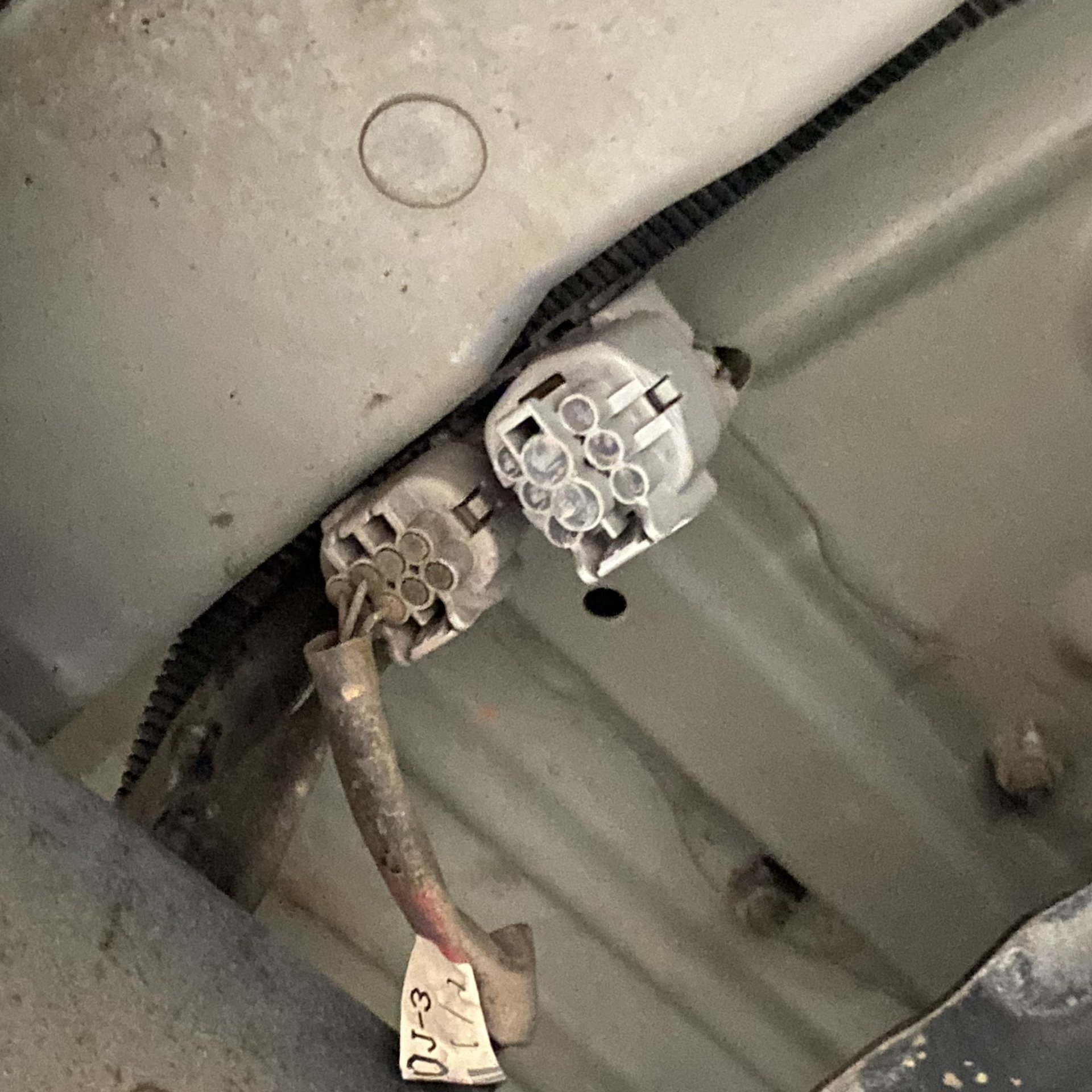

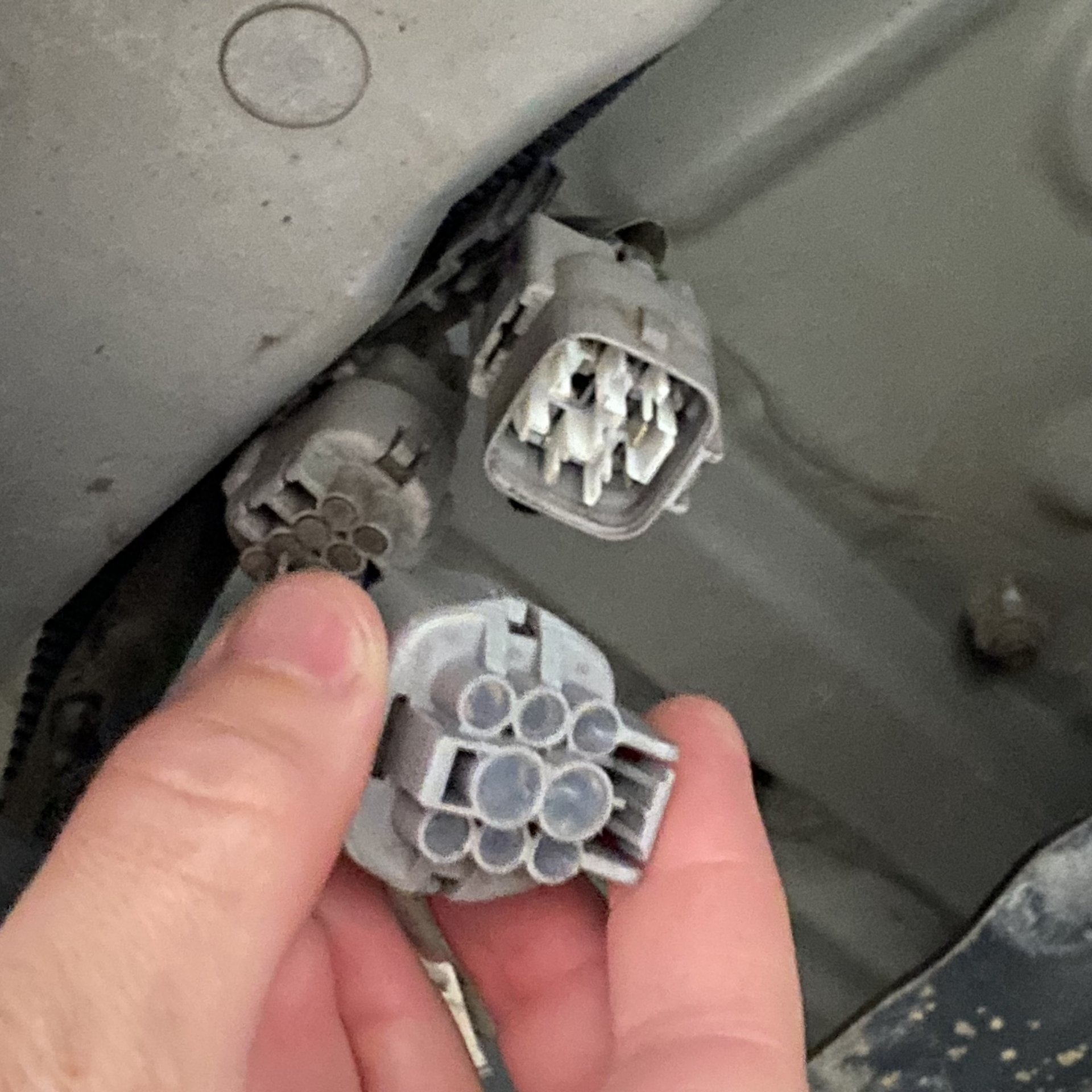

Lastly, I had removed my factory trailer hitch. I unplugged the wiring connector, but this left a plug exposed to the elements. I yanked the wires out of the corresponding connector that wasn't going to be used and filled those holes with Permatex Silicone RTV to seal them off and essentially provide a cap to the otherwise open-ended connector.
MacGyver would be proud.

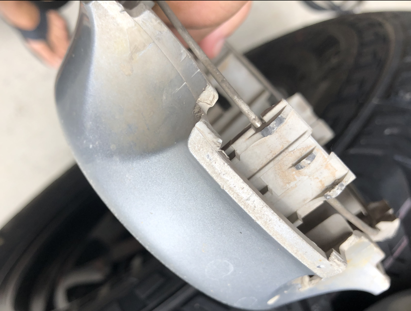

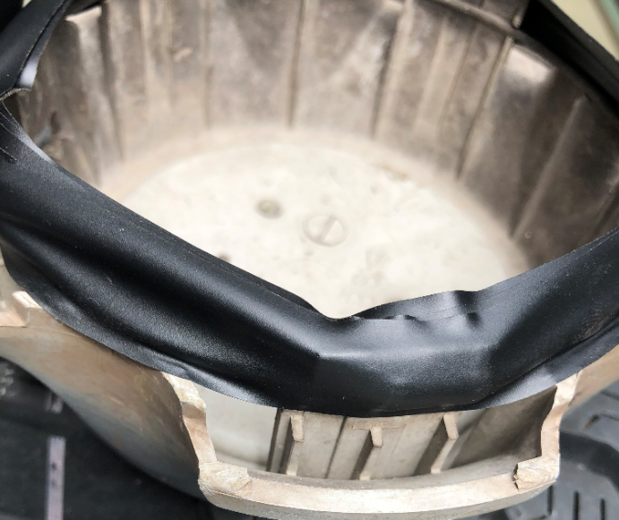

Discount tire said these "hub caps" were fatigued and wouldn't properly go back on when I got new BFG's a couple months ago. eBay wants 10 greenbacks a piece for new ones - clearly that's not Scottish.
so a couple of passes (exactly 4) with fancy electrical tape and they fit like, well... um... like they're gonna stay on till they don't? Let's call it snug.
#science, #ifitsnotscottishitscrap
Add a little bit of silicone to the worn down edges. Mine Started to fit loosely and rattle on the trails so this fixed them up and now they are nice and tight.

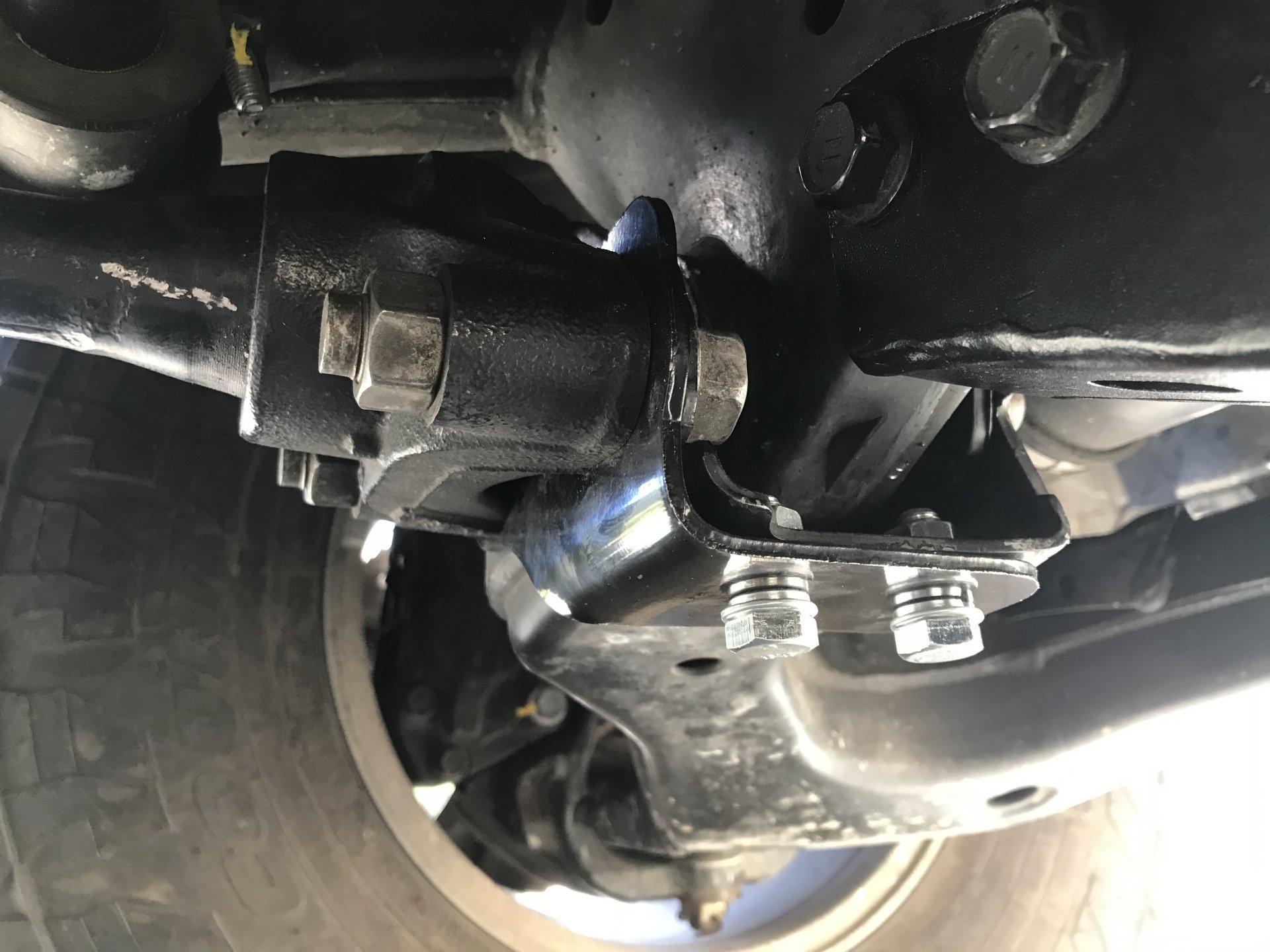

Before heading out I had a few projects I wanted to finish on the truck to get it ready. First up was installing a diff drop and some torsion bar reinforcement brackets from @Ironman 4x4 USA. Both went on like a piece of cake.
At the same time I decided to re-index the torsion bars and adjusted the height to better match the new springs. Next was taking it to the dealer to get one of the rear wheel bearings replaced and an alignment done. Happy to report it seems to have been fixed on the first try. Back in my hands it was time for some more interior work with switching out the old shift indicator plate, making some more progress on my custom drawers, and giving the interior a nice detail (which promptly got nice and dirty).

I installed my brackets almost a year ago but keep putting off drilling the wholes to put the bolts into LOL... Has been fine so far.
I did the same with my fogs till I got to the driver's side and the nut seized on the stud so couldn't get the housing off to wet sand and polish.

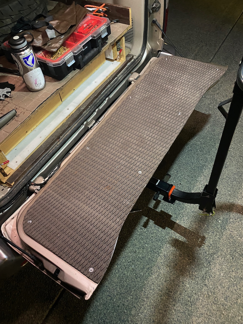

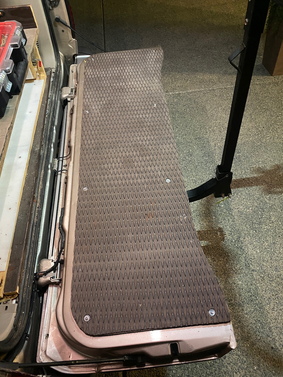

I thought I'd share my latest mini-project on my LX470, a custom tailgate cover. This is made with hydro-turf boat deck foam glued to a 1/4 inch plywood template. It's attached with bolts into rubber expansion nuts in the original trim clip locations. Nothing fancy, but way better than the carpet that was there before.

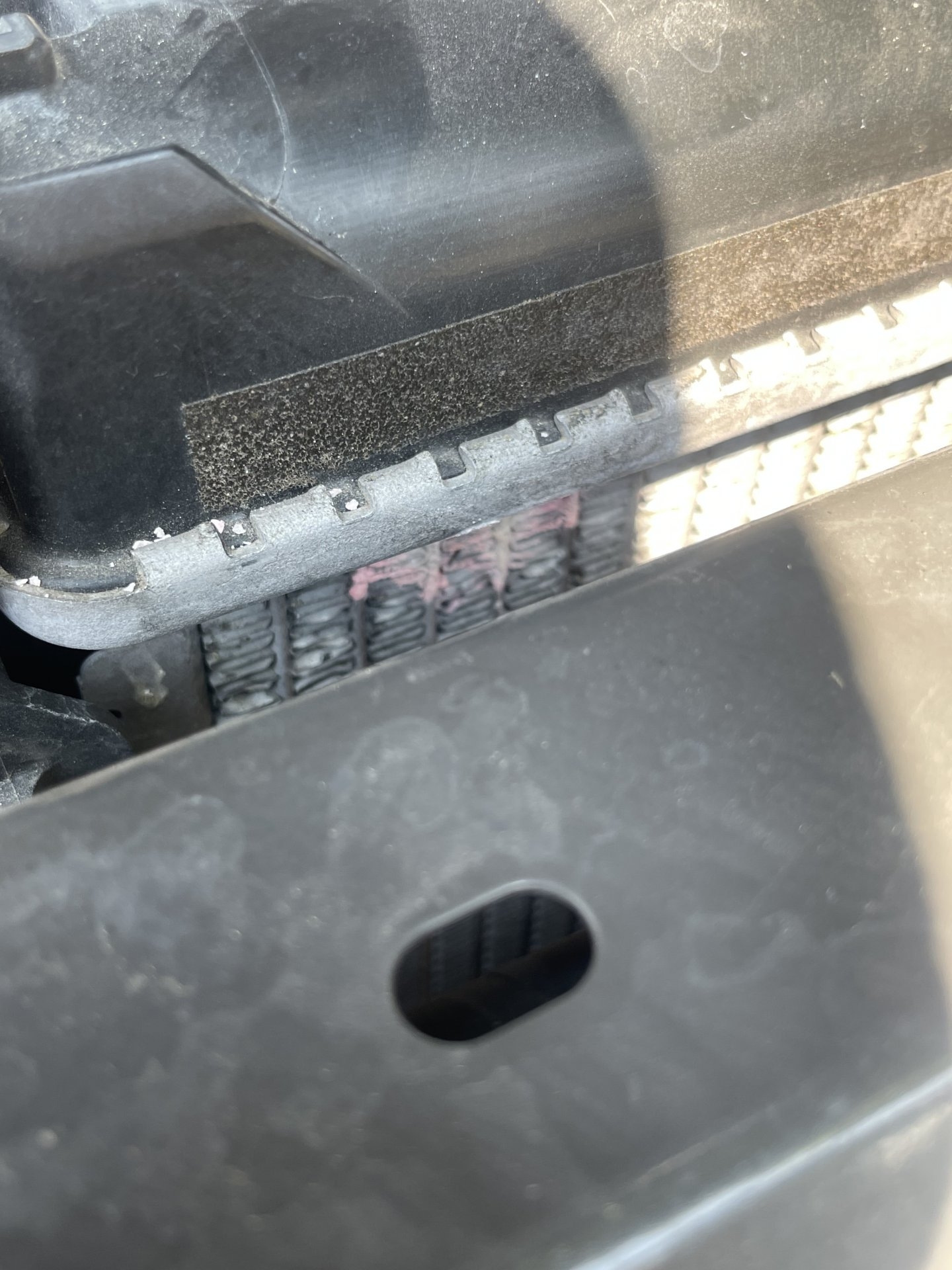

Doing an oil change on the 100 and tundra and found the tundra radiator leaking.
quick googling and an oem radiator is $208 from the local dealer, wonder why can’t the 100 radiator be that cheap lol.

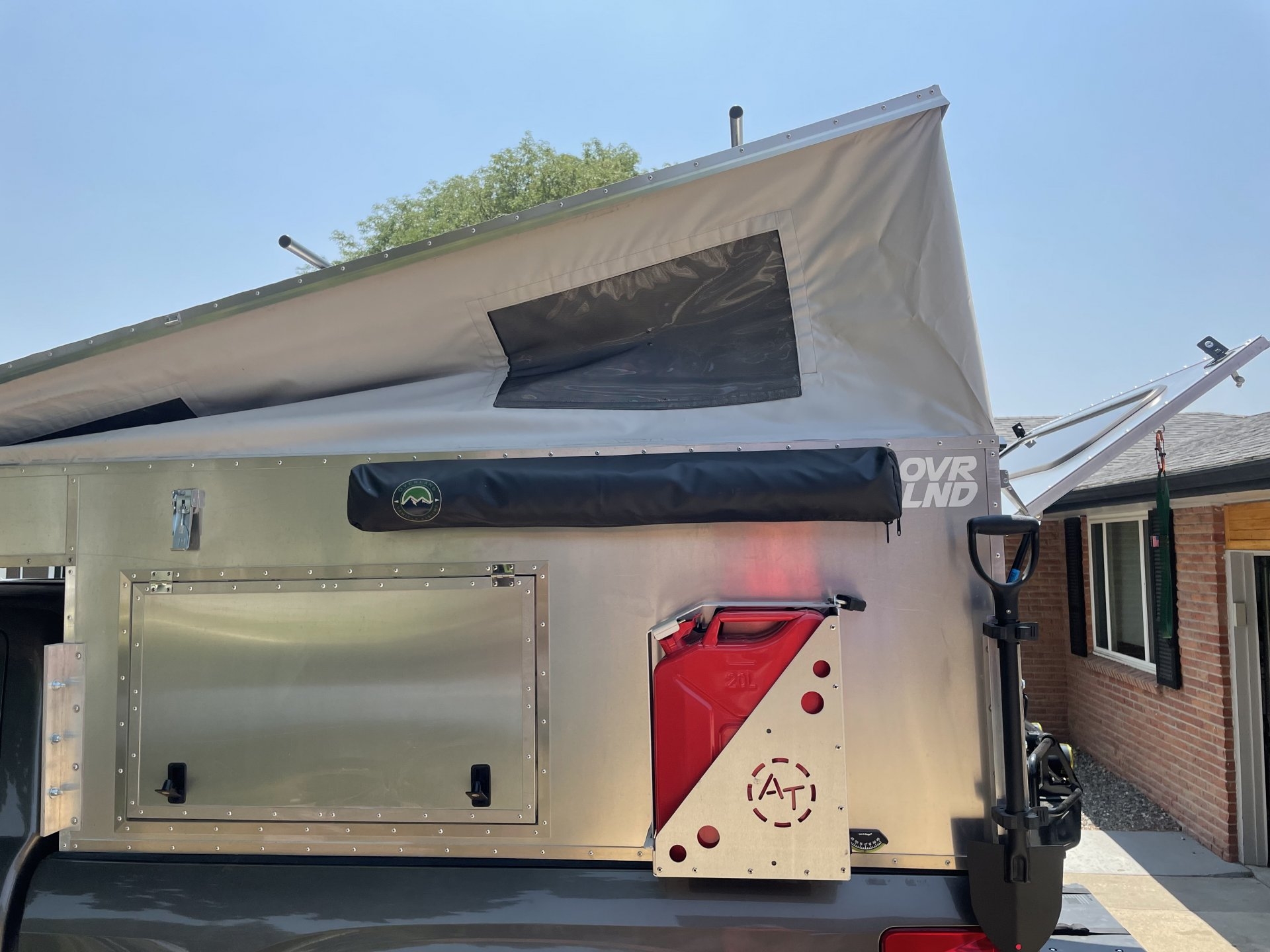

also slapped on a shower / toilet room
View attachment 2743905View attachment 2743906
What room did you end up going with? It's Overland...something. I've been looking here and there and trying to sort out which option might work best.
TIA!
TIA!
I went with the overland vehicle systems room, seems to be pretty good quality and heavy duty fabric. With my research most of the were nearly the same with different hinges and fabric.
View attachment 2743755View attachment 2743756
what color did you use? i'd love to do the same thing to mine
Nice, I like all the custom things you’ve done with your rig
