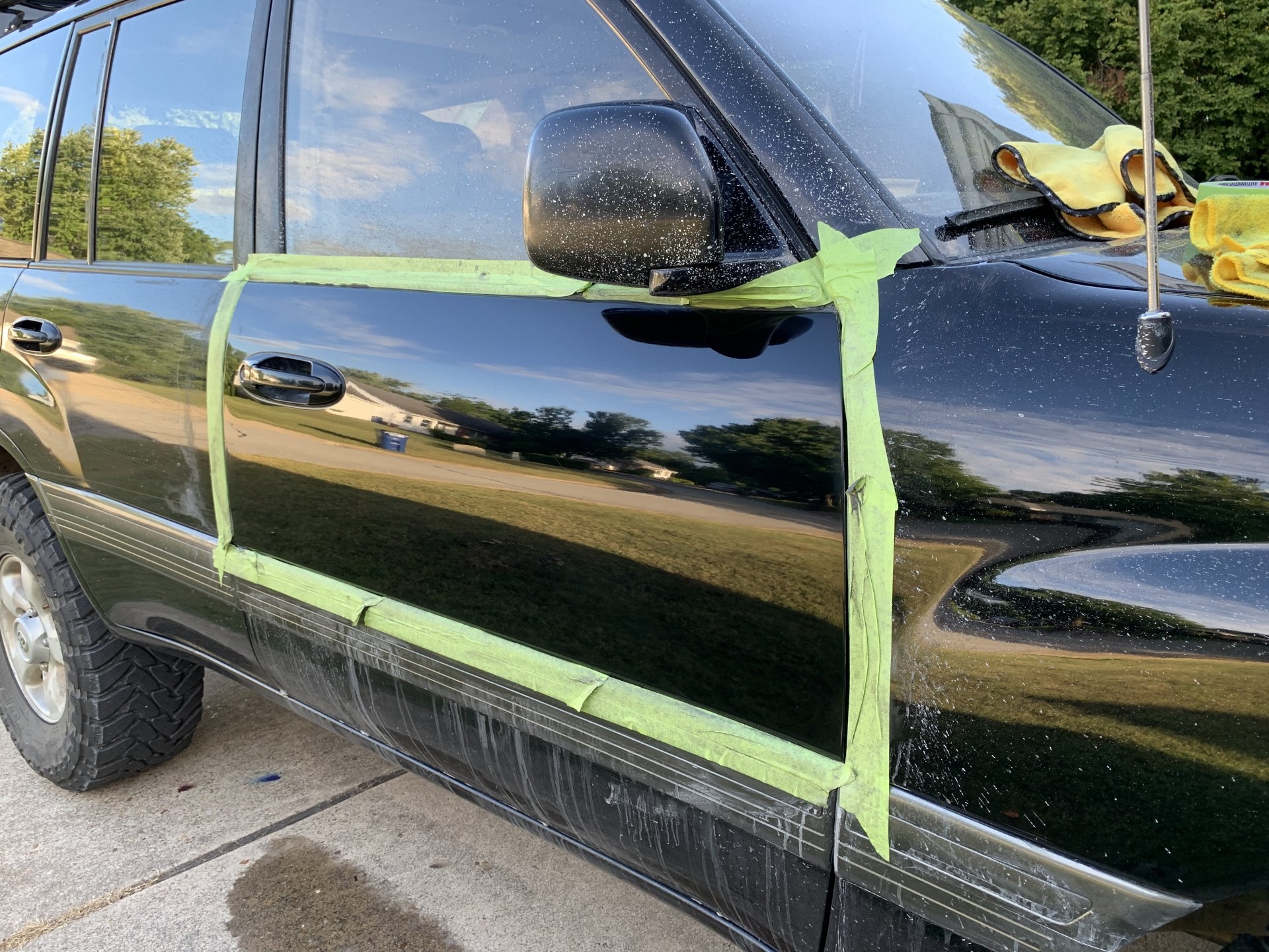

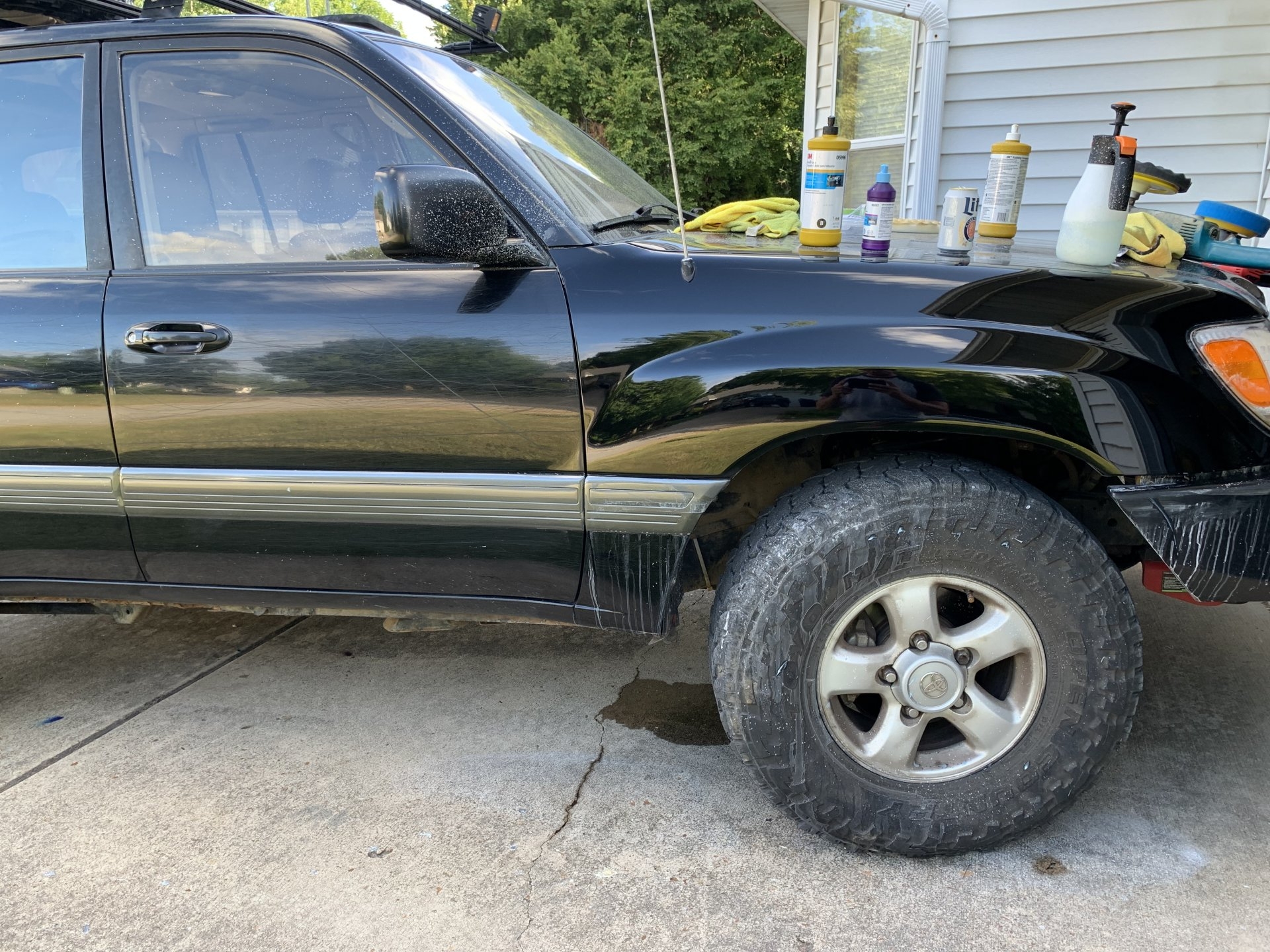

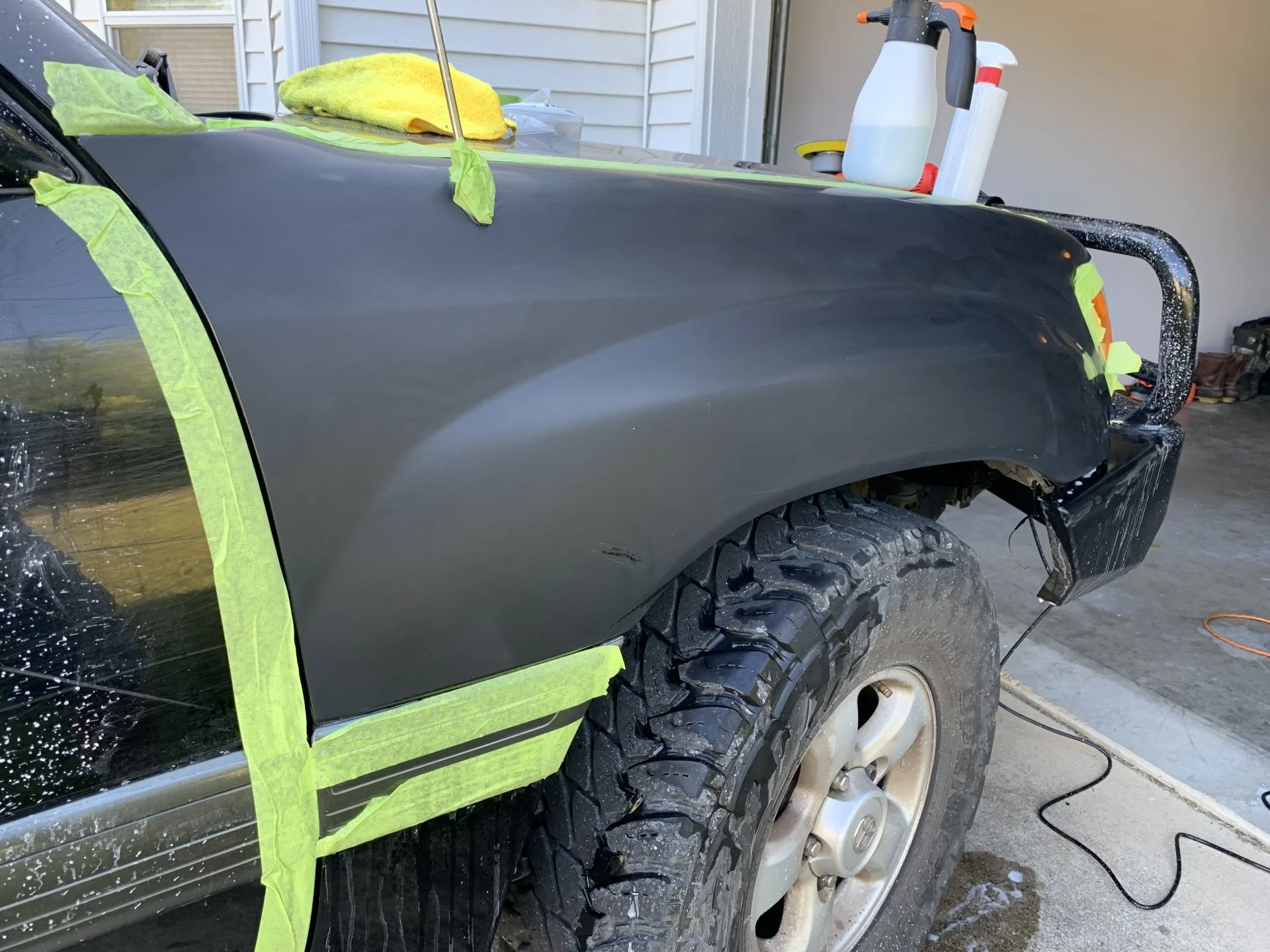

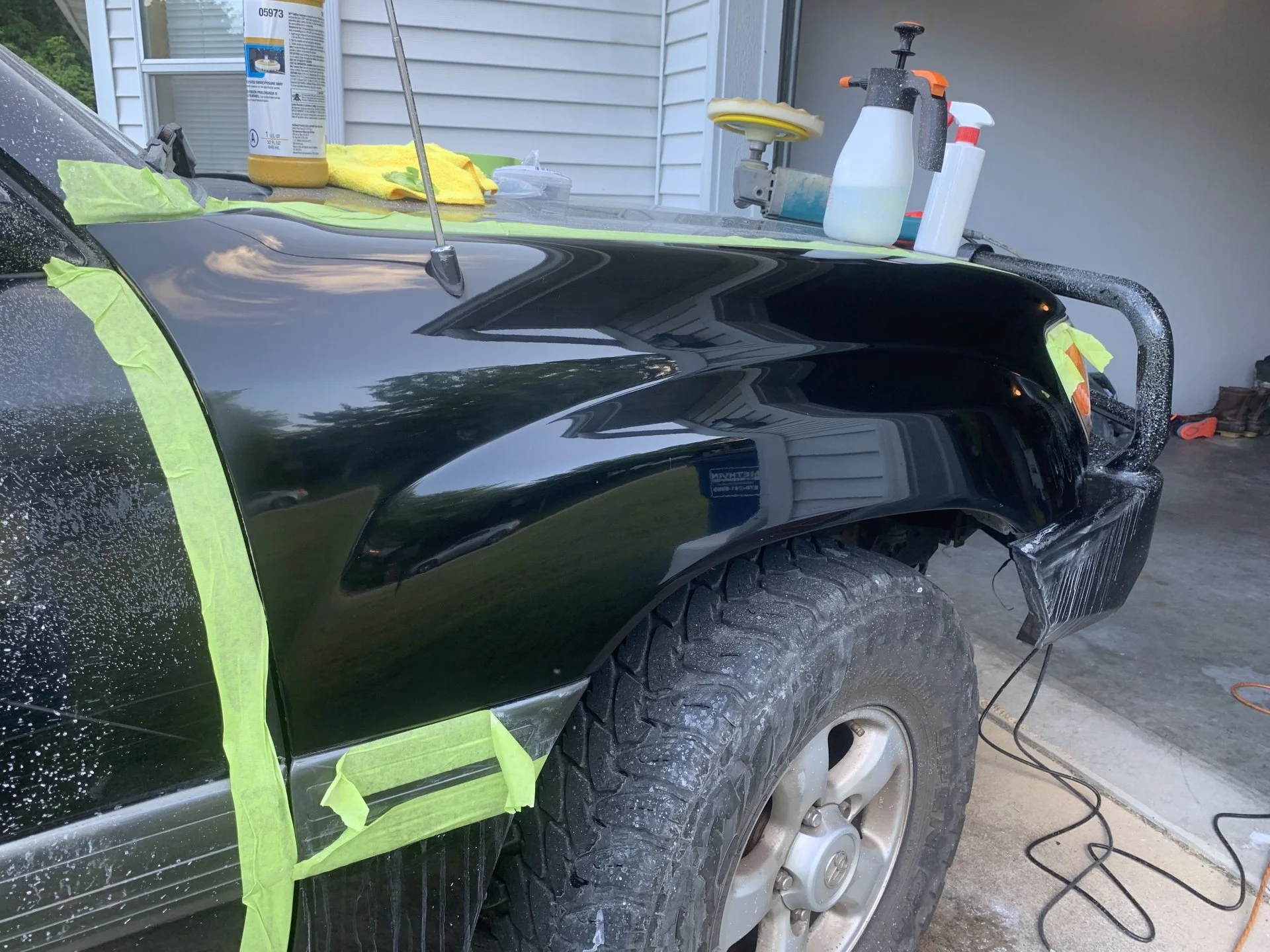

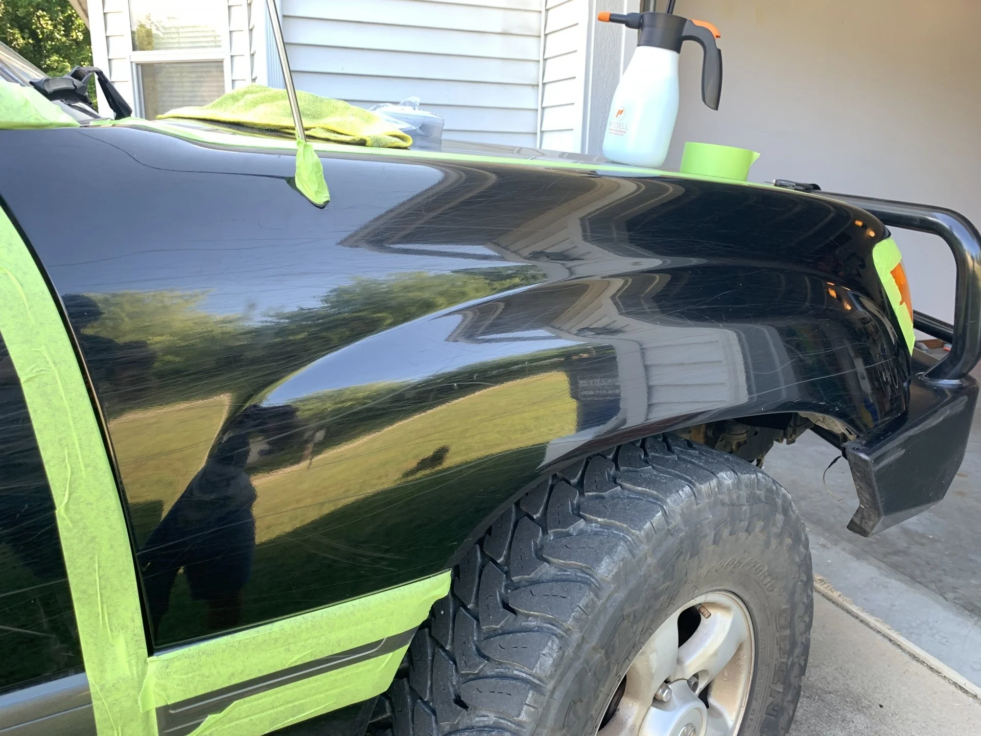

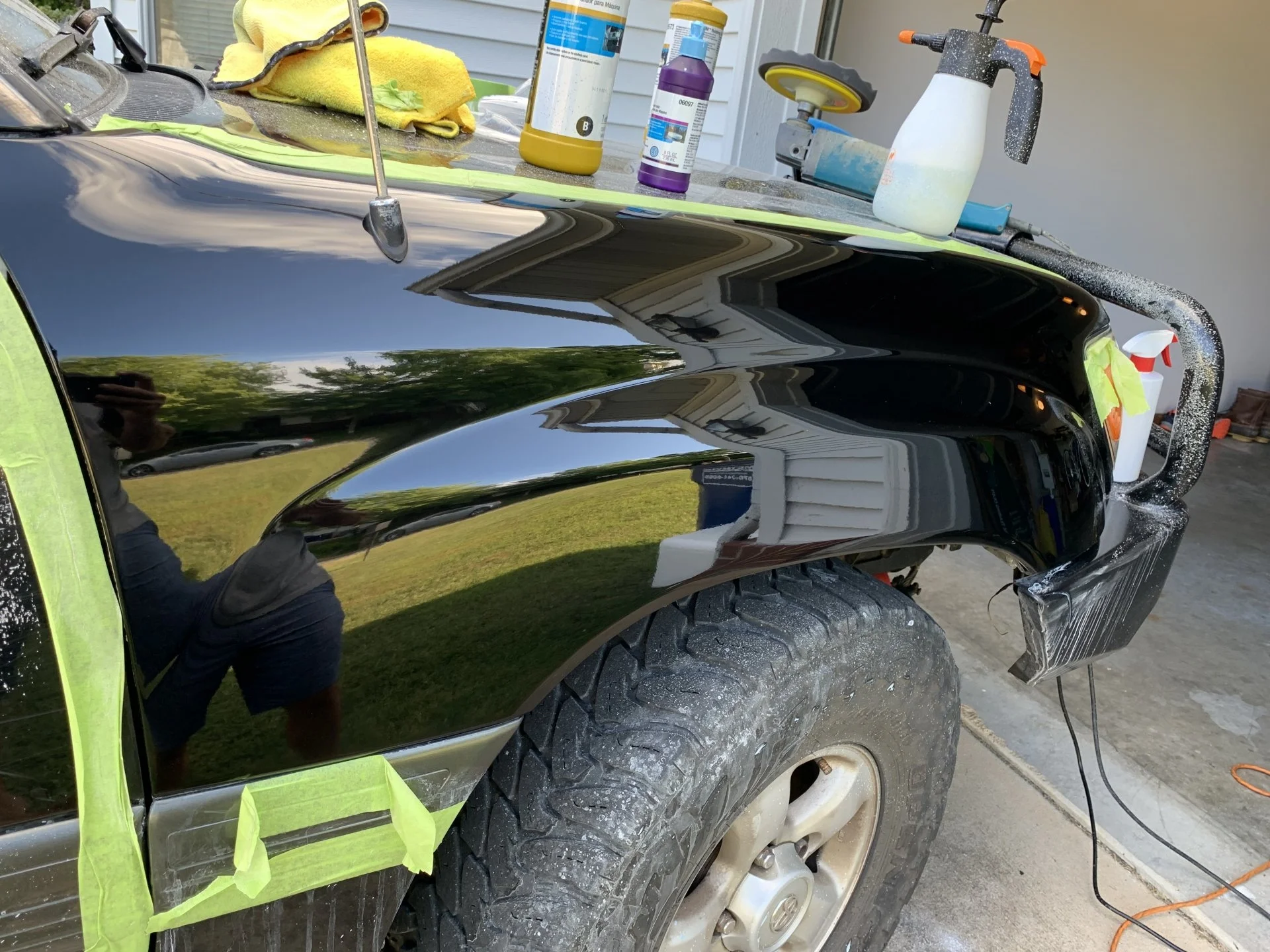

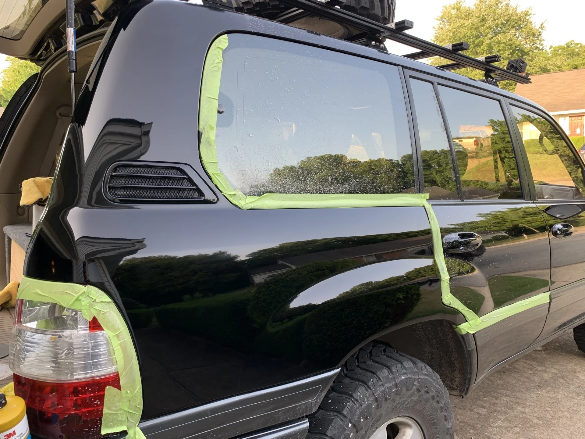

Started the process of paint correcting the 100 tonight. It’s going to be a lot of work but totally worth it. This is my first time trying this so hoping it turns out.

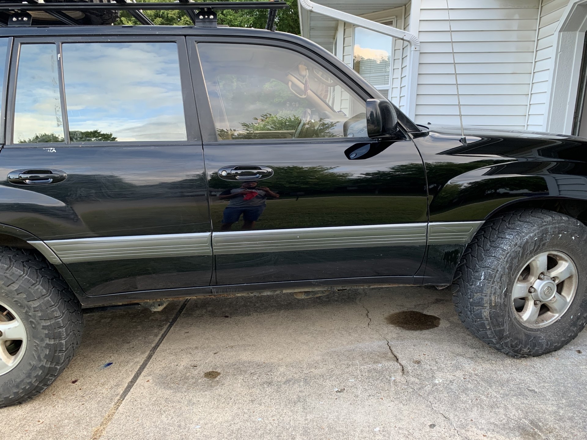

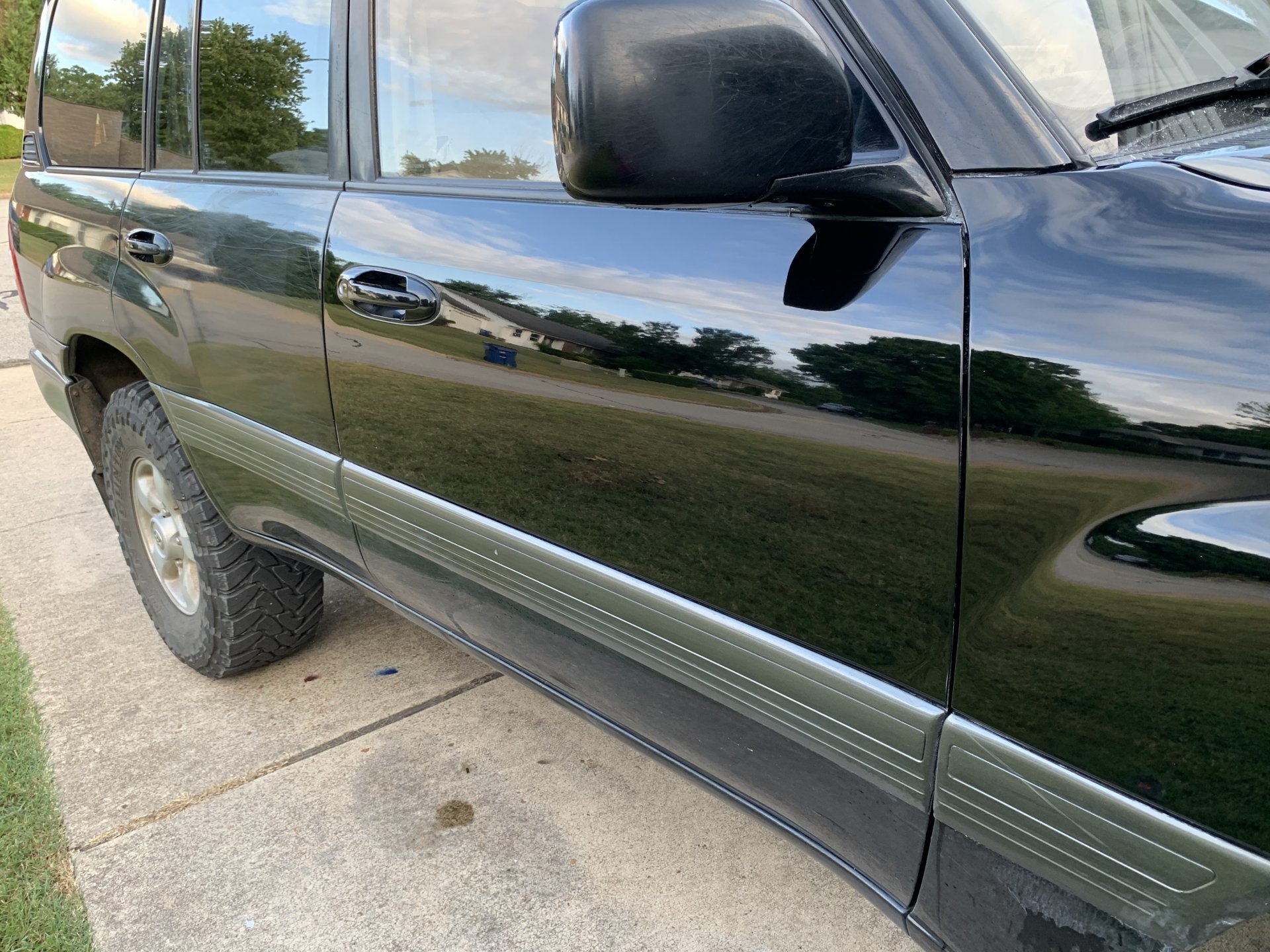

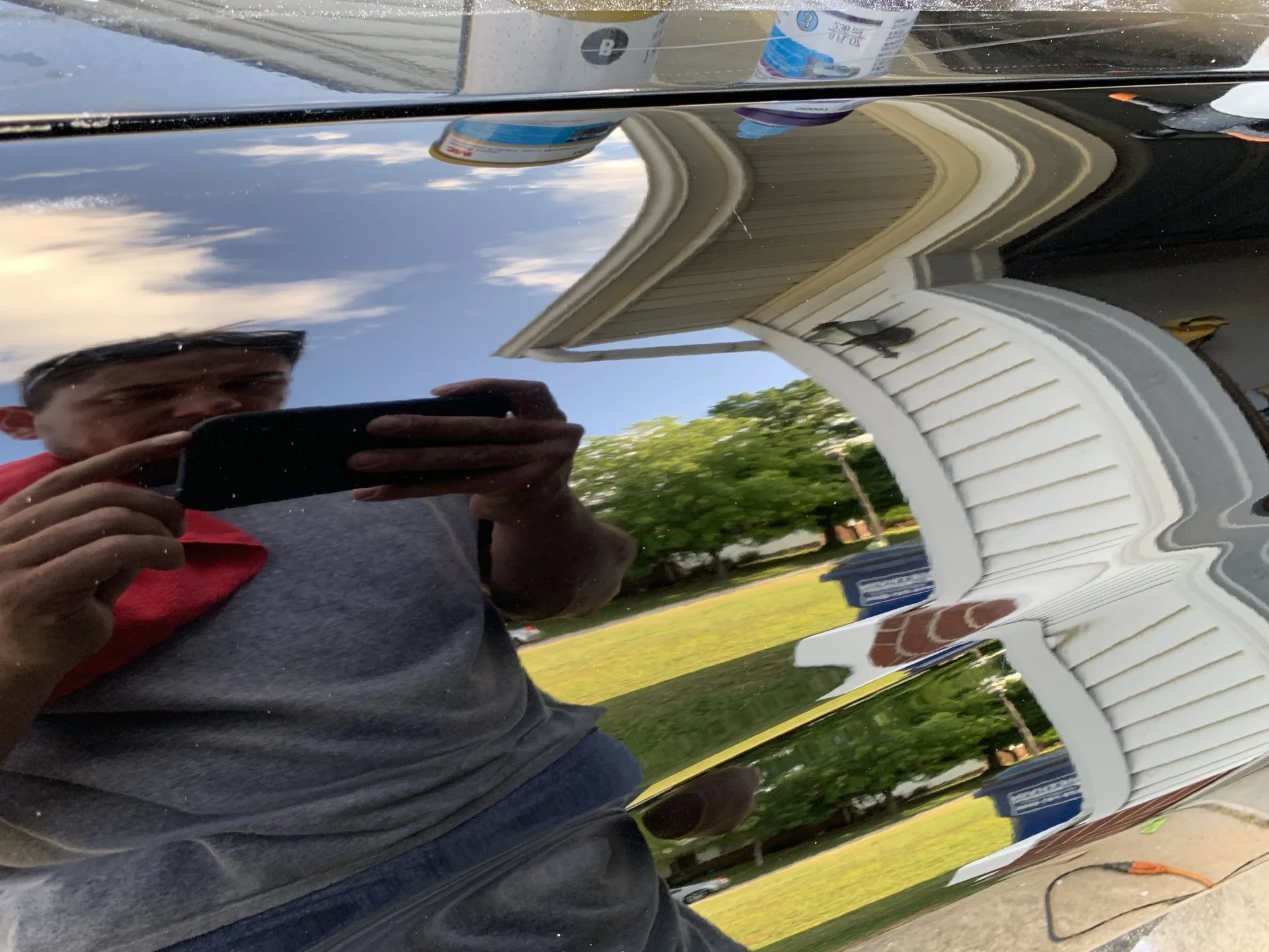

1500, 3000 on a random orbital wet sand.
heavy compound on a 7” buffer white pad
Machine polish on a black pad 7” buffer
Finish compound on blue pad random orbital
All 3m products.
From a fellow Arkansan who’s very familiar with the narrow pinstriping trails of the Ozarks and Ouachitas, that looks great! Do you plan on finishing everything off with a wax, coating, or other protectant?

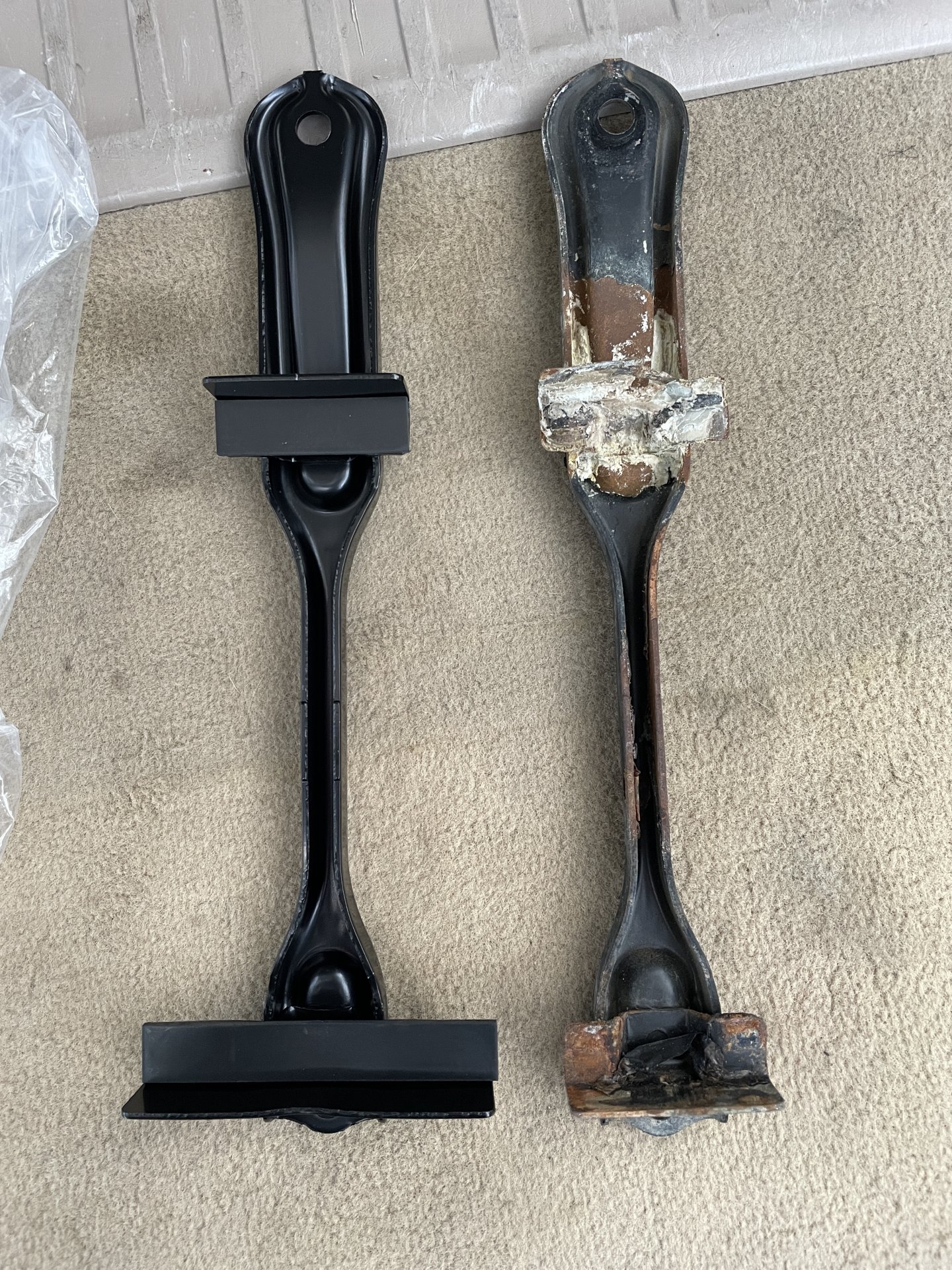

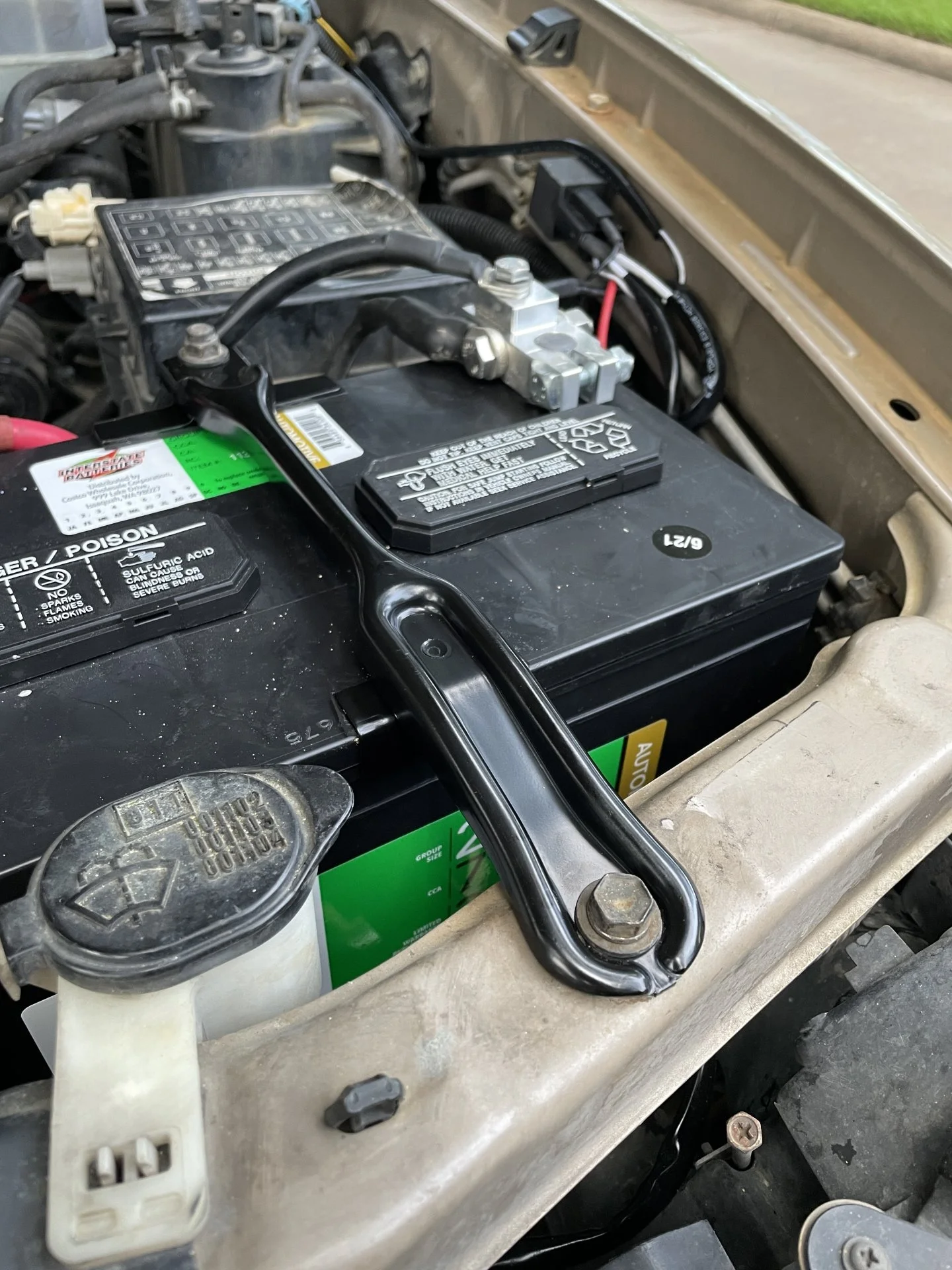

My battery finally took a dump earlier this week, it was the battery that came with the LX when I bought it a few years ago, so I knew this day would come. Went to Costco to pick up a new battery and I realized then that the battery that came with the LX wasn't even the right size. The size I had in it was a Group 24, and the correct size was 27. Ok, no big deal, bought a new one, then as I was taking off the battery tie down it started to crumble from the overly oxidized stuff from the old battery.
So I ordered a new tie down, and wow, what a difference. I never knew my old tie down was deteriorating. 1/4 of one banana job
