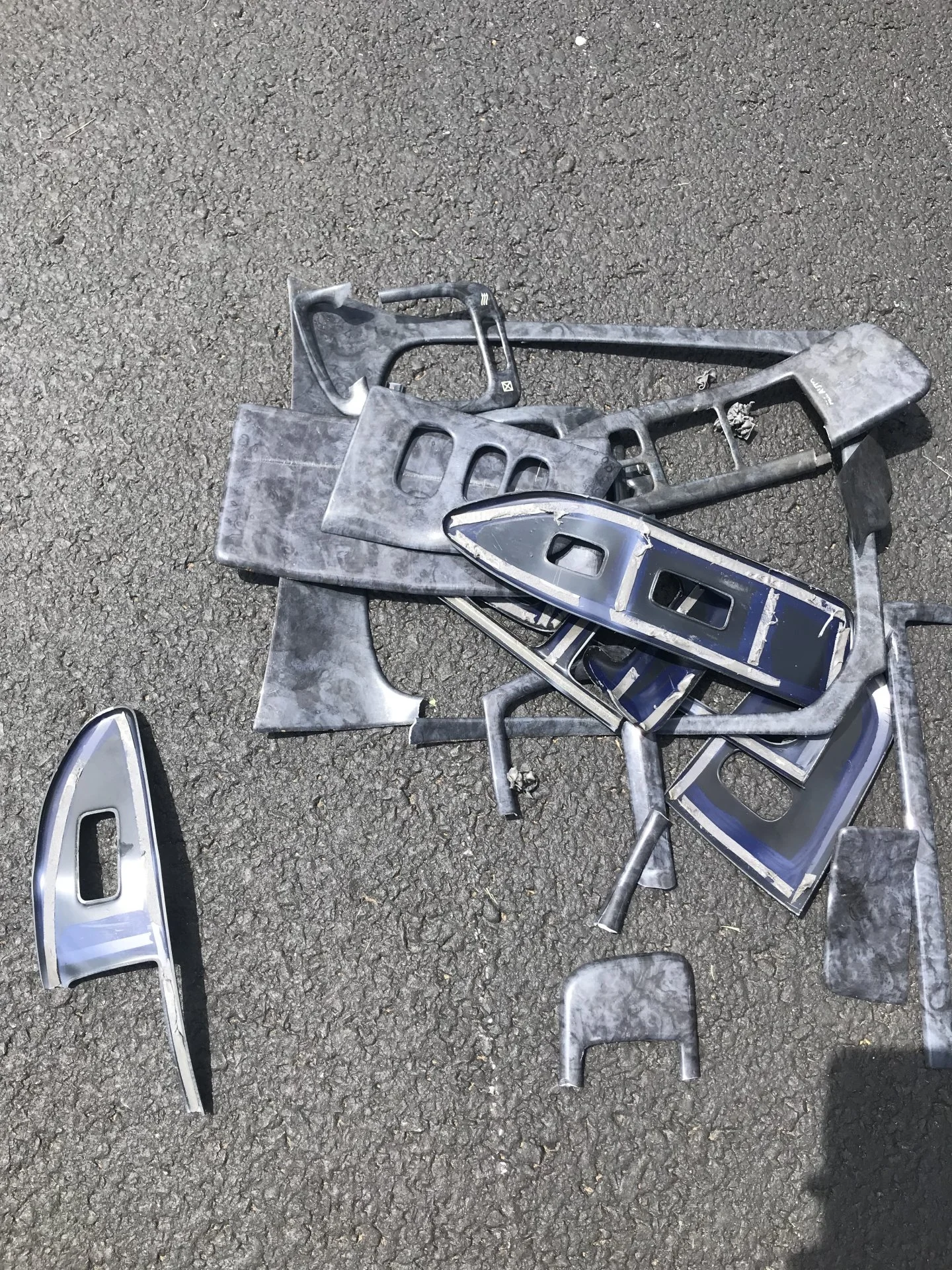

Finally got around to removing the nasty and faded “blue marble” plastic trim stuff. Warm day, an eager 10 year old with an eye for detail, and about an hour was all it took. She did it ::all:: including removing any sticky stuff from the adhesive 😳 and wow what a difference. View attachment 2727244View attachment 2727245
@ChiefKeef I, too, have the ugly blue/gray marble trim pieces and am ditching them to make the interior feel less dated. I noticed the underside of your pieces have only thin strips of adhesive. The pieces that I'm working with (2004 MY) have adhesive covering pretty much the entire underside and it is a BEAR to get them to lift off. The center console area was relatively easy, but the window switch control housing at each of the four doors is unreal. I had to use fishing line and thin cloth to get it to lift enough to slowly separate it from the housing. I've only been able to do one so far and have the three remaining. I probably have about two hours into this project alone.
