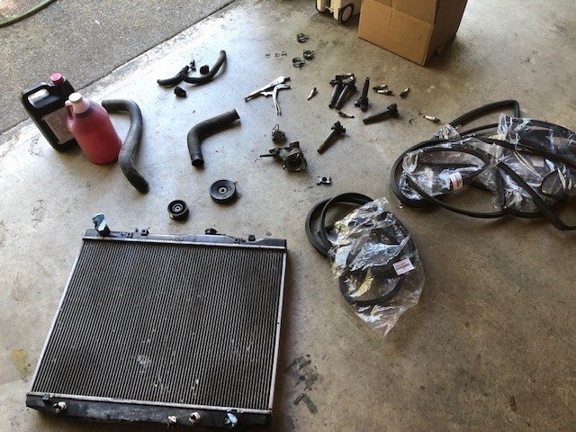

Feels like 'what haven't I done to my land cruiser this week' at this point...but switched out a number of items after crossing 200k and getting ready to join the masses at yellowstone in a few weeks....radiator (went Denso), toyota red coolant + distilled, both hoses, water inlet/housing/thermostat, spark plugs (2 were stuck, a cocktail of WD/penetrating oil/PB and 48 hours got them unstuck), Denso coils (5 of 8 original were cracked), tube seals, cylinder head cover gaskets and fresh gasket cover bolts (goodbye oil leak), idler pulleys 1 & 2 (goodbye cold weather startup squeak), fresh PCV valve/grommet/hoses/clamps/vent valve covers, and new weatherstripping around the 4 doors (goodbye high winds in my ear at freeway speeds issue). If anybody sees anything I missed, please let me know! Trying to get nice and dialed in for the next 200k! Also big shout to partsouq, gave that a try for the first time and was impressed by both their pricing and the speed at which they can send a box from Dubai!
