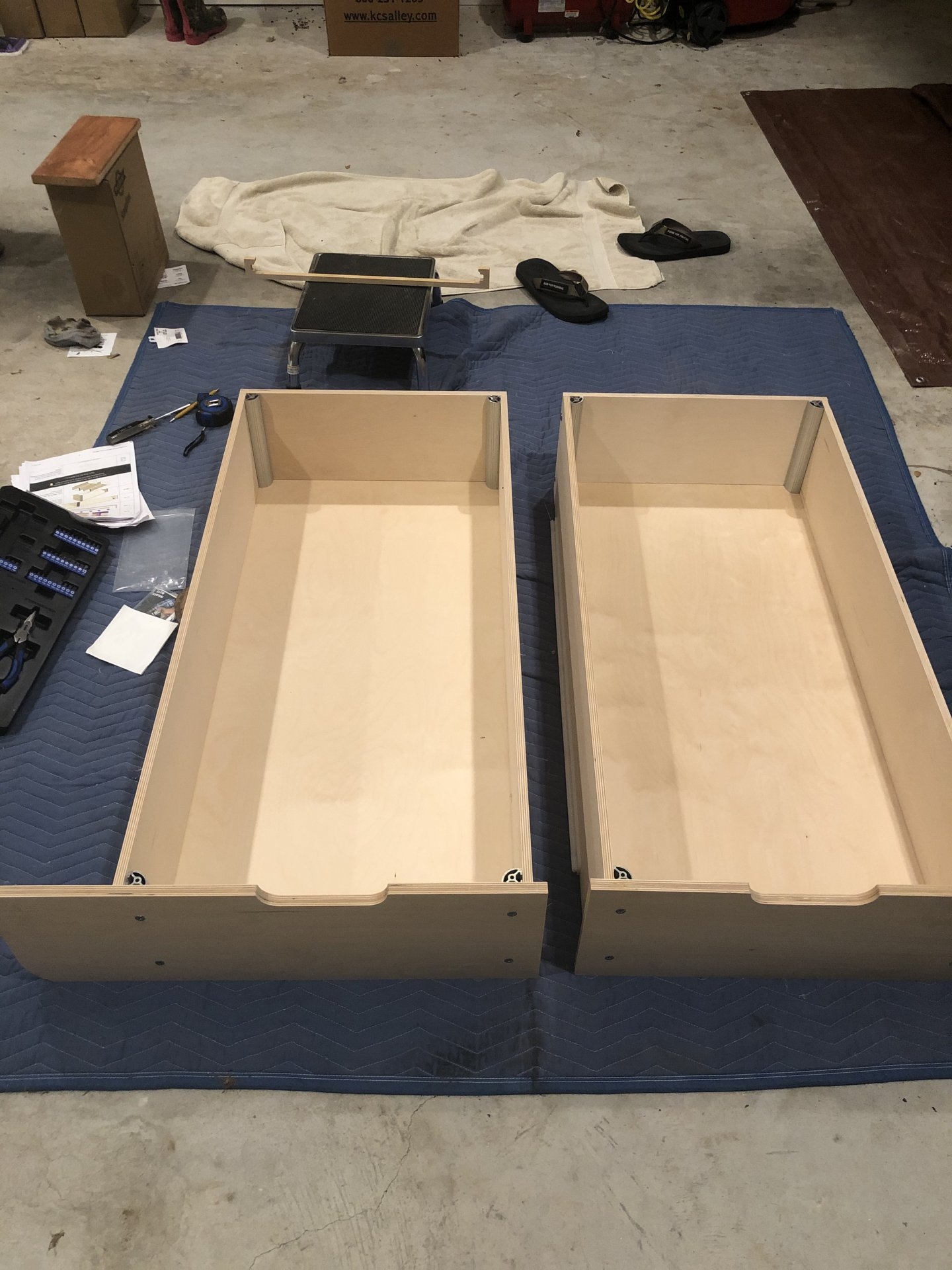

Finally getting around to assembling a set of @cruzerDave ’s KISS drawers, that I’ve had sitting in a corner for a while…
The plywood rail template tool is pure genius!

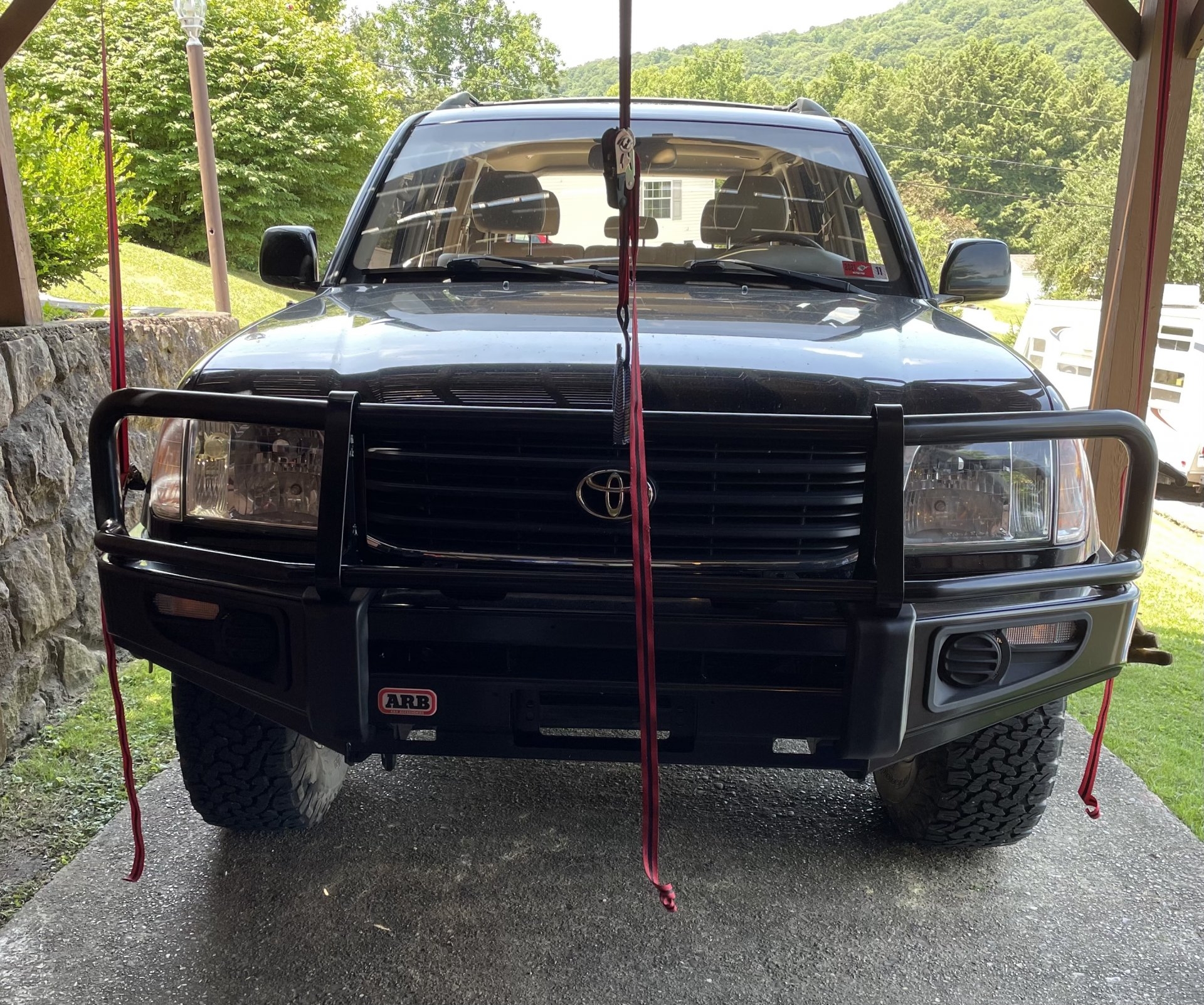

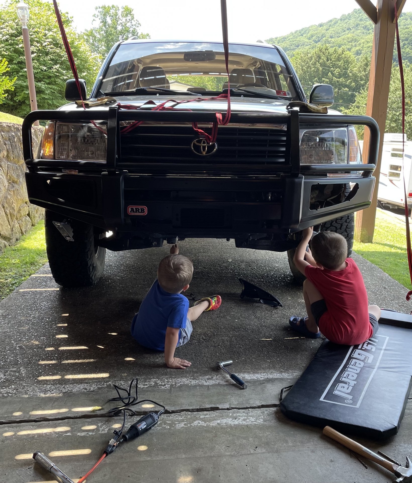

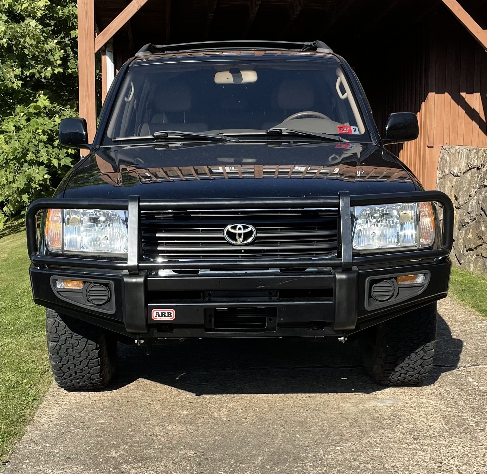

With the women out the house today the boys and I set out to finish the ARB front bumper install. I installed it Monday, but was unhappy with the fit. Worked on it for about an hour after work on Tuesday with little improvement. Finally got it right today!
It took some redneck ingenuity in the form of 3 ratchets straps ran down from my front deck and an old climbing quick draw. With my makeshift crane in place I loosened every bolt and got it where I wanted. I then tightened everything back up using the surefire old German torque spec of "gutentight". (no torque specs from ARB) I think I settled on 55 ft-lbs or every thing except the two bolts into the face of the frame rail. For those I used the Toyota spec of 43 ft-lbs. I also drilled and pinned it as I'll be adding a Ramsey winch once I rebuilt it.

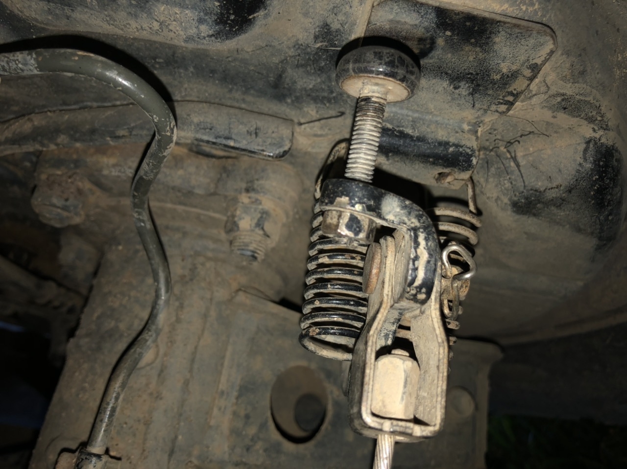

Put new hand brake shoes in.
Had to swap back to OEM dog bones as I couldn’t get the rotor back on with extended ones.
Old shoes were unevenly worn. Seems to be a lot better but not 100%. The stoppers are right at the end of their travel.
Shoe lever seemed too loose when springs and cable were disconnected.
I’ve got the cable a bit tight at the moment so stoppers are off the plate.
Not sure if I will need new cables.

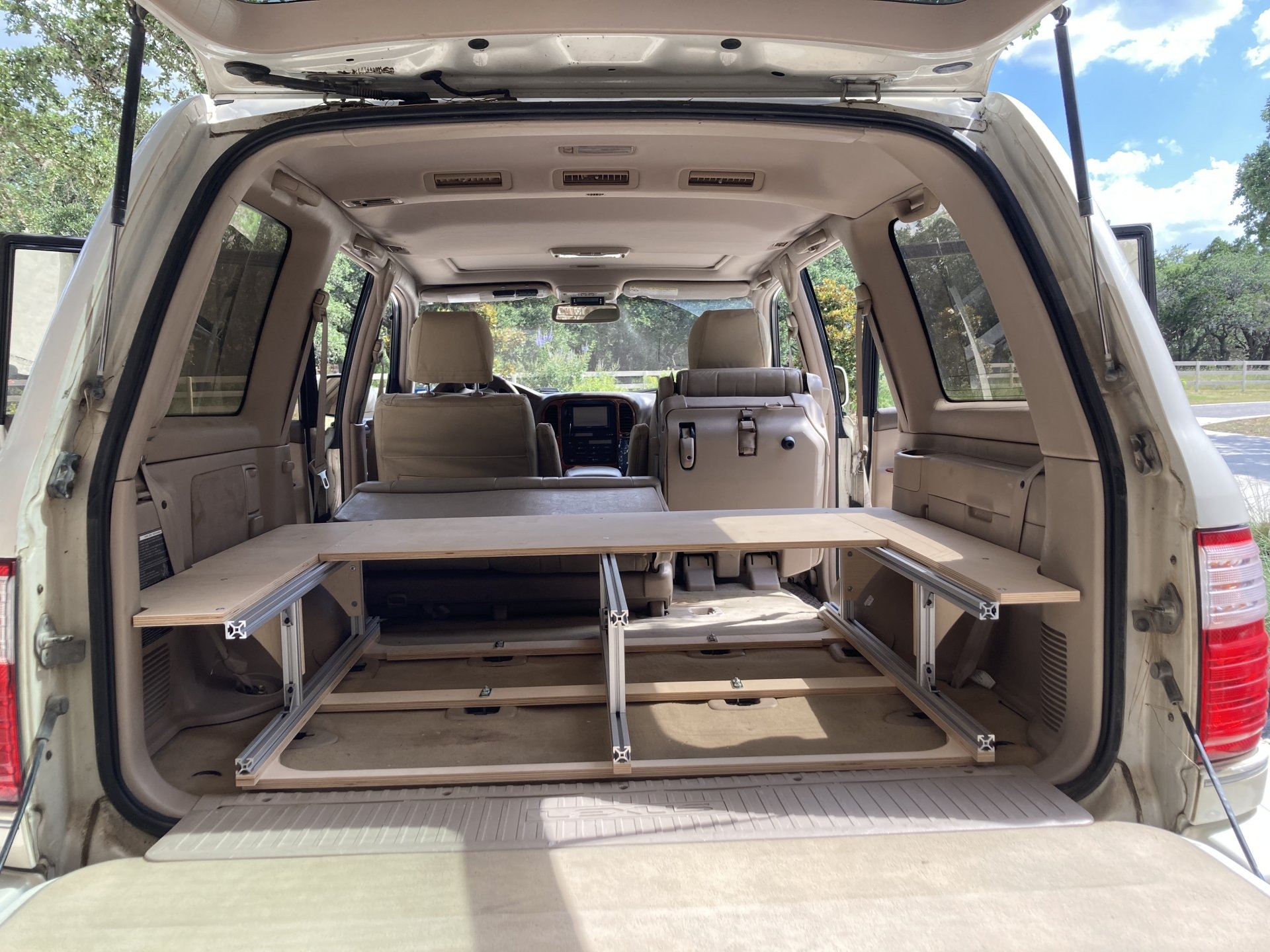

Bed platform 90% complete. Need to build a collapsible extension to reach over the middle seats. Took a slightly different approach than what I’ve seen on here. Used slats rather than plywood and built in two overlapping halves so it’s easily removed and very lightweight. Cord with cam jam tighteners at the corners hold it down sufficiently. Left just enough gap that the side storage areas are accessible.

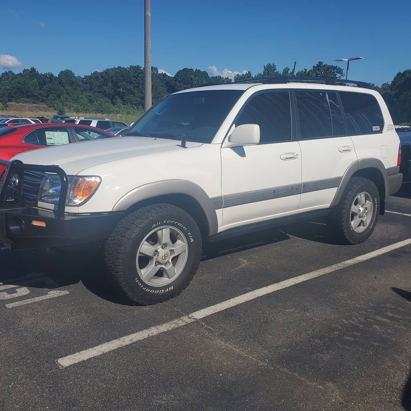

Finally got my Ironman 4x4 installed. Added their 7" light so I don't get scared in the dark. Settled for the Harbor Frieght Badland Apex 12,000 lb winch.
Still need to figure out the best method to get the height back from the droop. Already torqued OME torsion bars.
Ms. Betty your Cruiser is looking spiffy! To reduce the rake, you might have to re-index the torsion bars. A simple process that takes about an hour!
