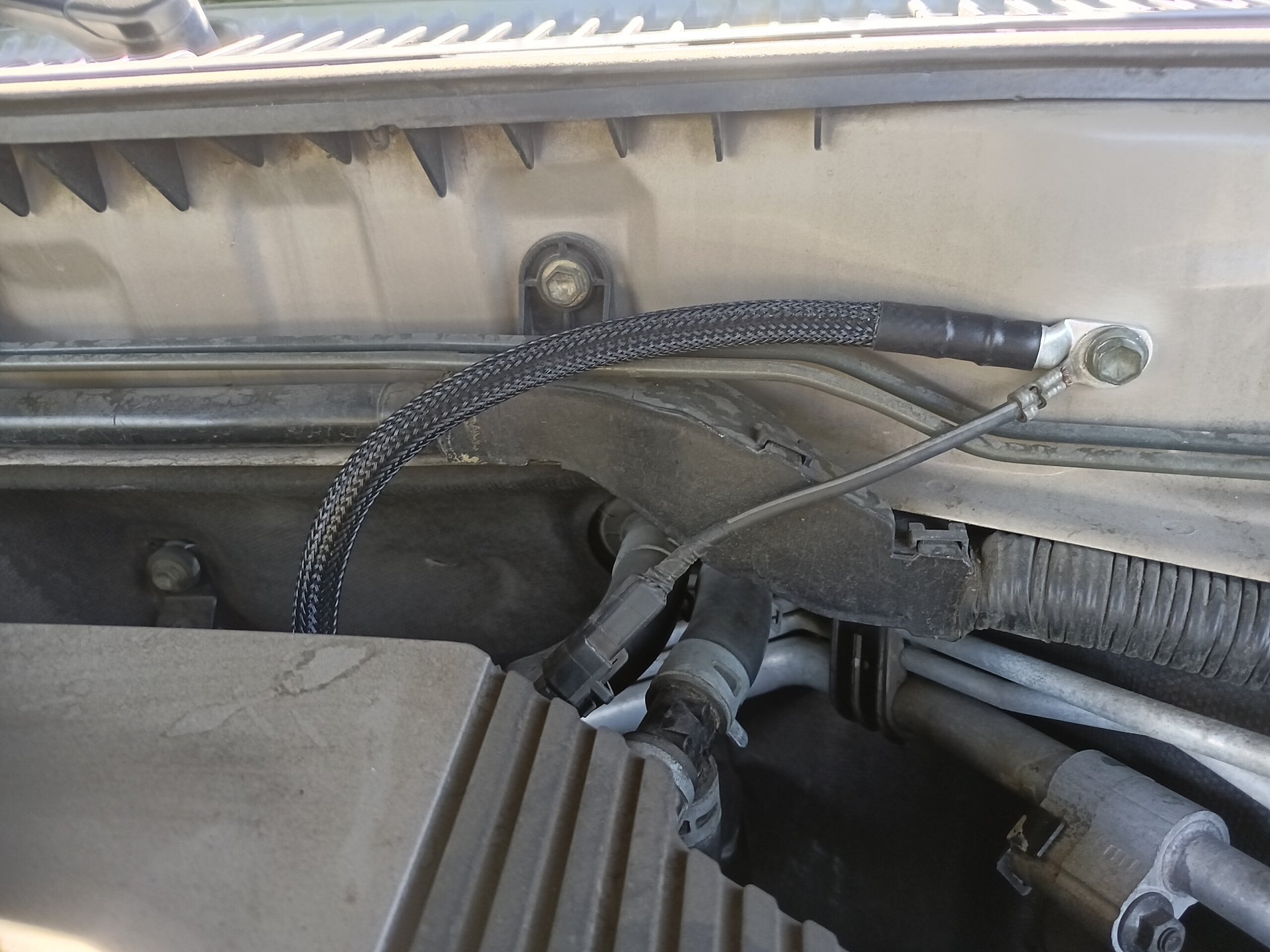

Today after sitting on my Ironman 4x4 driving lights for months, I finally had time to wire them up and trim the control box of the winch to make it fit.
Also while I was in there, I swapped out the battery terminals from the old fuzzy OEMs to the SDHQ billet versions
