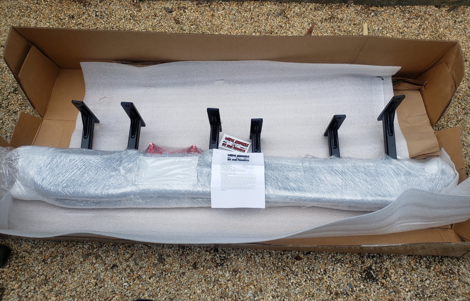

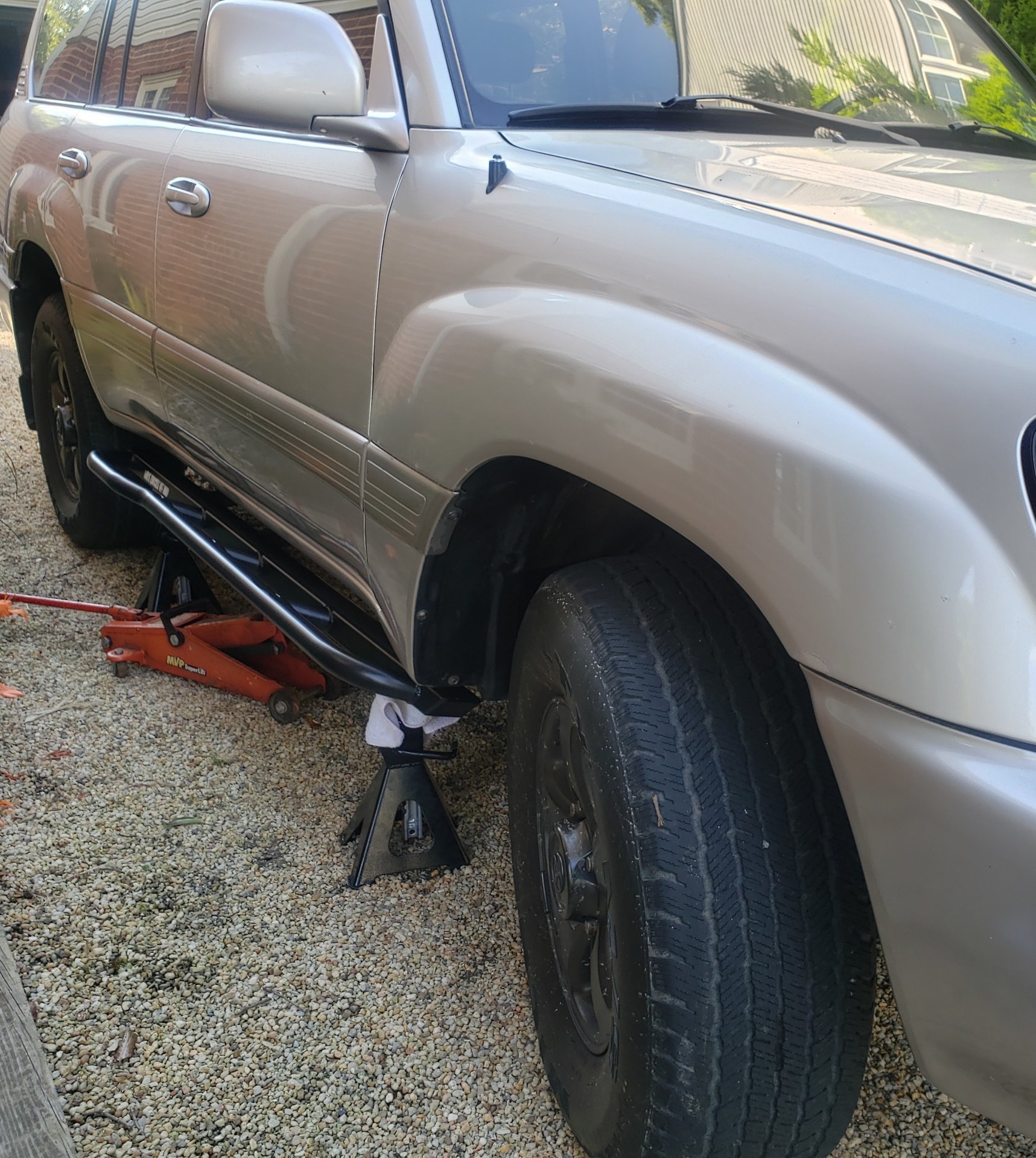

Well, after months of working on baseline maintenance, today I took a break to put in fun update when a package finally arrived from White Knuckle. Sliders are on! Snapshot on shipping - I ordered these end of March, so they are slowly burning through the orders.

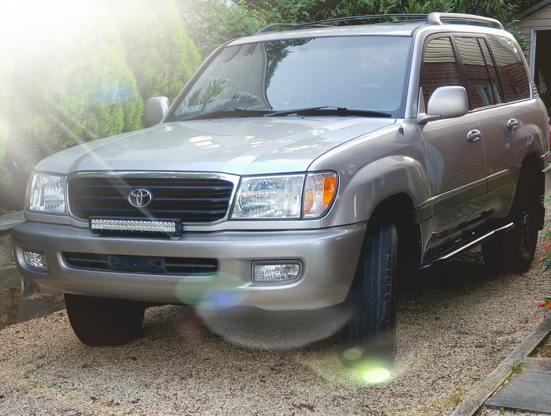

Time for some new tires 🤠
Yes it is!! I was really tempted to hit the larger tires right away, but decided to hit the remaining maintenence items first and will update tires after some big highway miles expected later this month.
