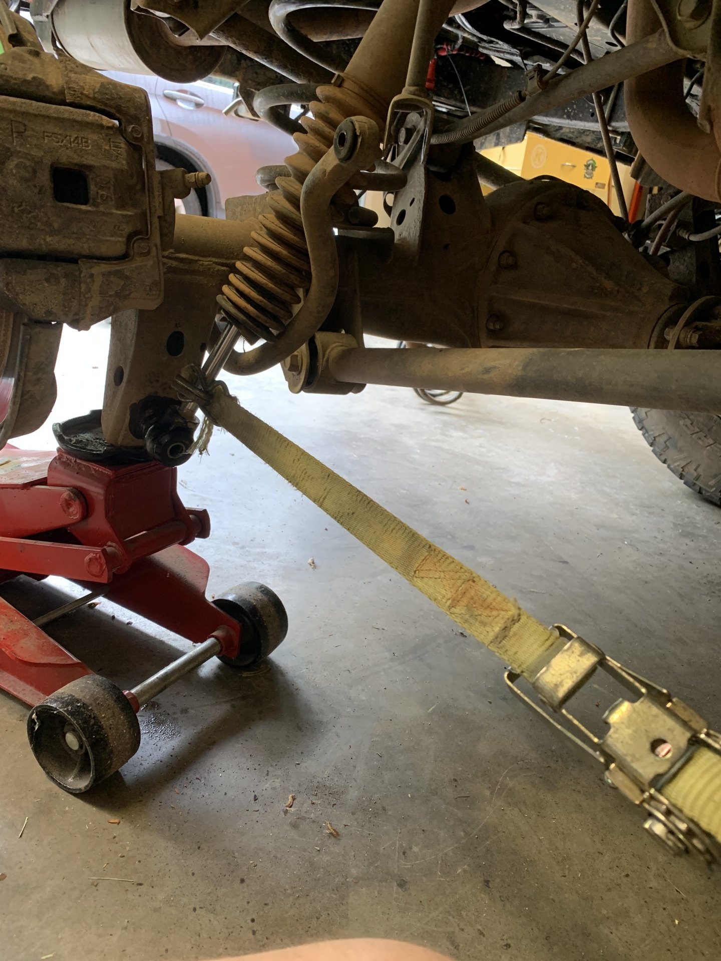

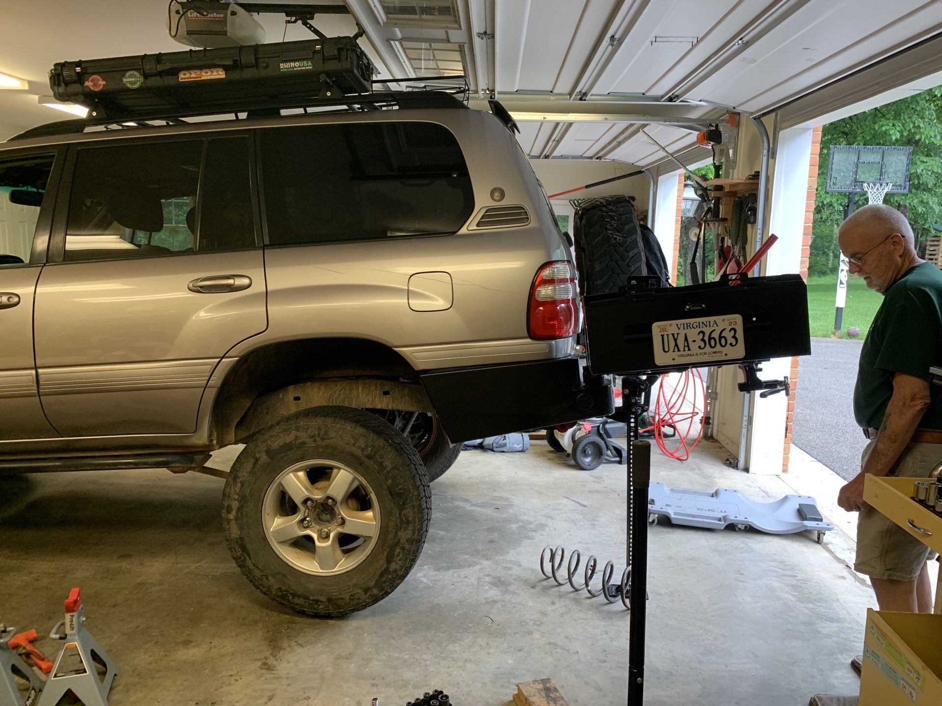

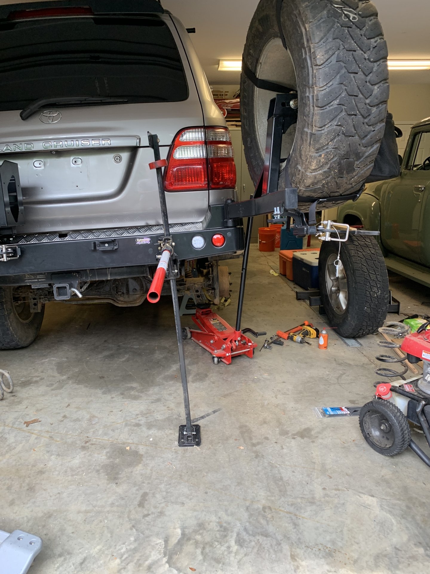

New heavy springs from 0ME to replace the medium duty ones after the new rear Dobinson‘s bumper with dual swing outs. Previous owner had the B spring on the driver side and the A spring on the passenger side. Got back about 2 inches in the rear and the rake looks much better. Definitely need some new bushings in the rear.

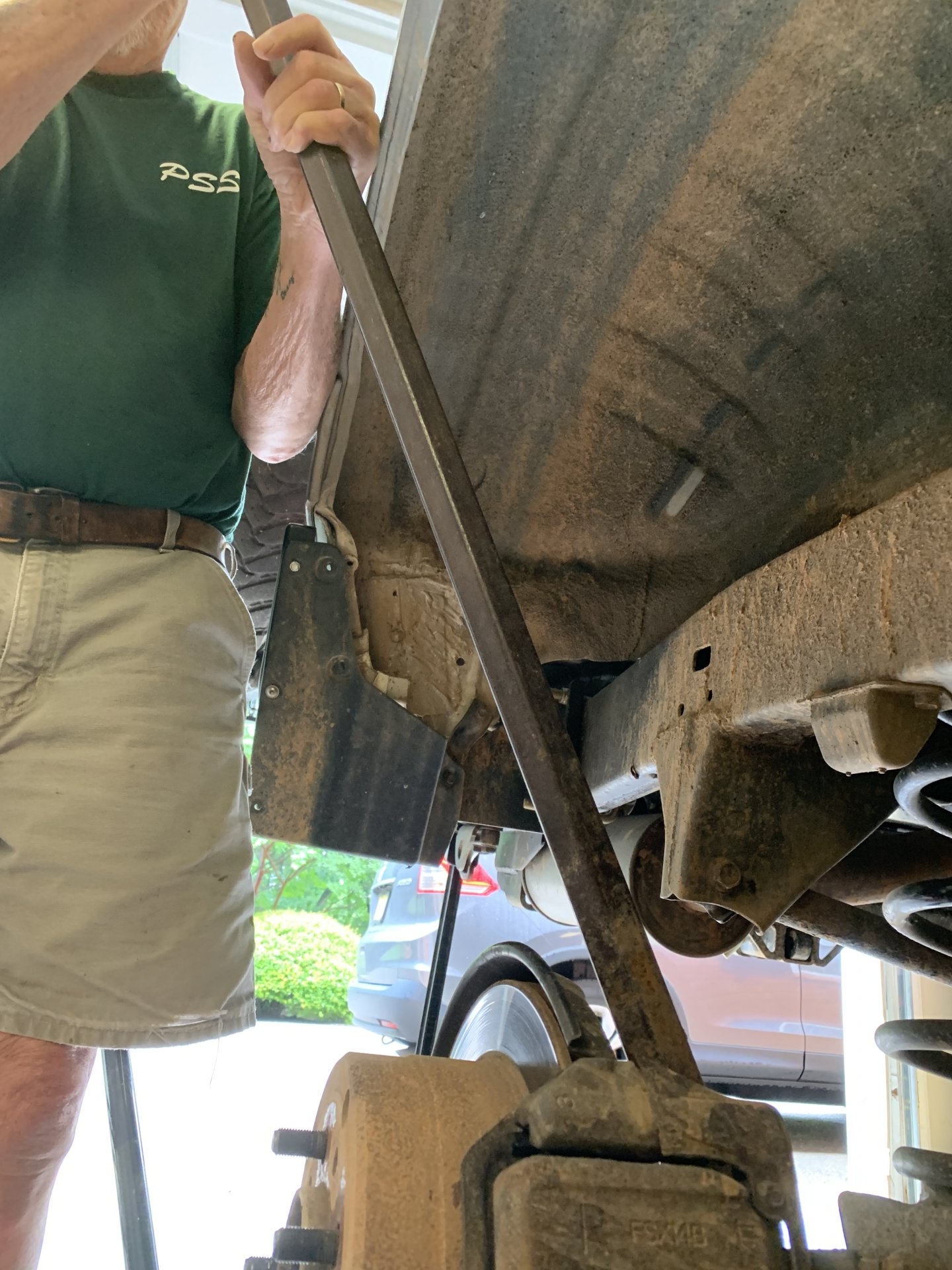

When you absolutely, positively need to get that lower shock mount off. It was a little crusty.

Is this how your rear is sitting post springs? Which did you end up getting?
