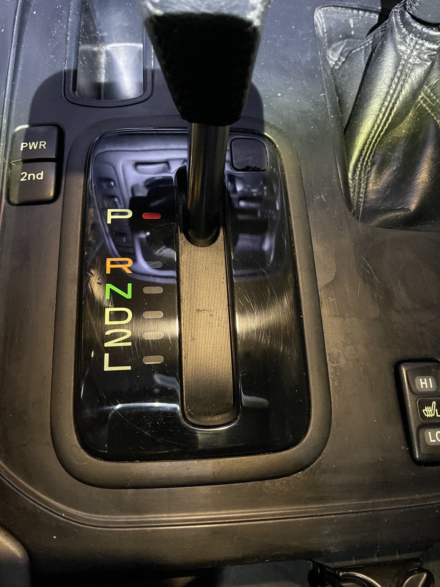

Looking to replace the shift indicator plate for my 99 LC. I've found 2 part numbers and I'm wondering if one or both will work. Thanks!
35921-60180
35921-60210
35921-60180 worked for my '98. It's $84.17 at PartSouq, ~$140 domestically.
35921-60210 does not show up as a valid P/N in the US, although it does show up at PartSouq for $67.01. According to @dbfw it looks like a direct fit for less $$.
Good to know @Ayune I just went straight to PartSouq to browse the diagrams and order, didn't even consider ordering from a US source.
@Atascruiser , when you go to do the swap, don't cut the OD wires. Just follow them back to their connector and depin them. They will fish out with the shift knob. Getting them threaded back through is a bit tedious, but not too bad at all.
Edit: Looking at the pictures of both PNs, you can see in my side by side pictures as well that the -60210 has a slightly tighter spacing between the D, 2, L positions. It looks like the -60180 might be the exact replacement. However, the indicator light still aligns properly on my -60210 going through all the gears, so I'm not sure that it really makes any meaningful difference.
I just received the 35921-60180 shift plate. Looks great.

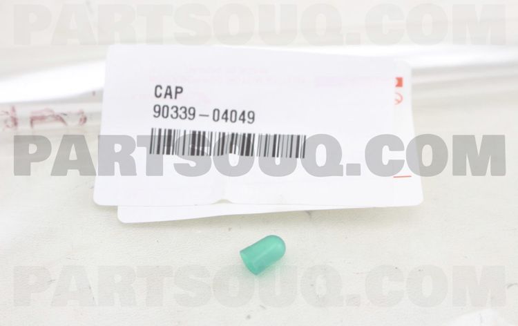

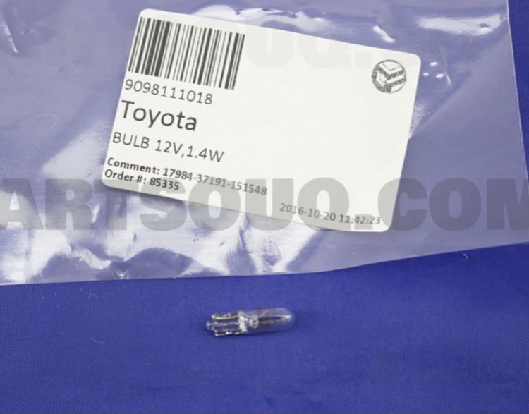

Here's my dilemma, I think I need a bulb for the console shift position light. It does not work. Does anyone know the bulb part number?
Note the shift position lights on my instrument cluster all work.
I'm curious about this too. My bulb is still good, but I just spent about 20 minutes looking through parts diagrams and couldn't find it listed anywhere.

Swapped mine out today, and aside from cleaning up gunky console nooks and crannies, the hardest part was fishing the o/d wires back out the bottom of the shifter column. Thanks for all the great info about the part and the procedure!
So much better.
Green Number 74 LED wedge should work there too.
