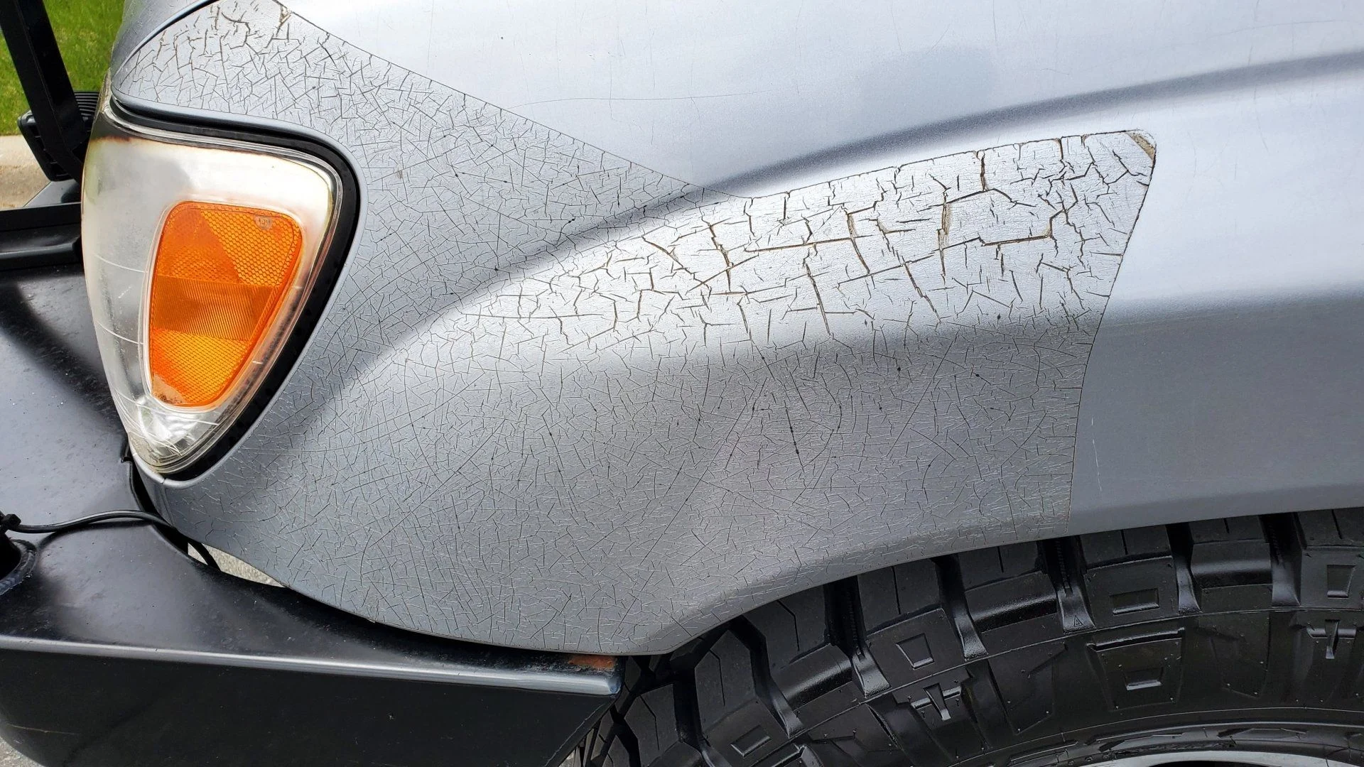

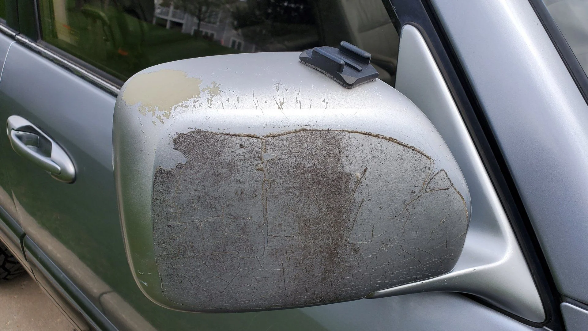

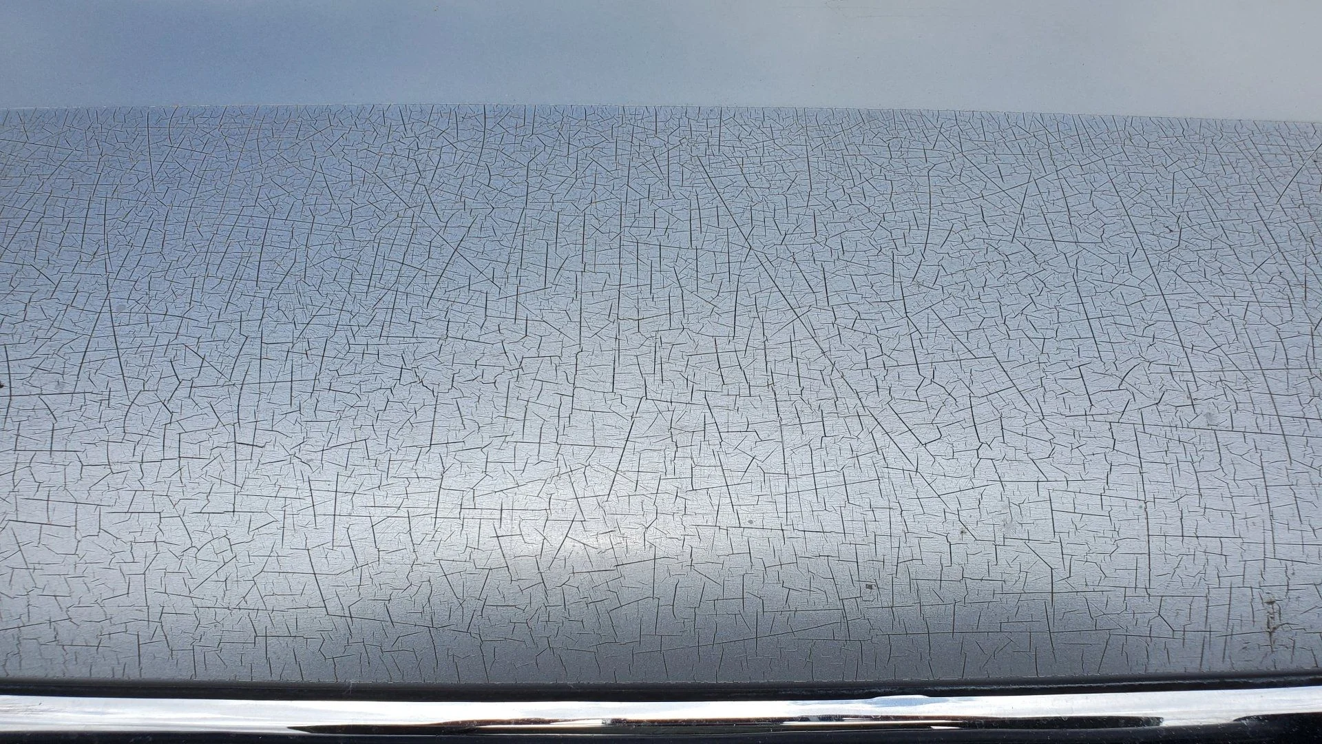

I am trying to figure out a cost-effective way to deal with dried up PPC film on the hood, fenders and mirrors. The hood also have a large patch where the paint appears burnt up. The two options I have are:
1) Pay a body shop to strip and repaint the hood and fenders. cost ~ $1500
2) Pay a restoration guy to chemically strip/use an eraser wheel to remove the PPC and do 3 stage paint correction and live with the burn mark. cost ~ $800
I plan to keep the truck long term (don't we all?) and want to get it done right. My first preference is to keep the original paint but the burnt mark is giving me second thoughts. What do you suggest?

I think you're gonna wind up needing paint no matter what. If you have a solid detail guy, they can get the old film off with the minimum of damage and then correct as best they can what's there under it, but that mirror has primer/ urethane showing, the clearcoat is failing on the hood at that discolored spot, and what's left under the old film is TBD once they can get it off. If all the rest of the paint on the truck is just fantastically great, probably pay the money to get it all correct, wax it up nice, and keep it good for the long haul. Would be a buy once cry once scenario.

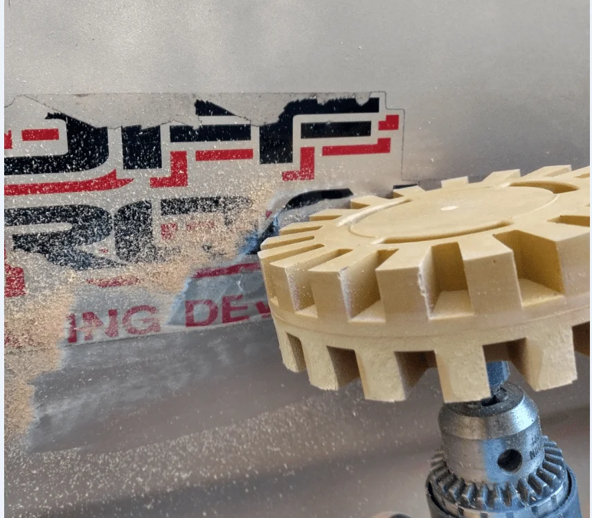

I realize there is a big difference in decals. I had a bad TRD decal on my Tacoma when I bought it. I used a 3M eraser wheel to grind off the old decal.
I tried many approaches before finding the eraser wheel that finally did the job. It just takes a lot of time and patience not to burn the paint.
Lots of dust and some ghosting remained from fading in the hot TX sun.
Used some Turtle Bug and Tar foaming remover to remove any remaining decal residue.
It didn't look bad when I was done.. You can still see a little bit of the red TRD ghost.

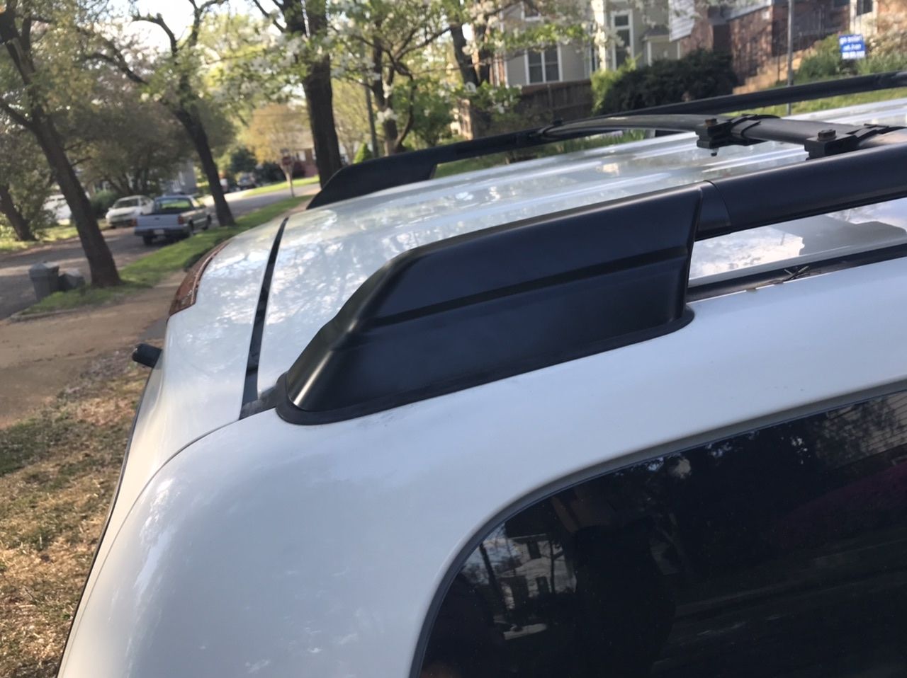

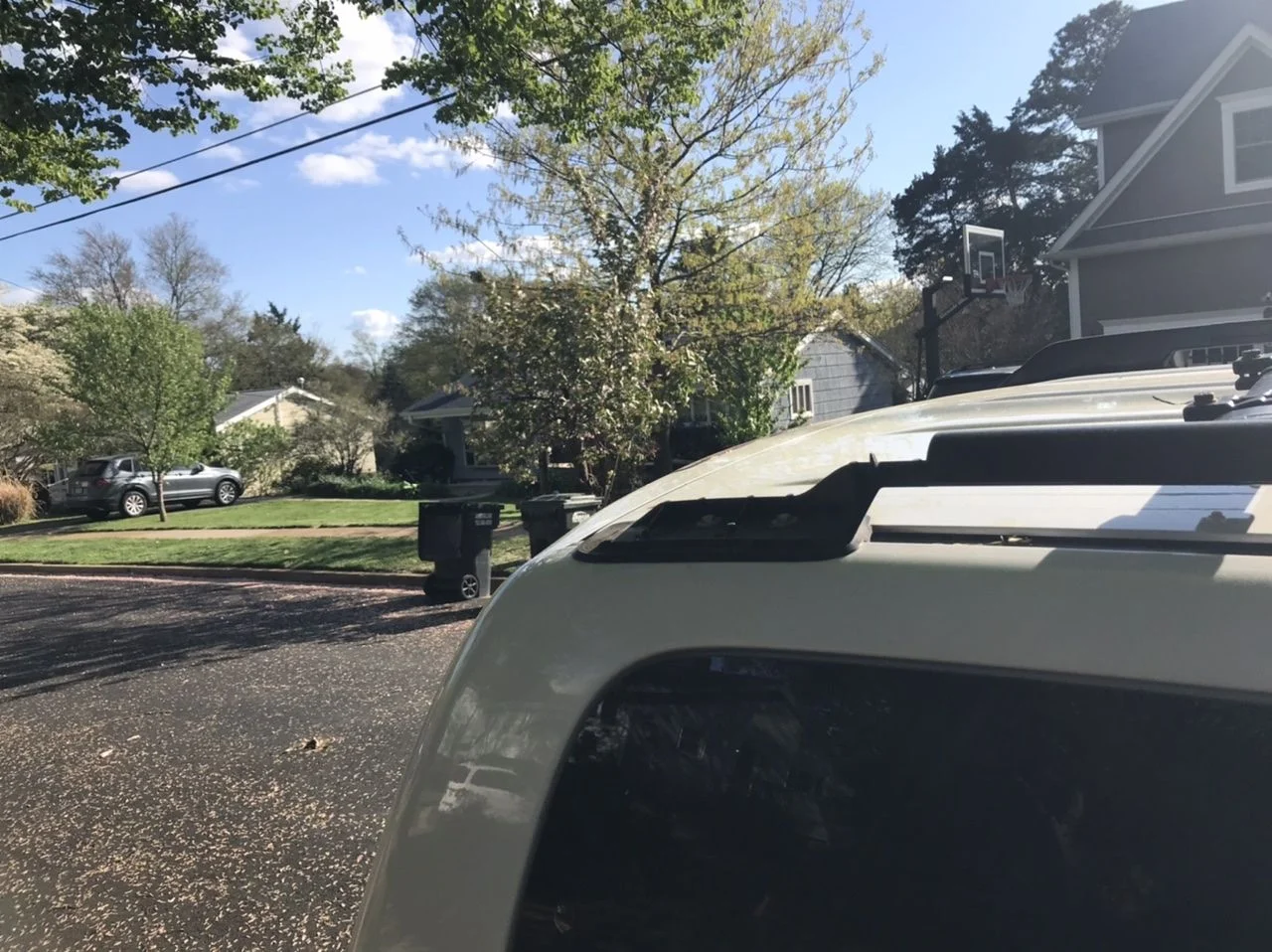

Noticed this on Saturday during my whether-it-needs-it-or-not semiannual waxing of the LC. Not sure when it fell off—it was there when we got back from recent camp/off-road trip...
$80 and 1 minute of labor later, so much better...

Thanks. the rest of the truck's paint is not too bad. Clear coat is all intact and if doesn't have any gouges or big scratches.

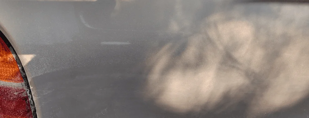

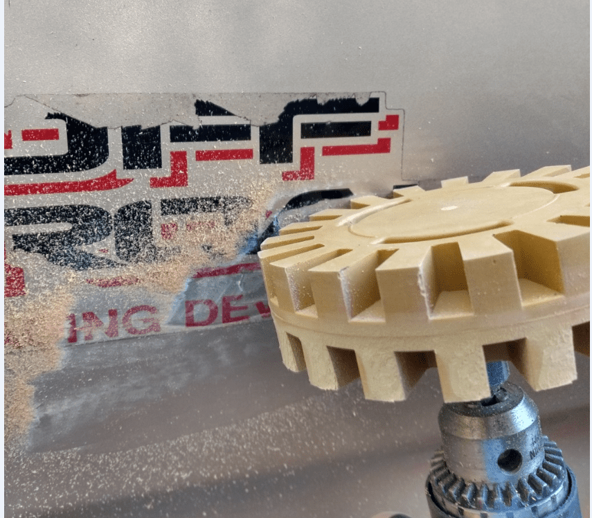

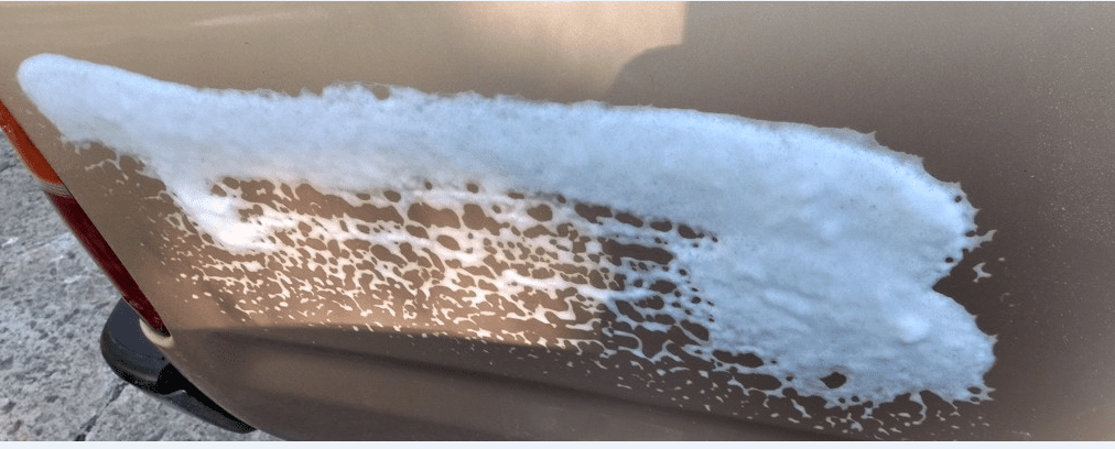

Thanks, Someone else has suggested this before. The detailing/restoration guy is pricing it to take about 8 hours to remove!!

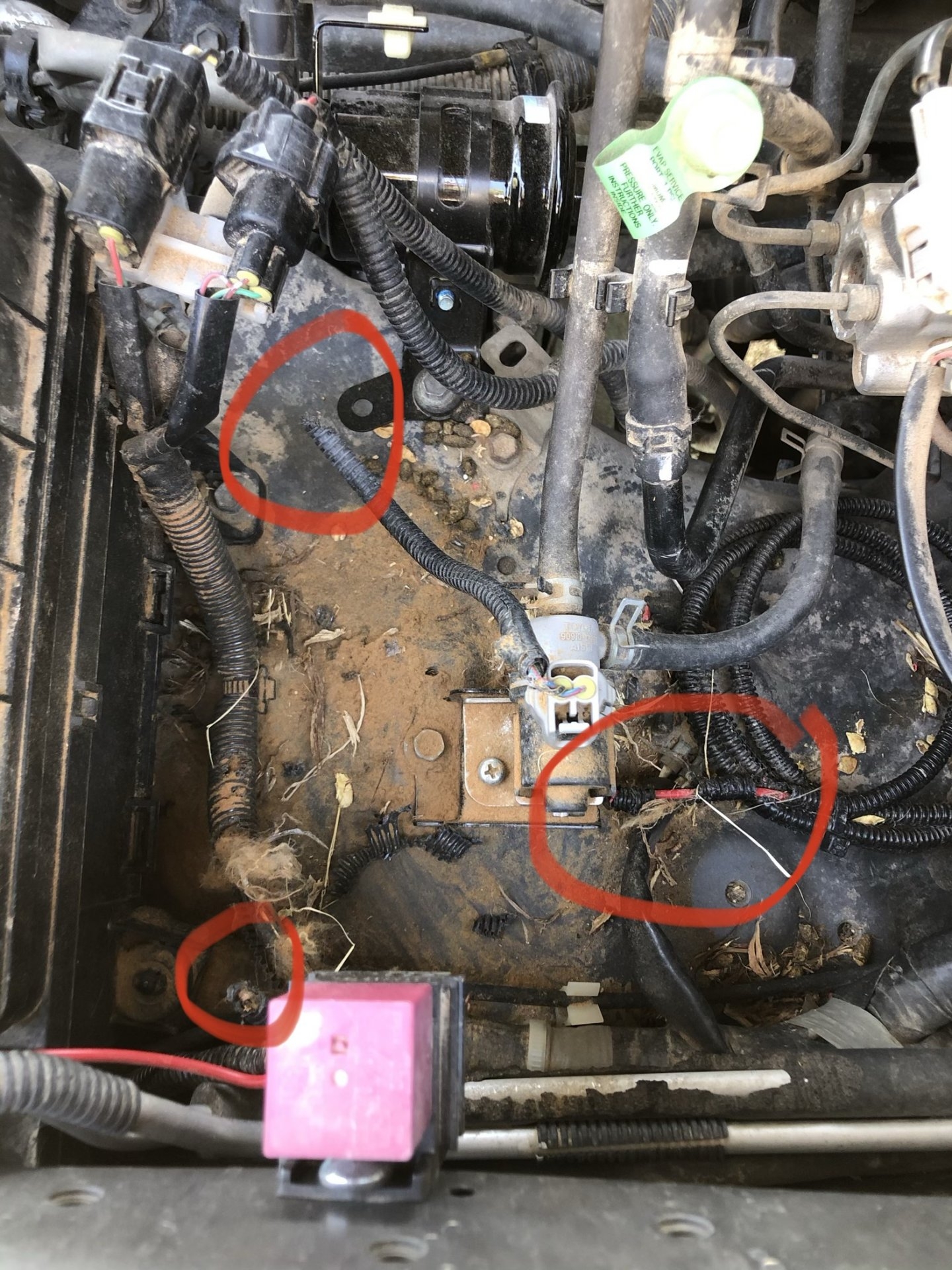

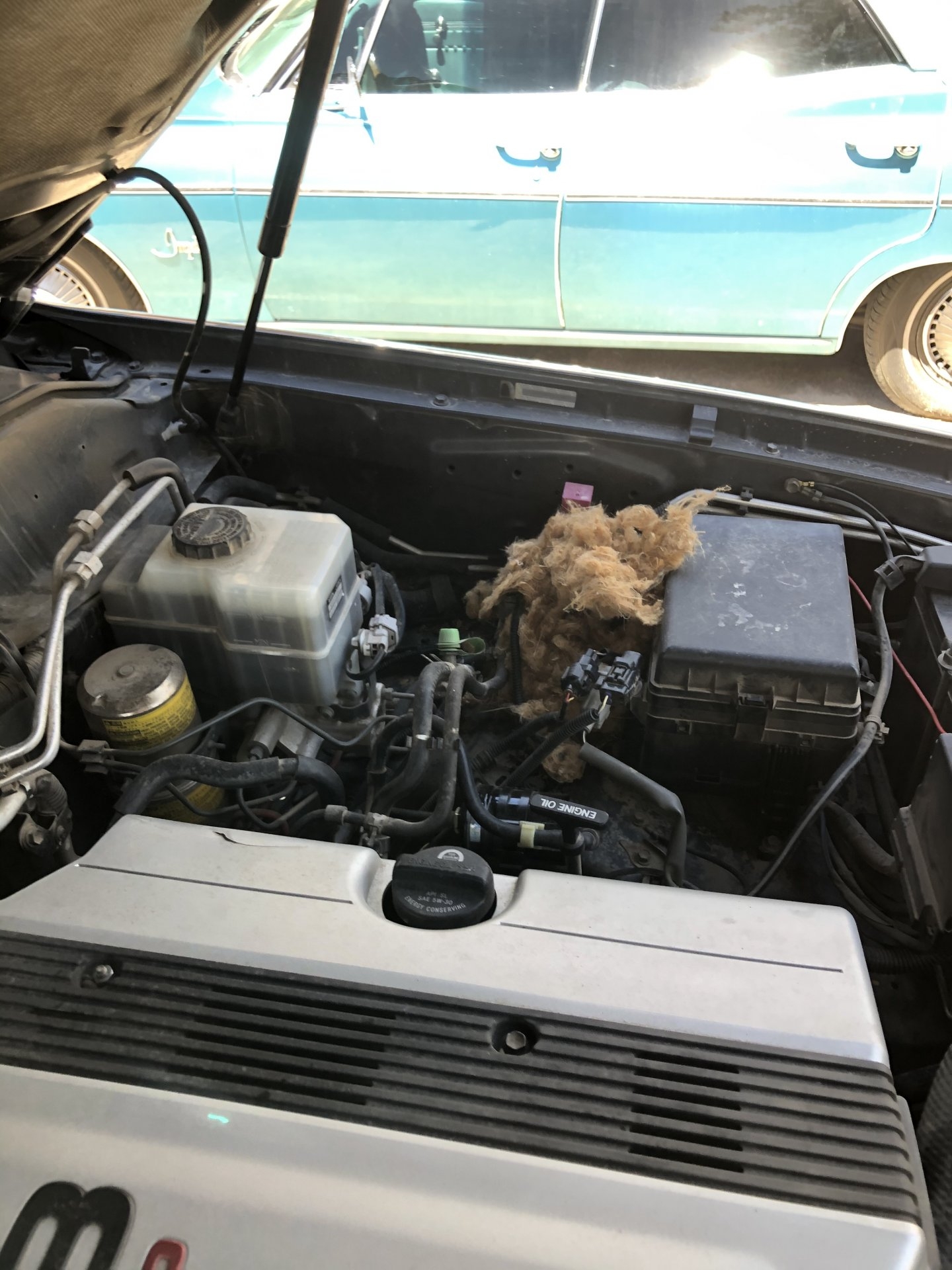

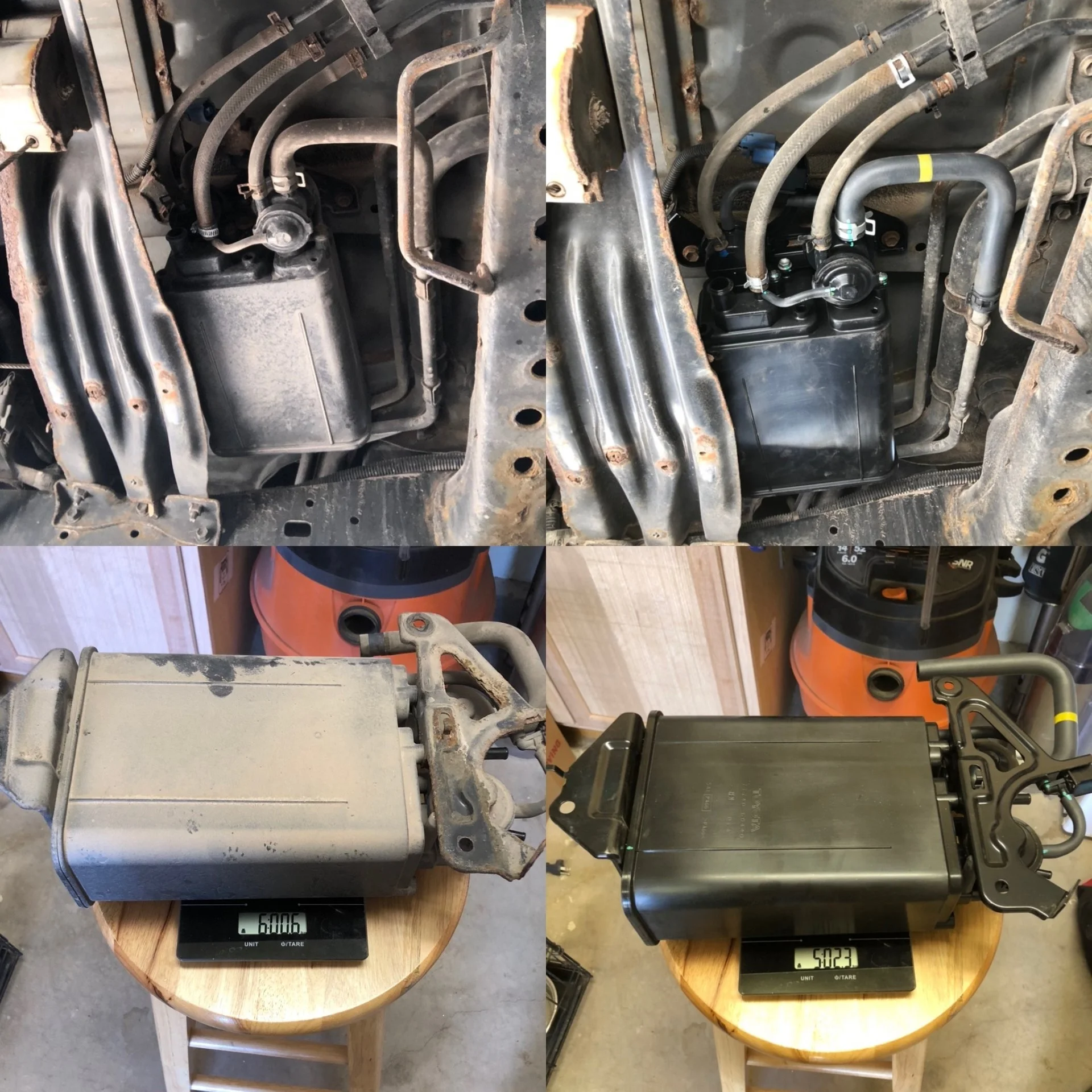

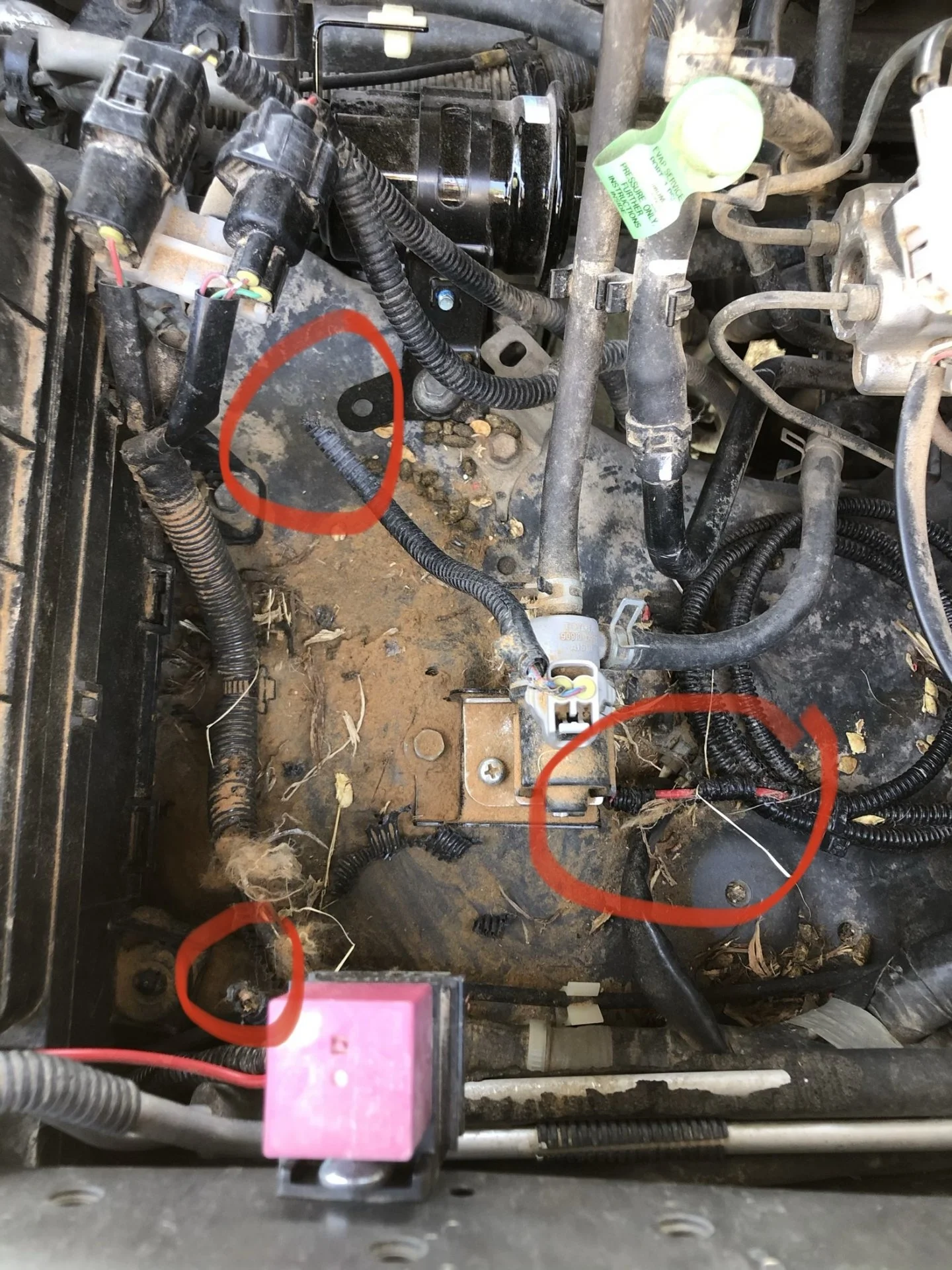

Charcoal canister, vapor canister purge solenoid, all the hose clamps, and patched up some wiring from an unwanted visitor while I was at work on the oil rig.

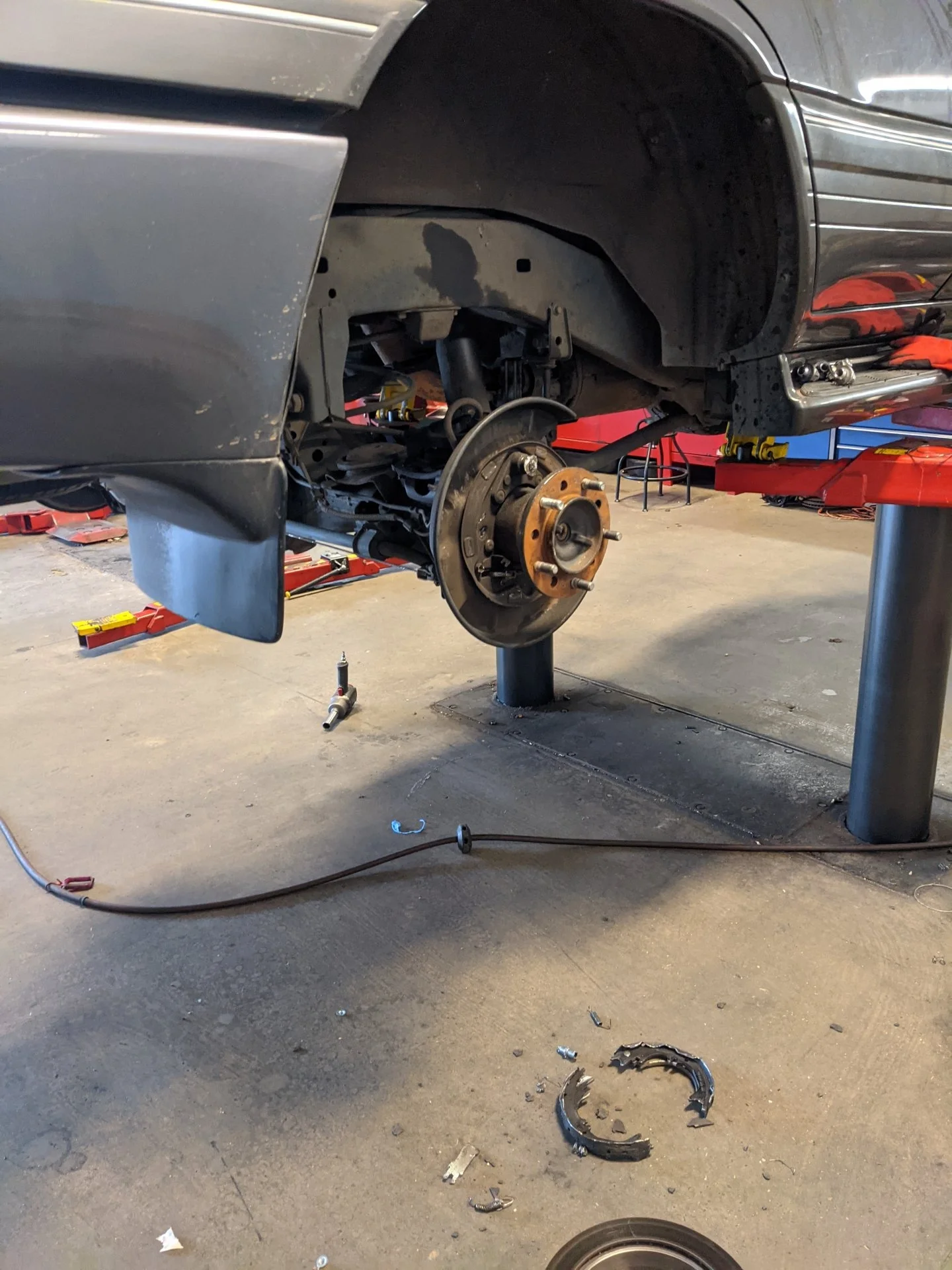

Just got done installing an alternator, radiator, Ts, battery cables ends, various vacuum lines, dual battery system and Slee dual mount, various lines, hoses,
wiring clips and now on to full brake job with new rotors/bearings/seals all the way around, new calipers, new ceramic pads, new stainless brake lines,
and G=d only knows what else,,,due to turning one bolt and find something else that needs addressing. I figure it comes from being an idiot and letting it sit for way to long....,I hate bad finances. After that will come interior clean up and then onto building a drawer system for the back.
