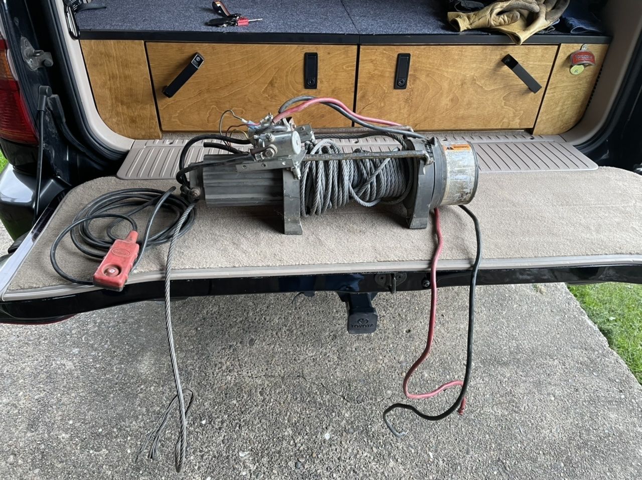

A friend of mine gifted me a Ramsey 8.5e winch. It's going to need some tlc, but hope to have it ready to go by the time my ARB arrives. Size wise, it's a the very bottom of acceptable for a 100, but I think it will do for my purposes.

Ramsey makes a quality winch, should be a great winch to have once done. I run a warn M8000, which I've heard people say is small. At the end of the day it's not the straight pull power of a winch but the mechanical advantage of your rigging, how much time you have, and the safety factors you want. I think it is a great fit and it has worked very well for quite awhile now. I am often on trail by myself and the smaller winch in my opinion gives me more options and keeps me safer.
I have a 50' winch line extension and a heavy snatch block if I need a truly long pull. I prefer knowing my winch is going to bog before I reach working loads on my other recovery gear. I also want the biggest duty cycle I can get and a fast rate of retrieval for my budget. I can and do just run double line if additional pulling power is needed, which I think is a good idea anyways for safety factor. Snatch blocks and extensions provide you many more options for recoveries, while also forcing you to think about if your tow points can handle 12k of pulling force. I typically run a snatch block just to know I'm distributing load over more than one recovery point while also knowing that even doubling my pull my winch will stop pulling before I reach the working load of my winch line.
Rabbit and the turtle. A high quality 8k winch with a great duty cycle and fast rate of retrieval can run a double hauled line and retrieve much more than a similarly priced 12k winch with a weak duty cycle and crawling speed on a straight pull. Plus, if you're running at the top end of the pulling power of your winch, you've got to do so on a low drum anyways, so I've got to run all my line out anyways.
