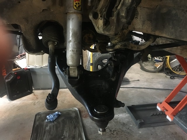

Taking bites from the elephant. Finish driver side LCA bushings (they were shot, so glad I went for it), 555 ball joint, replaced bushing and needle bearings, and have new races in the hubs.

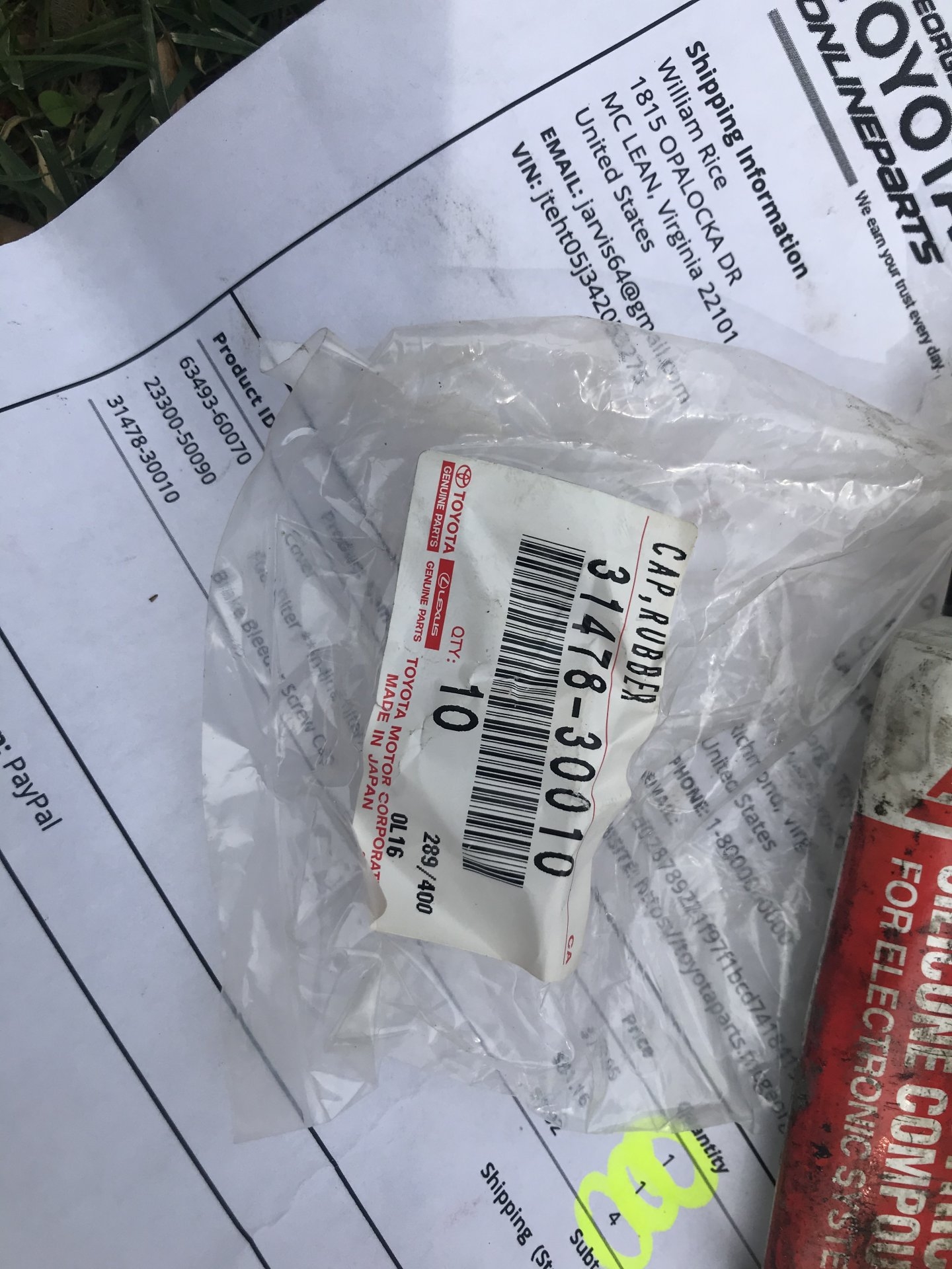

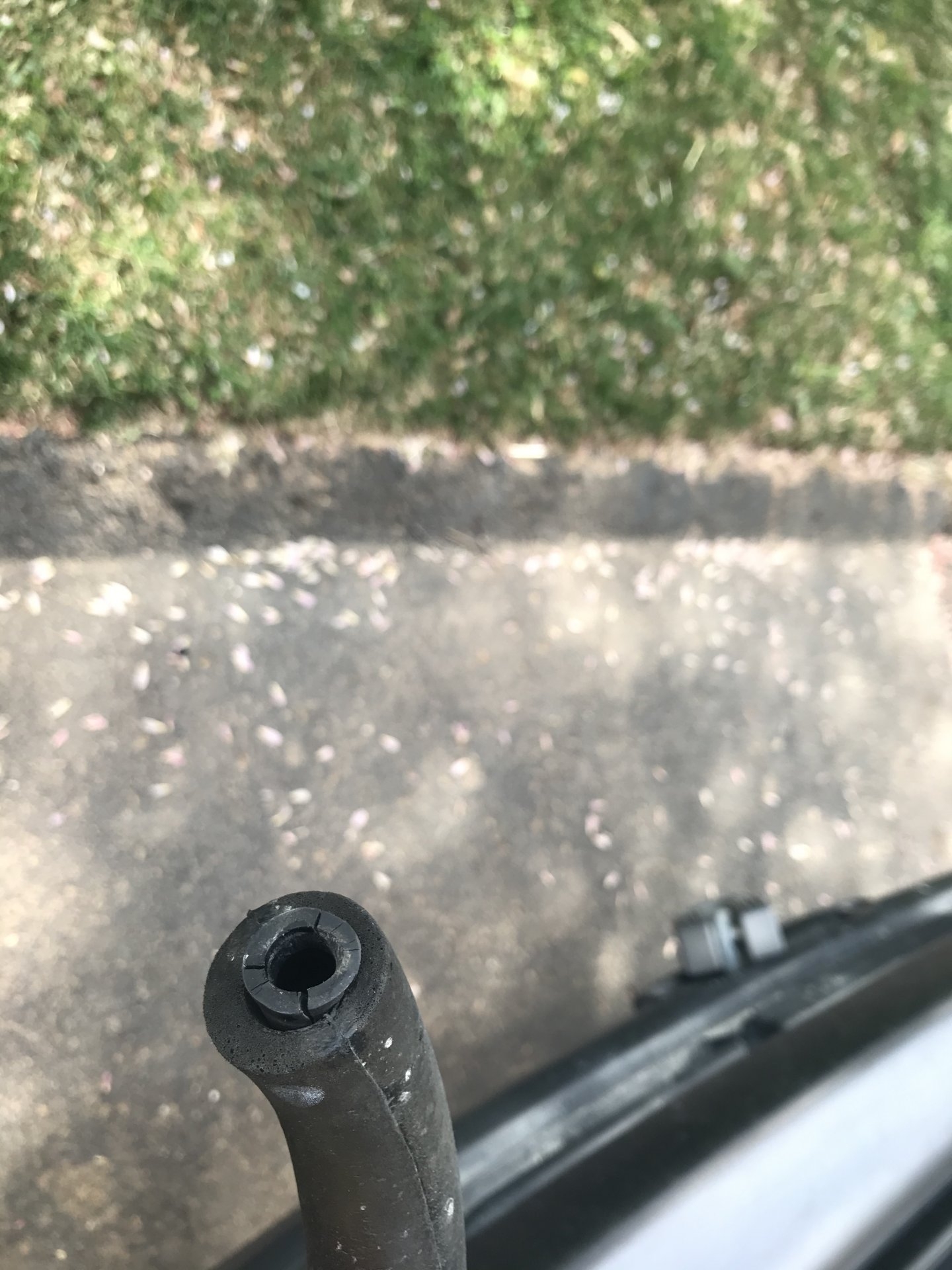

New pcv hoses (discovered I had the wrong style PCV valve so that’ll go on next week), new fuel filter, and replaced the MIA brake bleeder valve caps.

Thank you for the reminder to get new brake bleeder point caps.

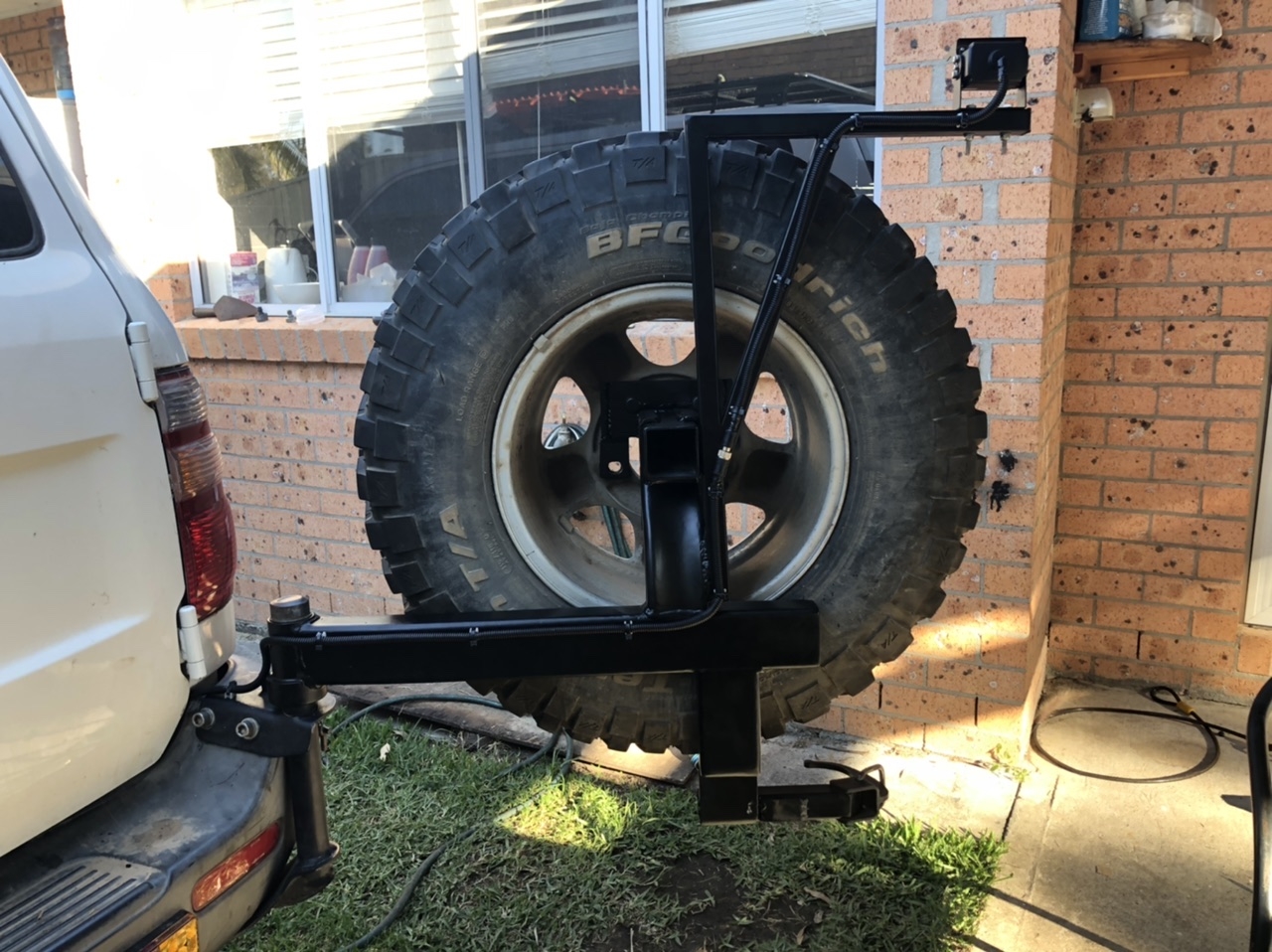

Completed the swing arm tire carrier on the Dissent Offroad bumper I won at the HIH9 raffle (A little more than a year after I received it due to a house remodel, two moves, and getting married slowing my wrenching time; still need to wire up the reverse lights and install the trailer wiring)! By far, the most well designed aftermarket equipment I've installed in my almost 25 years of wrenching. Thanks to @benc for his support of HIH every year!
I also added a Gamiviti @nakman spare receiver behind the spare tire and will use it for bike racks or traction boards bolted to the accessory plate I bought as well. You can see in the first pic that it had no problems clearing the stock wheel. Great product from another longtime HIH supporter!
