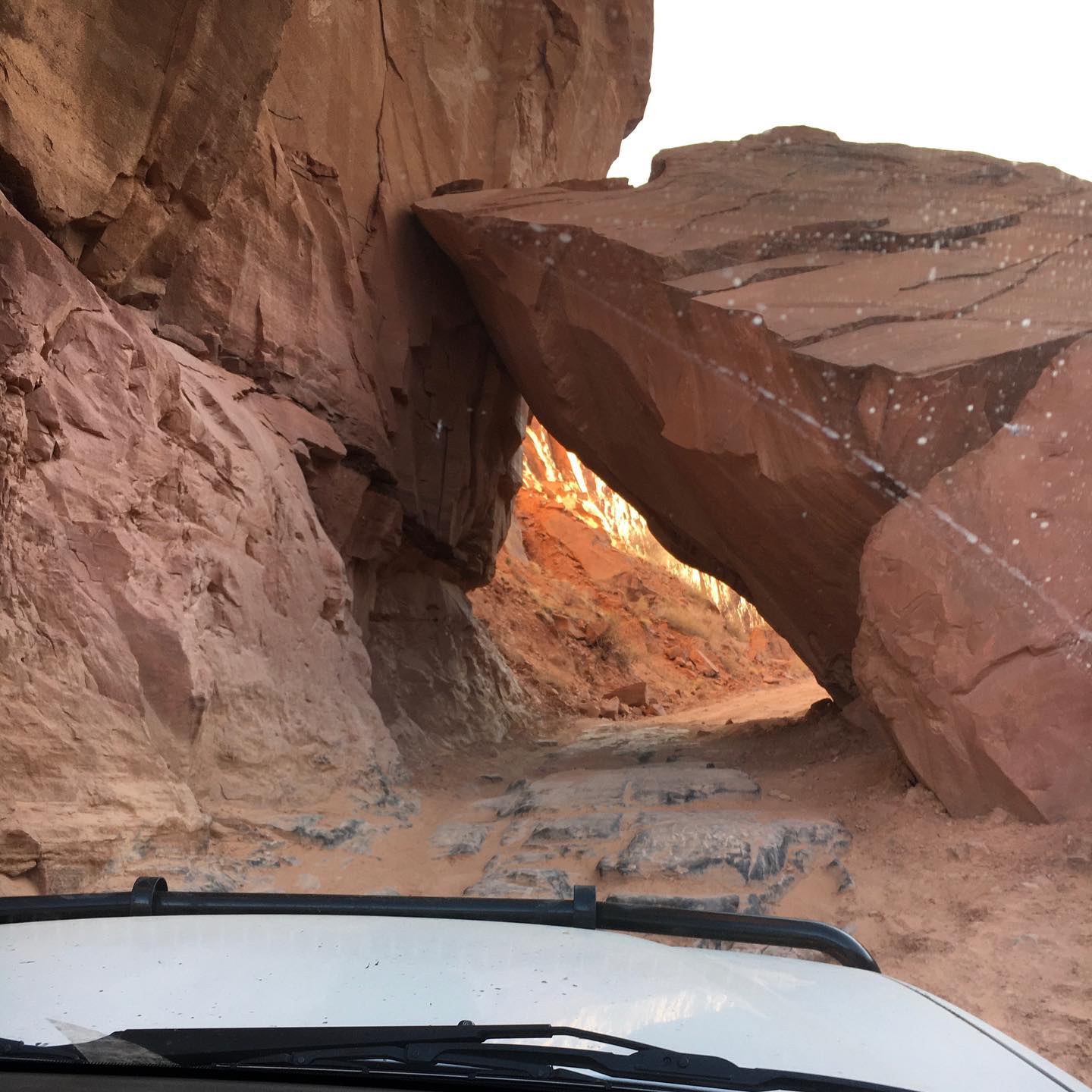

Moab "Weekend-landing" 2021. Our 5th year. It was Easter Jeep Safari Week so we tried some new trails--Moab was packed with Jeeps. Swasey Cabin Trail was a blue moderate. Tons of fun. Tough section at the end but the 100 did fine. Very cool driving under I-70 and then over it to head home, looking down. Long Canyon Trail was easy as usual. The Pucker Pass portion was washed out so I'd be curious to see what types of rigs were making it up that. The rest of the time we just hit 40-50 miles of country back roads which honeslty is our favorite part. Nobody around for miles and miles. I've got video driving under the I-70 Arch Bridges if you'd like it posted.

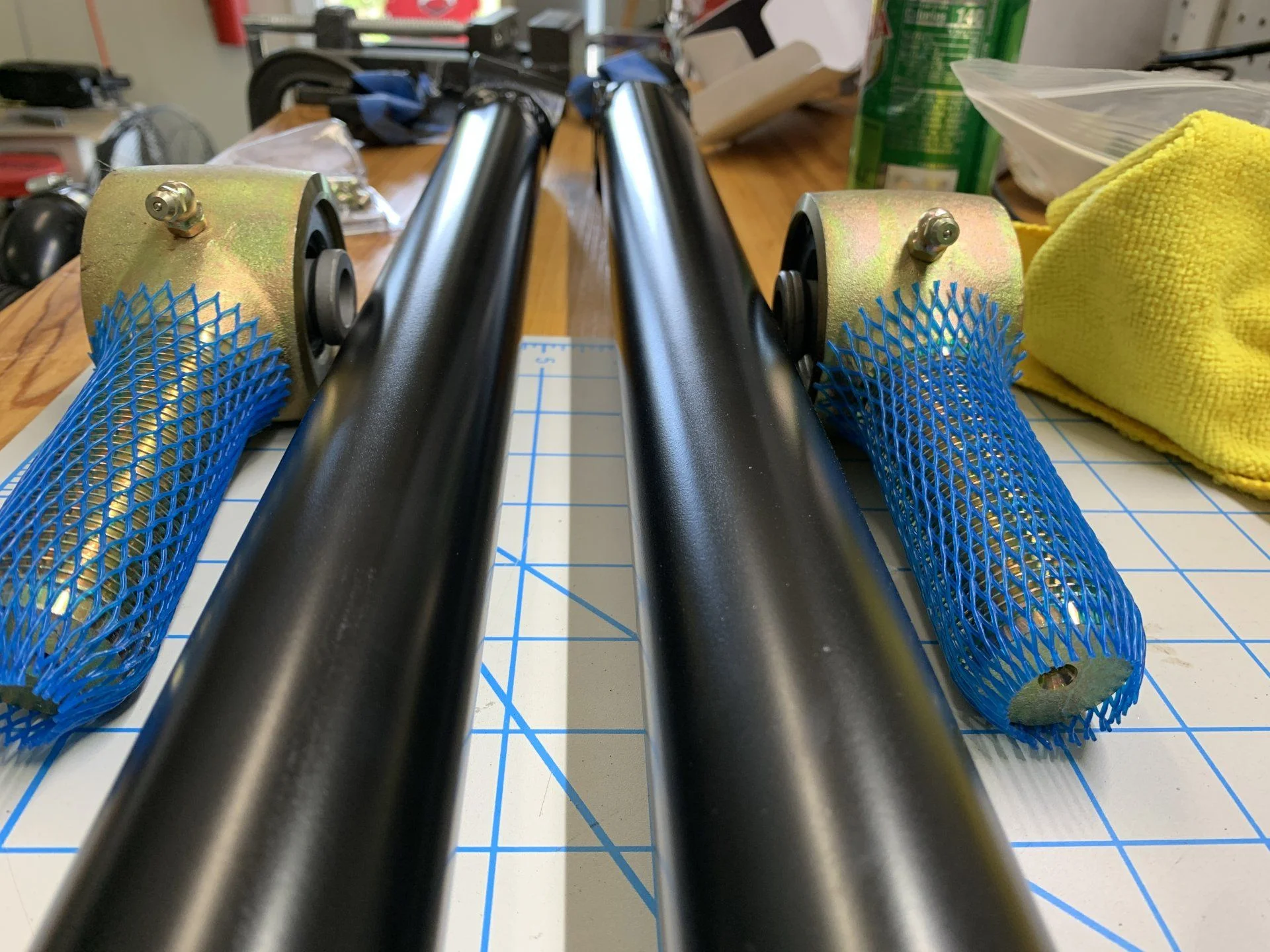

Oil & filter change, new Bosch Icon wipers (which I LOVE so far), and new Trail Tailor rear LCA’s. Bought them uncoated so I sprayed them with VHT epoxy paint and I think they came out great! Hard to tell the difference between this and powdercoat. Hoping it holds up well. Also replaced the straight grease zerk on the Johnny Joint to a 45° to make it easier to get a grease gun in there (@OwnerCS idea). So far they feel great!

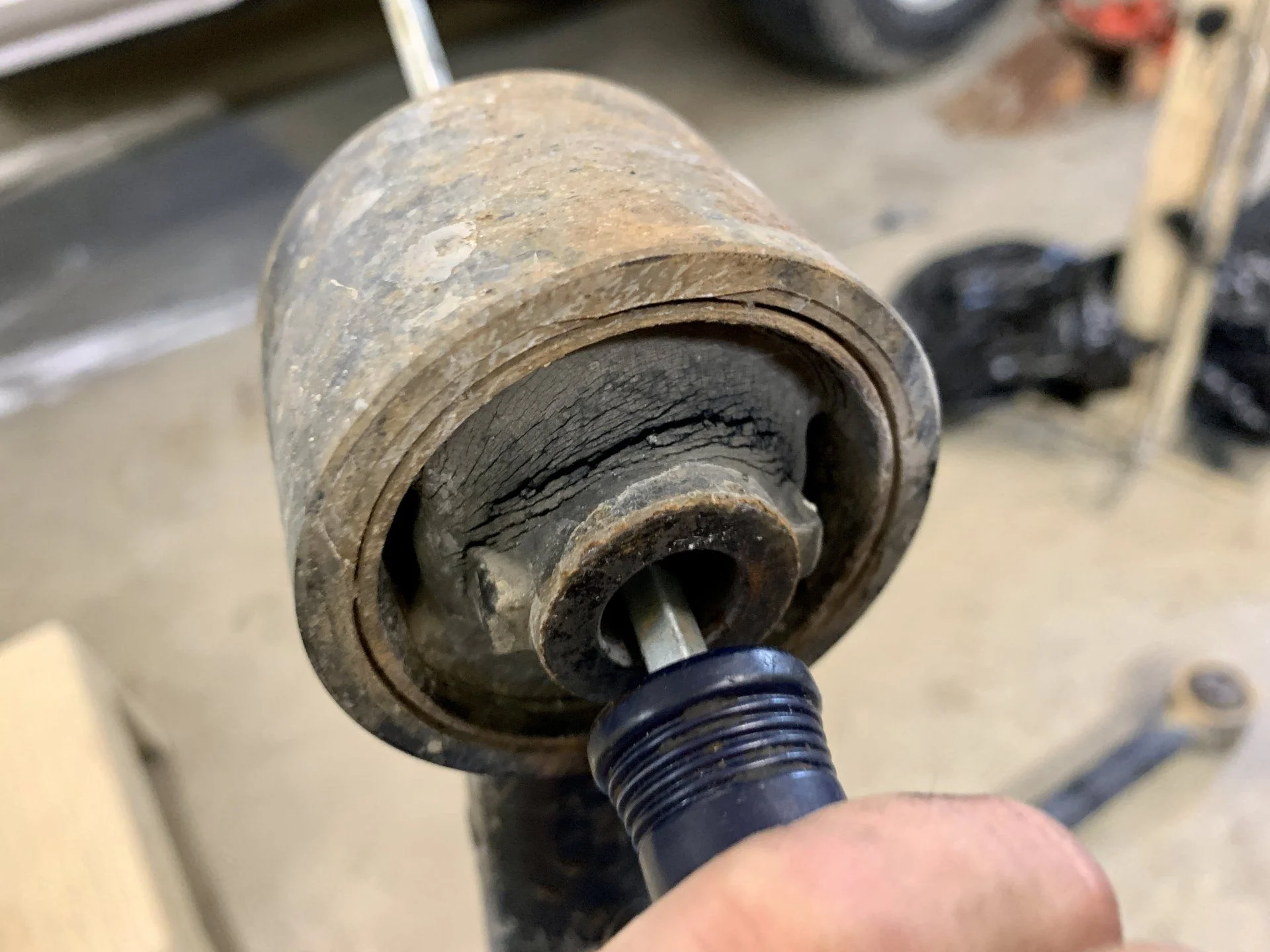

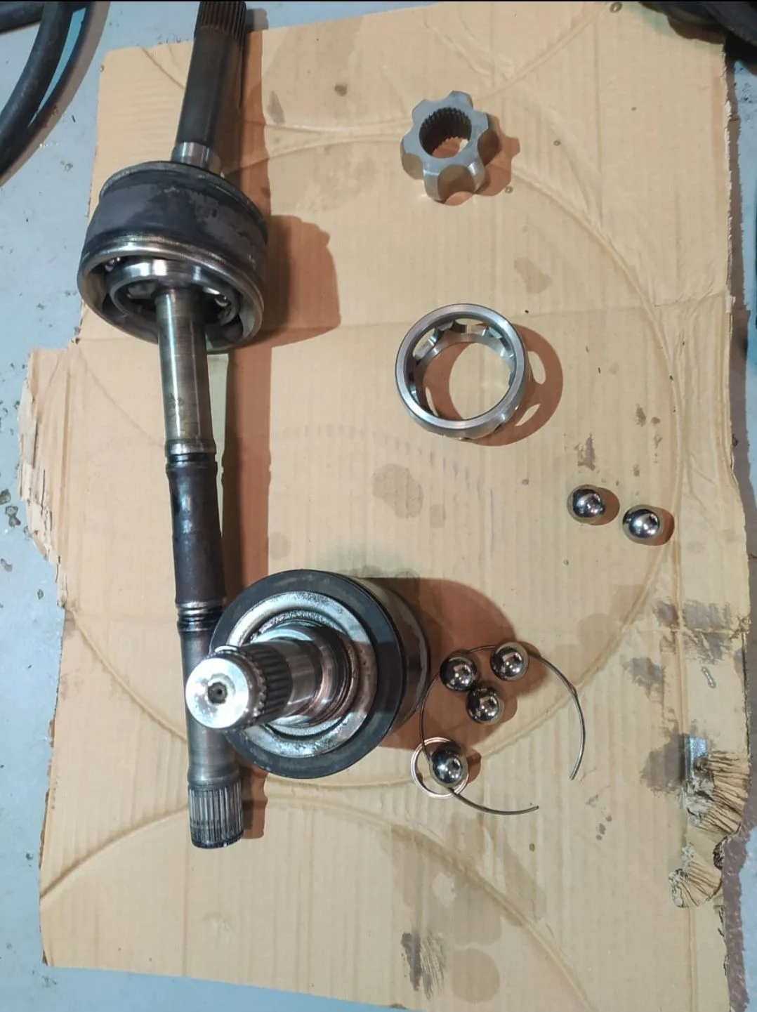

This is a 232,769 mile rear LCA bushing. Doesn’t look that bad at first glance but if you apply strain to the metal sleeve you can see the cracking and separation

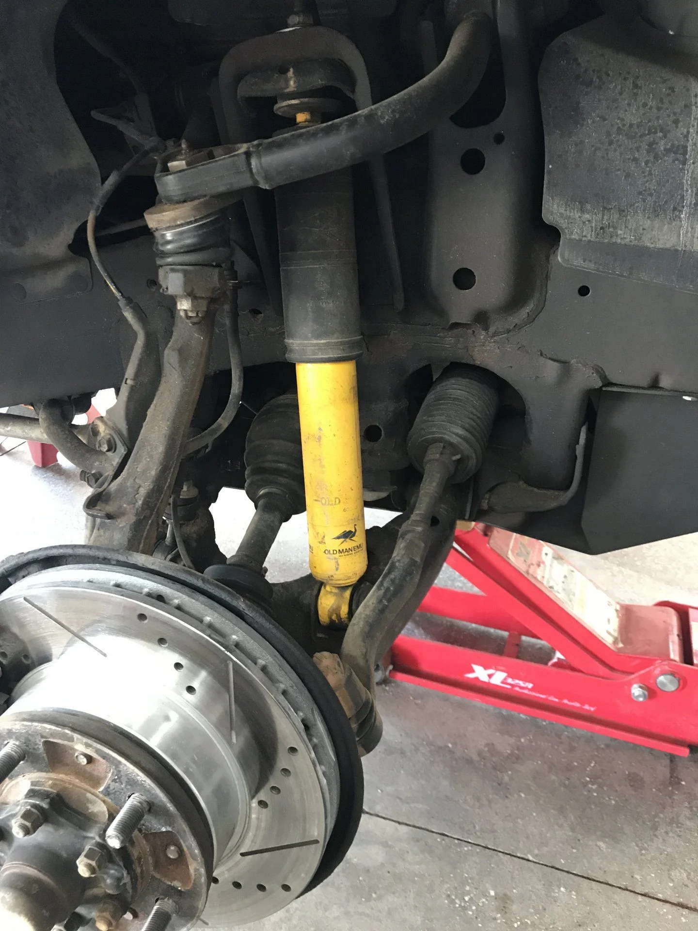

Playing around with front shocks. Removing the OME 60000’s with OEM for some R&D since they’re so cheap. Will sell the OEMs on here and give someone a good deal after my research is done. Even though I have a front bumper and full skid plates I’ve heard that you can find a sweet spot with the OEM shocks on a set up. I also have SPC UCA’s and Slee Diff Drop. Curiosity got the best of me and I like to tinker.

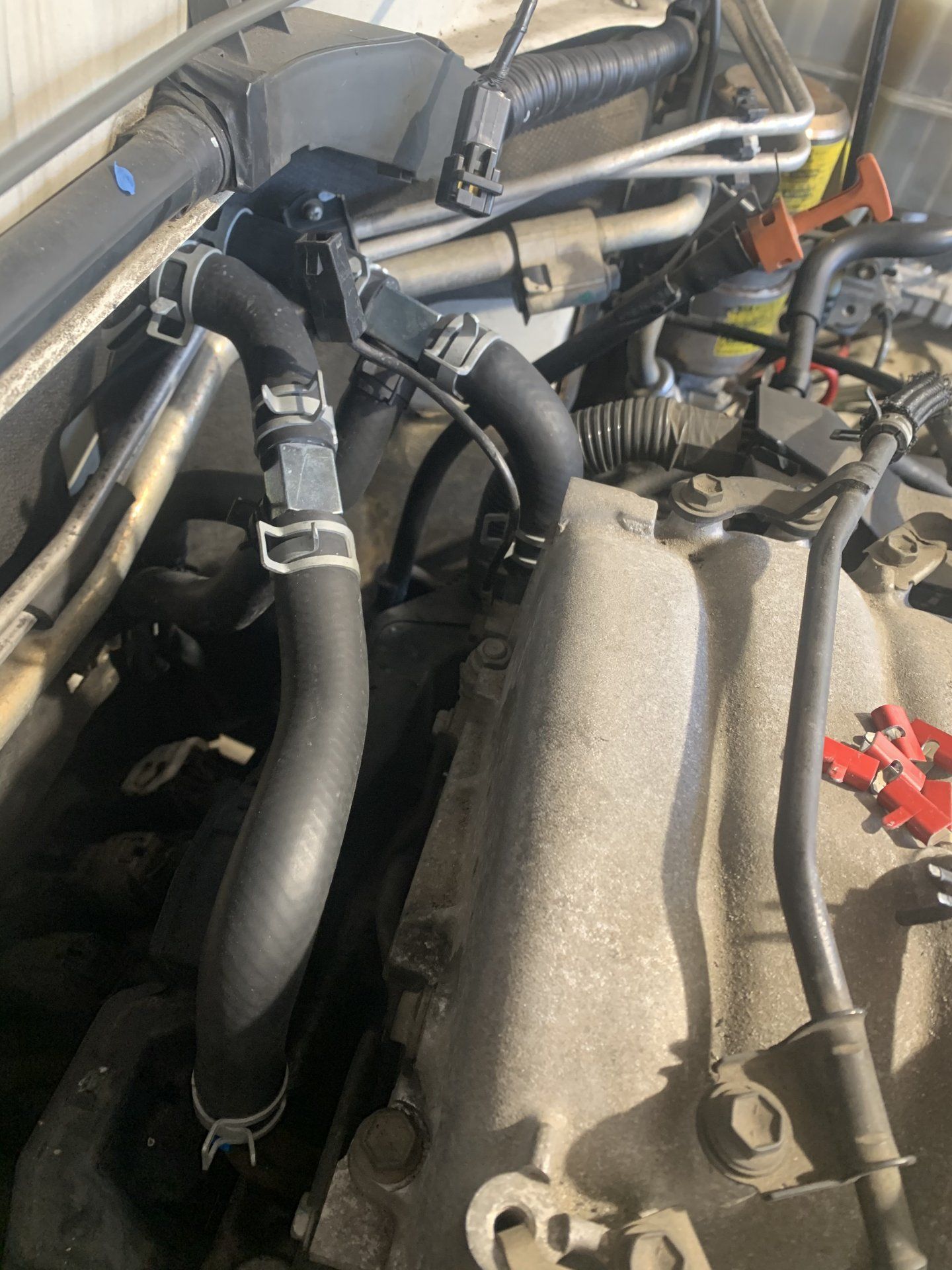

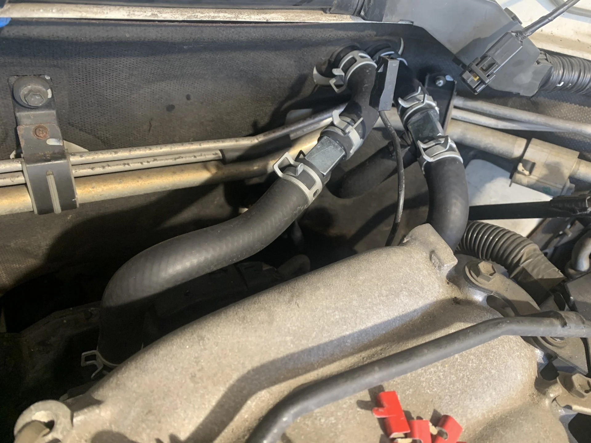

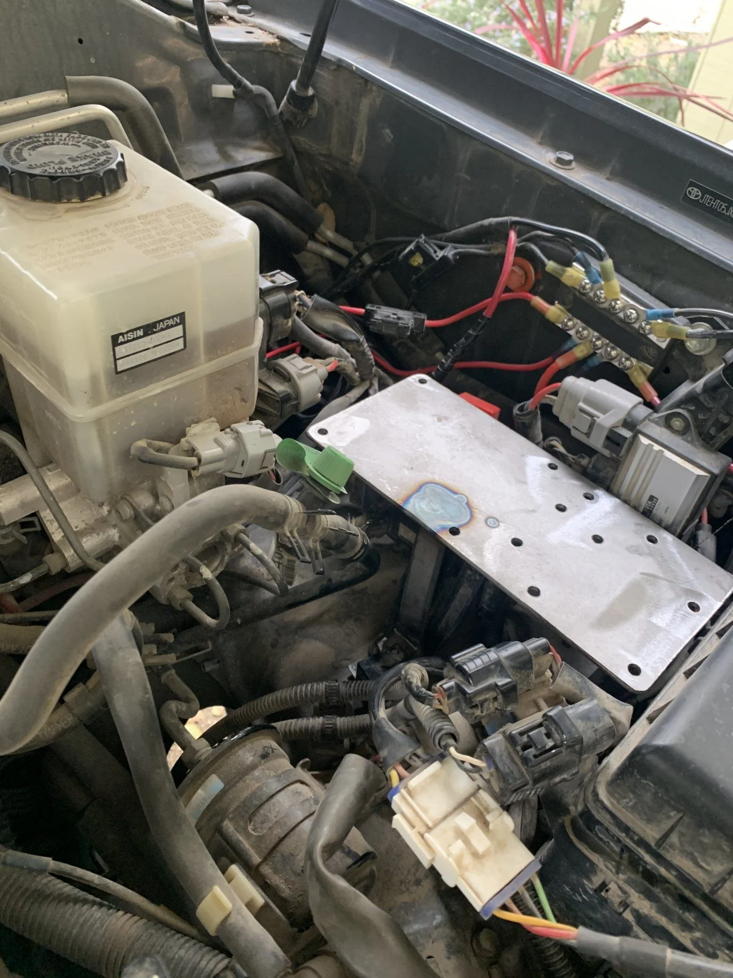

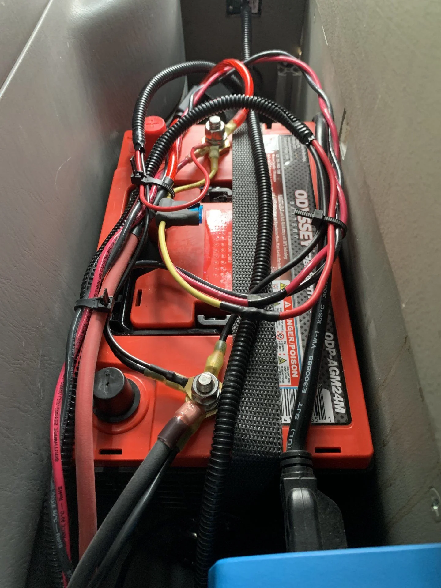

I finished off my dual battery set up. Installed this smart switch which disconnects the two once the starter battery drops below 12.8 volts. Built a bracket.
