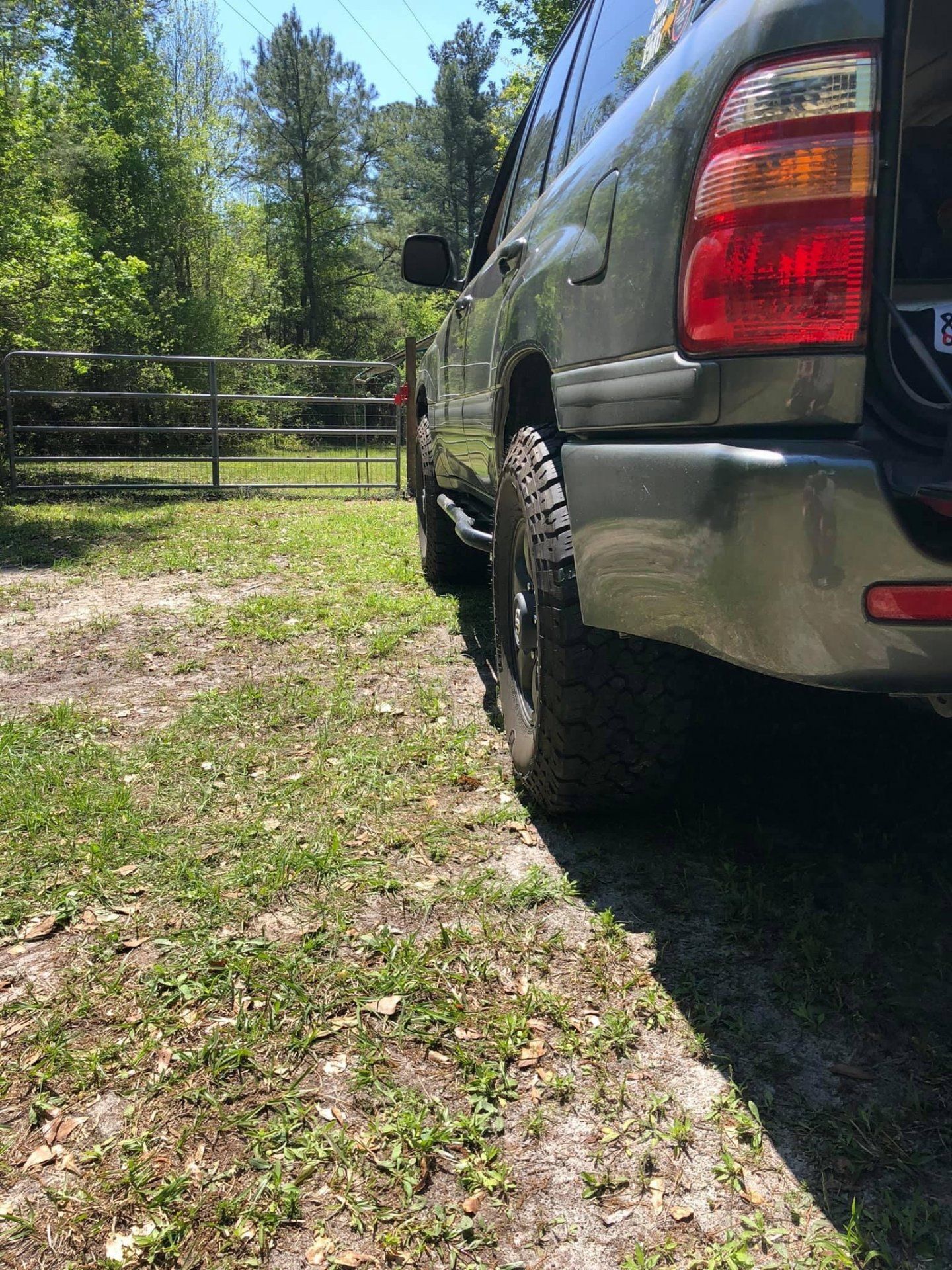

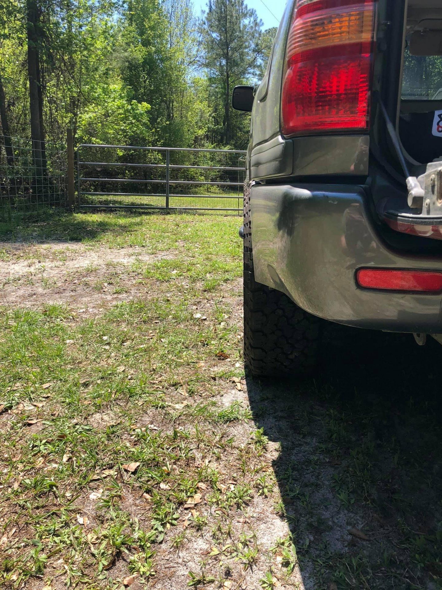

You do. @GTV has a couple threads on the matter (and his attempts at running no/very slim spacers). I went with 1" Boras and I think that is about the slimmest you can run without modifying anything else. You could go go another 1/4" slimmer (3/4" spacer) but you'll have to modify the dust cap/run different center caps on the RW wheels. There's more info. in his threads that is worth looking into if you want to see all of your options. Here's some 'poke' pics with my 1" spacers for reference.

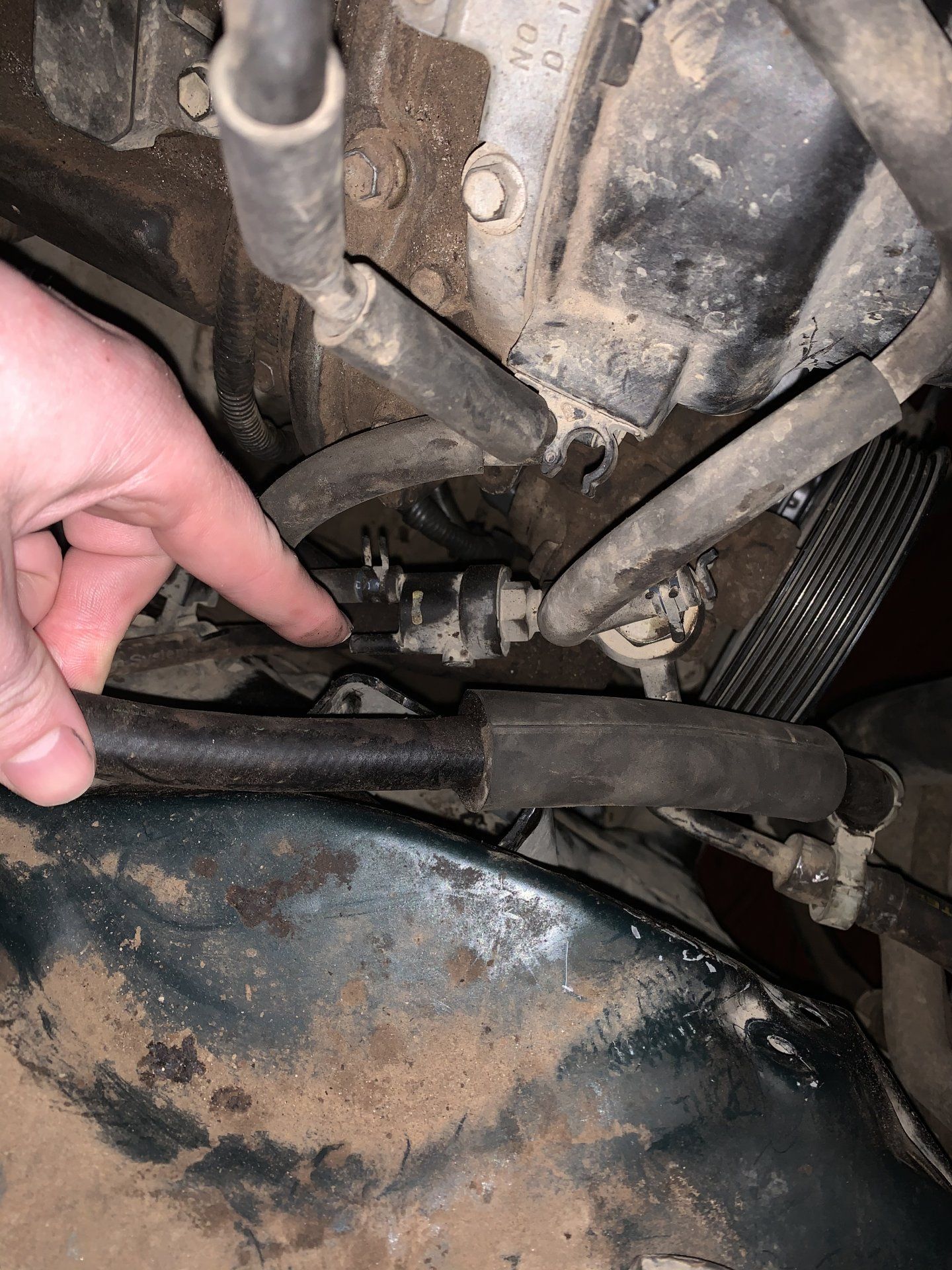

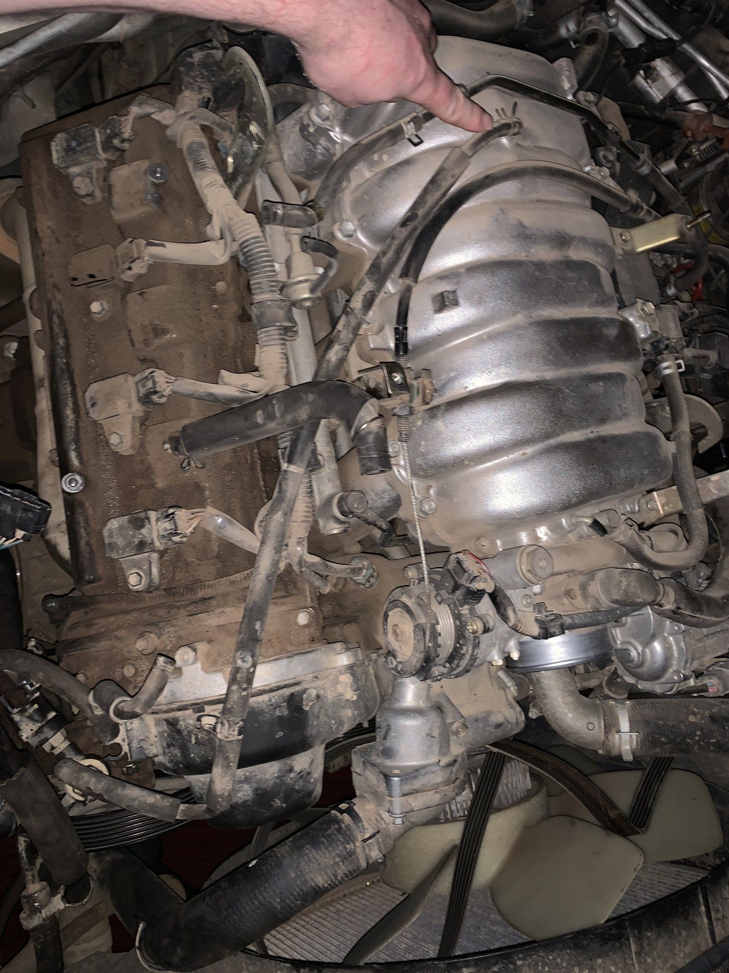

Howdy all, I’m wrapping up my alternator swap (what a PITA) and I’m struggling to recall if this hose on top of the intake manifold goes into the power steering? It must have come loose while I was jiggling it around because I can’t for the life of me recall why I would have disconnected it.
