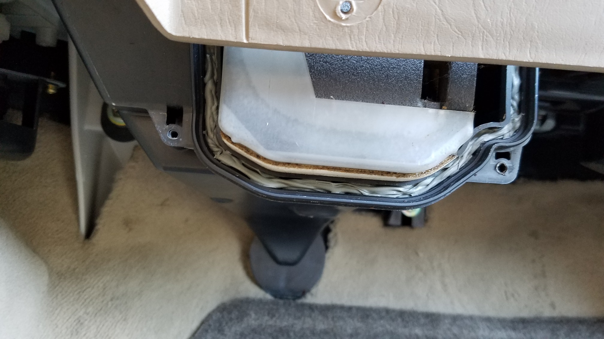

I finally got around to resealing the evap cover to stop the annoying drips onto the carpet. Cleaned out all the crap, not as much as I thought there would be after 22 years.
This was much easier than I thought it would be after reading through the threads. The key is to remove the lower bolt and upper nut from the dash brace marked with arrows here. With that loose, the lower dash had plenty of flex to get to the screw behind it and get the cover out and back in without too much fuss.
I didn't feel like going to the dealer to get the gasket, and had a big roll of marine-grade butyl tape that I use to seal things on the boat. If it's good enough to keep salt spray out of rail bases, it should be good enough to seal this cover.
