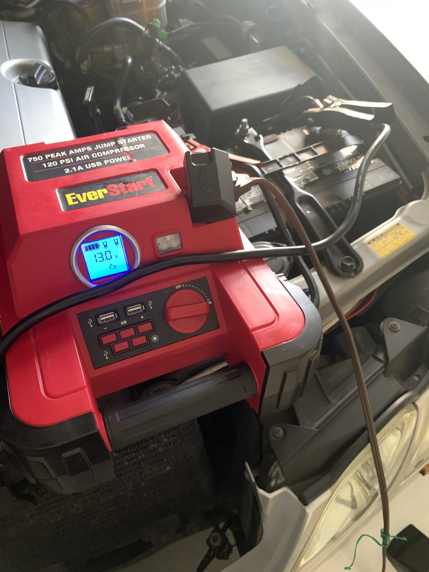

Finally narrowed down my “inaccurate” fuel gauge performance.
For about a month now I’ve been trying to reverse engineer the fuel gauge system. Already considered replacing the fuel sending unit found at the gas tank. The symptom is specific, when I start the motor, the fuel gauge reads empty (lower than then “E” mark on the fuel gauge). As I drive it it slowly goes up to its correct level. I tried unseating and reseating the FI relay, it worked for a few days but after a few days of not using the truck, when I start the motor again say after 3-4 days it goes back to the exact same symptom of “empty” reading even if it’s either full or half-full, etc but basically the reading is just plain inaccurate.
I used the truck for 20 miles yesterday, but prior using it, it sat in the garage for 3 days. When I started it yesterday, again, fuel gauge shows EMPTY, and by the time I got to my destination, it has creeped up slowly at the half tank mark (I’m at 155 miles area always when the tank is about half-full so I know that the tank volume).
Long story short, the closest component causing the symptom: the battery.
I hooked up a battery charger/conditioner to ensure correct optimal voltage and noticed that if battery is charged, the fuel gauge WILL immediately show correct reading when I turn the keys to accessories (not even starting the motor).
So I guess I need a battery replacement sooner than later.

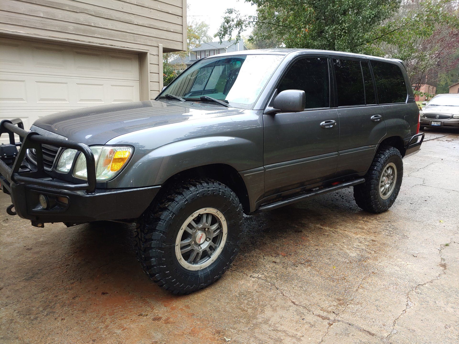

Replaced my Cooper St Maxx with a set of Toyo Open Country M/T. Same size, 285/75/17 . The Coopers just never did cut it in the mud and now that I've spent beau coups bucks on lockers and gears, it's embarrassing being the fat truck who can't get up the hill. Ready for the muddy soupy mess that will be GSMTR tomorrow!

Very nice! Let us know of how they do at highway speeds. Mud Terrains are pretty much a no go for us northerners since they aren't really suitable for wintery conditions.

I've only got about a dozen miles on them for the day, but they did feel a little bit twitchier on the highway. Got her up to Mexico speeds and as far as ride quality goes, they're no different than my Coopers were. There's a little bit of noticeable weight gain; I've lost a little bit of the punch I'd gotten back with 4.88s. Maybe a little more hum than the Coopers, but not significant yet. My speedometer is slightly more accurate, but I've got a brand new yellowbox on my work bench waiting for install and programming.
I'm really excited to try them out this weekend. Unfortunately, I bought the only 4 in GA so my 5th one will be installed when I get home from GSMTR. Will just keep my old Cooper there as a spare in case.

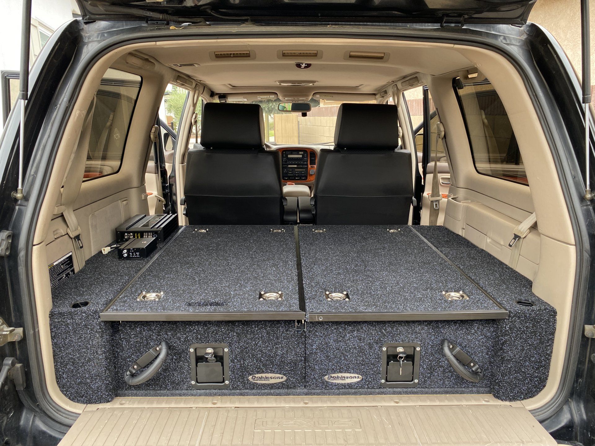

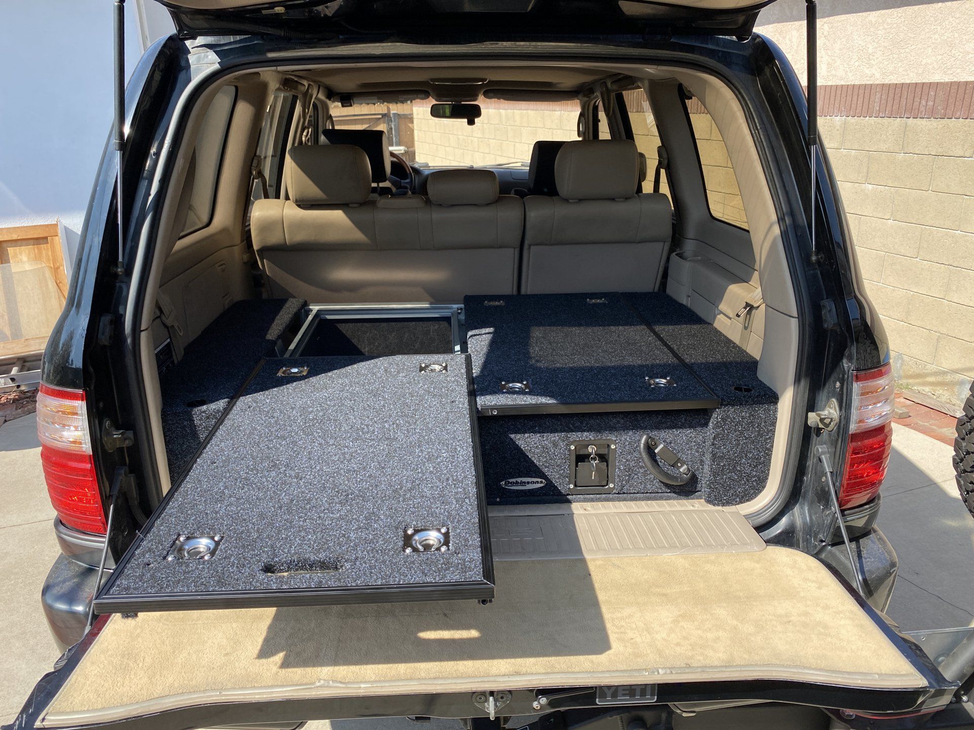

I had a big weekend last week. Dobinsons drawers in, Test fit rear Scheel Manns before making brackets, installed a Rig'd tultraswing, did a complete audio install Alpine 650, 2X MB Quart amps, 8" Hifonics sub, 4x 5.25 door speakers, ordered a front runner slimline 2, and this weekend will get Metaltech 4x4 rear trailing arms installed.
damm looks nice but those seats are $$$$$
View attachment 2480403View attachment 2480404View attachment 2480405View attachment 2480406View attachment 2480407
which version seat is that man looks perfect
