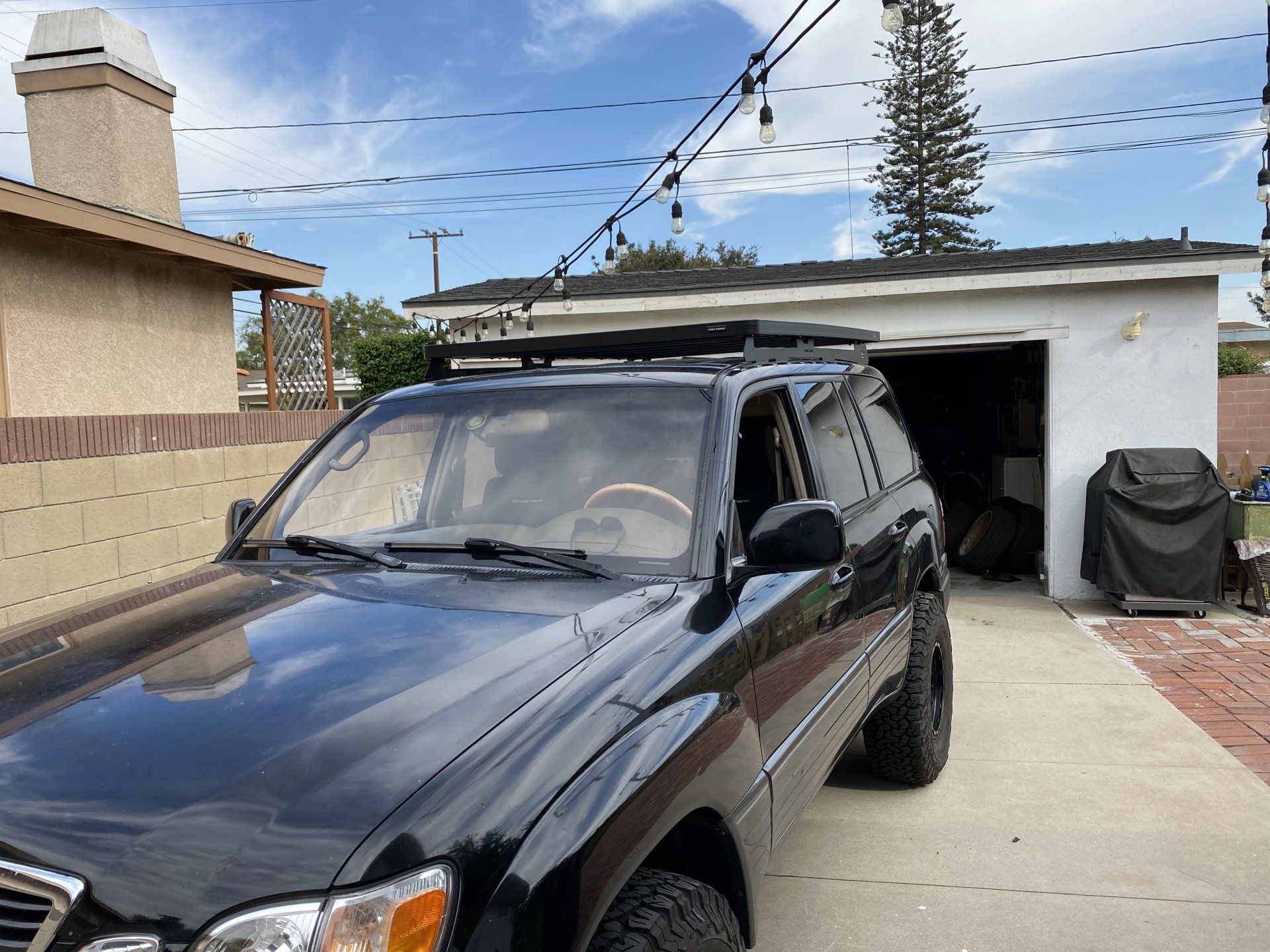

wished my paint looked half as good in photos.

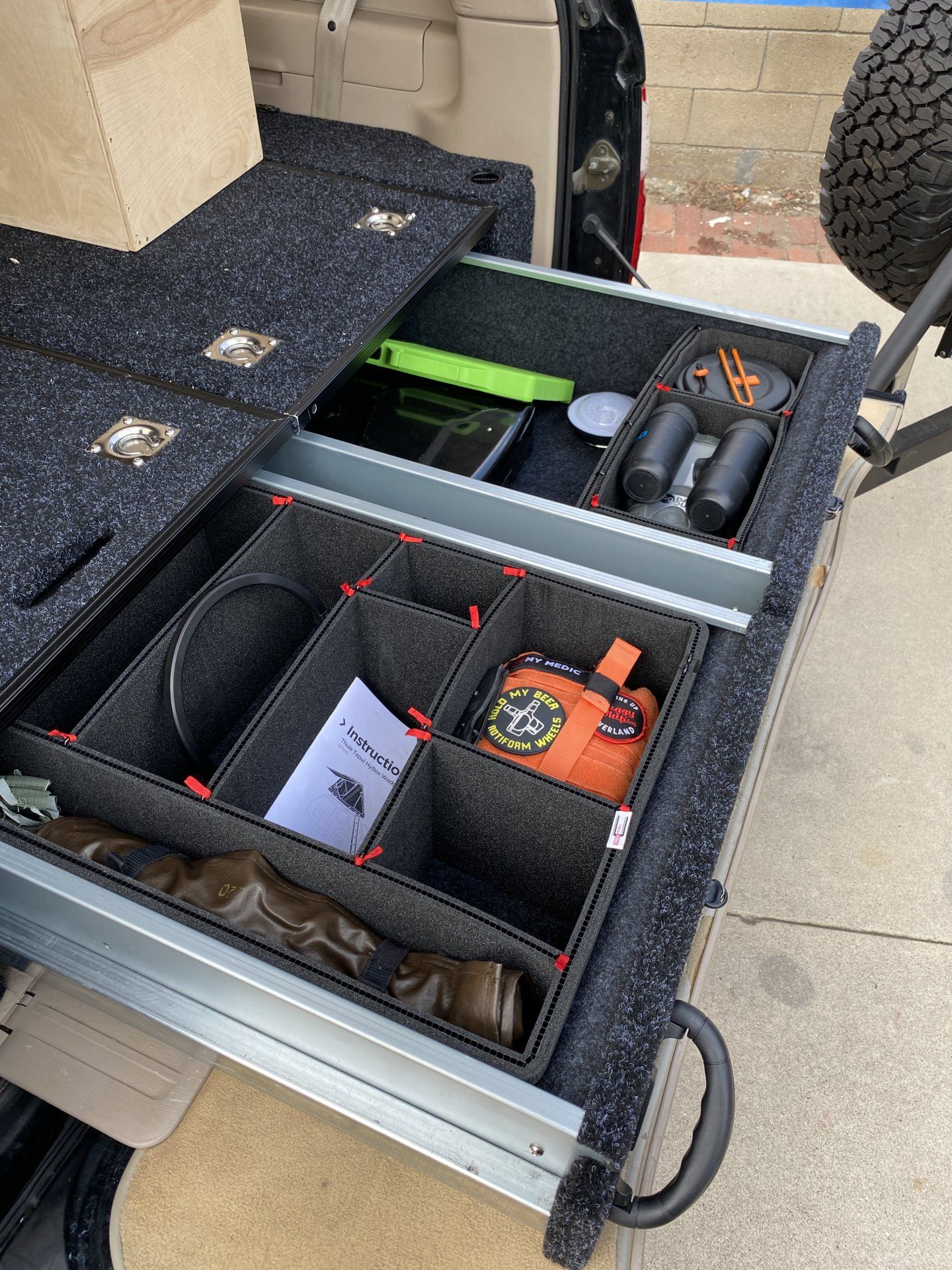

I had a big weekend last week. Dobinsons drawers in, Test fit rear Scheel Manns before making brackets, installed a Rig'd tultraswing, did a complete audio install Alpine 650, 2X MB Quart amps, 8" Hifonics sub, 4x 5.25 door speakers, ordered a front runner slimline 2, and this weekend will get Metaltech 4x4 rear trailing arms installed.
View attachment 2480406View attachment 2480407
You know if you've got room to move those seats outboard a bit more, you can drop a small fridge between them.
Dometic CD30 or an Alpicool 15L might both fit.
that goes in the back on the slide, seats will move outward a bit, thats as far as I can go until the base plate is made as the seats hit wheelwell trim/molding just sitting in there. Im thinking a small center console with USB, cupholders etc.

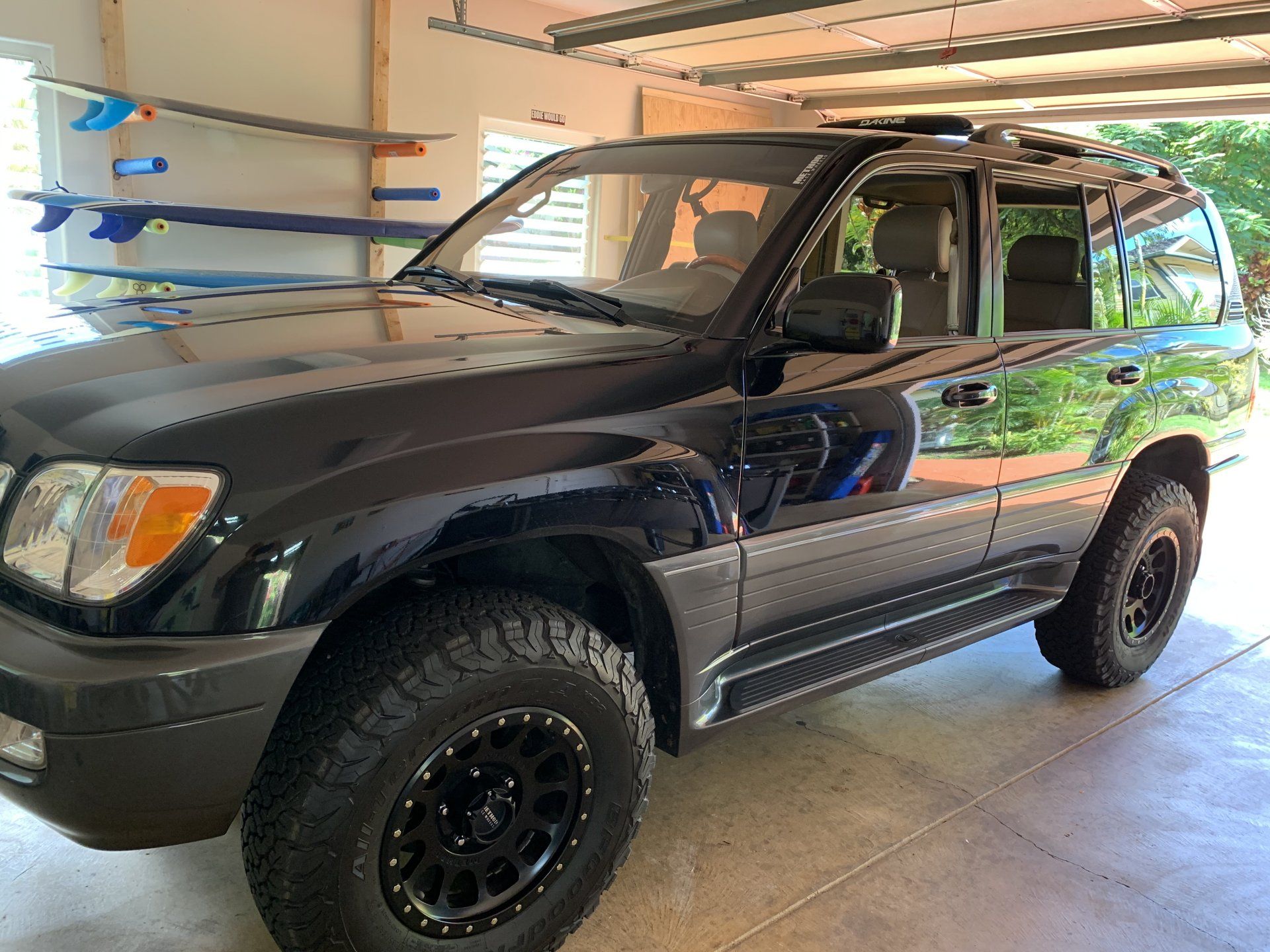

Wasn't quite this week, was actually last week, but - threw out the old clunky 8 year old 1.5" OME lift kit and had a new set up consisting of Radflo 2.5 extended travel shocks w/ resi's and adjusters, OME 2863's, SPC/Nolathane links and Slee/Spidertrax spacers installed at my friendly neighbourhood workshop.
Took her for a 1100mi shake down roadtrip to Arizona and loving the stability/handling at highway speeds and performance offroad.
Only issue now is the 275/65/18's look too small, and bigger tires are "needed" :hmm:
Might need to tweak the t-bars to level out the rake more, but really enjoying the way she's handling for now. Will let the springs settle and see how 275/70's look first.
