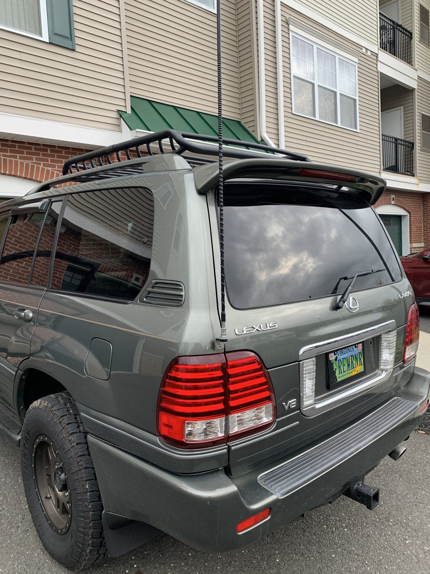

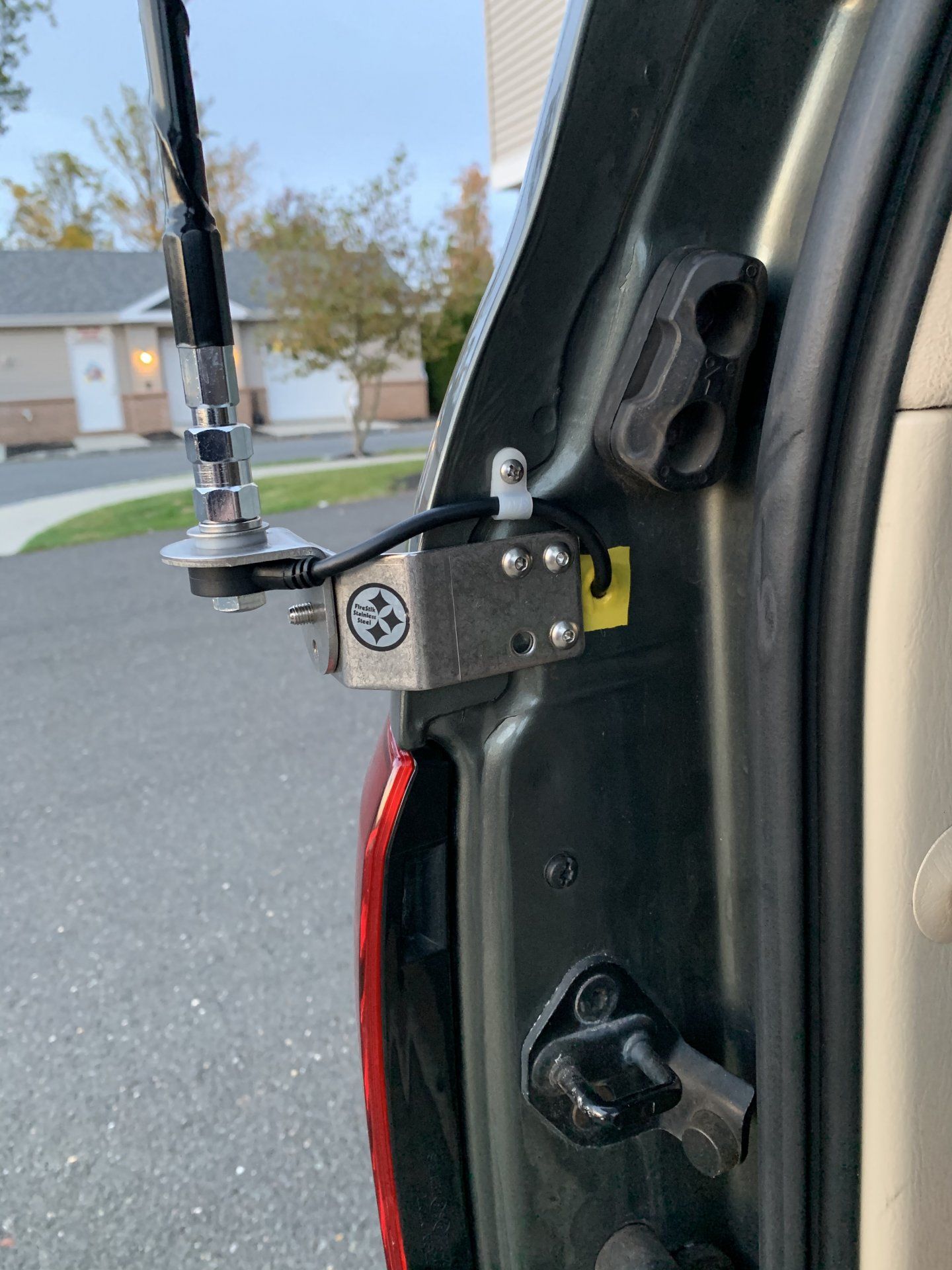

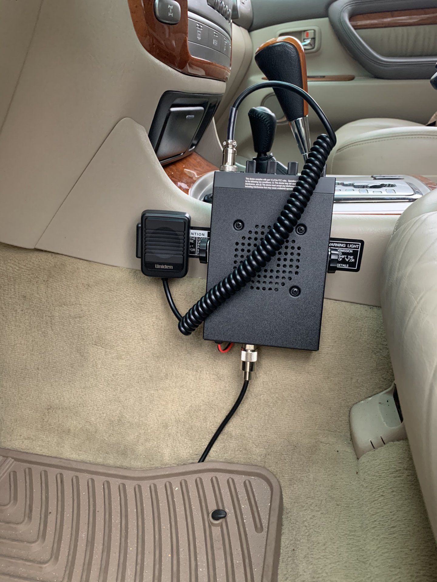

Finished installing my CB today! I’m satisfied with how it looks and how easy it was overall. Now I just have to tune the antenna next week.
If you are going to be doing any off roading you might want to consider a spring between the antenna and your steel mount @codester. The height you have there may meet with a low branch and it may take that right off the Pittsburgh steel mount... I watched one come off a Wrangler over the weekend.

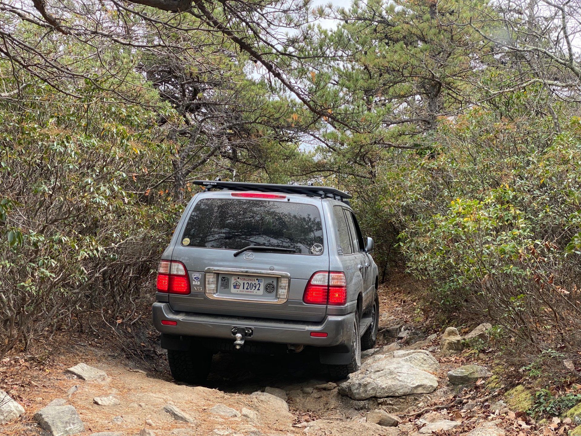

Trying to cram in as much off roading as possible before it's too cold for me. Canyonlands this weekend—Elephant Hill to exit at Bobby's Hole, Beef Basin back to Moab for the drive home.
Little on the fat side, but she fits.
Love the line: "Fat but she fit..." Threading the needle...noice job.

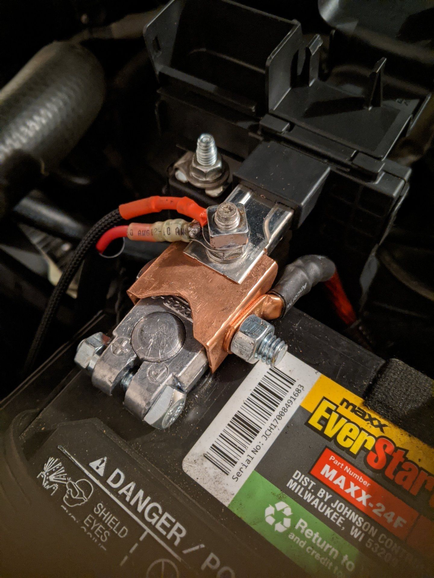

vice, torch, amazon.
3mm copper is too thick, for me at least.
16 gauge is what's in the pic. I could not find 14 gauge, which is 2mm. 16 gauge is 1.6mm
The lead clamp is the same that everyone buys. I wanted a stock main fusible link with stock cover but with the better clamp. That's what I came up with.
Lots of ways to kill that bird.
