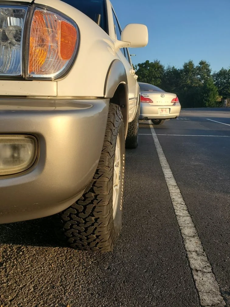

Got my Spidertrax 1.25" spacers finally installed. It was purely for looks, but glad I did it.
Thanks to Slee Offroad Betty looks so much better.

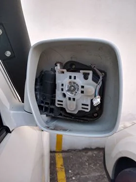

Lost my side view mirror on the highway... Not cool when I have a safety inspection in 10 days! Lexus quoted my $571 just for the mirror itself :rofl:.
eBay is your friend for this part. I just got the glass with backing mount or my driver's mirror for $76.00. Should be the same for your repair just make sure you get one with the heating elements. Then it's as simple as (1) plug-in the new mirror heating wires (2) clip in the new mirror (3) pat yourself on the back. One :banana:

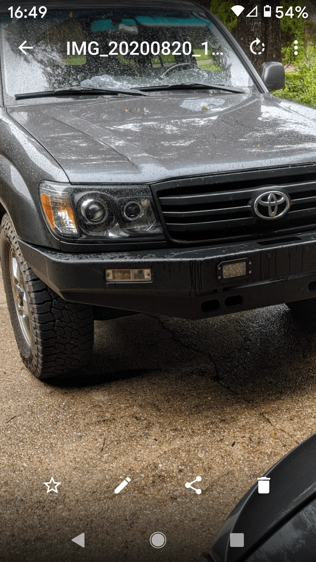

morimoto HB LED install. NO cutting of the reflector required except you must drill the one piece LC lights to 22mm hole size. They're polorised unlike the 2 stroke but they work the same with with a 7ohm resistor and the led harness if DTRL is a concern. Good looking LEDs for high beams without too much fuss.

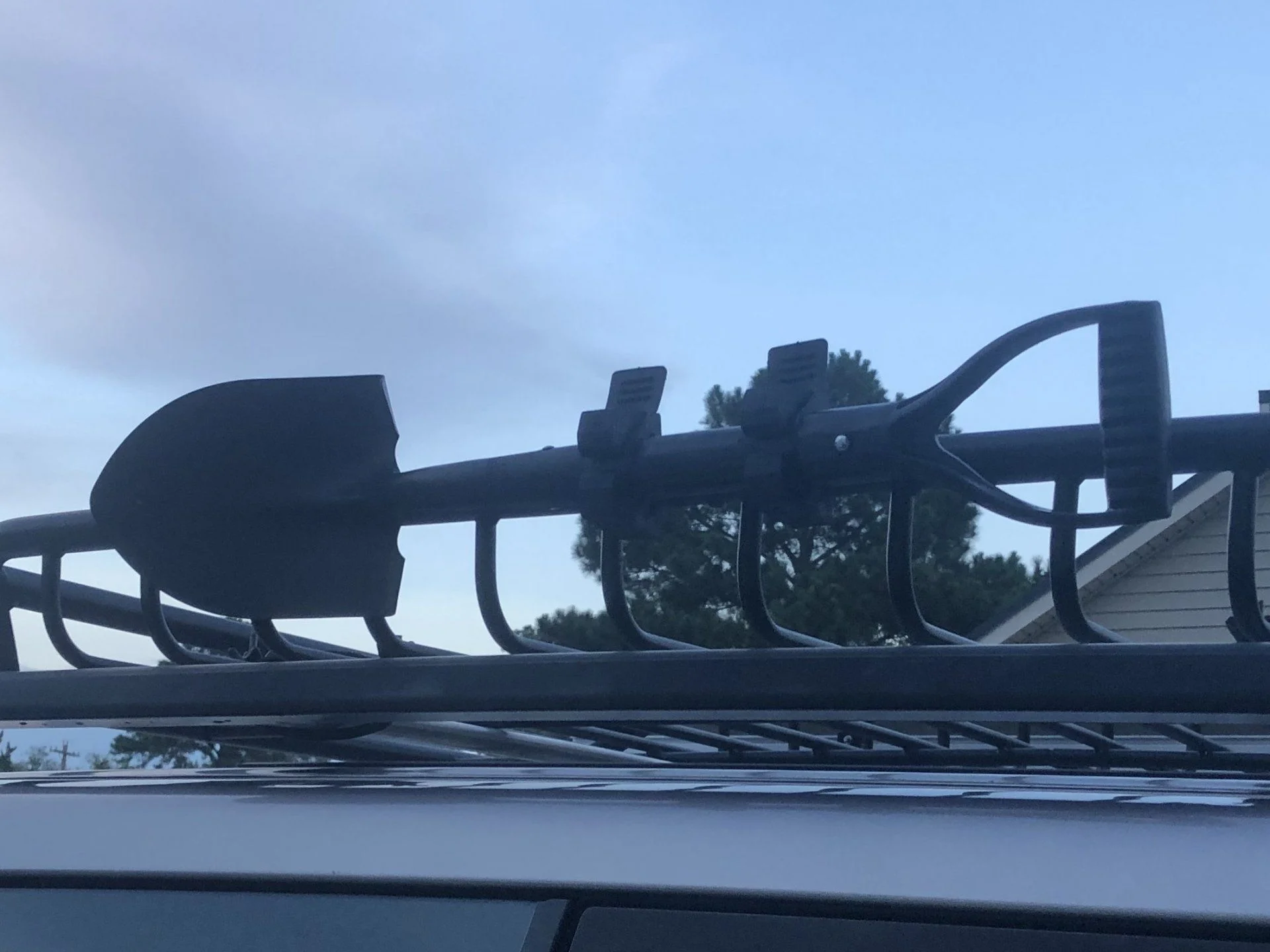

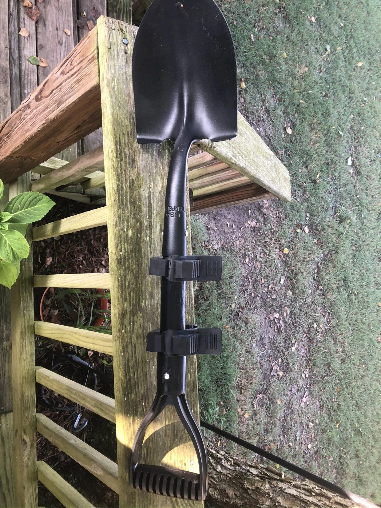

Can you share were you picked up the parts to build?
All you need is a pair of conduit hangers from Lowes (diameter will depend on where they're being attached), 3/4" carriage bolts to attach the tool hanger to the conduit hanger, and lock nuts for all carriage bolts (including the ones that come with the conduit hangers). Hope that makes sense, it's pretty straight forward. Oh - and some black spray paint :).
The hanger does tend to slide when metal on metal (mine is a hair too large for what I needed - I have 1" and should have used 3/4" conduit hangers), so I added some electrical tape on the inside lining of the conduit hanger to add a little friction and seems to have helped.
DIY recovery tread holders are next.
Link for conduit hanger example: https://www.lowes.com/pd/Sigma-Elec...RbT05IITdhAT_zGtirwaAsGyEALw_wcB&gclsrc=aw.ds

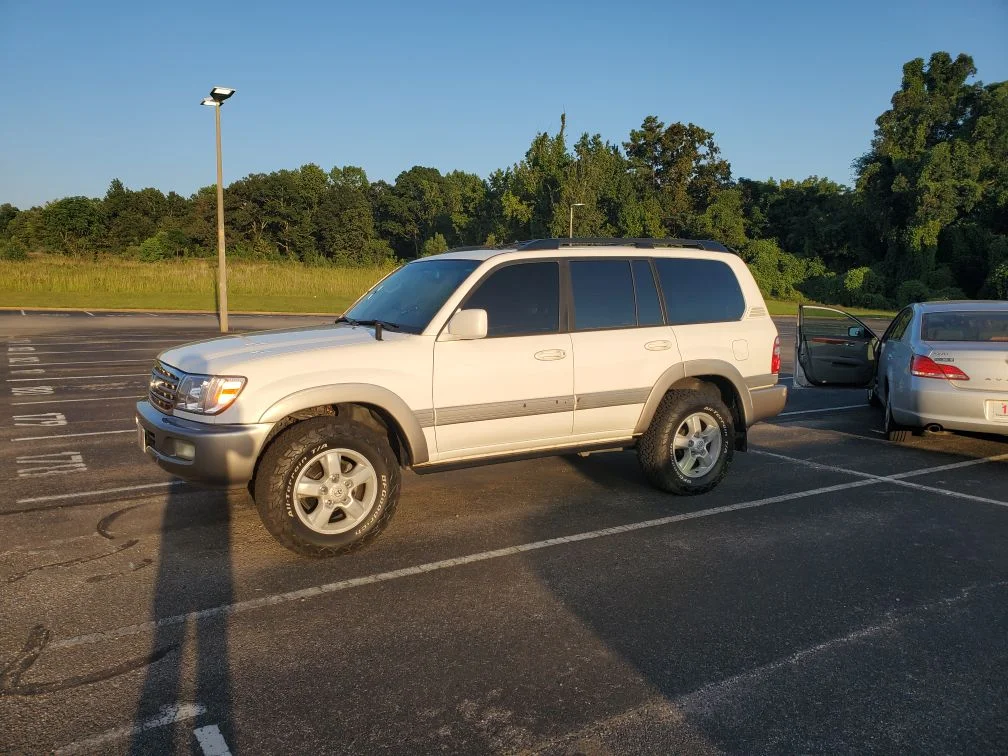

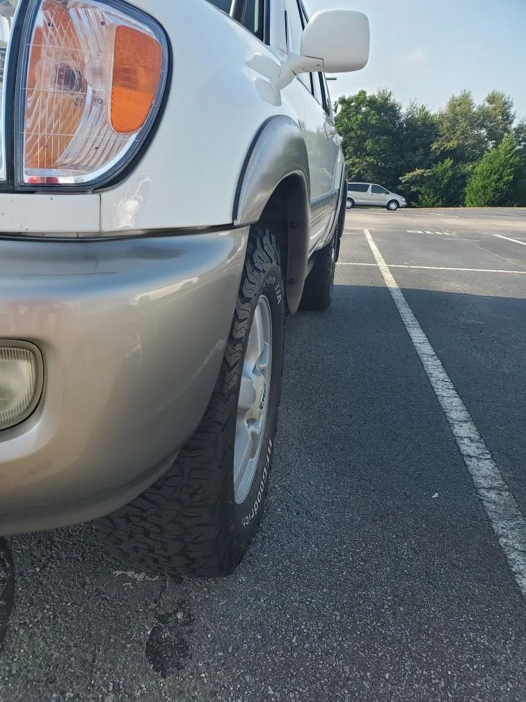

Nice, what size tires are you running?
