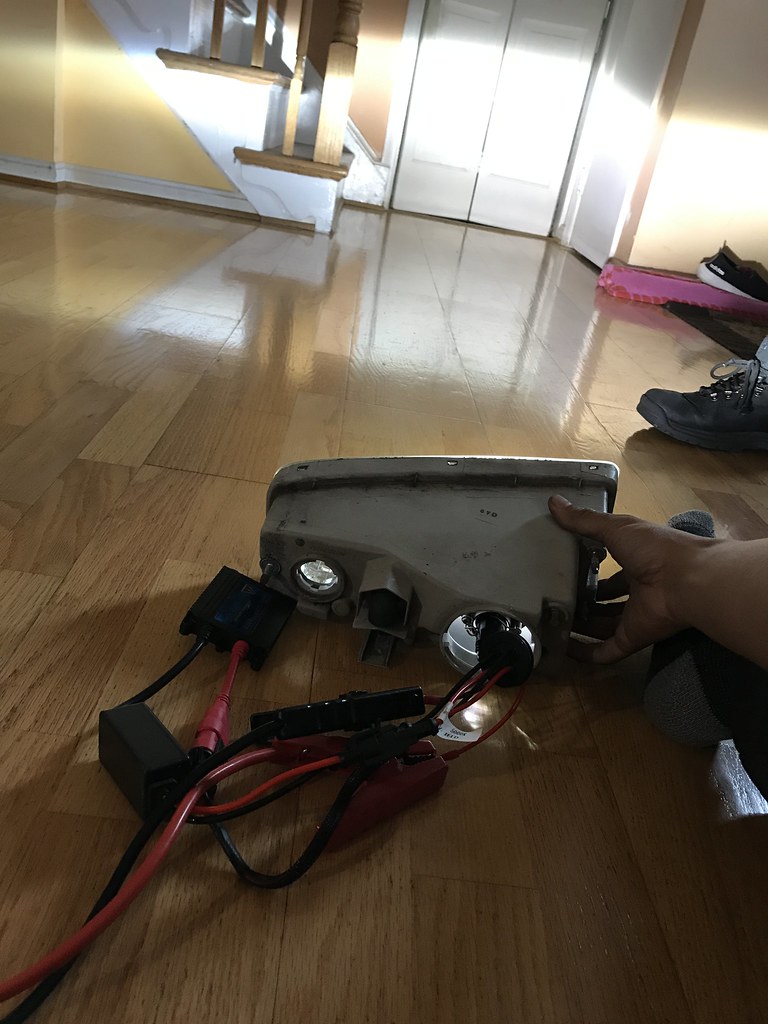

Retrofitted some H3 5500K HID into the OEM fog light, what a PITA, had to bore a hole for the wiring through that cap and make a new connector. H3 bulbs suck, wish they used 9005 or something for the fogs. Not a lot of room to work with. Not quite dark out yet, when it's pitch black i'll take it for a spin and see how it is.

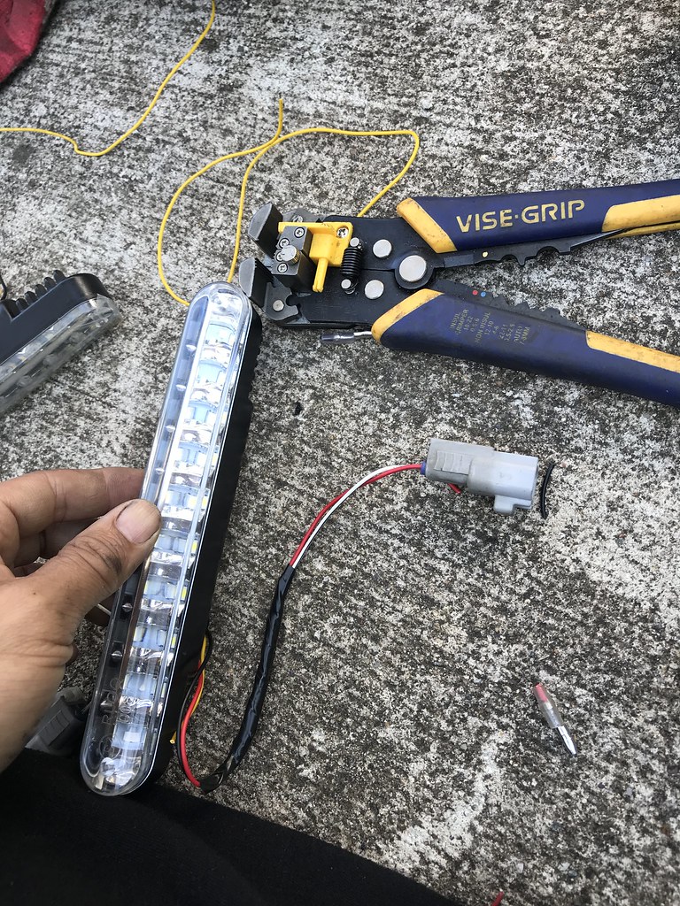

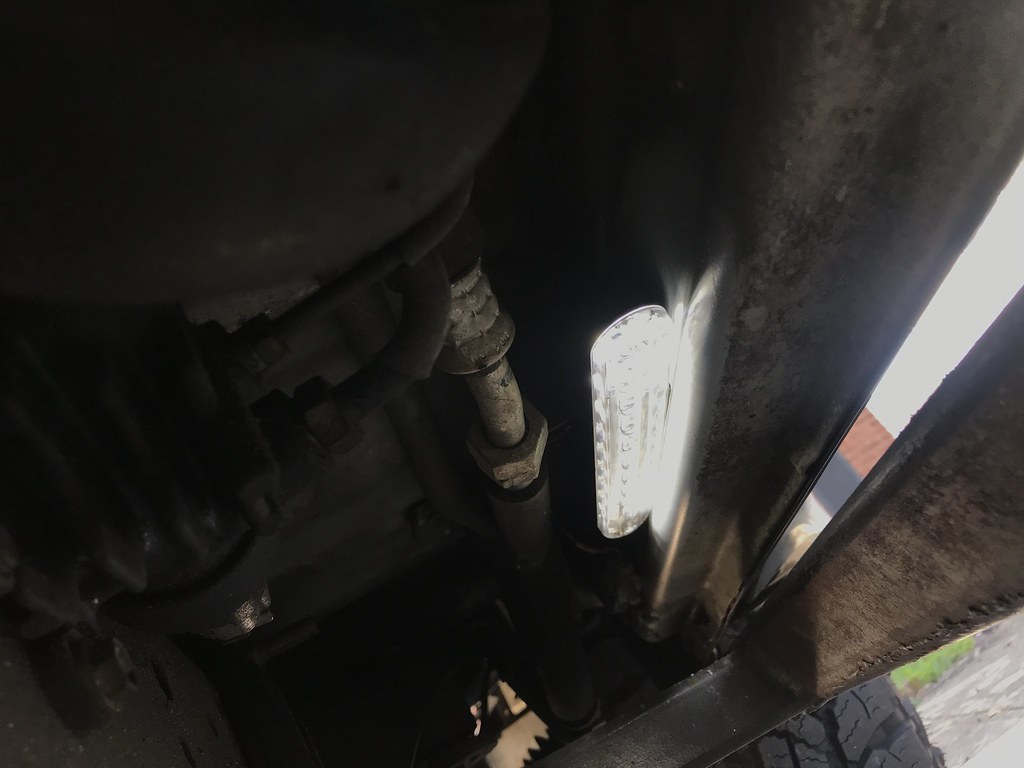

This has been on the back burner ever since i took off my running boards for sliders, i miss the courtesy puddle lights when you unlock the vehicle, this literally took 5 minutes i don't know why i sat on it for so long. Just wire it up to the running board pigtail and plug it in and double side tape against the body.
How does it spread the light at night? You have many more LEDs pushing the light now.
You asking about the courtesy puddle lights? I just put them in today, when it gets darker i'll take some pics. I forgot what the stock steps look like at night, but thes LEDs are not running the whole length of the truck, just focused on the driver's front and passenger's front foot area.

i installed Honda S2000 projectors in my fog lights. They are bright.
What? let me see, how did you pull that off. Fog lights are so small.
Oh you've got an LC, my LX has projectors in the fogs but they're tiny. What are you running for headlights? Any night shots?
Headlights are stock. sad My S2000 mod was done about 11 yrs ago. Need to put a clean set. Bowl on projector is burnt out. not as bright. I have a set of SC430 projectors with Clear lens from a Nissan 300Z. light output is the same as S2000 projectors but with a purple cutoff color. Nice. looking on getting some 2005 headlights and putting Q45 projectors , just for looks cuz light output sucks.
