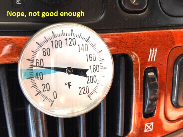

Wifey says her A/C is not cooling as well as in the past. So...I took a look at it.
First checked the static pressure:
Then checked my vent temps:

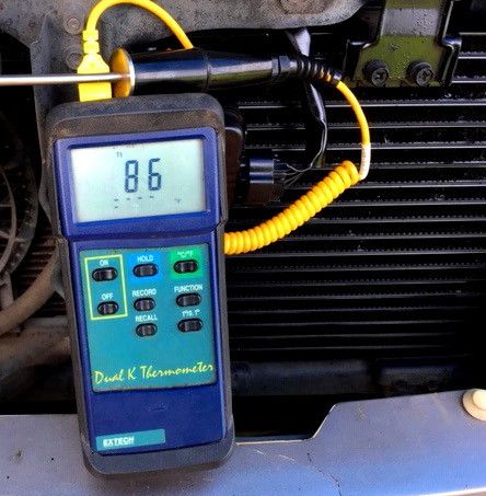

Took the ambient temp so I'd know about where my pressures need to be:

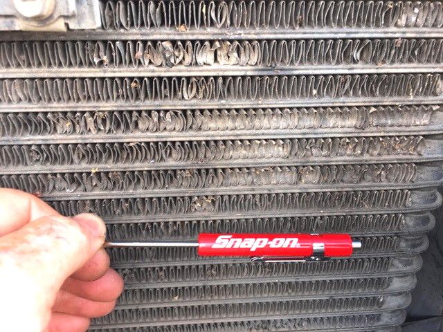

A little Trans Cooler repair.
I always have some insignificant 'rock damage' to the fins....but a Mockingbird went through the grill at highway speed and left a pretty good spot on it. I picked the feathers (and parts) out of the cooler the day before and then purposed to try and straighten up some of the fins. I used a small pocket screwdriver to manipulate the fins as best I could....then shot it with a light coat of paint.
Far....from perfect, but better than it was.
