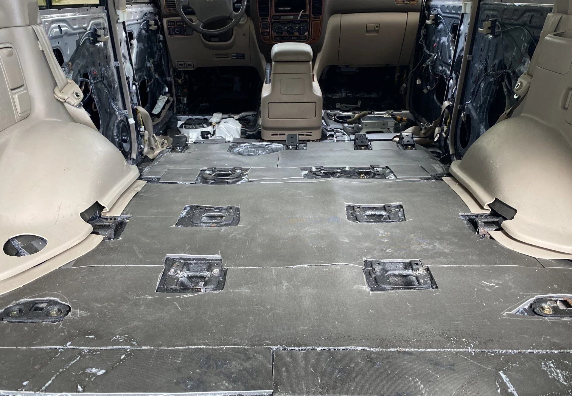

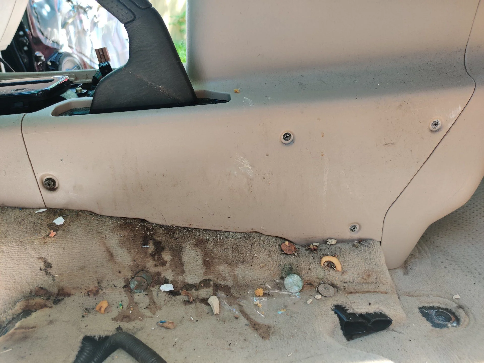

Finished the last of the sound proofing. Secondskin luxury liner pro. Getting closer to wrapping up this build

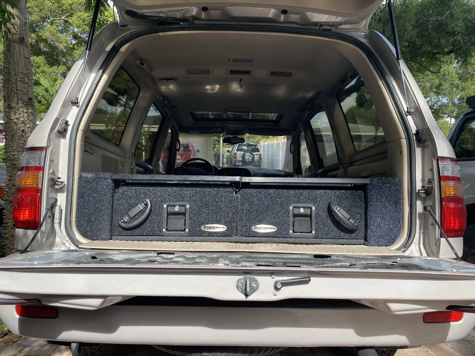

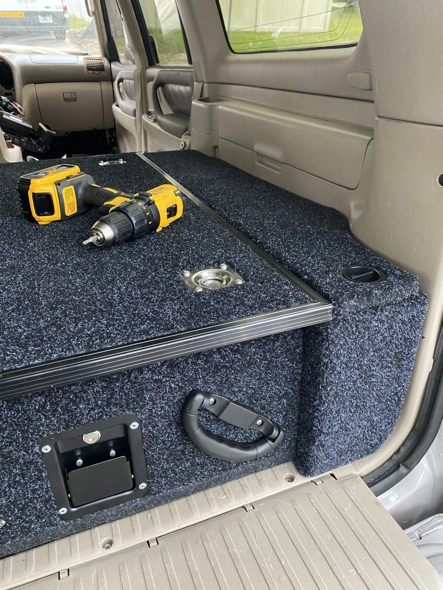

Then I installed the Dobinson’s drawers.

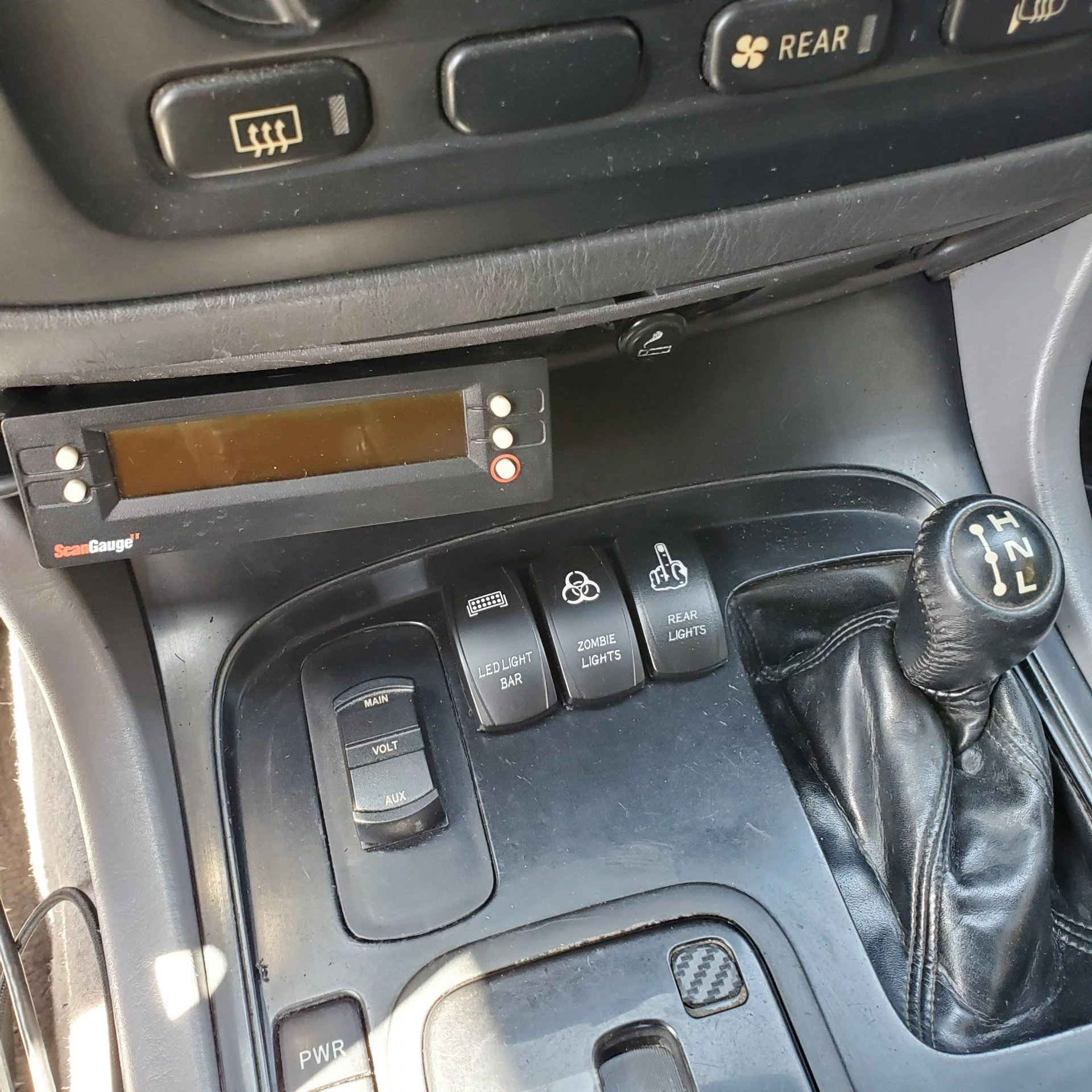

Took the rig on a fantastic 200 mile gravel route around the Texas hill country. Everything was great..,.until my alternator crapped out. Barely made it home as the battery fell from 13.4 volts to 10.8 volts. It was holding steady at 13.7-13.8 for the entire trip (as it always does). But, when it started dropping, it went quick and battery warning light kicked on. Had battery tested and it tested like new. Charged right up in an hour. Plugged it back in the rig and watched the voltage on my Scangauge bouncing between 13.7-14.6 before finally starting the slow descent down to 12.8. I shut it down and am now considering my alternator options. The original lasted 22 years and nearly 250k.
I upgraded mine to the Tundra/Sequoia alternator 130 or 150amp vs stock 90amp (?). Just need to replace the connector to the alternator (P/N: 90980-11964). If you running extra electrical stuff good to have the extra amperage available (ie sound system, LED light bars, winch, etc...).

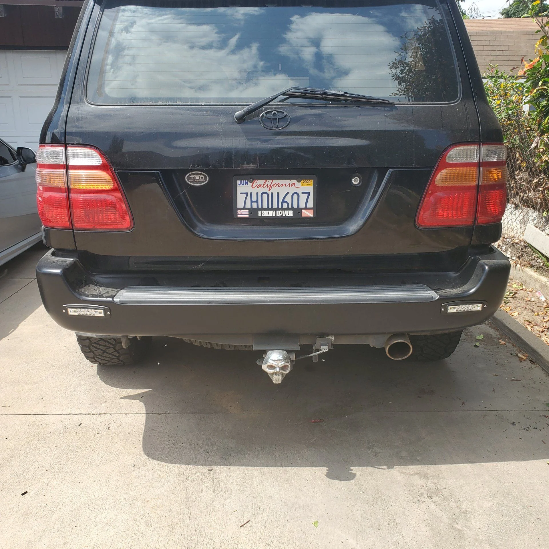

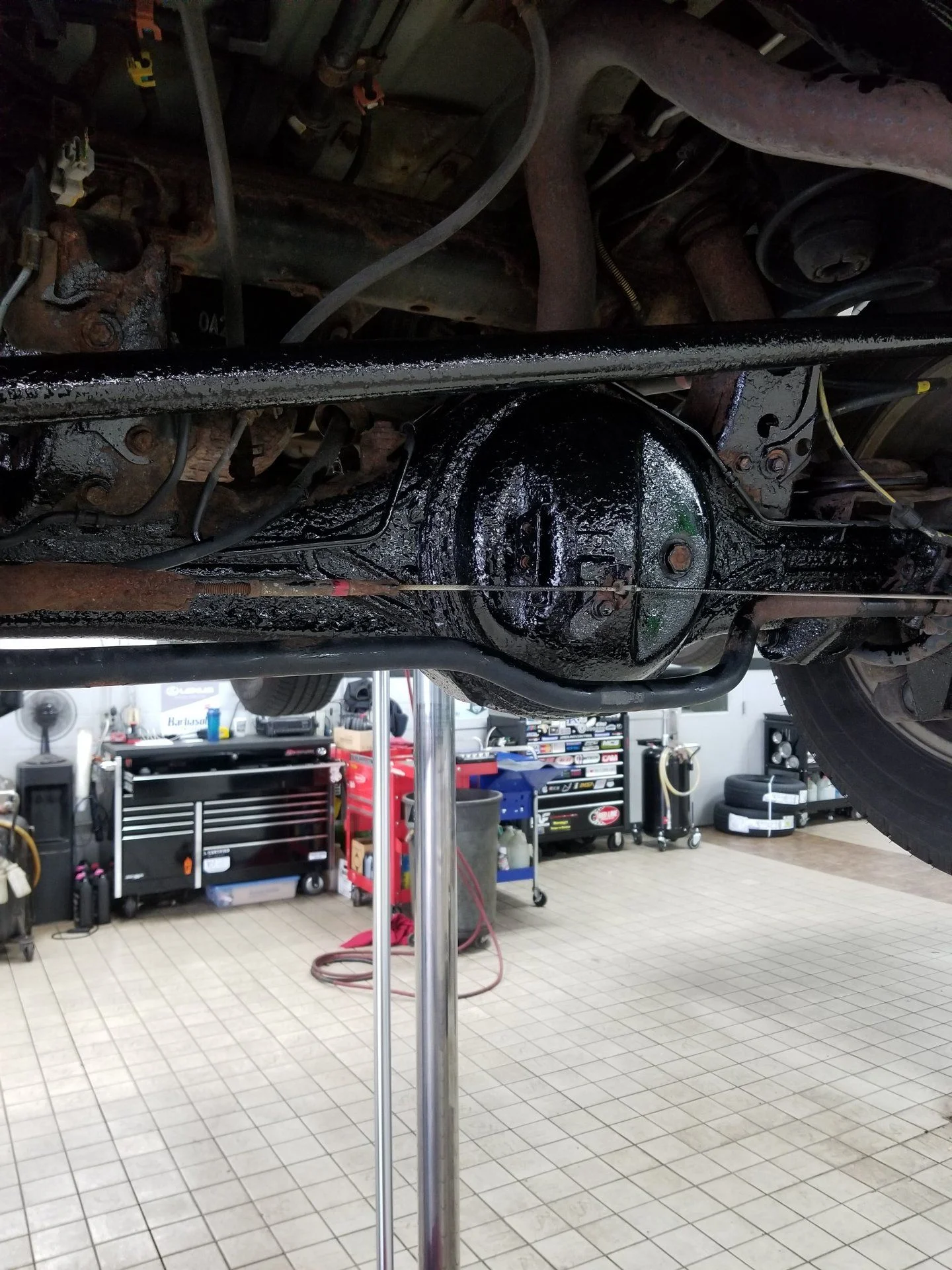

Looking better by the day.
Before/After:

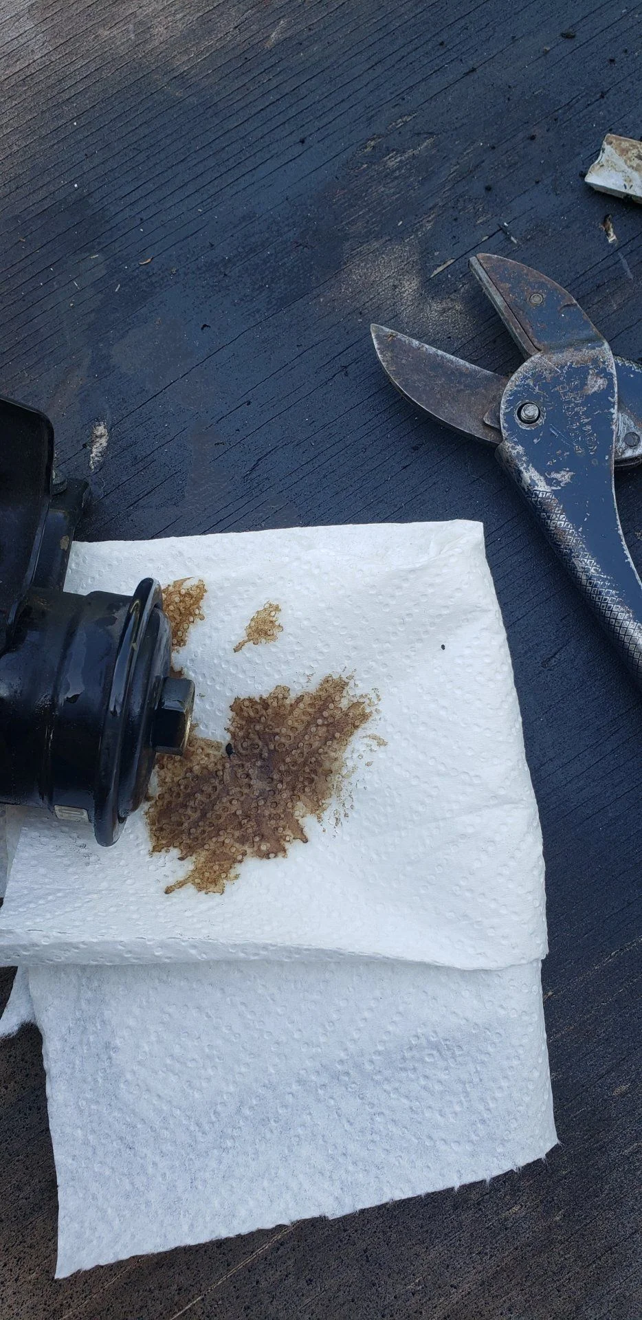

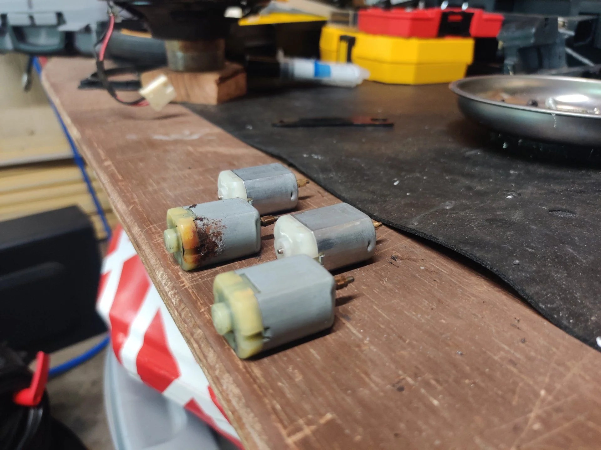

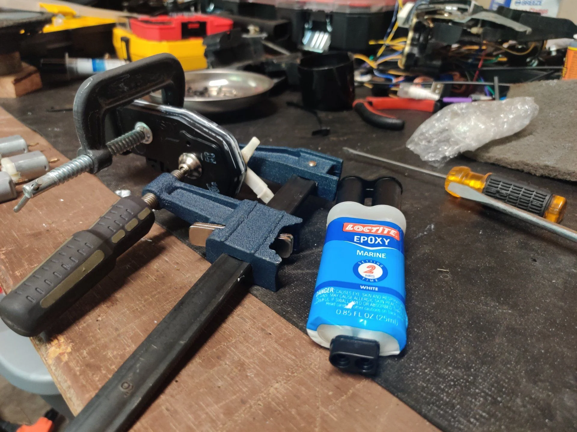

Waiting on the epoxy to cure on the front two door lock actuators. Read stories about people's assemblies popping open or allowing water ingress so I'm taking no chances. Went with a marine grade epoxy and am also gonna ziptie them.
Passenger motor looked fine, but the driver side looked alot more like I expected. Old motors left, new motors right. Amazing the difference such a cheap fix can make.
Finished the last of the sound proofing. Secondskin luxury liner pro. Getting closer to wrapping up this build View attachment 2307983

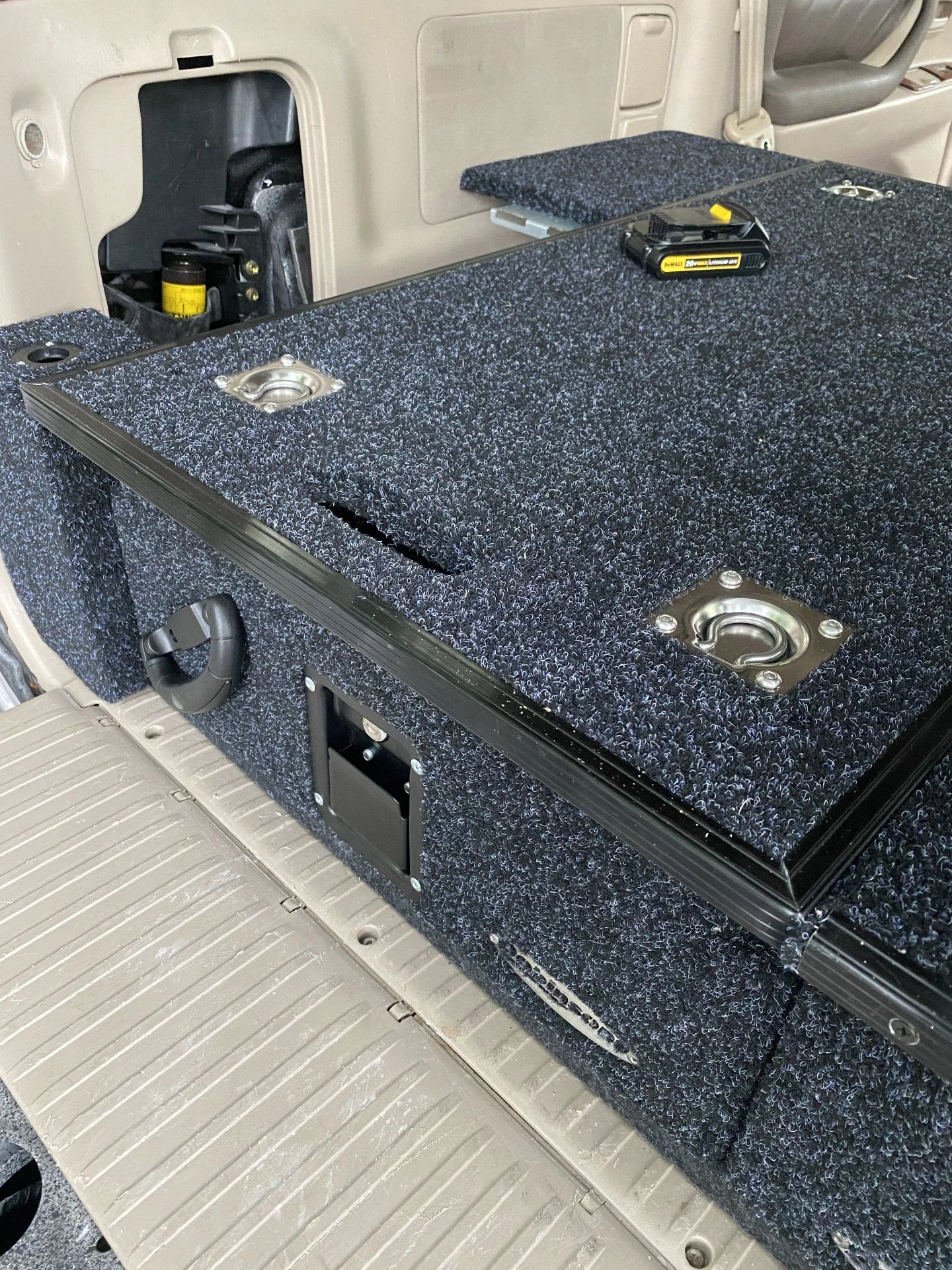

Those Dobinsons drawers look the part for sure. I have had my KISS drawers for quite some time, but am considering something like the Dobinsons. How would you rate them? Does either top slide out? Also, the sound deadening.....worth it?

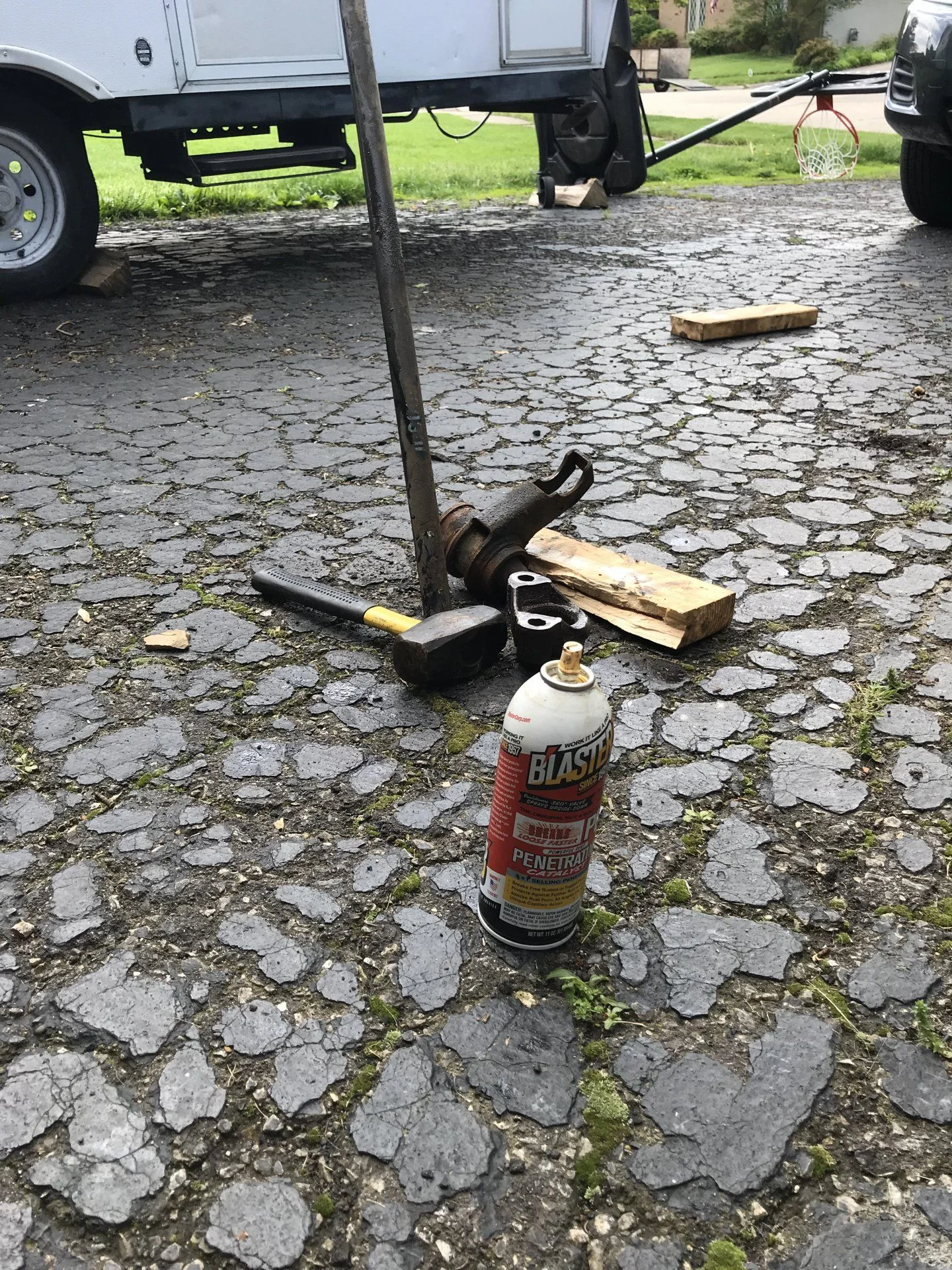

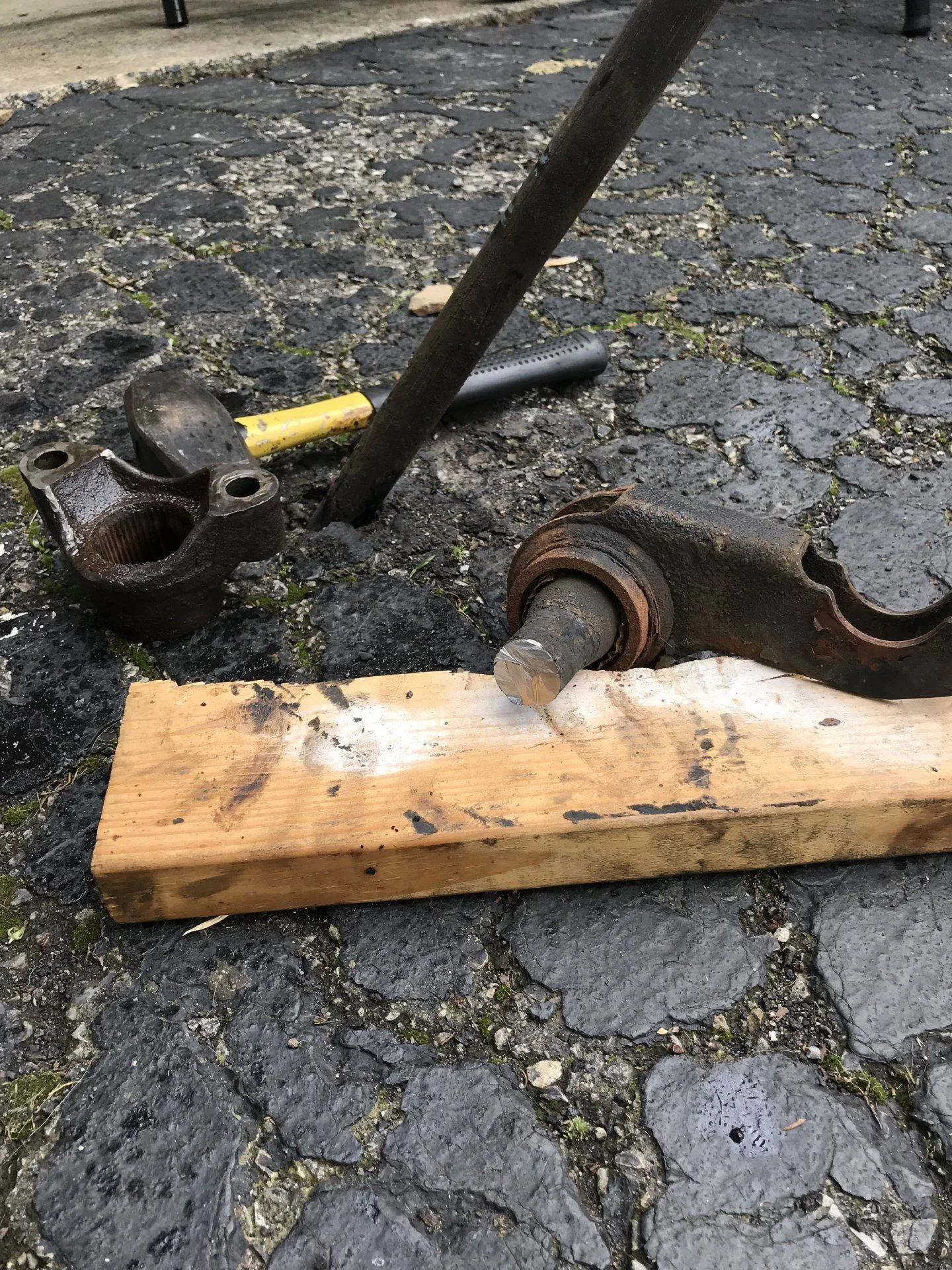

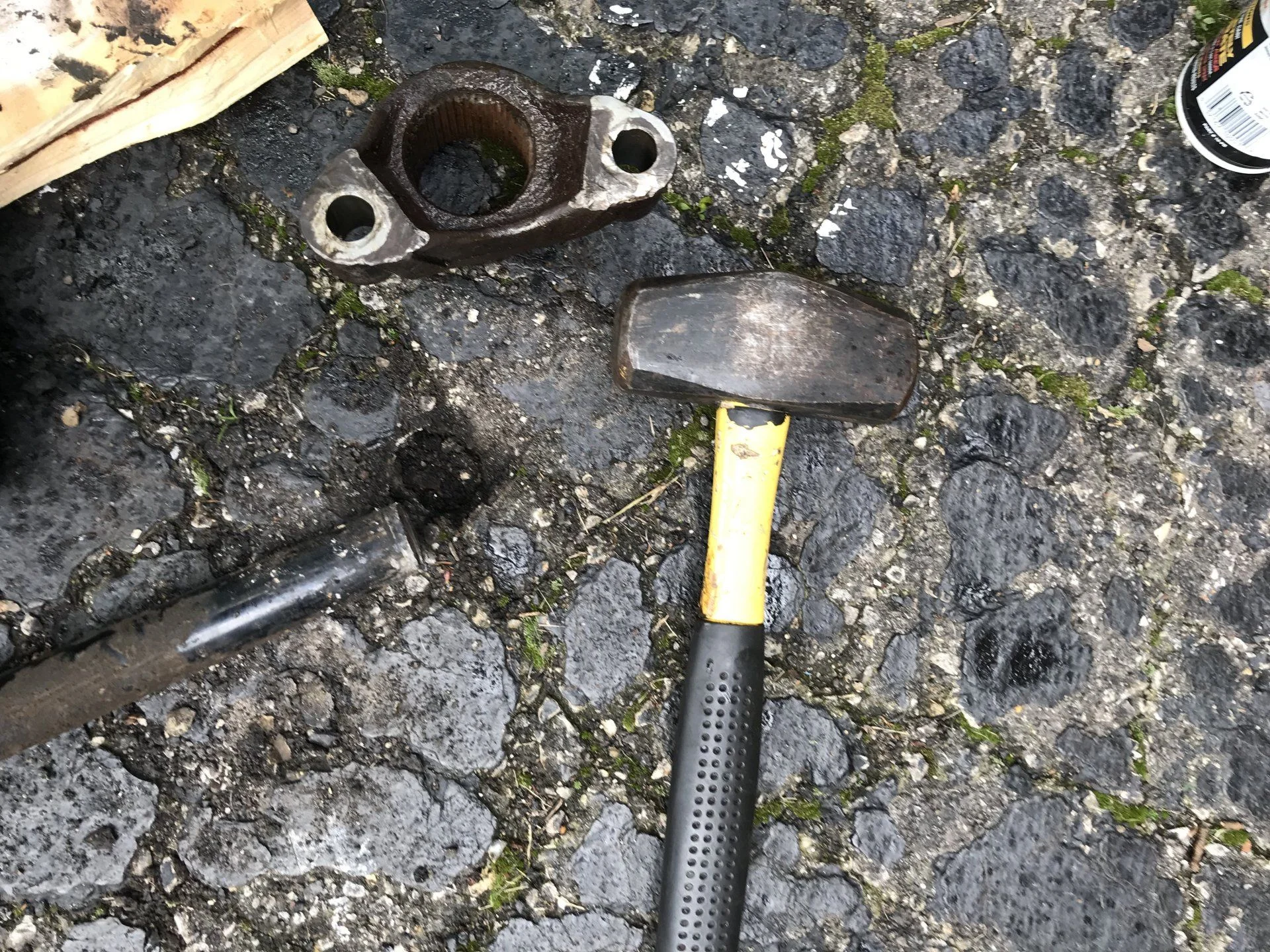

Torsion Bars....hahahahaha.....torsion bars. You AZ people don’t know how good you’ve got it. I cut that mother lover out, and proceedeView attachment 2308286View attachment 2308287View attachment 2308288d to put a 3” hole in my driveway driving one end off. The other end may be a goner, PB can only do so much.

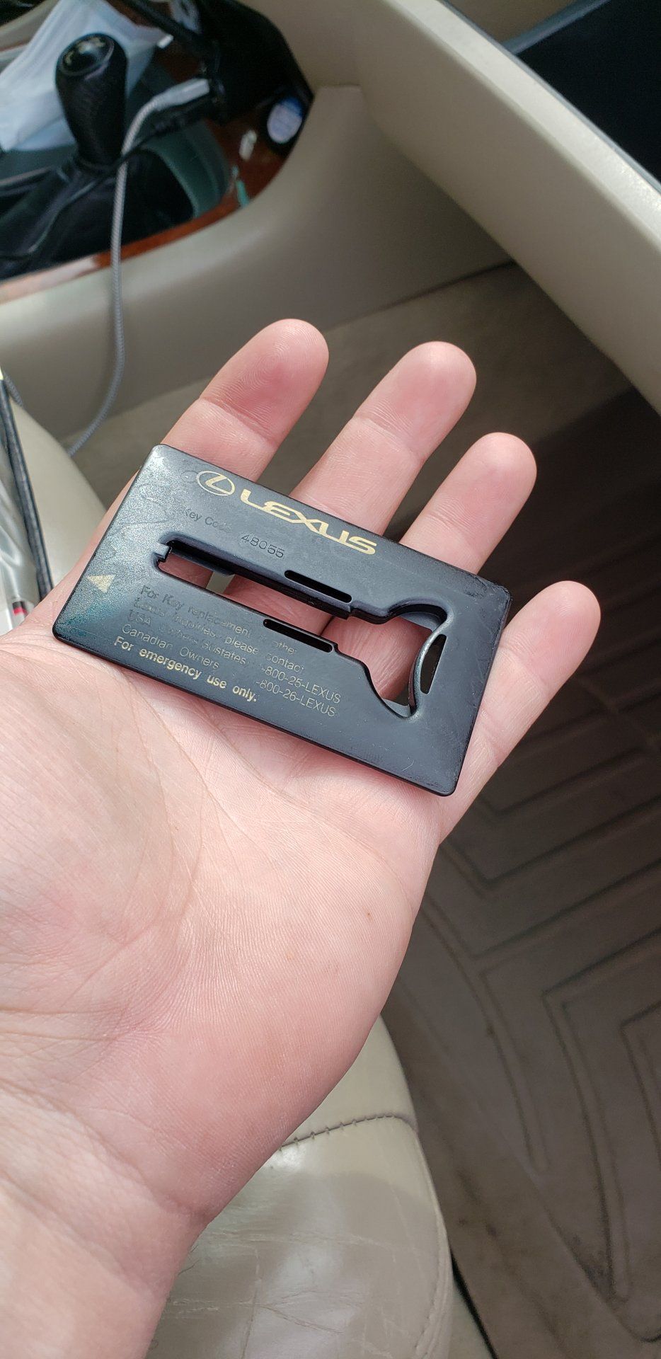

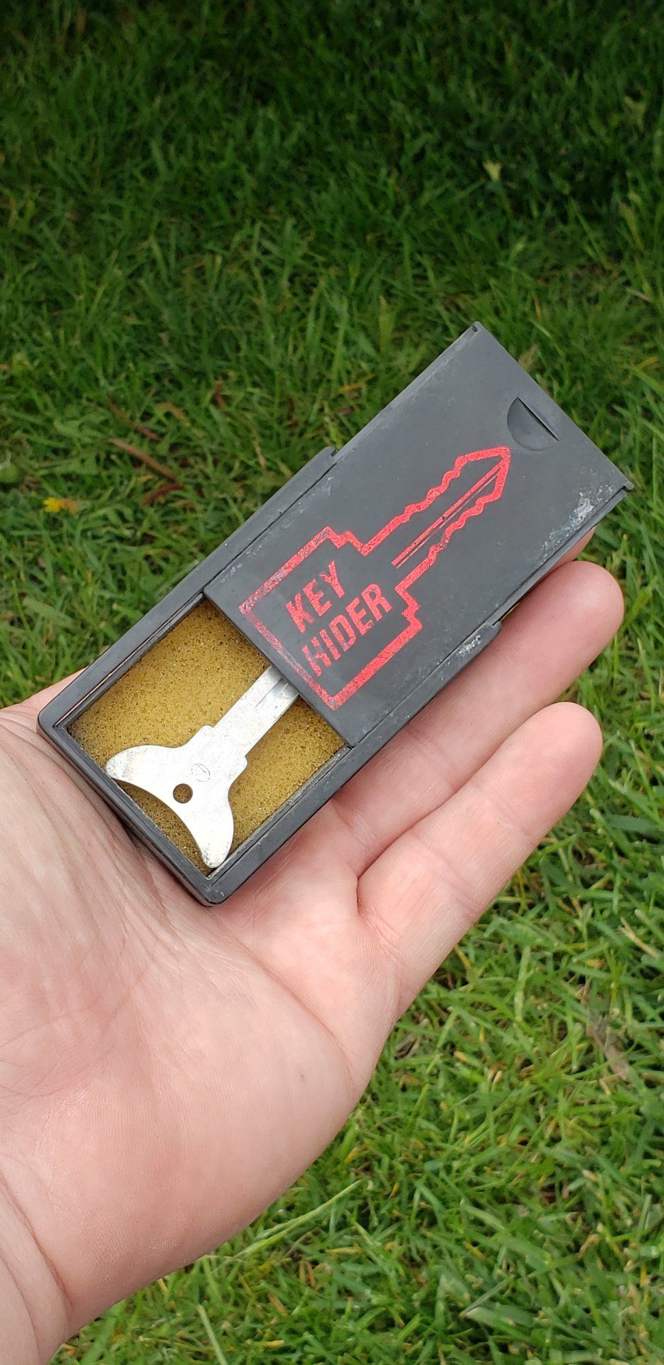

So for the past two days I have been crawling around under this thing cleaning up and doing general maintenance. I have had this rig for a year and it has 189k miles on it. I just found this. I assume it's the key that is supposed to go in the glove box
Yep. If you want to start the car with it, you need to use both parts, the security "chip" for the immobilizer is in the "holder", and you probably should keep it in your wallet (not the glove box).
Curious- that is an LX thing only? Or was it also included with LC? My LC is an '01
Great buried treasure find!
I'm pretty sure this was LX (short blade) only.
Someone could probably come up with a home-brew equivalent for the LC with the proper "chip" and a metal key.

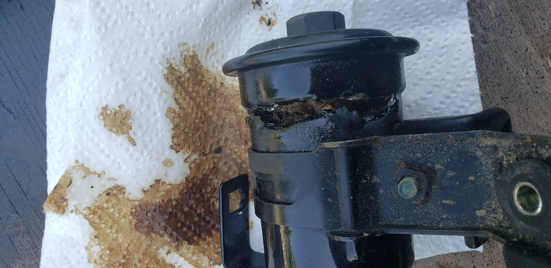

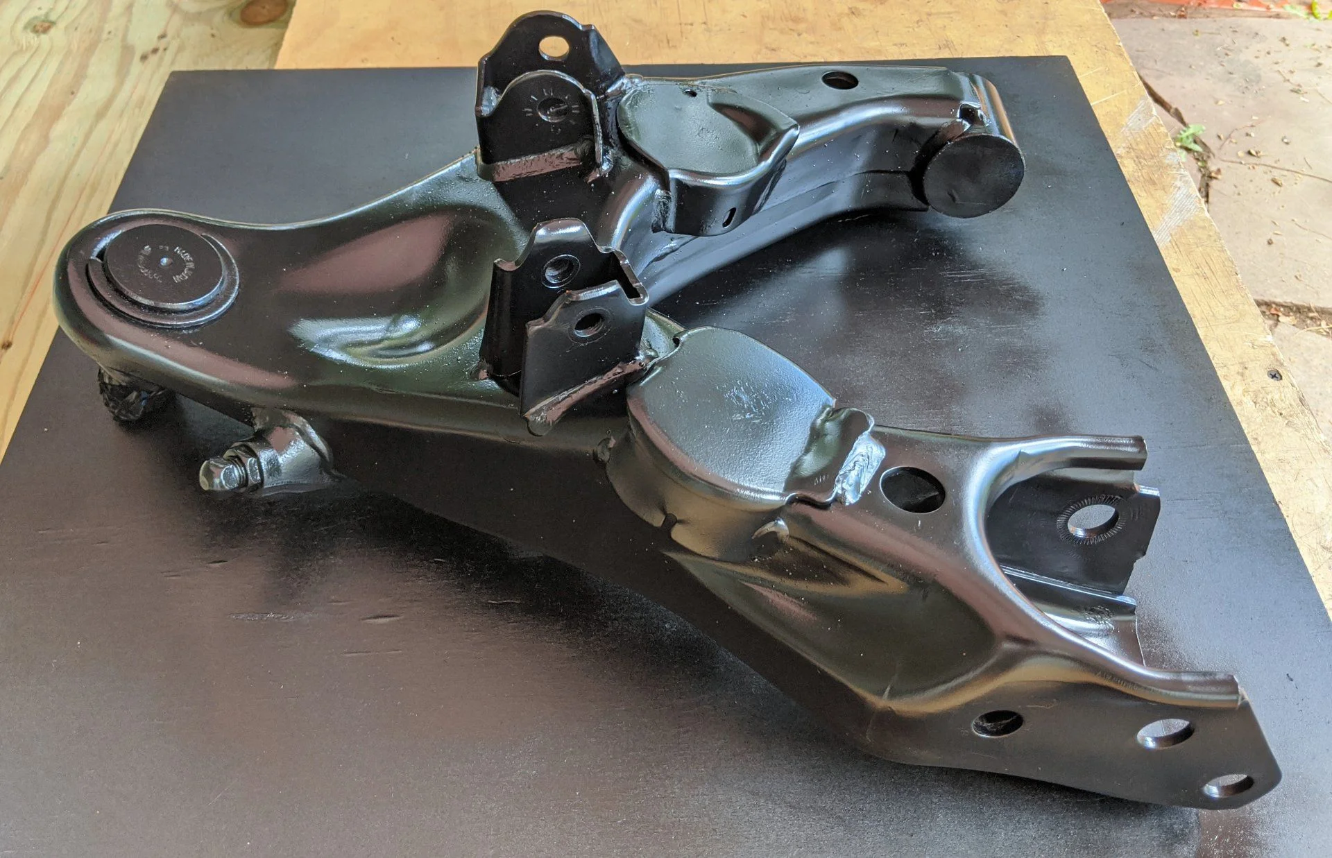

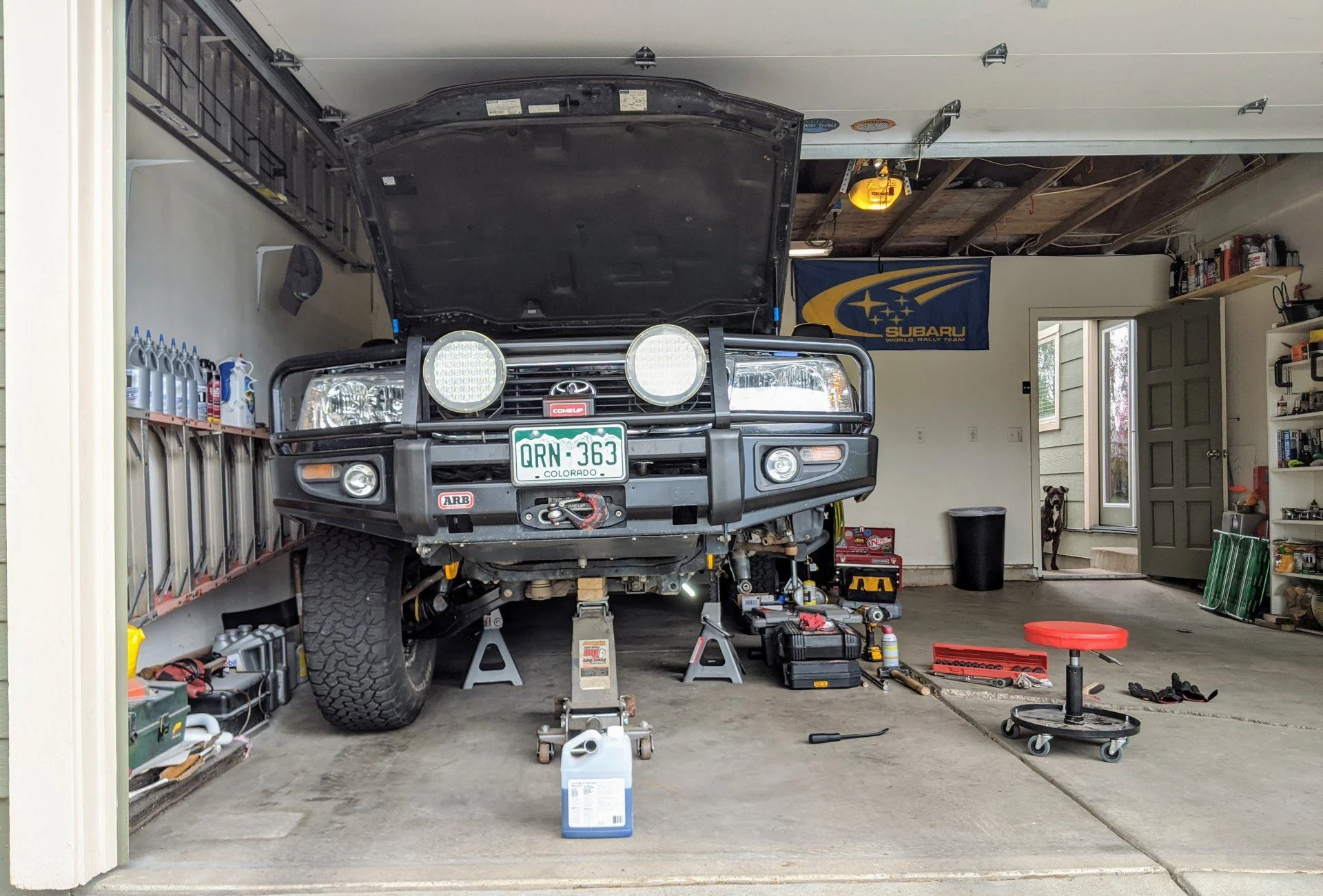

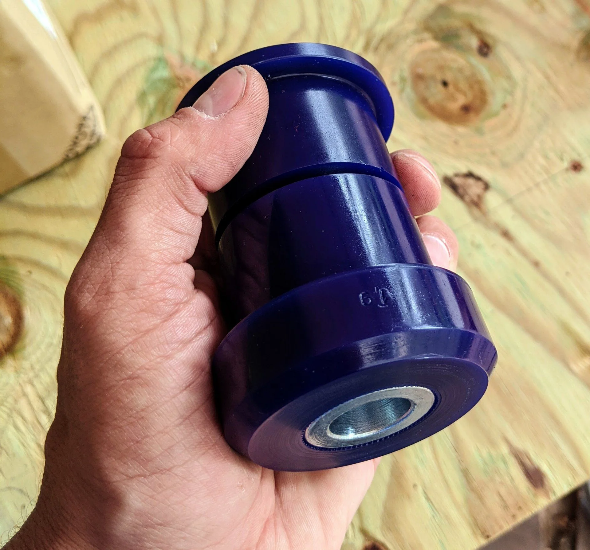

I found the source of the front end clunk I would experience when on washboard roads. The driver's side frame bushing for the lower control arm was toast. I could easily move it an inch any direction with a small pry bar. The replacement Super Pro bushings are very beefy and should improve the ride.
I removed any rust and painted the driver's side LCA this morning, waiting for it to dry. Tomorrow I will reassemble everything, check the index on my tbars and take it for a drive. Can't wait! This has been quite the load of work.
