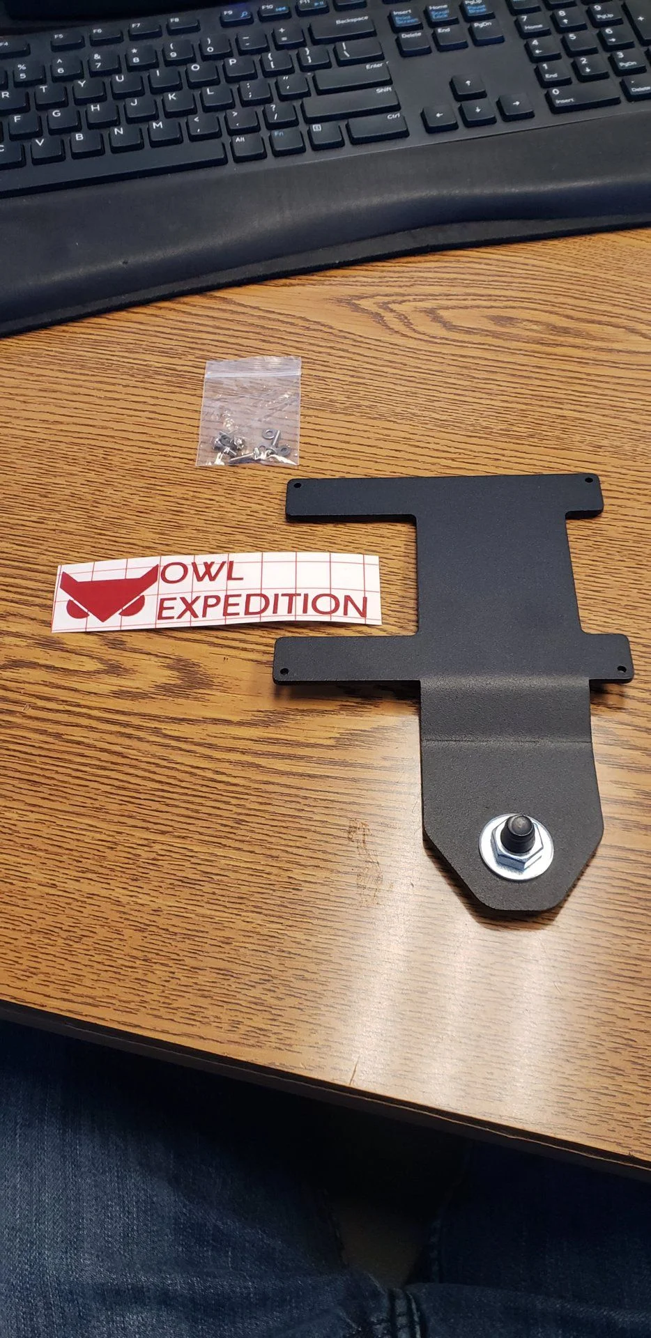

Ordered owl expedition media mount

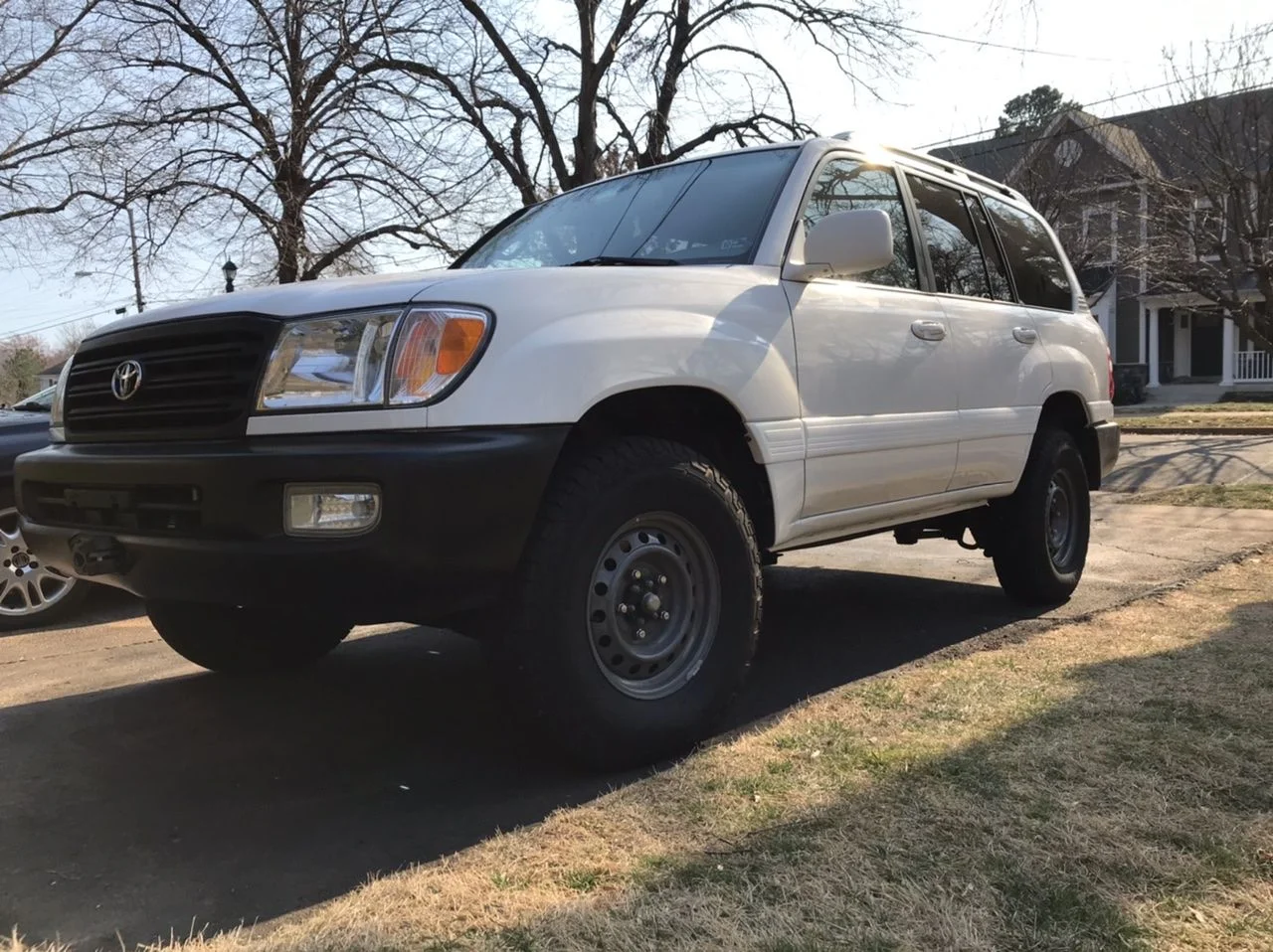

Installed the OME 1.5" lift this weekend. Need to completely remove the AHC components still but got the drivers side hard line out. I also hammered out the old front diff bushing which was not as bad to do as originally expected. About 20 minutes with a chisel and my 3lb sledge. New one in and drive clunk is basically gone. The old busing actually looked to be in decent shape too.

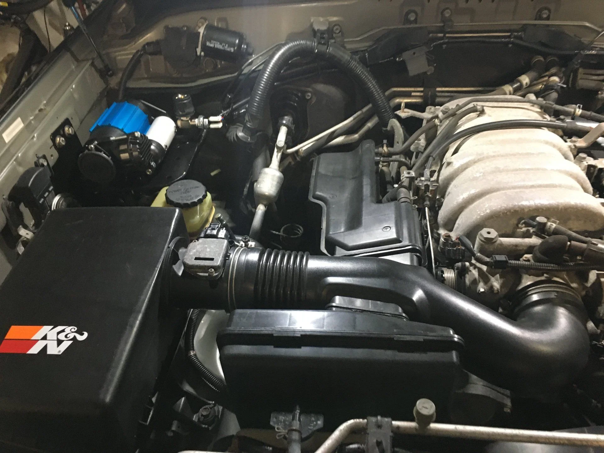

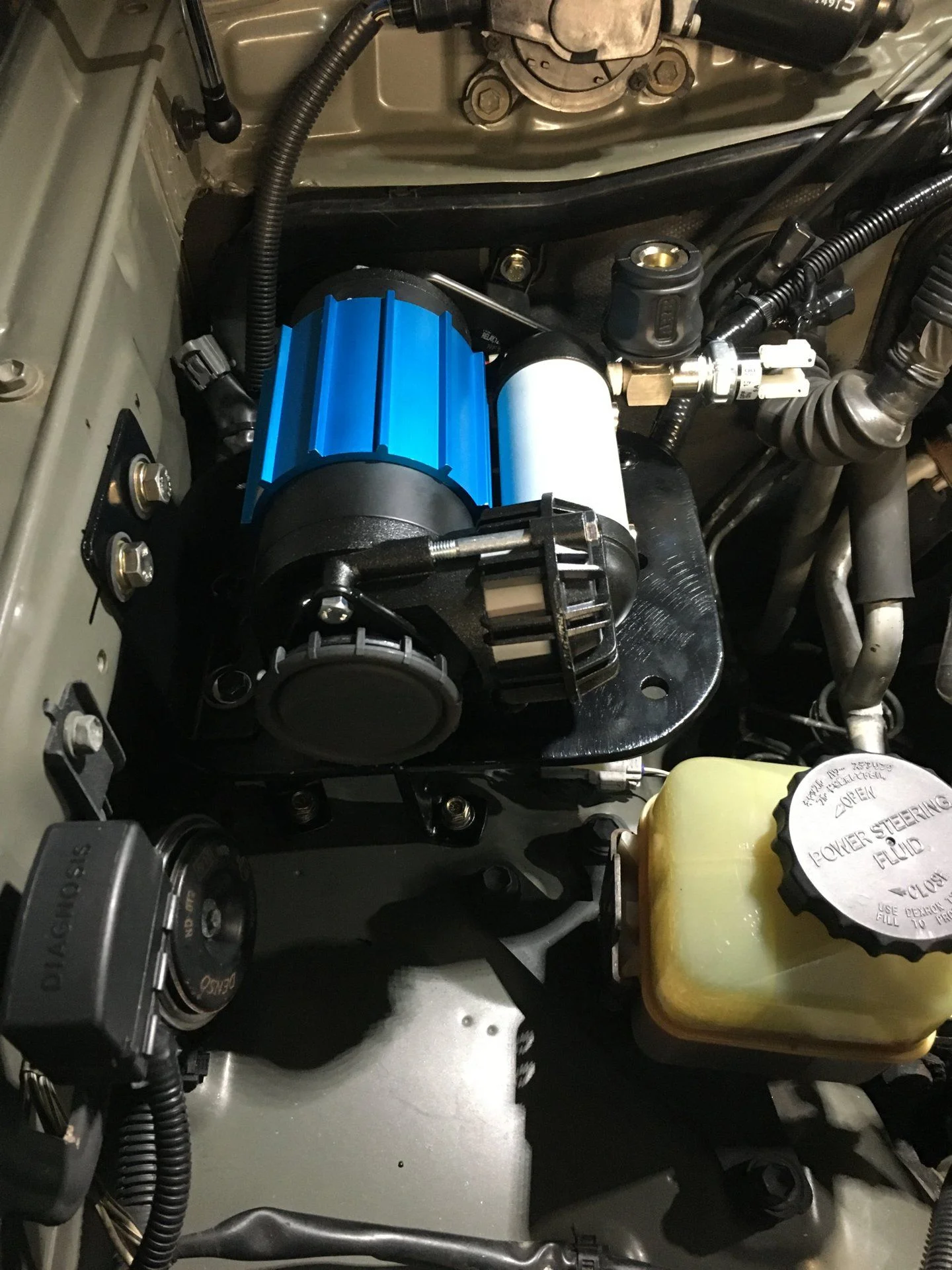

Completed the hybrid conversion ;)
View attachment 2226639View attachment 2226638

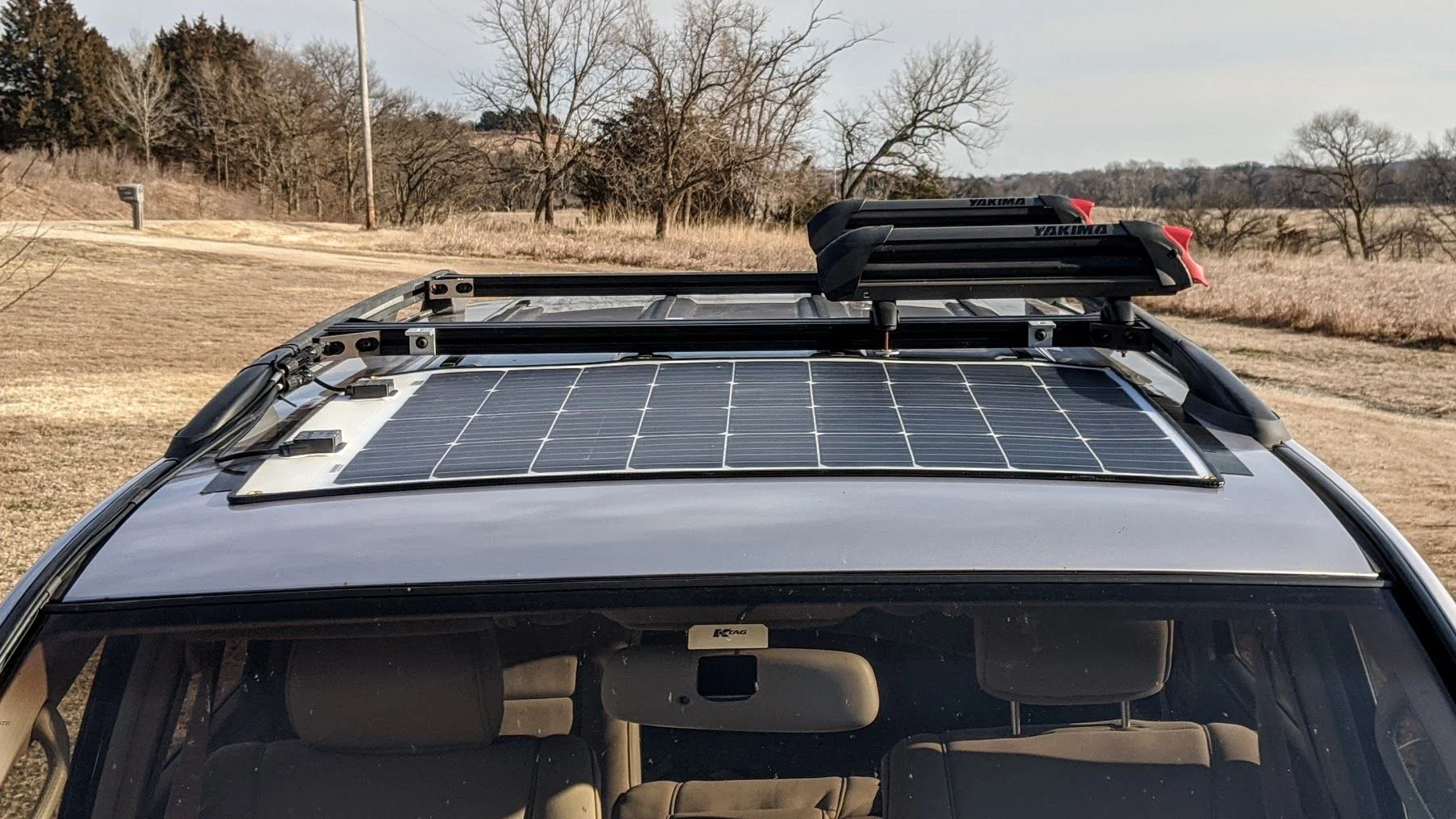

A fixed roof mounted panel with a PWM controller isn't the most efficient (but hey, it is cheap). It should help keep my house battery up while running a fridge on days I don't drive the cruiser. I still need to work of my rooftop cable management, but the system seems to be working.
  • 100w Rich Solar flexible panel (ETFE)
    • Rubber door edge guards
    • 3M VHB tape
  • Renogy 10awg PV cables
  • Renogy Voyager Charge Controller (waterproof, PWM, 20A, battery temperature sensor)
  • 20amp circuit breaker at the battery
Keep us updated on the new sun roof! I’m curious to know how well it keeps the battery topped off.

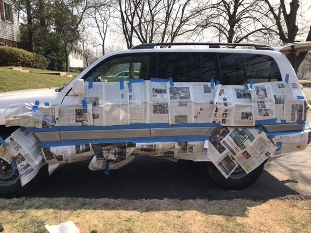

Did you sand down the molding before painting? I'm getting ready to do this to my 100 but I think I'm going to remove the molding from the cruiser.
I did—wet sanded it with 400 grit. I removed the trim on the passenger side, so tried both ways. It was nice to not have to tape, and it was good to get all the crud lurking at the trim edges bugged out (used an eraser wheel) but it was a pain to remove all the adhesive from the truck and (worse) trim. And I needed three of those little rolls of adhesive and some new clips to reinstall.
summary: both techniques are a pain. Slightly better results but more expense and slightly more pain to remove/reinstall trim, but probably the best way to do it right.

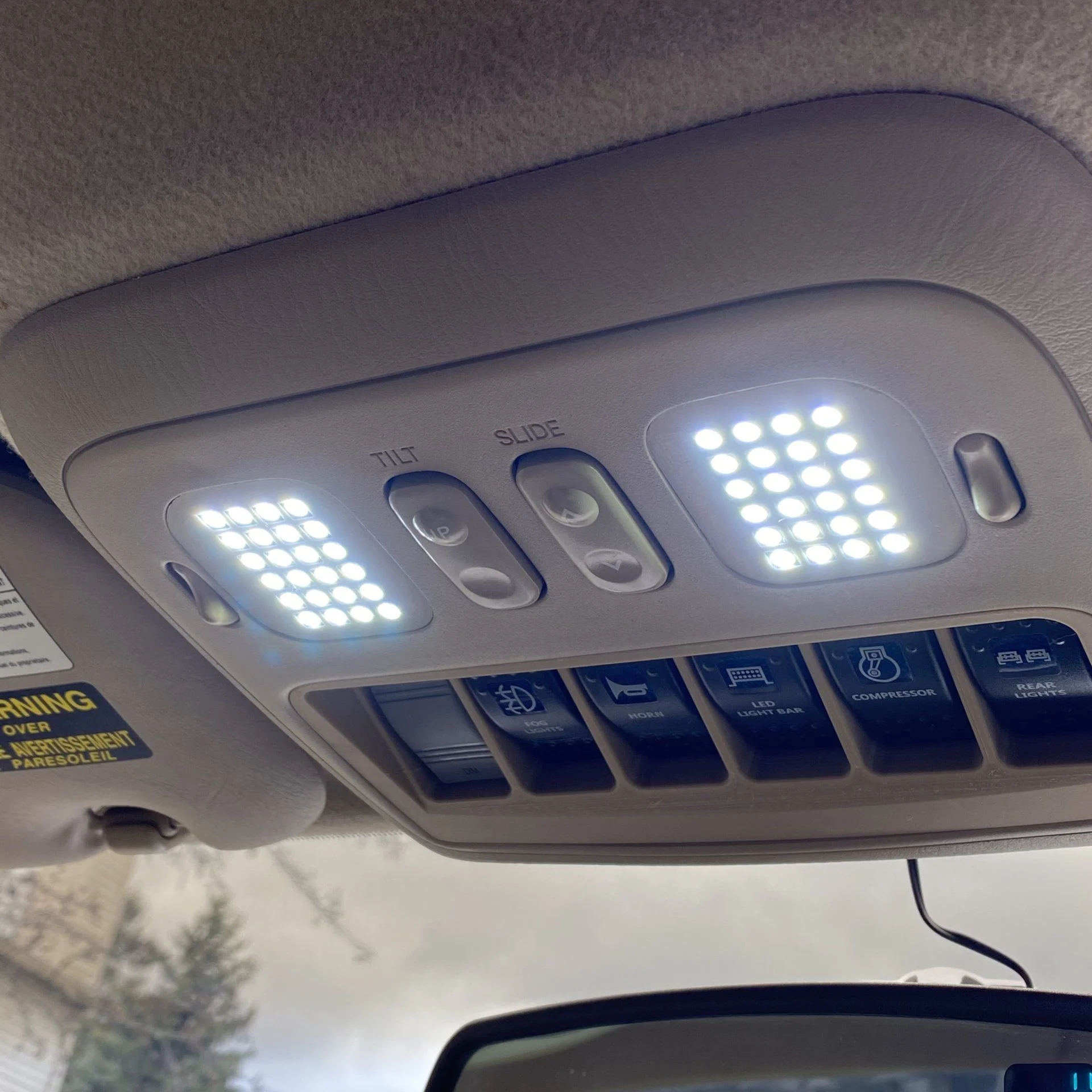

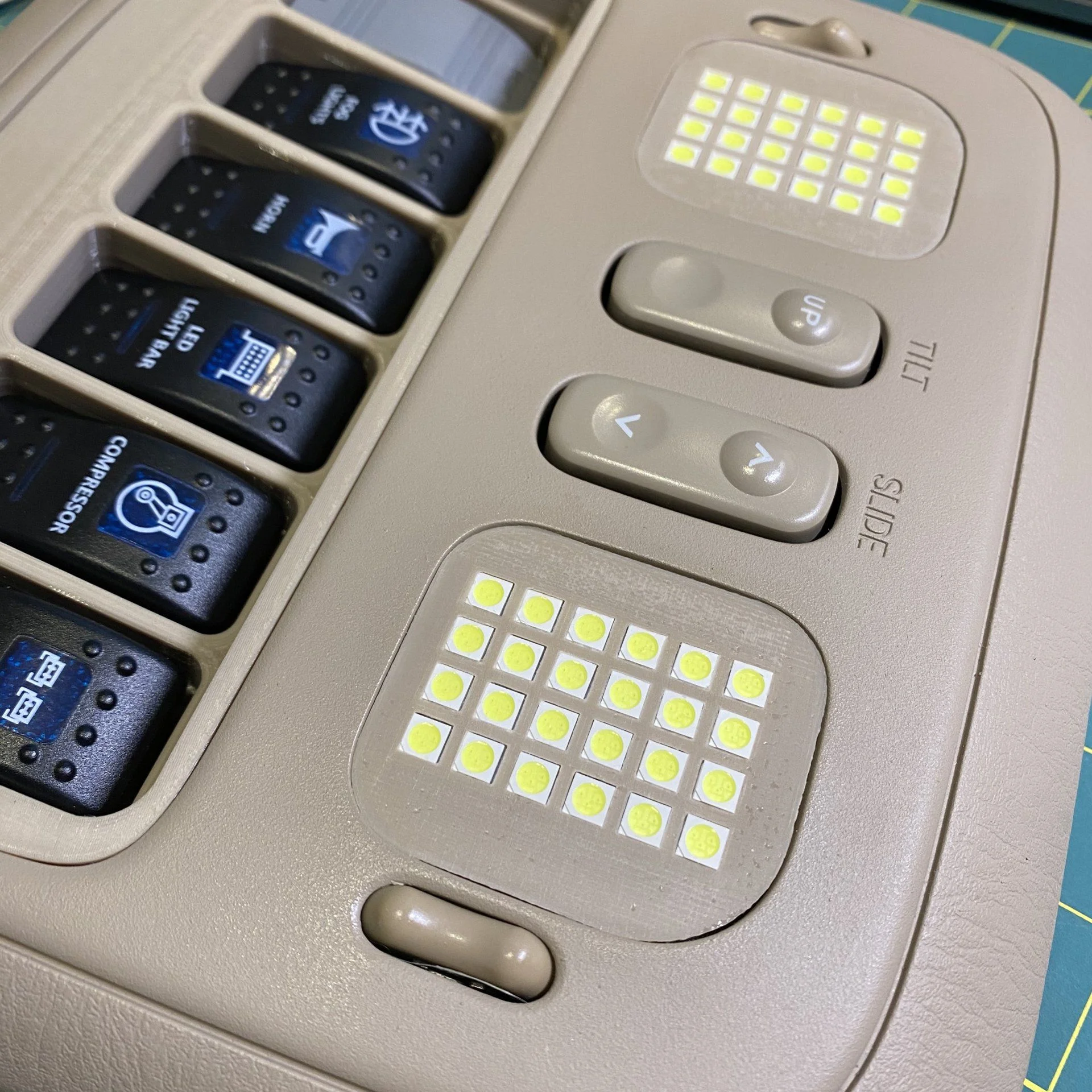

Clean panel how di u make it ?
3d printed. See more photos in my thread.

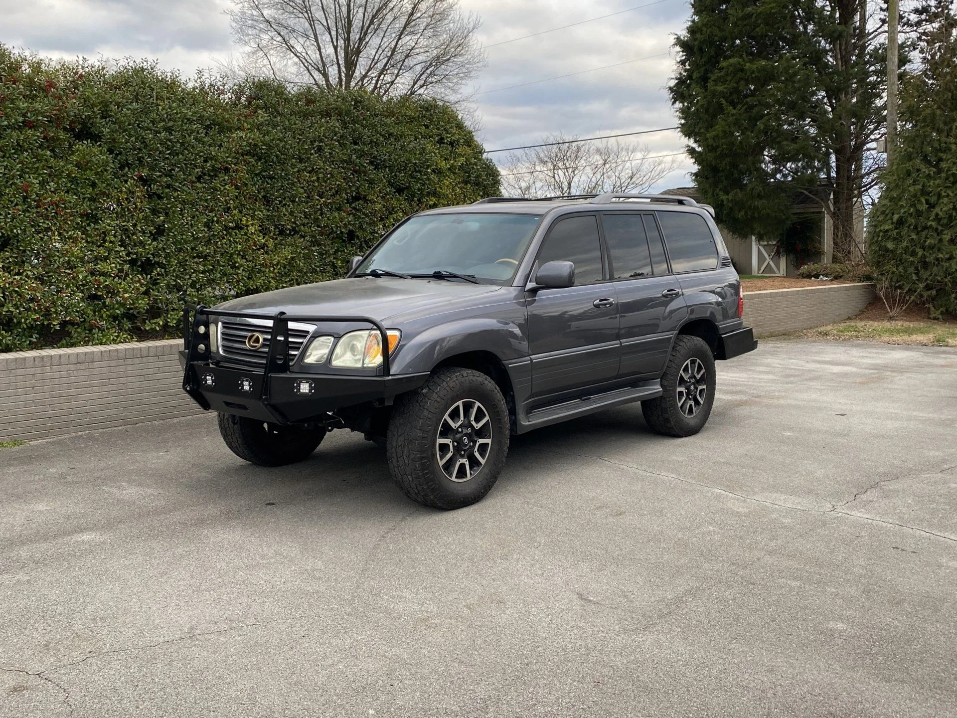

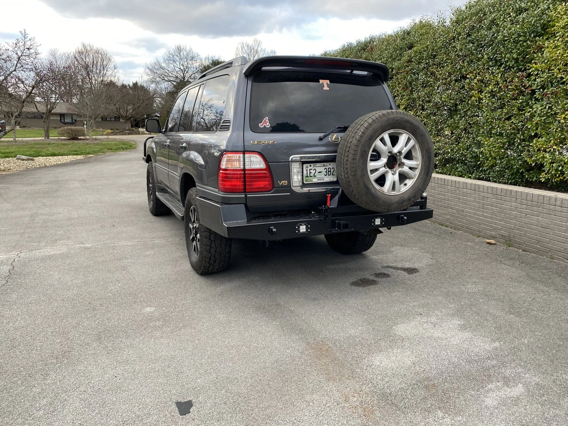

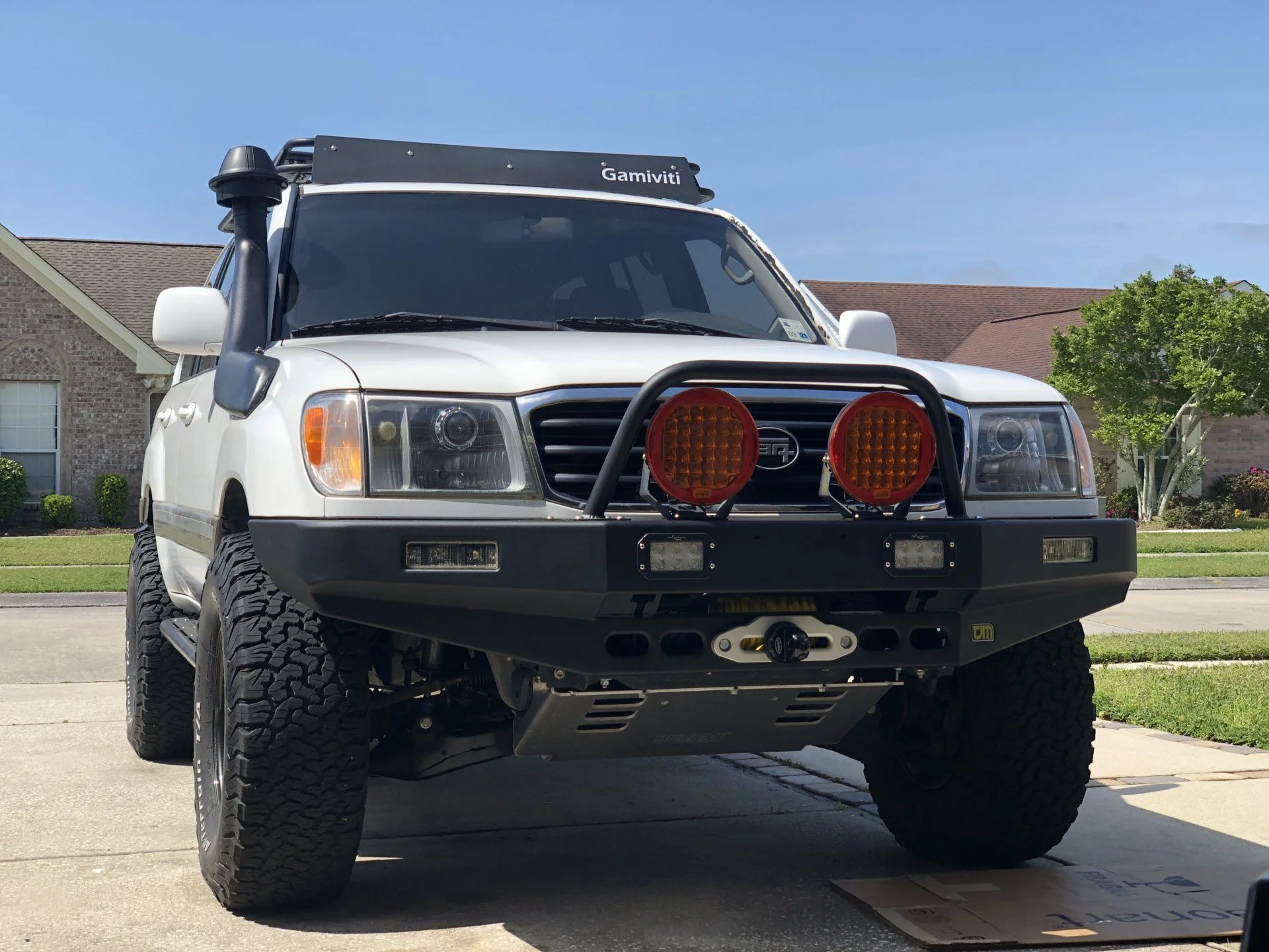

Not today but over the last two weeks. Started out stock with non functioning AHC.
New OME lift and AHC delete, diff drop, bumpers (front and rear), wheels and tires, ball joints, tie rod ends. Now all it needs is a bath and alignment. Still haven’t driven it yet. Gotta install winch and wire the lights in bumpers. Oh and find a matching spare wheel/tire.
Joe does great work, he built my bumpers.

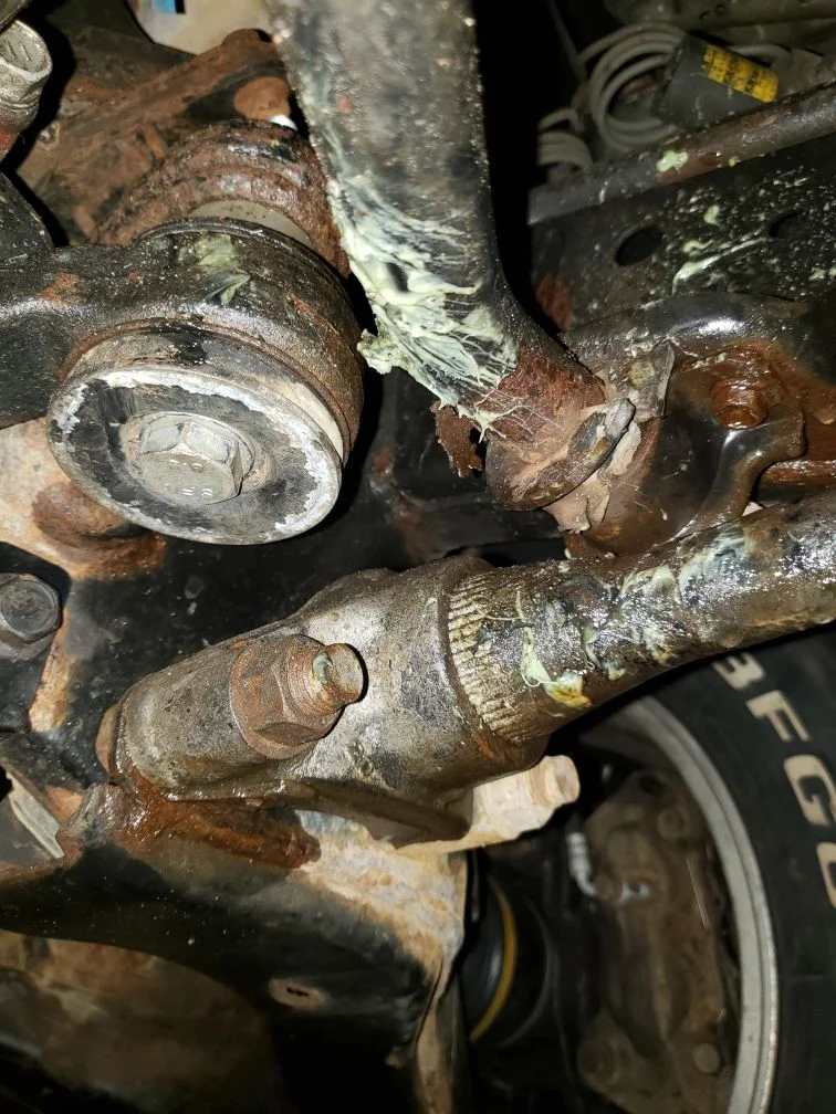

My LX is at a local shop getting the front sway bar bushings replaced. I know what a nightmare they can be, so I am happy to pay a cool $100 to the shop to deal with it. I asked them to give it a once over to make sure there isn't anything else they see wrong with the suspension/drivetrain. They came back saying that the passenger side torque arm is "tweaked". They noticed that splines are exposed at the LCA and thnk the torque arm somehow took a hit.
See below for the pics they shared. Is that even a thing? Can a torque arm even be tweaked?
Looks normal to me. Mine show splines as well.
